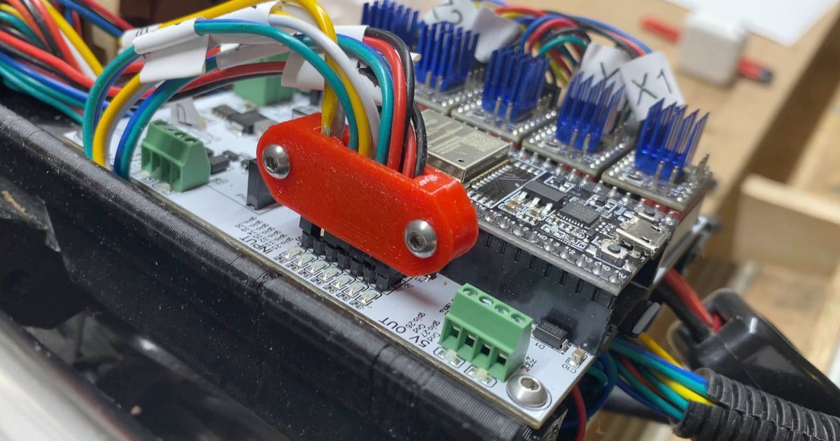

When I have had this happen on my MPCNC it was where the endstop extension wire plugs into the main wire that goes to the stepper driver and the endstop on the Jackpot. For whatever reason it was loose.
Yeah, I’m thinking hot glue may be in my future. What threw me off is all the limit stop lights worked. I just didn’t notice it was the Z light instead of Y2. Man that was maddening! :laughing:
Just look for a printed part *mod in the search box. I think @DougJoseph did it. It secures the conecction for the endstops
Maybe this is what you remembered?
Exactly!!
