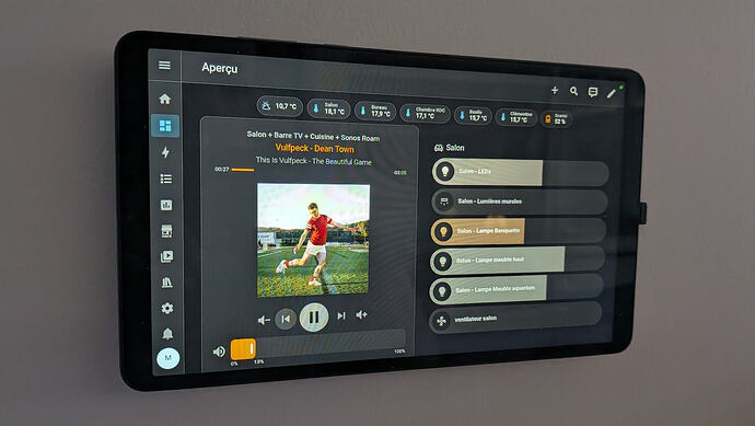

Yeah, I started configuring a dashboard, but is there any way to have something like a collapsable sidebar with quick shortcuts? or hiding the menu and top bar? Some kind of top bar with status icons?
The goal is to have a clean / non-cluttered dashboard for daily use

I bought a Redmi Pad SE, nothing fancy, just wanted a “not too old” device
The support is from aliexpress/banggood
https://www.banggood.com/fr/Magnetic-Wall-Mounted-Wireless-Charger-Wall-charging-Socket-Tablet-Magnetic-Bracket-Holder-for-Universal-Tablet-Android-p-2031434.html

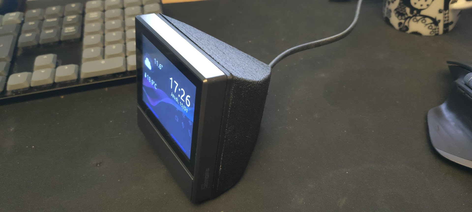

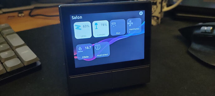

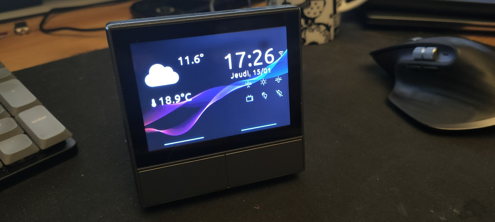

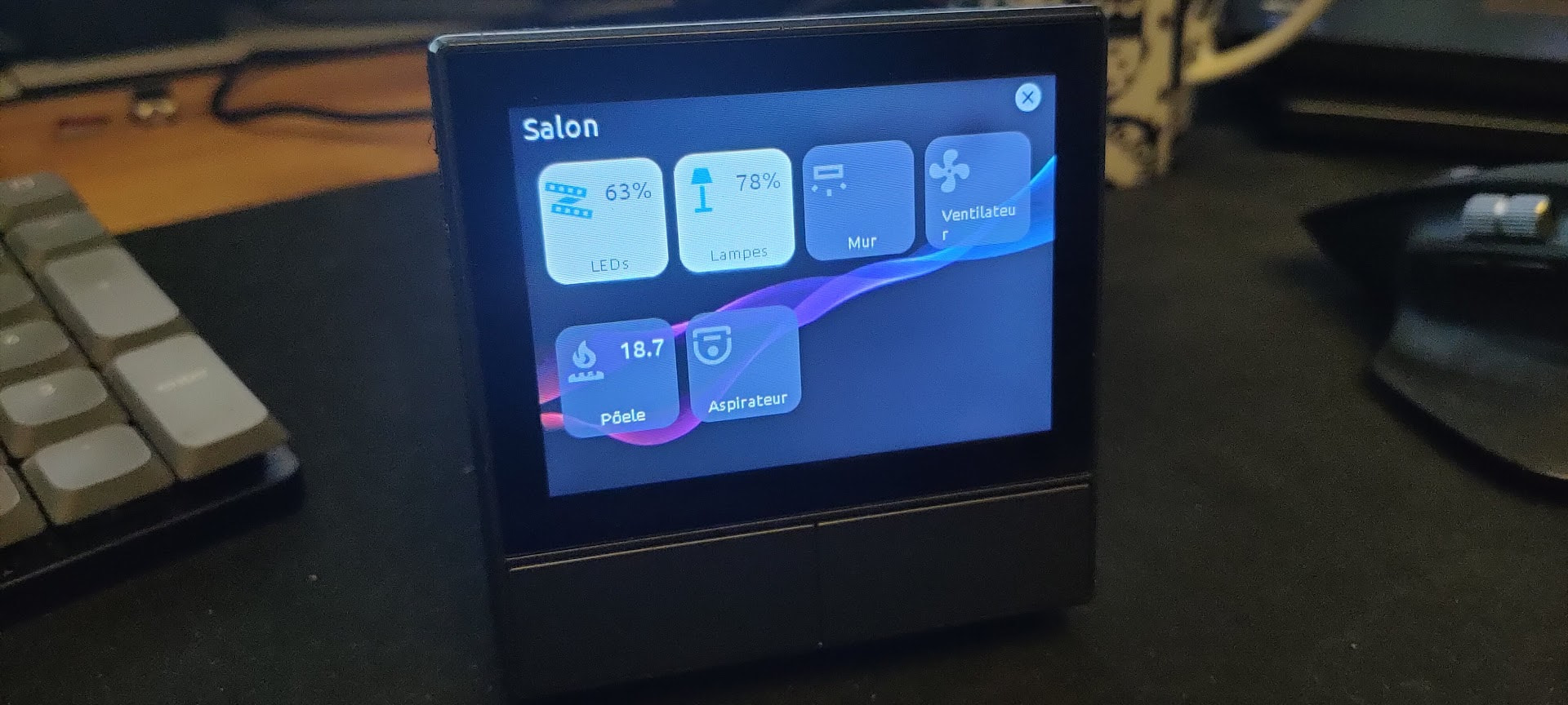

Previously, I used an NSPanel (EU) mounted in a 3d-printed support
I liked the clean simple look and configuration, but it really lacks flexibility
But as a glorified remote, it was just great

I put this one in my son’s bedroom so that he can play with led’s colors :slight_smile:
Nice wall tablet! Have a couple in my house as well and the family approves and uses daily. I am big HA nut and retrofitted the majority of the house to suit when we built our addition.
