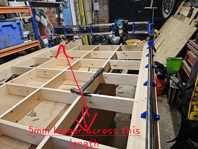

Hi everyone, i need some help with squaring, as my first couple of attemps are throwing me.
I have taken the machine and homed it. The router has a v bit in it for ease of marking the point.
I lower the z until it touches the spoil board and mark the point.
Track x all the way across till it hits the far side. Repeat lowering z and marking.
Then i send it all the way to the other end less 100mm or so otherwise im off the edge of the spoil board with is a full 8’ x 4’
Repeat lowing z marking and then home x and marking at that side too.
There is currently 5mm of skew in the direction shown.
I have tried changing y motor 1 pull off by adding the 5mm to the pull off mm, so from 4 to 9 and the results on the next test were well off.
Am i changing the right side? Do i need to split the diffence or change it profressivly and keep checking?

Have you had a look at that section in the docs? There’s also a video that is super helpful right below it.
I could be wrong, going from memory here, I think you add the extra pull off to the longer side.
I understand the process but whats classed as the longer side when i measure diagonally?
Well, good old ASCII art…
So take Y Max as up and X Max as right on your screen.
If the / measurement is longer, you need more pull-off on the left hand side, closer to Y Min.
If the \ measurement is longer, add it to the right hand side.
Naturally, subtracting from the other side is also possible.
The diagonals measurement enhances the out-of-square amount, but the actual amount of change gets diminished because the belts are outside of the cut area. Using the amount of the difference as an adjustment is a fudge, and isn’t guaranteed to get you a correct result, so you keep repeating the process. Some time ago, I did a CAD drawing that you input your machine parameters (Namely distance between Y belts), the Y length of your rectangle, and entered your diagonal measurements into and it would tell you how much to adjust by. It’s in the forums here somewhere…

Right. There it is.
Edit: M666 is the Marlin method of adjusting pull-off. We do it more individually with GRBL/FluidNC.
Hmm, not sure how I missed this that post. I’ll try that out the next time I need to re-square. Thanks Dan!
The side with the larger number is longer
