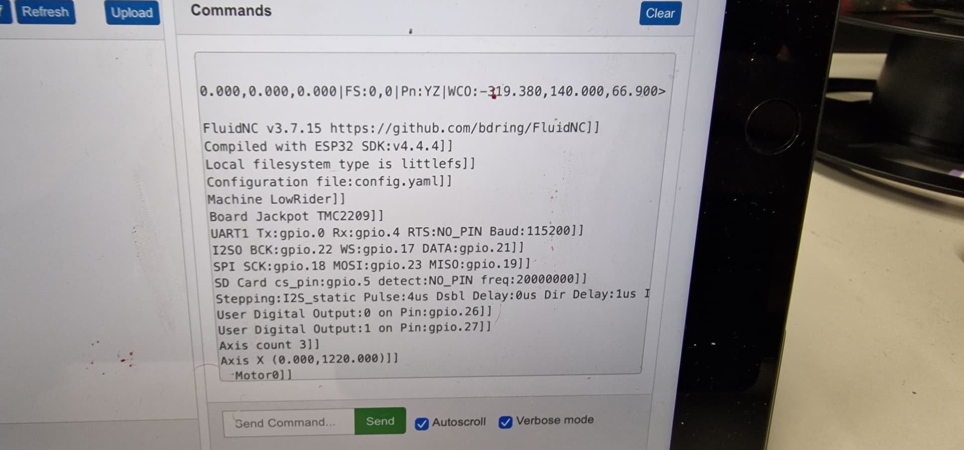

I don’t have any bits in yet as I was just getting the movement set up. Should I plug one of the broken steppers back in when I do this? The last one to go that is still in there was one of the Z axis ones.
Maybe.
If you run with the replaced steppers and never have a problem then I am curious what the deal is with those original steppers.
If it’s thermal overload, then you’ll get back to the same conditions eventually with the new replacements. It’s really hard to see how you could be getting thermal overload with the TMC2209s.
Have you modified your config.yaml in any way from the V1 defaults?
Like Ryan, I’ve never seen a stepper fail that wasn’t caused by me damaging it (e.g. I killed a couple by mangling the connector on the stepper body, killed one by bending a shaft being stupid with a pulley.)
If you did your own connections this is the issue.
You did not change the config so it is not thermal shutdown.
Plug in the new steppers with premade connections and it will be fine…other than you will need to up the current, but that can wait.
Yep.
I am more than confident that it’s something I did as it’s all new to me. I did copy the files from the download link via fluid NC when I first had trouble but that might have been after the first one failed, I’m not sure.
I have put one of the broken ones in the Y socket and tried it in the video. Hopefully you can view the file.

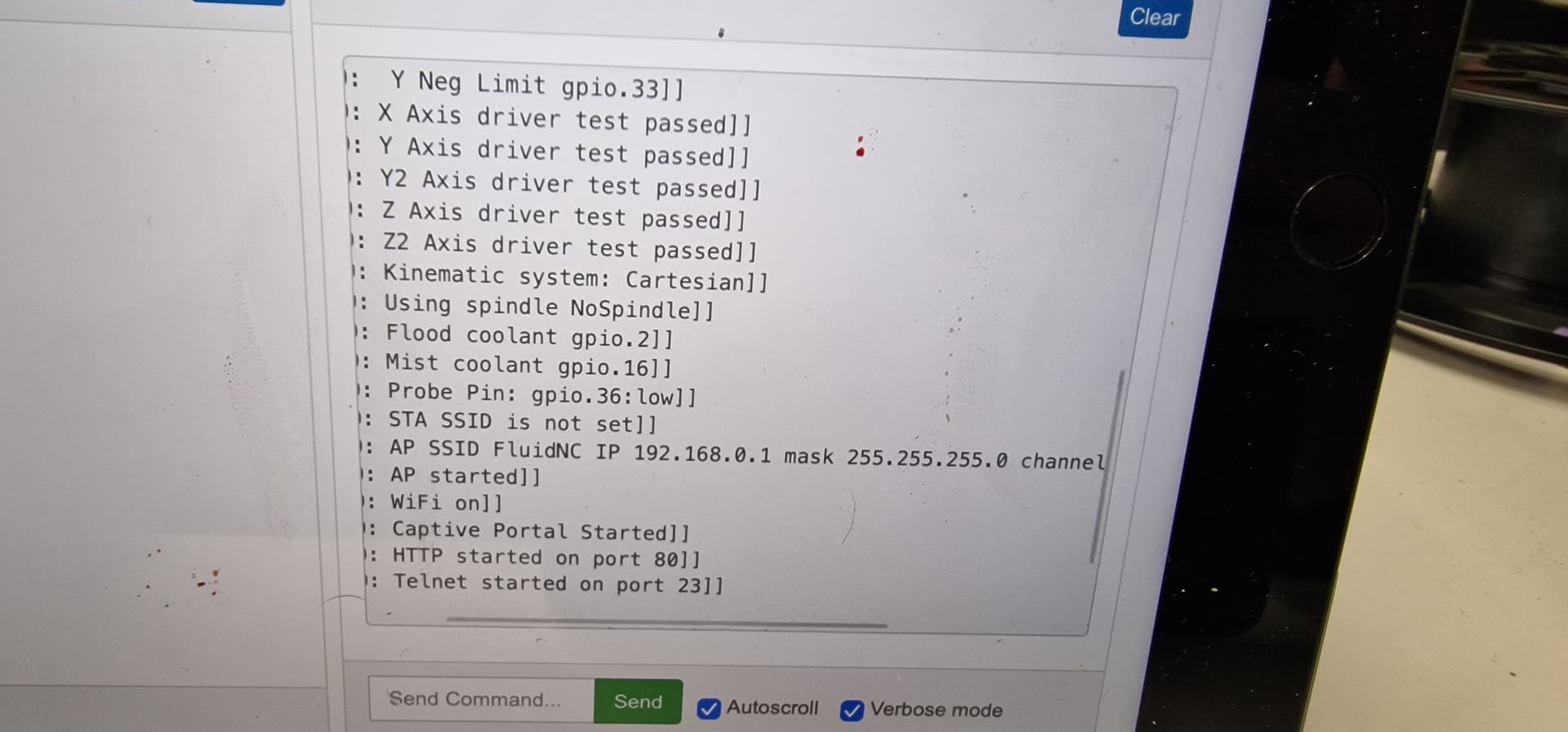

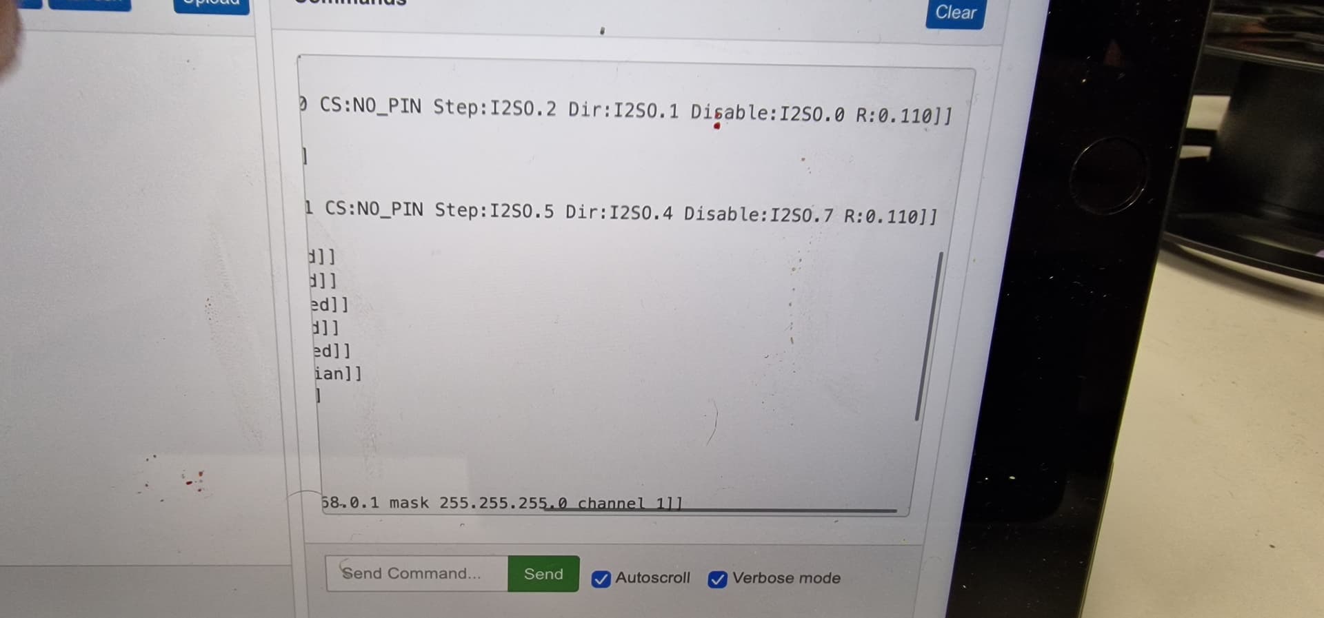

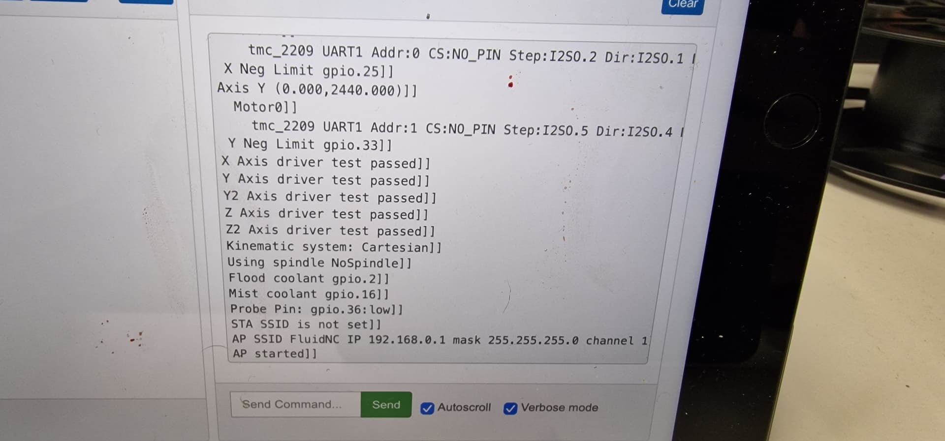

In the terminal type in $ss show us everything it says.
