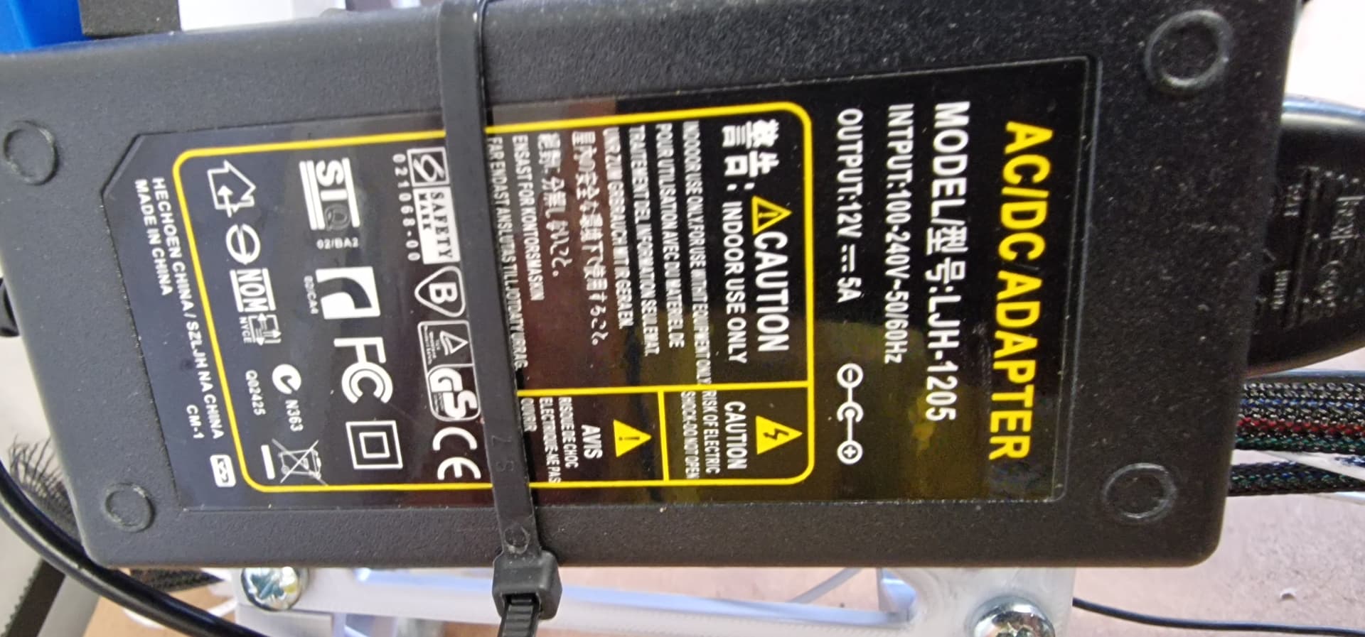

So I have now had 2 more stepper motors just suddenly stop working. They are fine one minute then just start making a load grinding noise while the end just sort of vibrates instead of turning. So far all the ones that have failed have been my old ones I bought a couple of years ago but I have 5 new ones and don’t want the same to happen to them if there is something wrong.
It’s all wired correctly and worked fine for a while. IS there some kind of power setting I need to change so I don’t damage my motors?

Could it be your power supply? What voltage and current is it supplying? A photo of how your board is wired up can be useful as a sanity check.

Any specific reason you used 12v instead of the 24v?

There is nothing else plugged in just this adapter. I used 12V as I had it lying around. I could try and find a 24V if that would be better.

24V might be a bit better as you’d have less IR drop in the wiring to the steppers.
