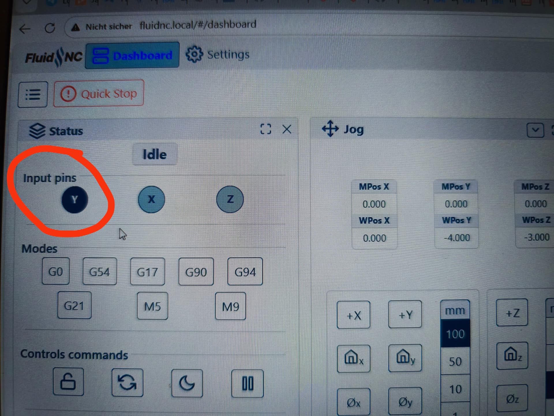

my new lr4 not making homing correctly. i see that the fluidnc gui shows Y switch always as “touched”.
i am sure i did all correctly, i even see on the board led gpio.33 on/off when i toggle switch.
i even changed the yaml.config exchanging gpio pins between X and Y…X=25 with Y=33…
still not ok… seams there internally some fluidnc problem. but this is too deep for me.
fluidnc is two days old, istalled version 4.0.1 webgui 3.0.9

solved… into built-instructions is was not very obvious that i have to mount TWO end-switches Y. in fact one was missing, after disassemble and installation all worked fine. i am able to make home-sequence now.
