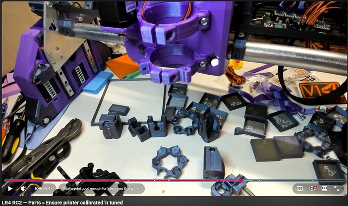

Cool! Minor thing, but consider laying out parts with mating faces to be oriented outwards to reduce risk of stringing artifacts interfering with fit. Still orientate same axis incase X and Y calibration is slightly off. For example…
Will research. I just use the auto-orient feature in the slicer (Elegoo/Orca). Should I do otherwise?
As long as its not auto rotating them you should be good. Ryan specifically says in the docs to keep default orientation.
Intentional layout can help reduce clean-up needed, and, avoid ending up with an unhealthy collection of Z Stubs and Nuts.
Agree. I’m not using my best words today, kinda bummed out. Am suggesting how to layout parts in (default recommended orientation like docs and Jonathan says) positioned and rotated around the Z axis such that stringing artifacts on mating surfaces are minimized.

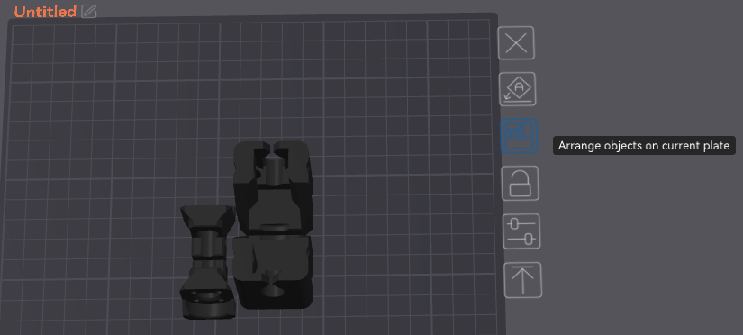

So then my question would be; do you recommend printing every part individually, one per plate? If not, how do I for instance add a z_nut, then clone it, while maintaining orientation? From what I understand, the only change in orientation the slicer software does is a horizontal rotation. It has never for instance rotated along the Z axis. I figured the slicer was optimizing the distance between objects for the printer…
Not at all. I put several parts on a plate
Make sure Auto rotate for arrangement is not selected
If you don’t have Auto Rotate selected then you are correct :partying_face:

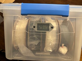

Just had this delivered, so having fun assembling my first dry box. Thanks again for the recs!

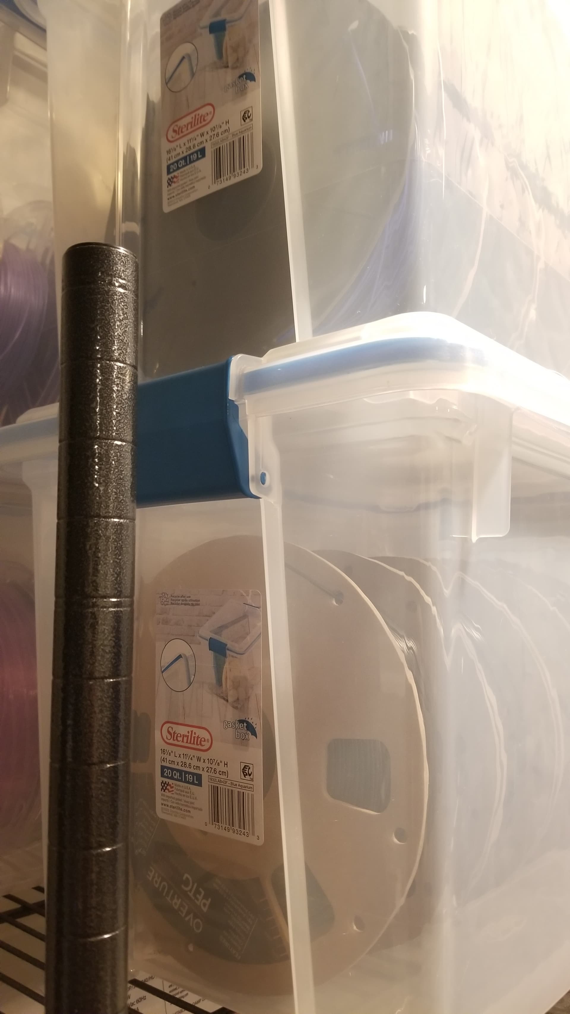

Nice! Personally like the gasket boxes too, picked up from Walmart online for $7. Can fit 4 and a bit spools. I leave “Rechargeable” desiccant in containers with hydro sensitive filaments. They’re not vapor proof, so still useful to have a spool dehydrator.
More deets? What containers do you use for your desiccant?
I am waiting for the Prusa Drybox to replace some of my IKEA dryboxes, at least the 8 to go with the INDX. :sweat_smile:
