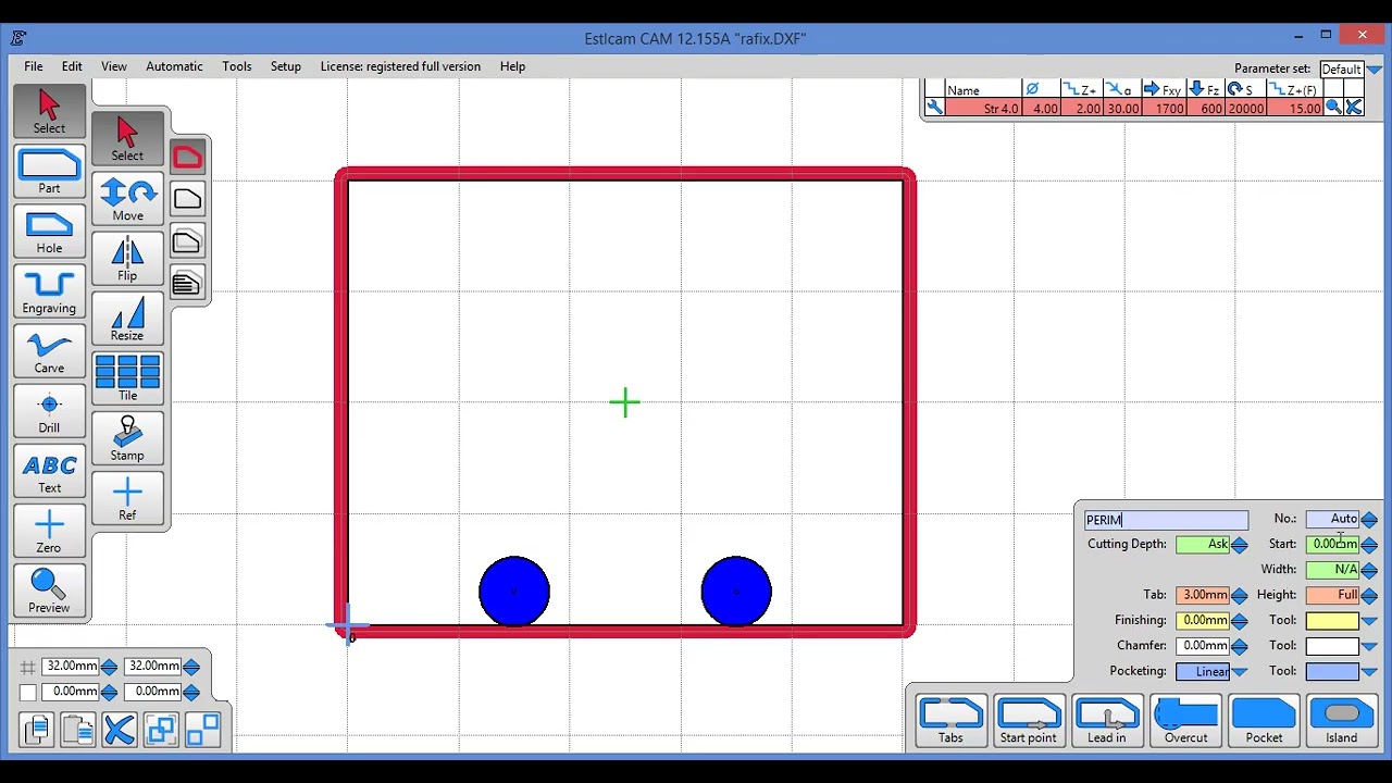

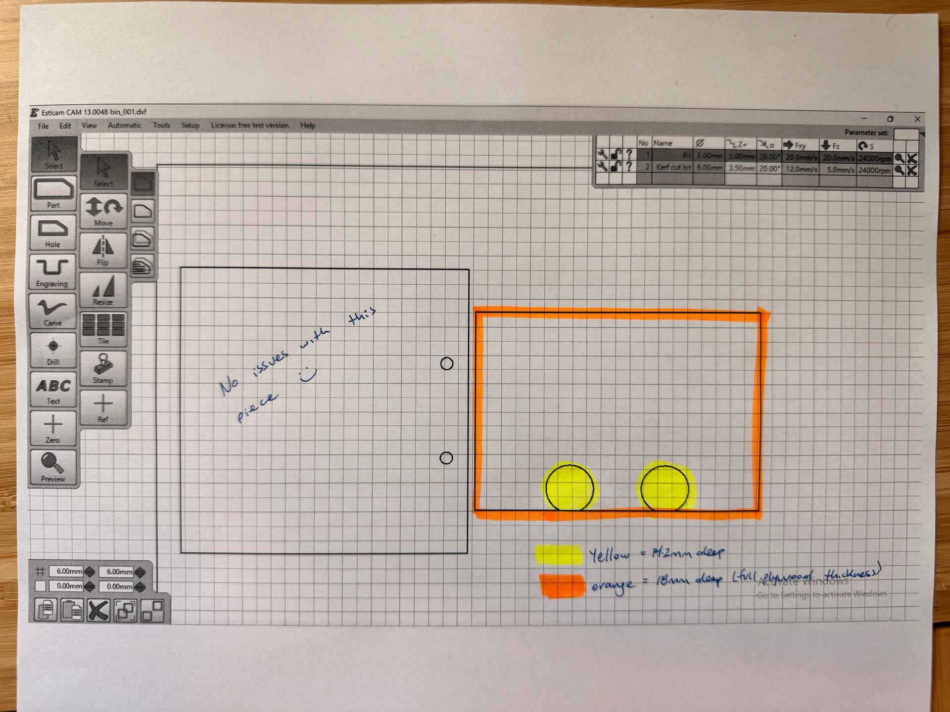

Hello, I’m setting up tool paths in Estlcam to use Hafele Rafix 20 connectors. Some of the machining that’s required is milling a 20mm diameter blind hole partway through the material (I’m using 18mm plywood, and the blind hole is 14.2mm deep). The blind hole is not a perfect circle, but rather a “D” shape.
Could you please provide guidance on how I can mill the two 20mm blind holes (yellow in the image below) at a shallower depth than the rest of the piece (orange in the image below)?
Many thanks in advance!

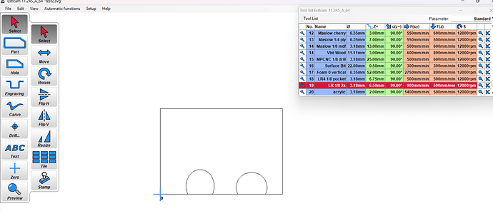

open your drawing svg.
Select your cutter first
select the hole tool from the left tool menu

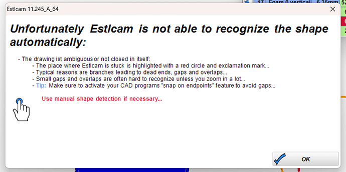

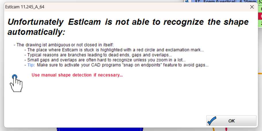

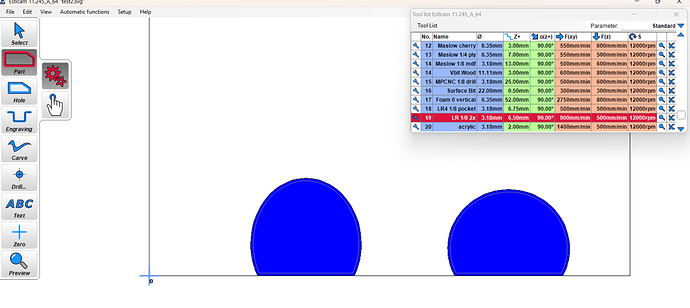

Click on your yellow-marked feature (one of the circles). If the shape is not joined, then you may need to use the trace tool, which is to the right of the hole tool with the finger and the dot.

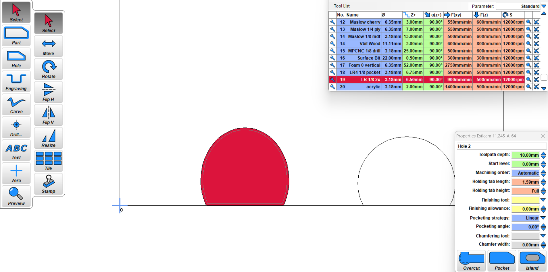

click on the circle somewhere and then move your mouse around the circle and Right click to have it follow the curve. The circle should be highlighted with the red cut mark on the inside of the circle. If you wanted to cut outside it, you would use the part tool.

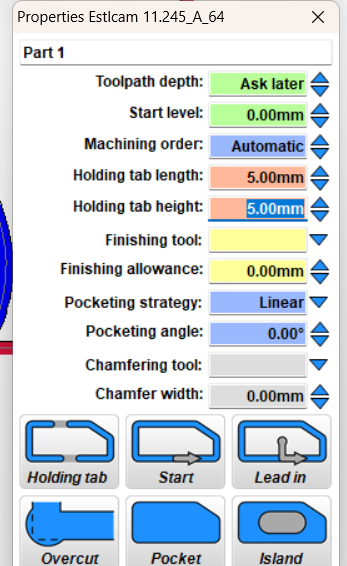

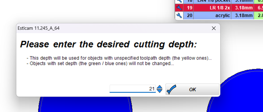

In lower right click pocket option and manually set toolpath depth. Repeat for the second yellow part.
Once the depth is manually set, the part will turn blue.

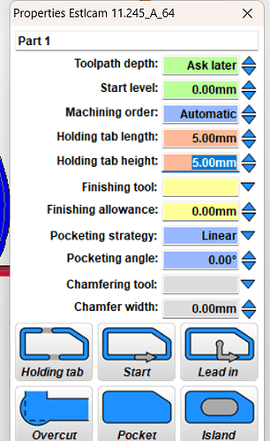

Next Select part tool. Select outline. Set holding tab length to 5 and height to 5. Put in at least 2 by clicking on the red line.

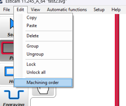

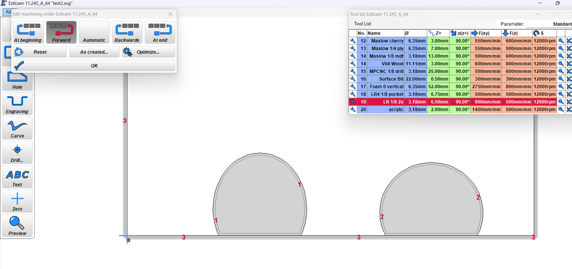

set cut order,
click on the circles and then the outer rectangle… it will number them 1,2,3

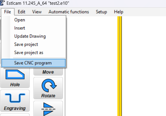

save the project and give it a name, then save gcode.
It will ask for depth when it generates the gcode. I always add 1-3 mm cut depth for through cuts depending on the piece.

For another perspective. I start with Create objects automatically whenever I can. I try to set path properties in the order that I want to machine them. Path properties always includes a meaningful (group) name (visible in Preview and G-code), machining priority, Depth and whatever else is appropriate (e.g. a finishing allowance and tool… and tabs, my bad). Note: A bug in v12 ( Dave Lers : Workshop : CNC : Estlcam : v12 : Issues ) makes group naming a PITA (one of the reasons I mostly use v11).
