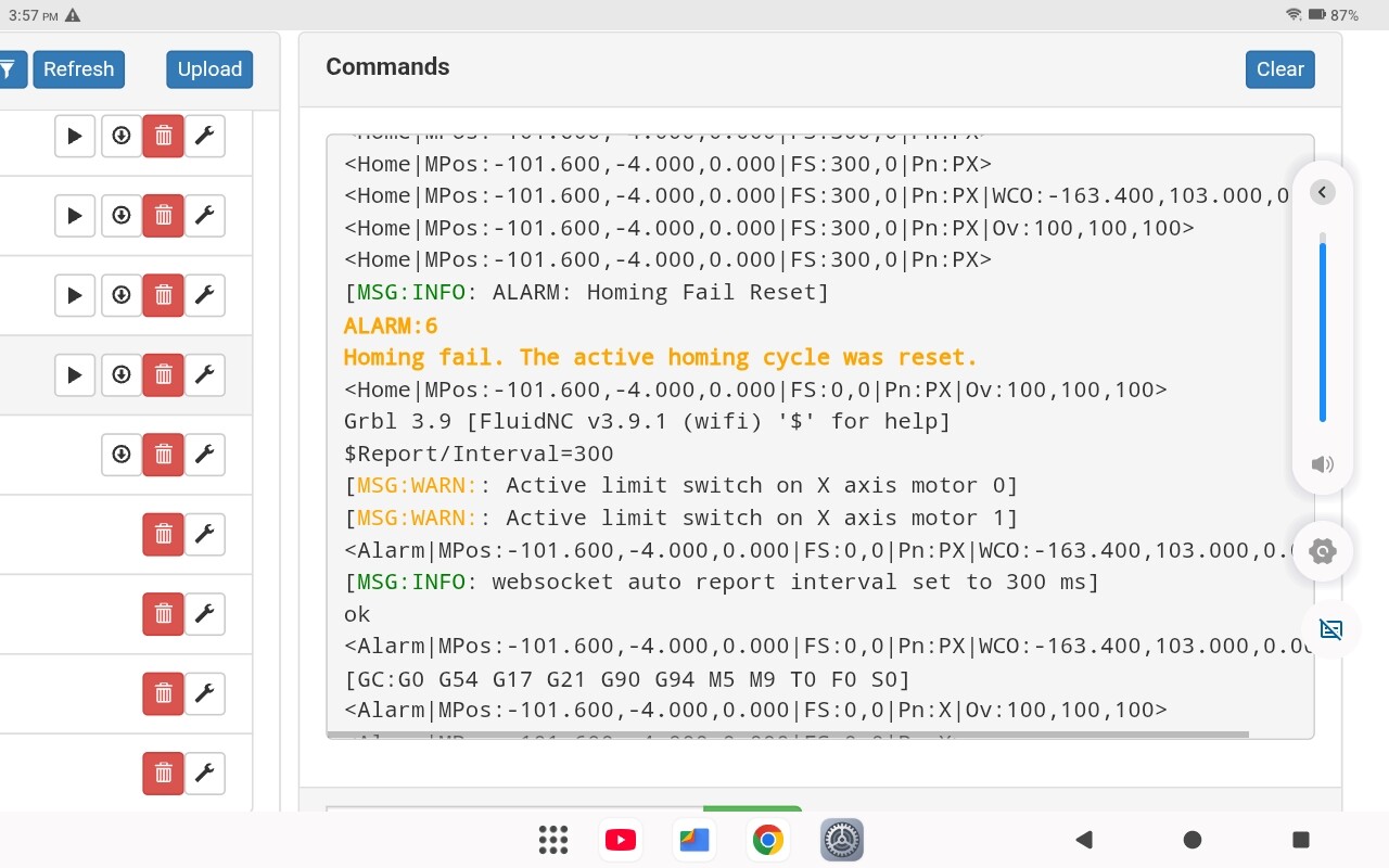

I’m having an issue when homing. I’m using Jackpot board. This is recently new issue. When the switches reach the stop block, it just stops. I have no control and have to reboot the board. All most always does it on X axis, and about 50% of the time on Y. I have checked the switches are engaging within 1mm of each other. Occasionally I’ll get an alarm that goes away with the reboot. I have not made any changes to firmware or any settings recently, since it started happening. I checked belt tension and I also checked the wires and plugs, everything seems to correct.

I did the $limits, only gave me X, and I had to reboot to stop.
The error I got when homing failed was Error6, “step pulse to short"
If that means anything to any one
Here is the Alarm: 6
Homing fail. The active homing cycle was reset.
<home l MPos: -101 . 060 , 0 . 000 , 0 . 000 l FS : 0 , 0 l Pn: PX l Ov : 100 , 100 , 100>
<home l MPos: -101 . 060 , 0 . 000 , 0 . 000 l FS : 0 , 0 l Pn: PX>

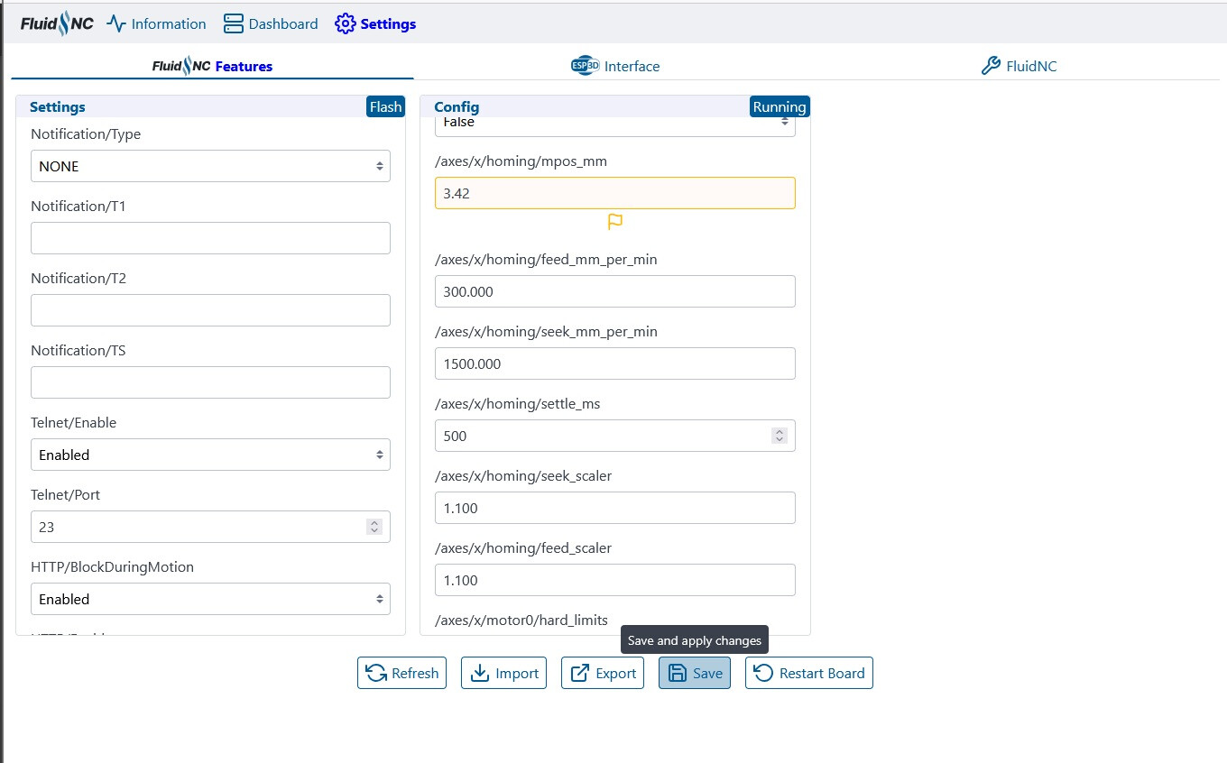

Solved:
I changed the following from 3.00 to 3.42 and works fine now
