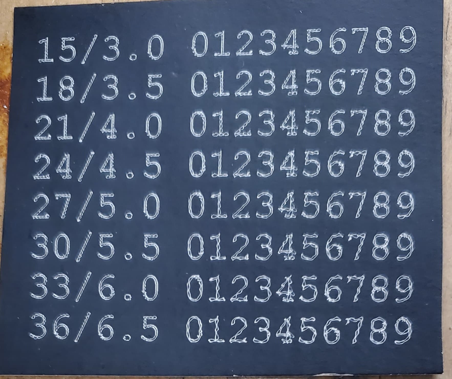

I’m trying to dial in my laser for engraving and noticed at small scale, my lines are wandering. The issue is a bit like backlash, and I am looking for any ideas that either fix the problem or any troubleshooting steps I can take to track the problem down. Here is my original test. The numbers at the beginning of each line are the speed in mm/s and the laser power used.
These letters are about 5mm high. I thought this might be some sort of vibration from moving around the mass of the Z axis and core so quickly. I replaced the Z axis with a plastic version (manual so no stepper) removing over 2 lbs. from the core. I also added some blocks to make my enclosure more stable. Here is the result:
I don’t see any improvement. The softness is my photo, not the engraving. I found just a bit of play in the Z axis and eliminated it and ran the test a third time:
Again, to me, no improvement. What is most puzzling to me is that it seems to fail in a repeatable/predictable way. For example, take a look at the ‘9’ on the end of the middle line from all three runs:
I can hardly tell the difference between run 2 and run 3. I went back to the cards to make sure I had not made a mistake and posted the same photo twice.
Any ideas?

I don’t really see much different in the speeds, and you’re not flying. You could try reducing the acceleration. But this feels like a mechanical thing to me.
Let me just dump some stuff you could try:
  1. Jamie’s test pattern generator draws a ruler in one direction and then comes back the other way. Which is great for backlash. You would have to add in some laser power settings: Test Pattern Generator
  2. Make sure there isn’t any numerical errors in the gcode. Look at it in ncviewer or something. I haven’t seen that many errors.
  3. Toggle using arcs. Either turn them off or on to see if that makes a difference.
  4. If it is backlash, it looks very small. Can you push the tip of the laser and see where it moves? You’re not interested in the flex. It would have to move 0.5mm or so with almost no resistance. This test can drive you bananas, because you will see things that don’t exist. But maybe you can find something that matches other evidence.
  5. Reduce the acceleration and maybe the jerk. Just half it, or quarter it and see if it makes a difference.
You’ve probably already made sure the tubes were clean, the bearings are moving smoothly, the belts aren’t stretched somewhere (like the fiberglass broke), the motor mount screws aren’t loose, stuff like that.
Tricky issue. I hope we can figure it out. It is gnawing on my brain already.
I’d increased the acceleration as part of trying to get tile burning faster. Currently a 4" x 4" takes two hours. When I went back to the V1 firmware acceleration settings, the problem went away. So, thank you for the suggestion to reduce acceleration. That leaves a number of open questions, and a whole bunch of tests to be run.

I tracked the problem down and now I think I understand it. This is what I get for playing with things I don’t understand. Acceleration, jerk, junction deviation are all new to me, and I only have a vague idea of what they do and how they fit together. I’ve been trying to increase my engraving speed, and I’ve gradually moved up my acceleration from the original 180 to 1200. But the problem wasn’t the max acceleration. I was playing with both M201 and M204 g-codes, and I increased the values in tandem. The issue is that I used M204 to set the starting acceleration too high.
In this test, the printing acceleration is set to 1000, and I increase the starting acceleration.
So, I assume that Marlin is fighting itself, wanting a lower acceleration but is forced to start high and come down.

But you could also switch to classic jerk and tune that. What is going on is that your moves are so small they are not even being accelerated. If you tune the instantaneous jerk/JD super low you will be able to tune accels a bit higher.
Good to know, though ultimately messing with the acceleration was a bit of a boondoggle. Since a lot of engraving is just long, straight scan lines, acceleration only plays a minor role in the time it takes to engrave, say a 4" x 4" tile. Using Lightburn to simulate the time, jacking up the acceleration from 180 to 1200 only saved me 6 minutes on a 2 hour engraving job.

It is more about getting the machine to START moving smoothly to get rid of your artifacts. I only tuned the junction deviation for slow routers. You should tune it for fast movements. JD is when it will consider accelerating, so if this was set to high it would not even try to accel and just slam around at every corner. With tiny segments at high angle changes they might not even get going fast enough to trigger an accel. If you go too low though it will try to accel on tiny angle transitions and circles will get messed up.

It’s possible, if you have a mass hanging off a cantilever, that it could be vibrating primarily by rotating (tilting) and not purely lateral vibration. In this case, adding a counterweight could reduce the vibration even if the torsional stiffness is not increased.
Assuming you can identify the approximate center of the lower-than-ideal torsional stiffness, you would add the extra mass such that the center of mass of the assembly downstream from the joint is roughly centered near the joint. Meaning it should be centered in the Z axis, to handle accelerating in X/Y without wanting to tilt. There is no need to center the mass around the joint in X/Y if you don’t have high speed movements in Z. Then the lateral acceleration produces much less of a torque on the joint, and therefore less rotational vibration induced from lateral acceleration.
If the torsional deflection (tilt) is the primary source, then good balancing could produce a huge improvement in addition to whatever benefit is gained from going slower or with lower acceleration.
You could also experiment with raising the workpiece and raising the Z axis which would alter the balance of the Z axis around the joint, and it would also shorten the lever arm so a given amount of torsional vibration would produce smaller artifacts. These effects would be combined, so it might not be obvious which mechanism is producing the benefit (assuming there is a benefit).
Yeah with a laser it is tough. It will be most stable nearest the center of the two XY rails, but increase focal length magnifies any issues. So the best case is like you say, laser as high as possible with the focal length as short as possible. So work on a riser to get it as high as possible.
The other way to look at it is for raster images none of this really matters with overscan enabled and just slowing down for Vector stuff also solves it and you will not lose hardly any time.
