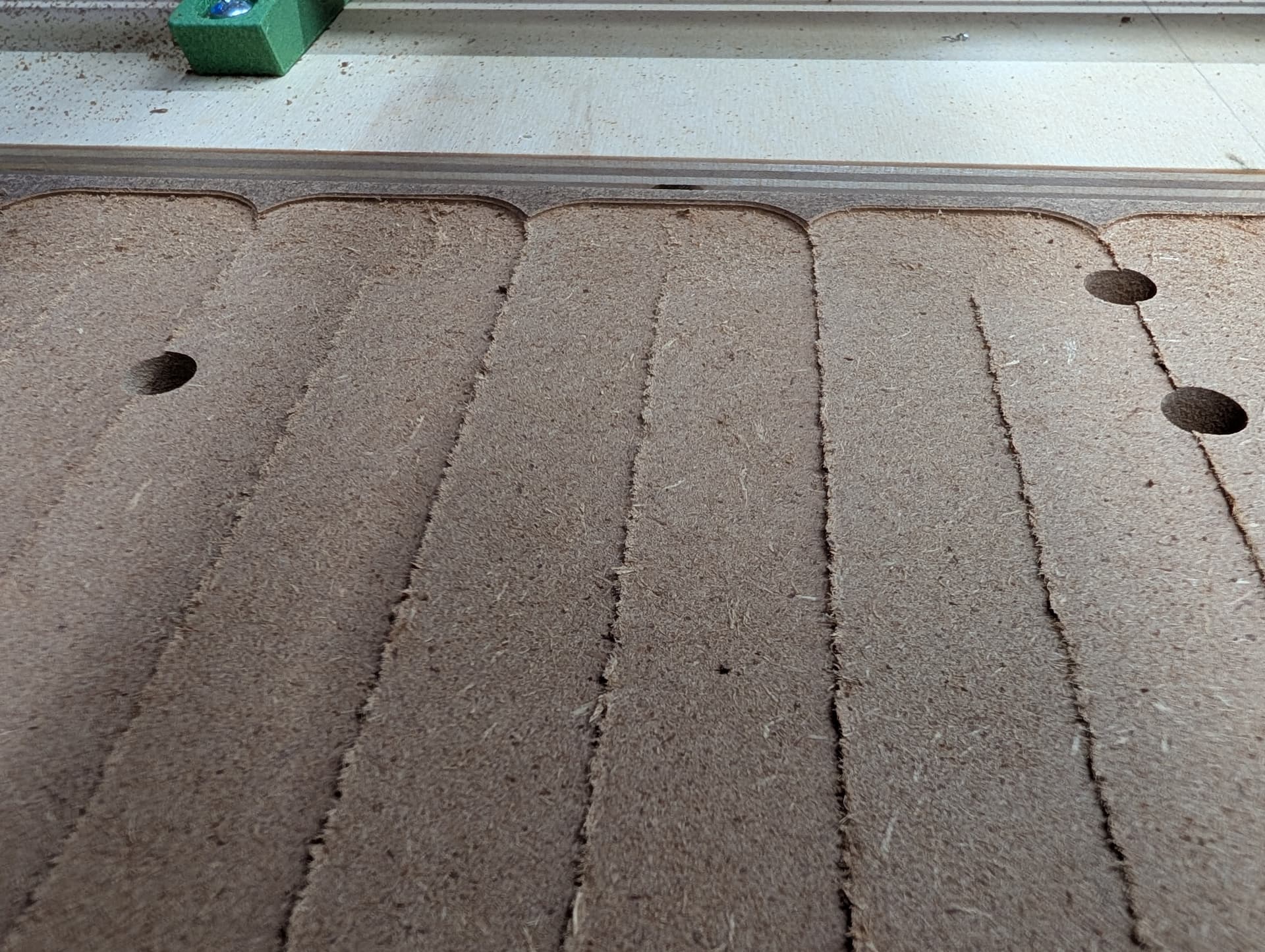

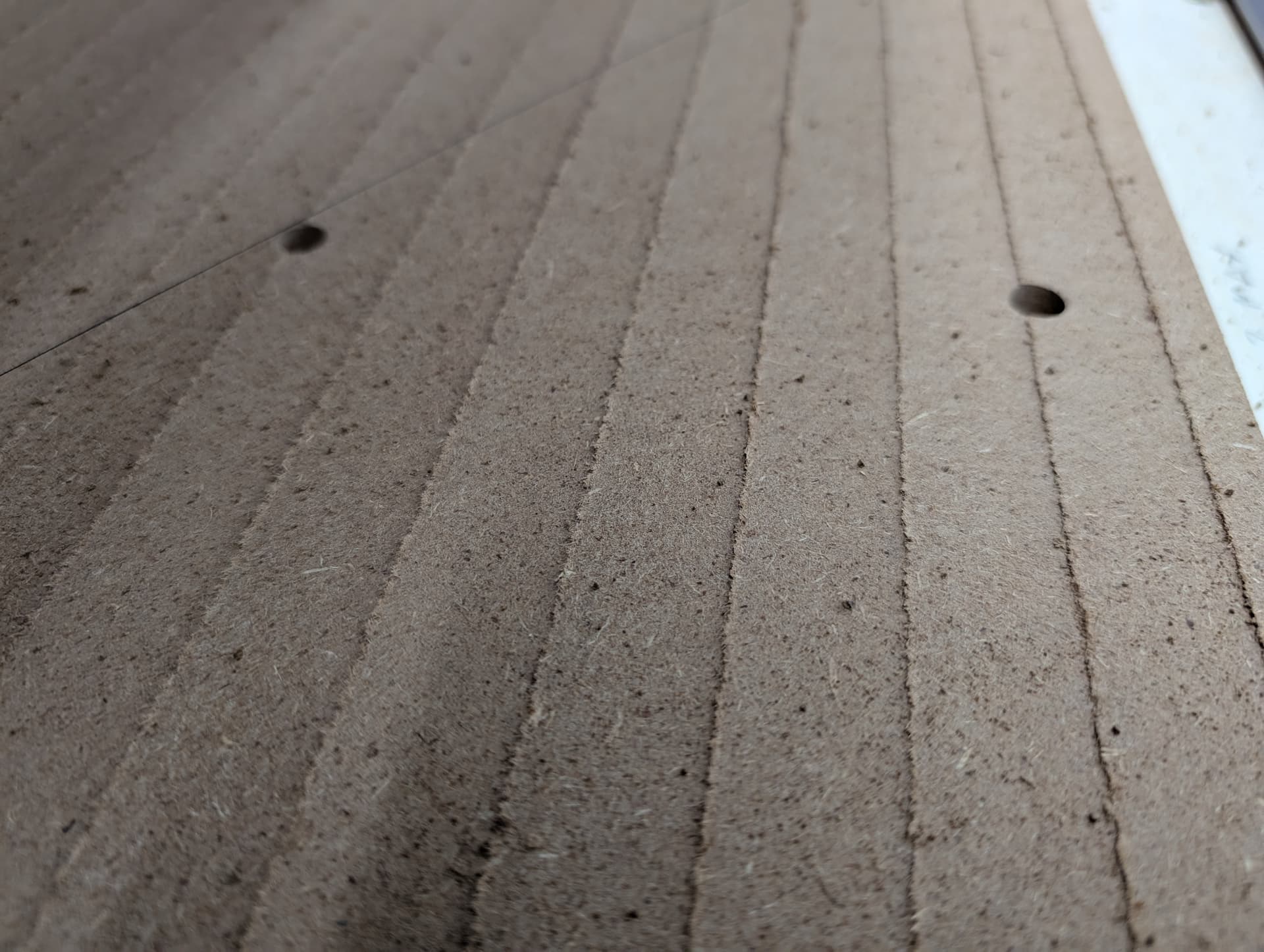

Does this indicate twist in my gantry, and if so what is the best way to address it?

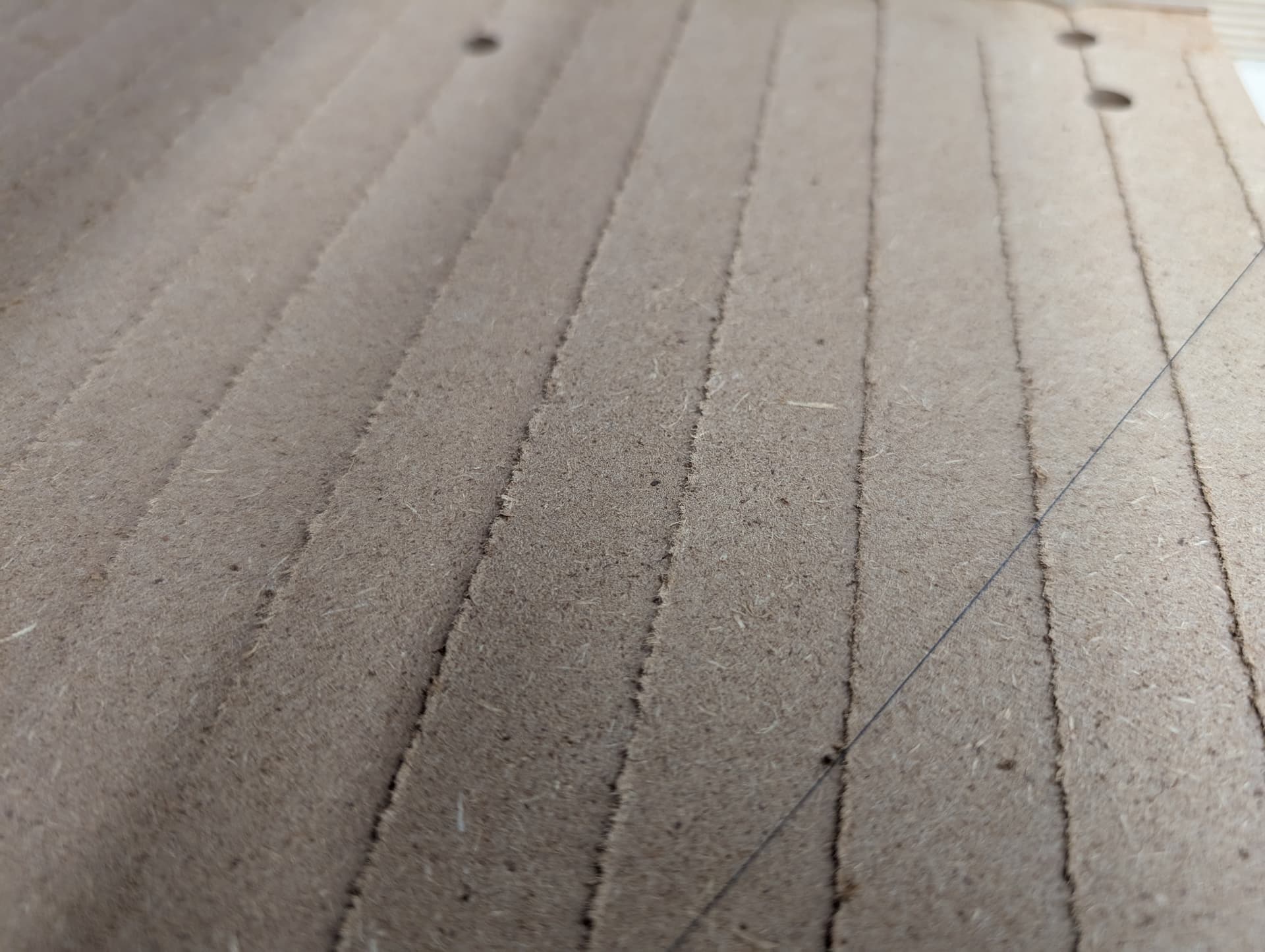

As the router goes from xmin to xmax, the sawtooth pattern becomes more pronounced, from barely visible at xmin to kinda crappy at xmax (it does cut deeper on xMax so perhaps that’s a factor too)
Looks as though it potentially gets skewed at xMax too (wider lines left)
I tested the table using cotton tied in diagonals to all four corners and looked spot on with the cotton lightly touching in the center.
What’s your step over? Looks almost like that’s leaving a track between passes.
Let’s use generalities.
If you see more of an issue with 1 side vs the other, its because your gantry and bed are not level in relation to each other.
That deeper cut will take your minor tram issue and make it more apparent as it moves deeper.
Tramming issues with core tilt will give an actual saw tooth pattern, which shows you which way the tool is tilted.
Once you have your level set, you will sees a consistent tram issue, and if you fix tram first you see a consistent leveling issue. Both are fixed independent of the other and i dont think it’s important which one you fix first. But you want to correct both issues.
It’s 22mm stepover with a 25.4mm bit, so wouldn’t be leaving a gap
Okay I’ll run another pass with a different stepover and see where things stand, I do see minor tram issues in the Y direction, I was just puzzled by the increase over X, but yeah perhaps it was just depth of cut on that first run.
Your tramming issue is the same allthe way across, its just more apparent because of the depth.

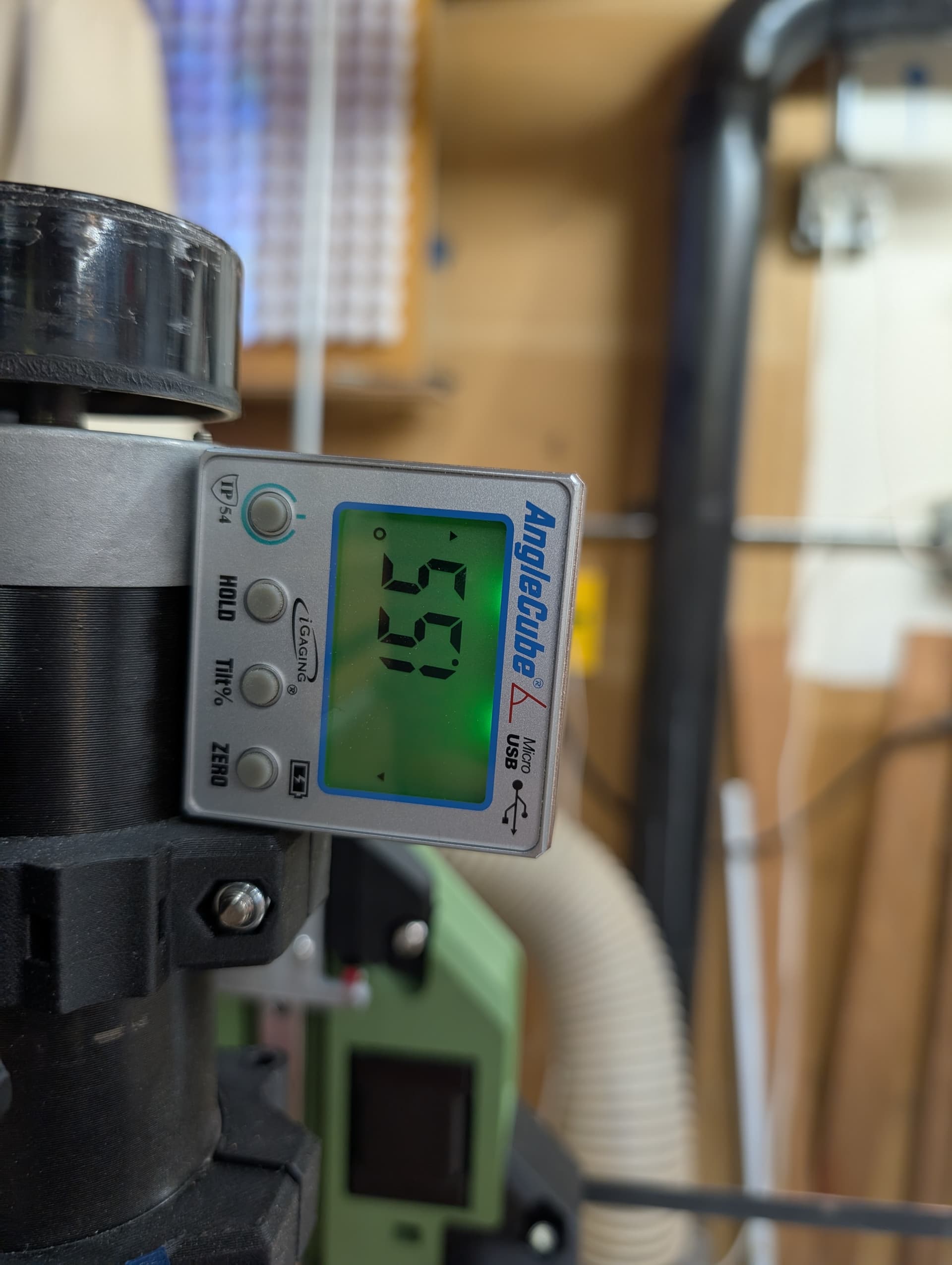

Think I’ve found my issue
So at xMin the bit is perpendicular to the table, at xMax not so much. I was able to reduce the error to about .5 degrees by loosening the three screws and twisting but having a hard time completely zero-ing it out.
Is it worth disassembling such that I can potentially rotate the plate a bit after loosening the eight screws that attach the plates to the blocks? Any other spots I can tweak?
You don’t want to check if the bit is perpendicular to the table, you need to verify the router/bit is perpendicular to gantry/plane of motion.

Perhaps but as you can see from the pics the spindle angle changes from xMin to xMax so there is definitely twist in the assembly somewhere.
I assume the bit should be perpendicular to the rail too, which it is on xMin (the table) but not no xMax (the rail)

Your diagnosis is correct. You have a twist in your beam. (Side note, I’m going to start using that phrase in conversation :smile: )
Somewahere along the way between the early LR4 beta and now there has been discussion about stopping to check the beam isn’t twisted before continuing on. A 1.5 degree twist in the beam is way too much.
I’d start carefully examining the side that is 1.5 degrees out of whack, and if you do take it apart I’d start with that side.
Neat angle measure. Maybe find and compare various reference edges on XZ plates and YZ plate to figure out where offset is creeping into overall assembly.
Since 1.5 deg is on the Max side with rail/pipe, and we’re assuming Min XZ assembly and Router mount are good and both 0 deg (and not perversely offset but cancelling out to look like 0)…

I’ve tried a lot of these digital angle finders and this one is by far the best, highly recommended.
Think so but will double check.
I loosened and retightened the strut plate while twisting the beam back to zero which has helped a fair bit, down to 0.5 out but will dig deeper too see where things went awry.
Needs a smidge of tramming but got the twist out, much better :slight_smile:
