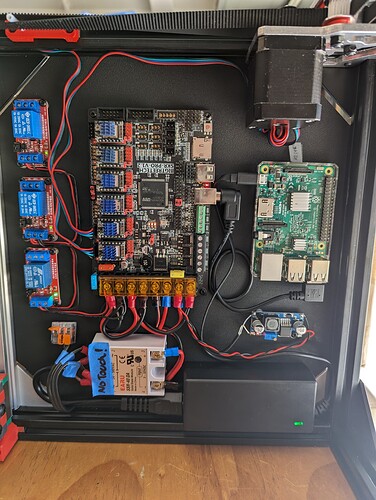

are the 3 relays for the Z Brakes?
yes…we’ll see how orob’s brakes turn out though.
Yours are just hooked up to the power supply correct? And no tmc errors on start up like @orob was seeing?
Orob and I talked about it earlier today, I was not testing the situation in which he was seeing the error. The Klipper reboot. Power up is fine for both of us but the reboot/reset seems to be faster than the relays, I have an idea to try but his solution seems more complete.
I have the Y endstop, bed and Z’s left to wire. Might take a wiring break to make the Y endstop mount I forgot earlier.
Okay I was busy packing bolts most of the day but I have the hotend/core all wired up.

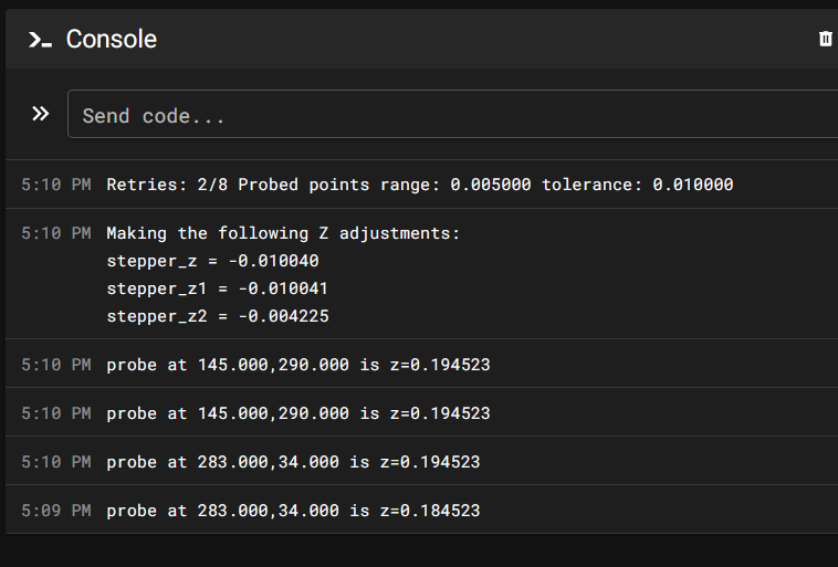

Update so far.
X & Y home and work great.
Z homes and Tilt Corrects…stupid good. I think having exact stepper locations is key. I have it sitting on a box (so the bed catch drop too far). It got within 0.005mm in two tries.
Mesh is next.
Aza, I tried doing 4 point measure and I hit and snag. My bed has diagonal corners high, and low. I let the 4 point tilt run and it could not do anything. 2 corners are high, if it moves on down (front right), it moves the other one up(back left). So it was stuck just continually probing making tiny adjustments and eventually failed to hit the tolerance. Only changed the settings to my three points and that is the first run from the screenshot.
For some reason my microprobe doesn’t like touch mode, I will keep poking at that. It triggers but errors out, so I have it retract each time and it is fine.
