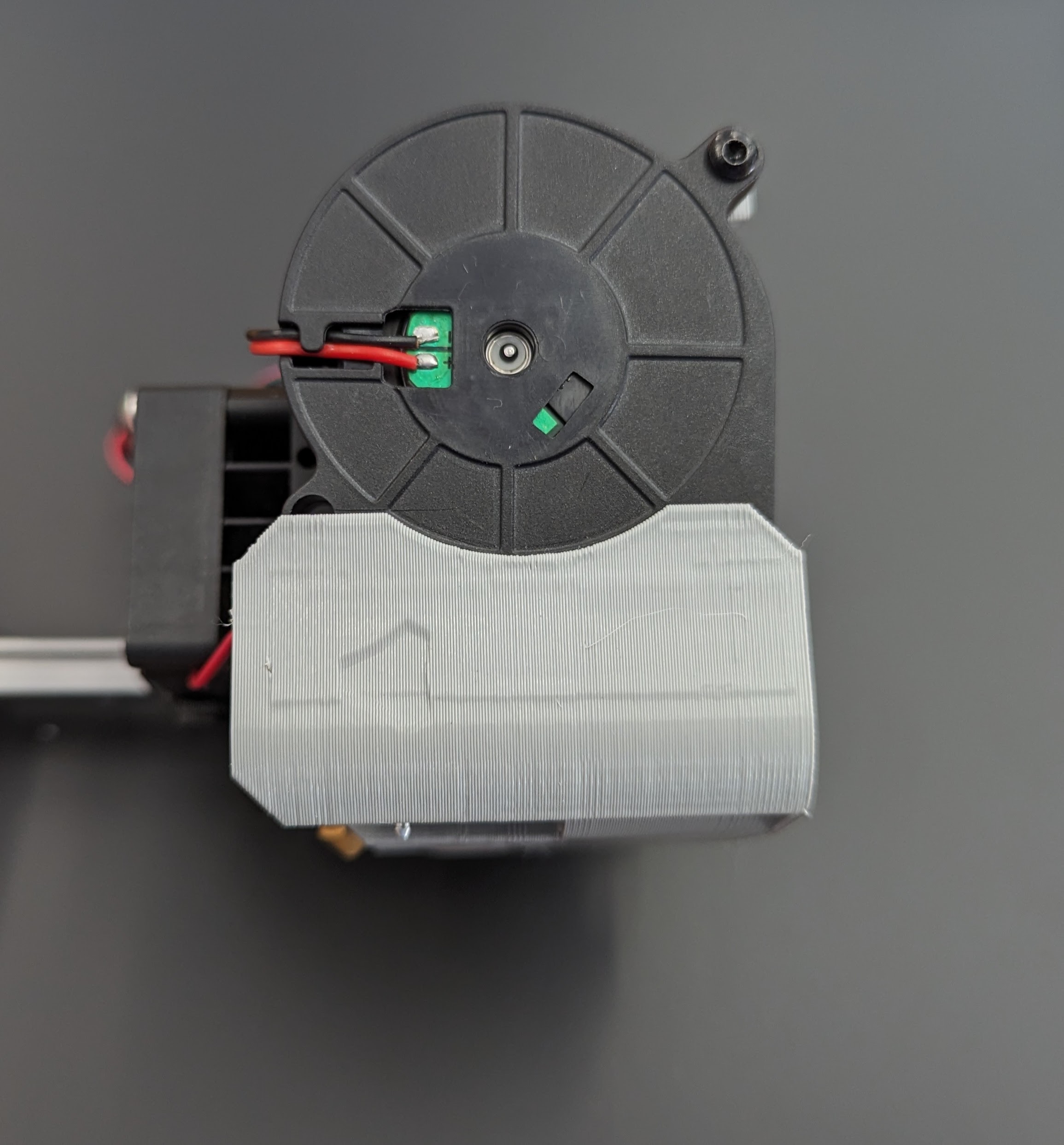

While doing that I made a bunch of tiny tweaks, Finally done with this thing. I will release it with the CAD once I prove/test the offsets are right for the probe and nozzle.
Getting a lot closer now, the screws finally showed up.

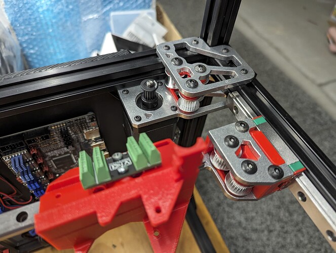

Had to tweak one of the front tensioner parts, new prints are almost done. Might even get some belts on this thing.

I have belts on one of the truck parts were extruded wrong, so they are reprinting now.
I have to say the belts are pretty good to work with. You can set them pretty tight even just by hand and they are balanced, then you take that centerpiece and set it in the belt groove, and it is perfect. The only part I needed to guide it a bit was the logo hole in the truck, the rest was surprisingly easy to thread through. I might be able to change that up, I need to take a look to see the overhang angle.
Not sure what sort of schedule I have tomorrow, bagging bolts and hopefully doing some XY movements at least…I am extremely pleased with all of this so far. The metal makes that middle X rails extremely solid, it has been a breeze to build.

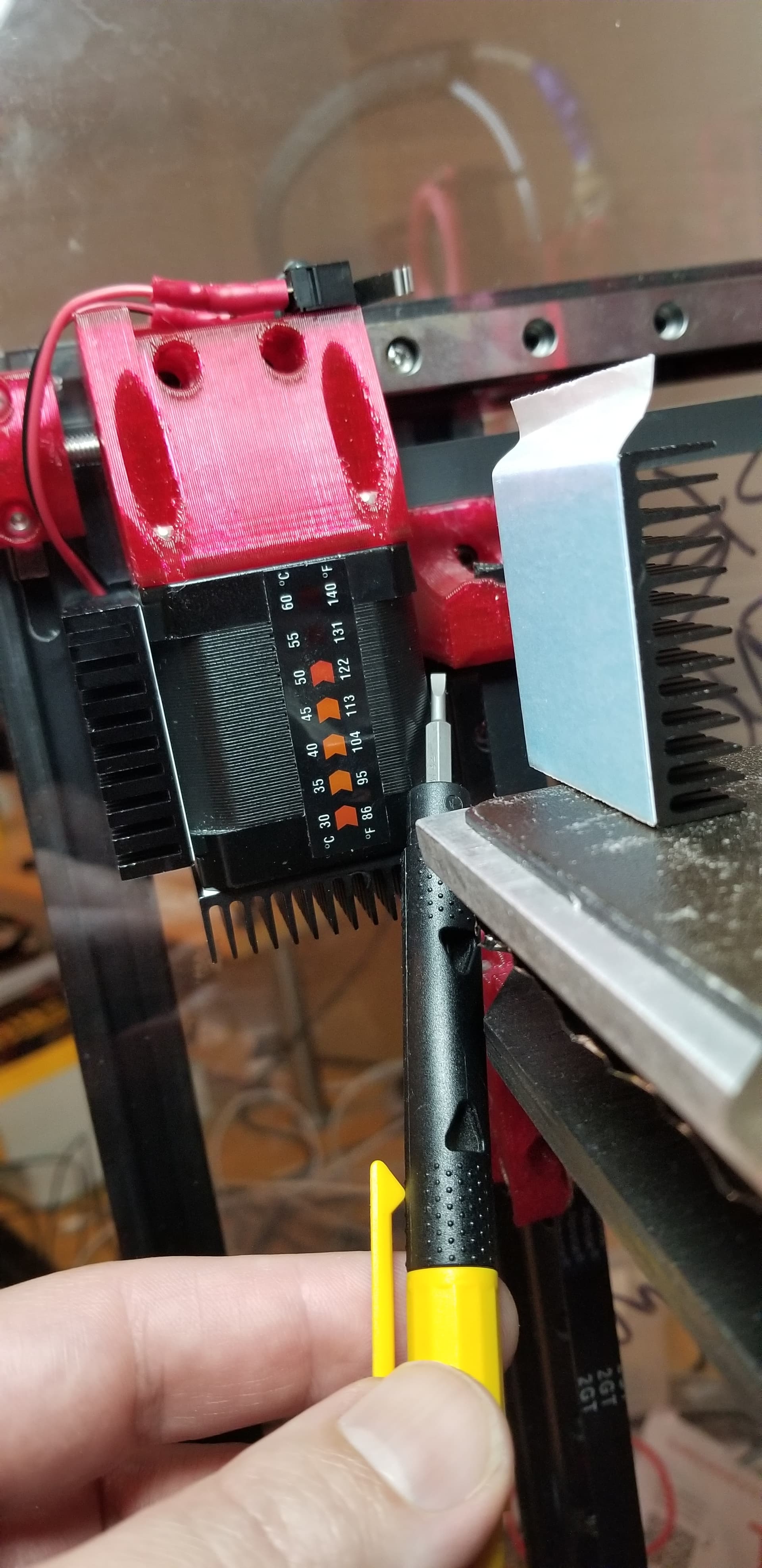

Before I forget again, didn’t check CAD yet, but hoping rear mounted Steppers have room for some heat sinks (40x40x12mm). The Alu mounts will be great.

If you print those stepper mounts in something other than PLA you should not need heat sinks, steppers can handle a lot of heat.
The new machine is mounted to aluminum so you can go hot enough to boil your bearing grease if you really want.
There is a dance between, mount thickness, stepper mounting screw length, frame mount screw length, and pulley position. I am using just under 5mm and that is as thin as you can go before you need to flip the pulley then you need to go much thinner. That depends on your stepper shaft length as to ho thick you can go. With my steppers I would not recommend less than 0.187" / 4.75mm.

I also tweaked that truck part again last night and reprinting it now, again, that should make installing belts simple.
Also added a bit more to the CAD.
