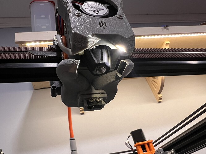

I haven’t actually gotten to print with it yet. But it did light up all the way to the nozzle. When I get back home I hope to get it printing and I can send you some video of it. Those little chips are surprisingly bright. I need to figure out how to separate the control of them and dial the logo one back some it was way too bright even at 50% lol. I know it’s easy to do in klipper I just have to remember how lol
If you can mount the leds far enough out and at the right angle you should be able to light the nozzle easily
Crappy pics but hopefully gives you an idea
Okay I don’t hate it.

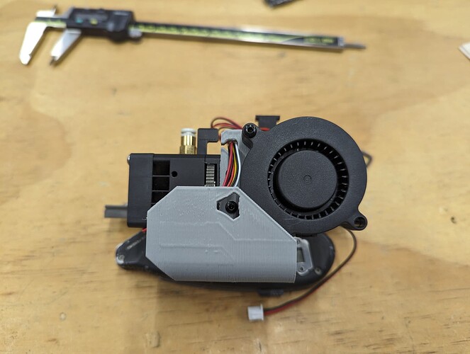

I have the BLtouch already mounted right there (at 90 degrees with the cables on the right instead of up front. The mount is a bracket that goes between the fan on the left and the hot end cooling block / heat break just behind where you have it.
EDIT: I mention this because you could use your fan mount and optionally just print the bltouch mount that already exists and you wouldn’t need to add anything to use your mount with it.
like this:
Looks workable to me.
I can make it separate. Do you have a link to some BL mounts you like?
I started making them separate for this reason, but the second set of screw holes are just too close to the vents to really use with a printed part.

This picture seems to have all the cooling vents pretty blocked.
Point the LED inside the fan duct for the cooling fan. The light should bounce around and shine out the openings on the bottom at the filament.
Also, I agree. I don’t like the idea of the additional faceplate on the front of the mount. To me, it just makes it stick out the front farther.
That is a good idea, there is room to add one there, I have a few I can drill into to see where the light actually comes out. I try to design those so it does not blow on the heat block though so I still think it will be a nozzle shadow.
This one does add 1.3mm. Do you think it is worth it or no? I really can’t decide.
The last pieces of this puzzle for me is if I need to add some guide channels internally to evenly divide the airflow. Hard to tell but I think a majority comes out the far side. That might actually be a good thing.
That’s not too bad. I know I had to redesign the fan holder on my v4 to save 3mm so it didn’t hit the front door on my enclosure.
Maybe provide two versions. 1 “nice” and 1 “slim”
It’ll be interesting to see what happens. I’m hoping the light comes out more than one hole and helps cancel out the shadows.

It should be fairly easy to edit the CAD for my fan setup, but the printer mount itself should be the same, so you are able to use other fan mounts and stuff if you would prefer.
Looks like the Revo nozzle is 3mm lower than the non Revo.
interesting how the basis line for measurements vary from one version to another…
It is higher than the Lite version though, in terms of the printer itself no changes, you lose or gain a few mm. The fan mount is where work is needed to change those 3mm for the probe, and a easy tweak for the duct…or use a premade one.

Mount for a bl touch that sandwiches between the fan and heat sink.
Make the mount holes on the fan to be slots and then you should be able to get the 3mm difference just in where you tighten them up.
Are you concerned about losing the travel on the right side of the machine with the fan stick past the extruder? I find that I never use the gear on the front on H2’s Plan to cover it with the fan when I figure out how to design a damn duct.
