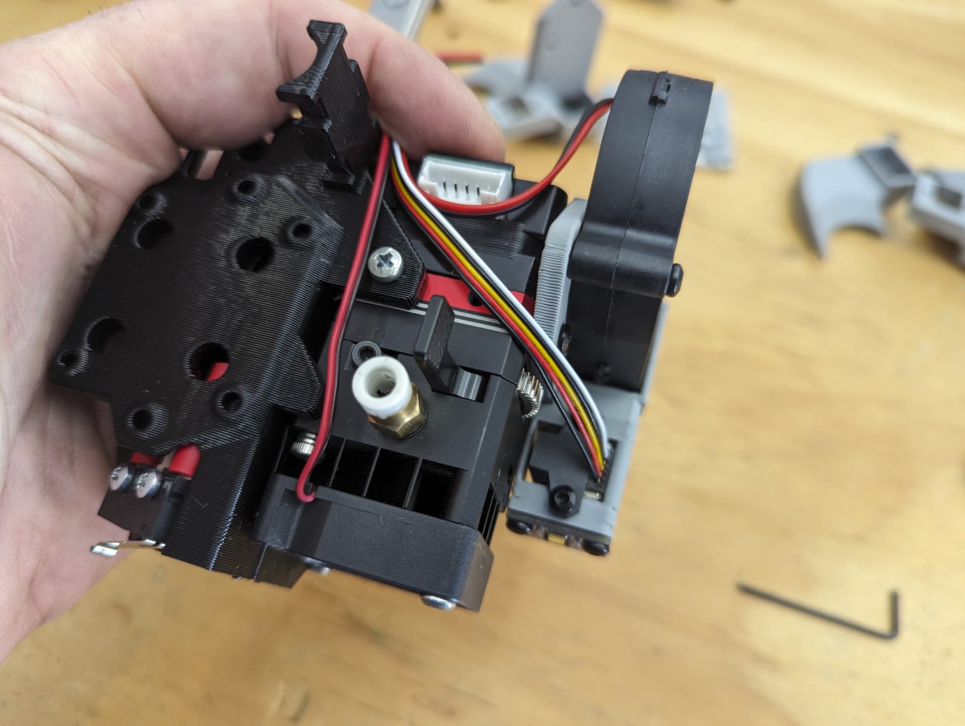

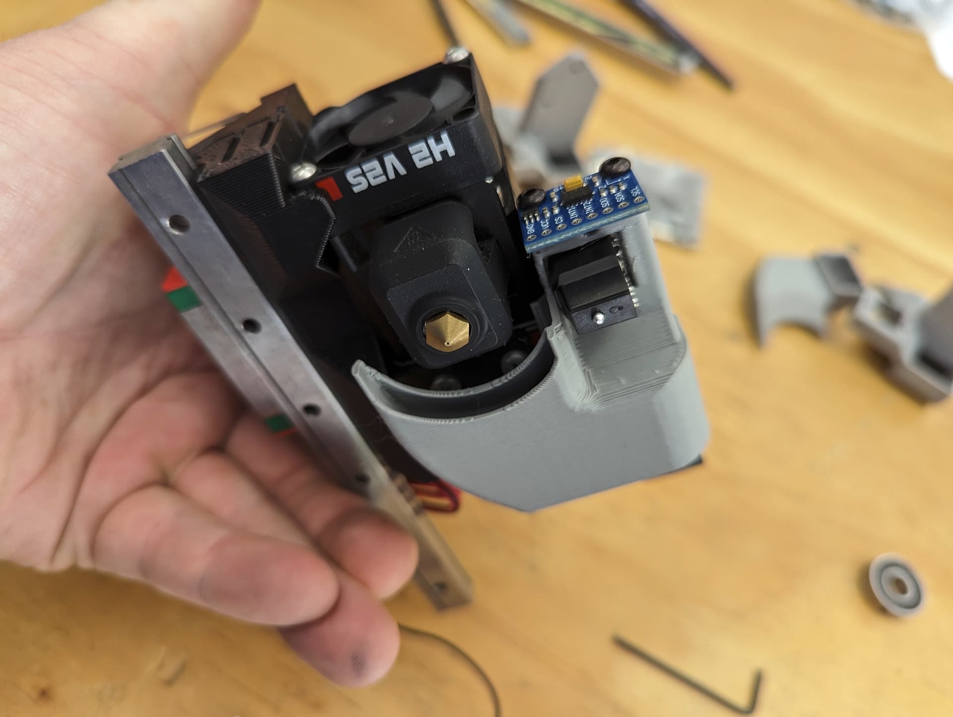

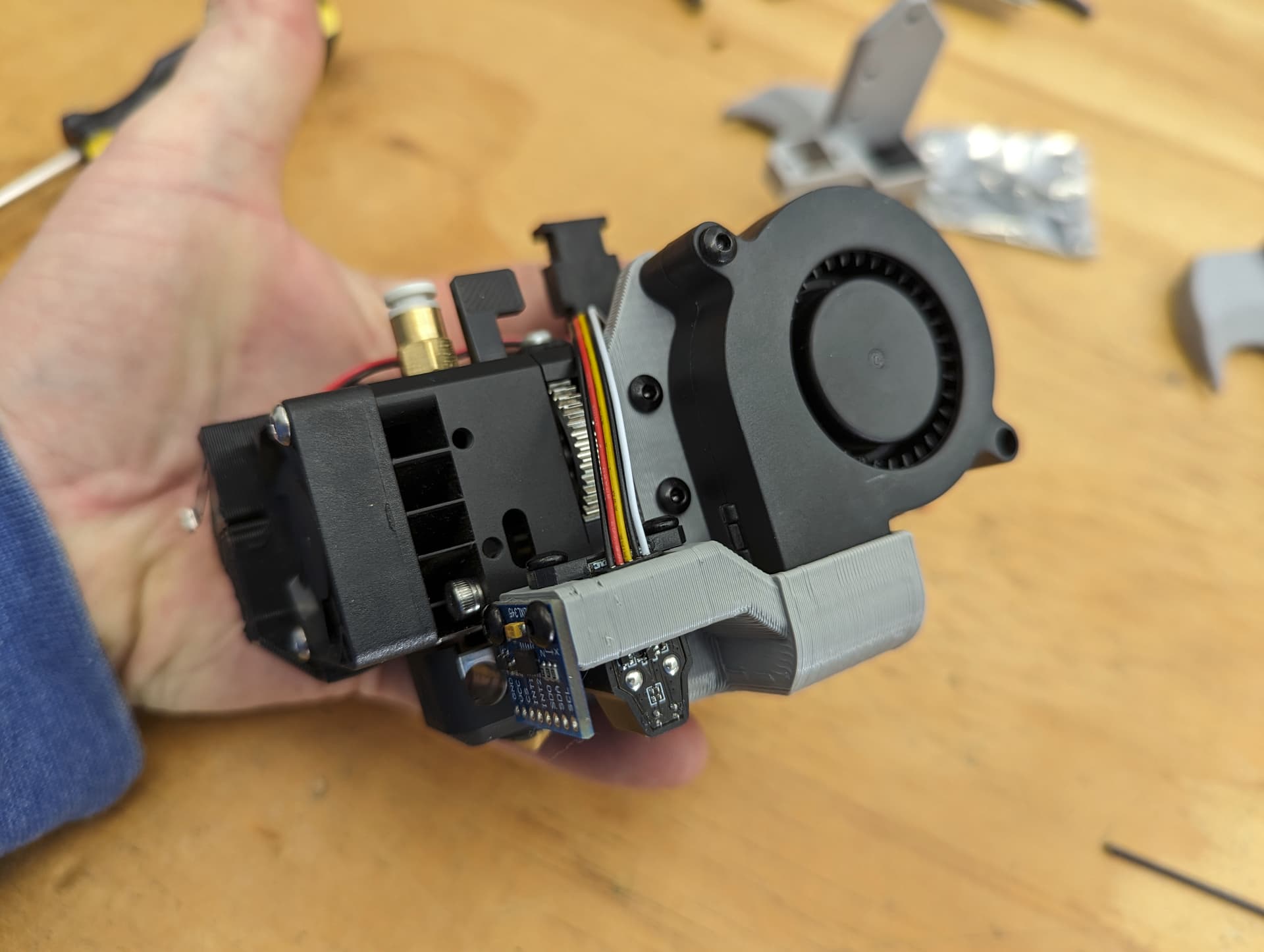

Well…I splurged and bought all black hardware. If you see them, I have a couple bags of black pulleys, could not help but get some black screws.

#   - Extruder-HotEnd : BIQU H2V2 (lite?) Extruder
#     - Thermistor Type : Semitec 104NT-4-R025H42G(NTC100K)
#   - Probe : ANTCLABS BLTouch Bed Leveling Sensor v3

So minimal H2 cooling, probe, accelerometer?
I can add a little fake wall to hide things more,
Once I get this one dialed in, I can make it work with the Lite version.
I like it. The one on Ernest (v4) is leaning forward 45 degrees toward the user so it doesn’t hit the machine frame, but it sticks out the front of the machine. Will an original BLtouch fit in that mount? I may print one for my current setup. it looks good
No, I did look at it but it is soooo big. This extruder is tiny. That gear is right there, and the vent is on the other side. It would need to stick out further and probably be turned sideways.
The throat screws would get covered as well.

I couldn’t figure out how to make a more symmetrical aggressive looking hotend (like stealthburner) for my setup.
Being able to easily see what the nozzle’s doing is helpful.
What probe did you end up with? Did you tear down a BIQU MicroProbe V2.0 for H2 Series Extruders Ender-3 B1 3D Printer – Biqu Equipment, or something else?
Yup, that is the probe.
It goes against everything in my head to add things like walls just for looks, sometimes it does really add a good look though. I made a little one, going to give it a quick test print.
I have tried a bunch of times I can never get a light very close the extrusion, the nozzle is so close the heater block gets in the way. LED’s could work on the Lite, HF version since the heater block is so large. I don’t think I will add them there, though. Surely add some to the frame, the status indicator is pretty nice.
Have you looked at using LEDs like these??
BTF-LIGHTING SK6812RGBW(WS2812B… Amazon.com
There are 3 of them in the tool head on my E5+. 2 pointed down at the nozzle and one up top behind the logo. Really nice easy addition. And it turns out I have PLENTY left over lol
Can you actually see the extrusion, or just near it? The heater block always seems to cast a shadow. I guess I do always use some sort of heater wrap so there is even less room.
If I can’t light up under the heater block it doesn’t seem to be worth it. I just look as it moves. More wires, more stuff on the moving head is the last place to put stuff. If it can be lit up from the frame, that is much better in my book.
There are some pretty tiny LEDs out there, you could also build in a spot for a light pipe/fiber optic source, something like this:
https://www.digikey.co.nz/en/products/detail/bivar-inc/SMFLP5-21-7/3101216
Ignore the price because there are vastly cheaper options, that’s just one that looks like something I’ve used before.
