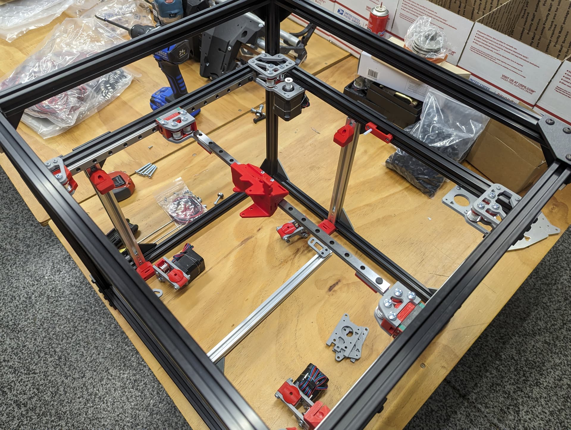

So far so good. It would be easier to have all the parts on hand while assembling but I could not help myself.

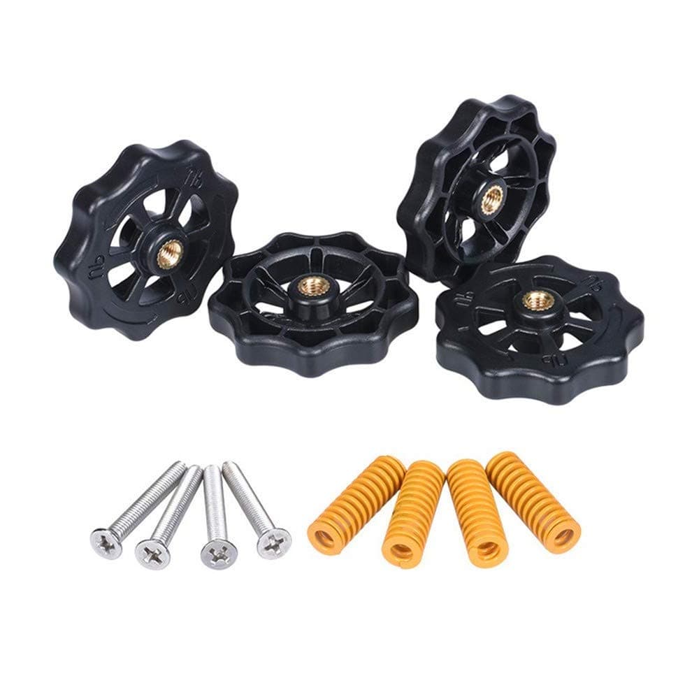

Using the leveling springs you sent me last year for my v4 bed. Reasons… Manually fine tuning bed after first ever XYZ home helps reduce how many attempts and overall time Z-Tilt takes for EACH print. Just manually leveled using by sliding paper between nozzle and bed. Also, am hoping ever so slightly springy bed might help reduce bed/nozzle damaged if/when unwanted contact/grinding happens.

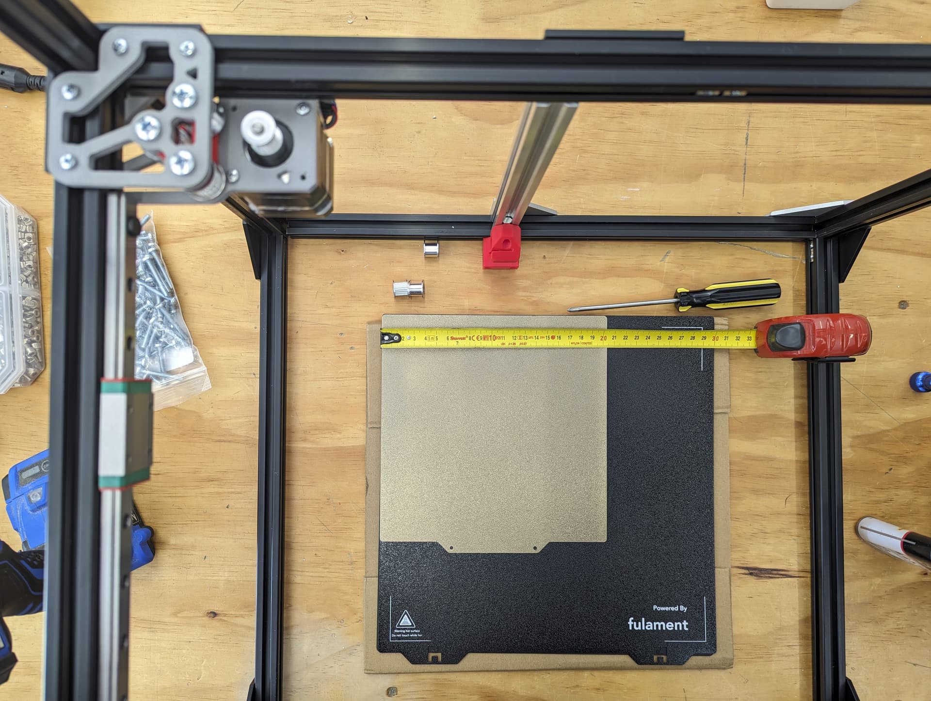

Since my v4 is a 300x300x400, would it be considered bad form to make a v5 that is 200x200x200?
oh and is the aluminum spec’d in this for the plates 1/4" or some other thickness? Any idea of the surface area of a piece needed to cut them all out? 6x6" or 12x12? Just thinking of gathering some and interested in ballpark amounts. I’m also curious about acrylic instead of aluminum unless that is a bad idea.
To me 300x300x300 is the perfect size. My V4 is 300x300x400. And I will still build the V5 at 300x300 for sure. I only have one printer under 300 and it gets the least use because you can’t fit shit on it lol. Yes I know I can and still use it but it’s just not as easy. It’s all in what you are used to I guess. I am also curious as to what you find ridiculous about it.

It seems sooooooo big, like not even close to the 200x200.

I could see 300x300 seeming big when all the others you have are 200x200. I guess it just seems normal to me lol

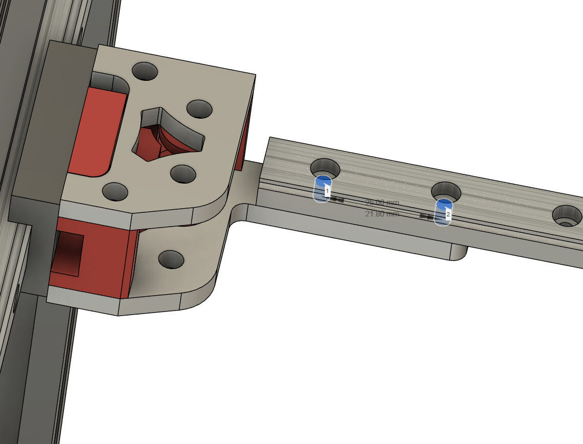

I found a mistake. Or a bad assumption.
These 4 screws are not M3x10…I am not sure why I thought they were. They need to be M3x12-14mm Grrrr. It was so perfect before that.
Making the nut holder now.
You’re talking about the bolts that attach the linear rail to the aluminum plate? If we threaded the plate then 10mm would be more than enough correct? I know you don’t want to make that a have to but I’m thinking anywhere I can I would like to do that on mine. Just seems like it would make a lot cleaner look
Yes but it kinda needs to be a slot.
A slot means the build does not have to be as perfect as the V4 had to be.
Although I have learned, cutting all the extrusions 2-3mm short means building it perfect is pretty easy.
Well, it’s double the print size.
Oh, and FWIW, on my v3, I use a 7×7 probe grid for mesh level, and it’s the same size squares as 5×5 on a 200mm bed. (50mm squares) and almost double the probe points (49 v. 25.)
I found that the 50mm spacing is still about right for a good first layer, something to consider for firmware config on a 300×300 build. I got some issues in places with a 5×5 grid mesh level. The G29 operation takes longer of course, but it seems worth it.

Waiting on Z linear guides, so I started working on a H2 fan and probe mount.
Might start wiring up a board to get klipper started. It also might be good to figure out where it might be good to add wire holders. For this one I think I am adding the board on the right back panel that is where the hotend wires and bed/steppers will end up so close and easy.
