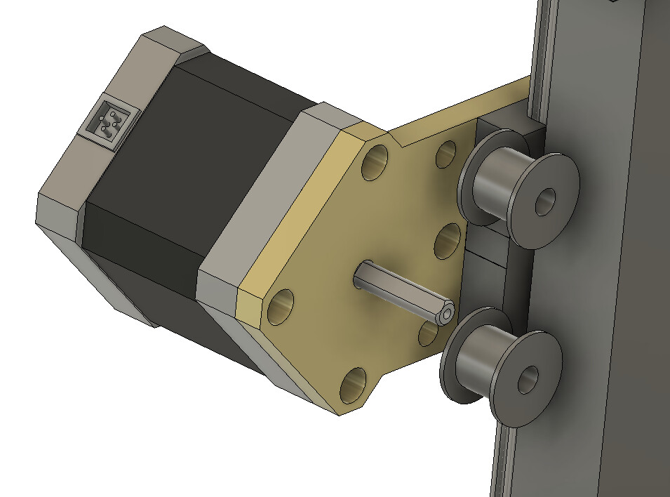

For my laser, it didn’t seem feasable to get 1.5m rails, and the OpenBuilds carriages were inexpensive, so I decided to try them. I have 2 of those carriages and 1 of the Ender style ones and they were pretty easy to get moving smoothly. The difference in cost was much bigger dealing with a couple of 1500mm and an 800mm rail.
So far, so good. I think I can do better with alignment of the motor pulley with the belt inside the extrusion, sometimes I can hear it touch the sides, but it hasn’t caused skipped steps at all.

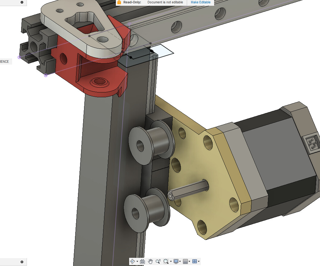

I’ll report back on the brakes… Z motors under the bed is ok with me. I’d rather have them on the floor so they don’t move, but the v4 is working. I have had the belts seat into the end blocks over time so they loosen and then if they get too loose. The motor will skip. The z-tilt auto level is fabulous though.
Not a fan of the make your own plate thing for the bed holder, but only because I have not done it. I’m using extrusion for bed support and don’t like it either because the bed mount is wonky… Has to be a cleaner way.

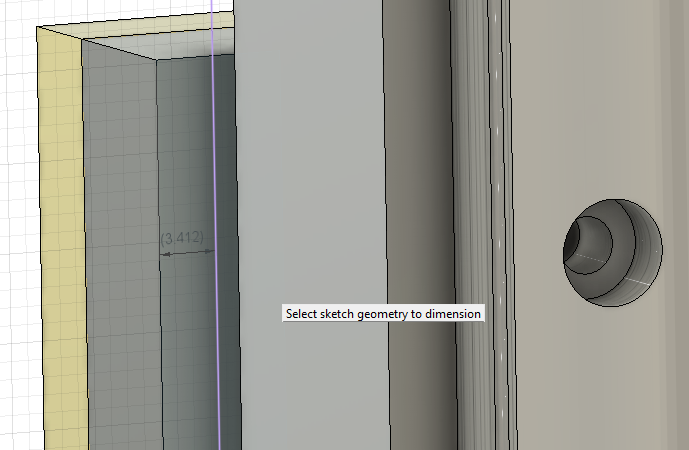

MGN12 Rail block would be proud by ~3.5mm, easy to cover or live with? For 1/4" panel could route channel.
MGN9H rail block would be flush.

CNC 4mm deep channel in 6mm ply should be ok? For Laser cut, could do full cut slots for where the rail blocks slide, then, if full enclosure wanted could 3D print/CNC/Laser cut patch plate/cover.
Or, with MGN9H for Z linear rails, the rail block will be flush. Adding layer of exterior silicone/VHB tape before fastening up panels might provide enough of a clearance gap.

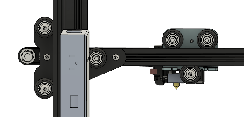

Just gonna put it out there that you want three wheels on something like this, and one of them should have an offset cam mount in order to make it adjustable. Otherwise, that’s a good plan. (The Mini V wheel gantries that exist use four wheels, 2 adjustable, but I found that three is much easier to adjust with my laser build.)
This is how all the plates on the Ender 3 are designed.

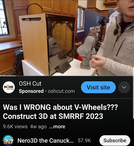

Before this, I was against V wheels, and against 4 wheels. Now though, am not so sure… They’re claiming 4 correctly installed polycarbonate wheels are better than 3 wheels, and better than cheap linear rails. They mention quality linear rails are best, but I don’t know what they were referring to?

I don’t think there’s any question that V wheels CAN work fine, and do in plenty of the budget printer designs.
I’ve had the same set of V wheels running on my Ender 3 Pro for 4 years now. Maybe I was lucky and just happened to get them installed correctly up front, but have never really had a problem with them. I also print at very slow speeds, and not in a heated enclosure, which I think has an effect on their longevity.
The guy in the video is probably right, but I’m guessing they aren’t using the same cheap V-wheels that a lot of these other builds are using.
I see on the OpenBuilds store, the Heavy Duty V wheels are $7 each. If these are the types of wheels you have to buy to get the same longevity and performance as the rails, then the rails are a no-brainer to me.
