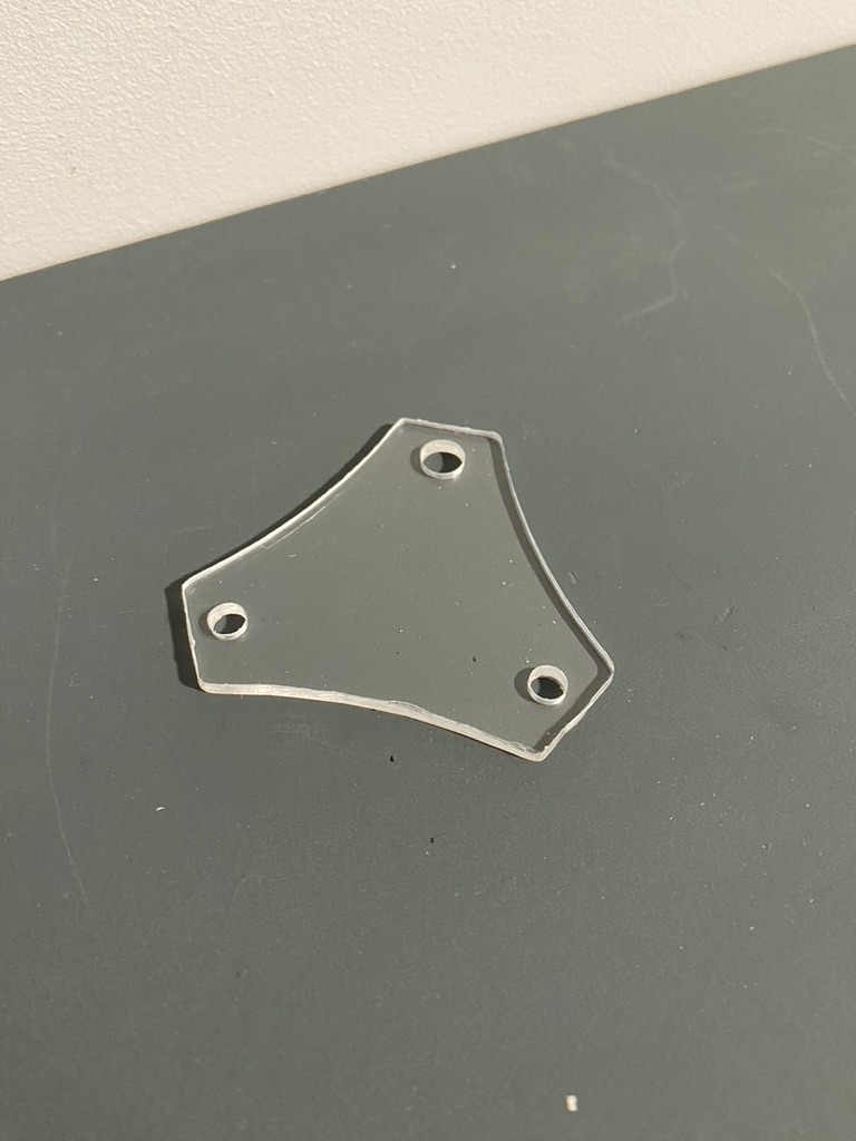

Just realized sendcutsend have carbon fiber, acm and other materials… Are you milling parts, or got fiber laser, or using sendcutsend?
Tons of stuff in lots of sizes.
Milling myself, and sendcutsend, also oshcut, pcbway, jlcpcbfab.

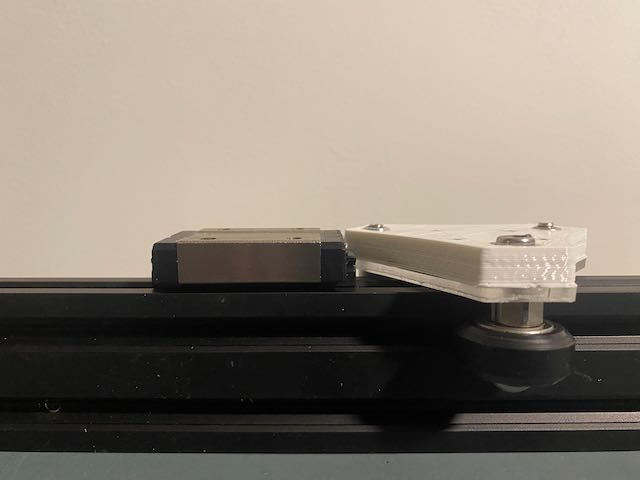

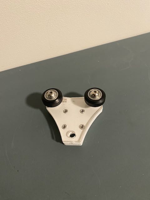

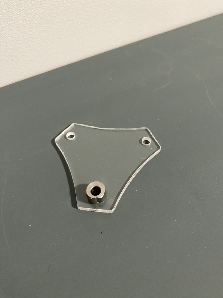

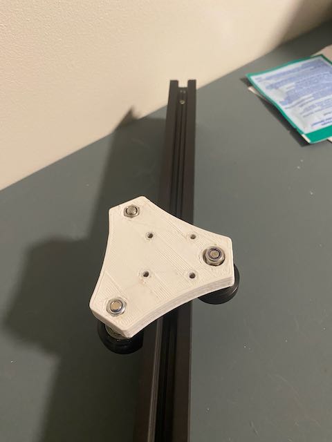

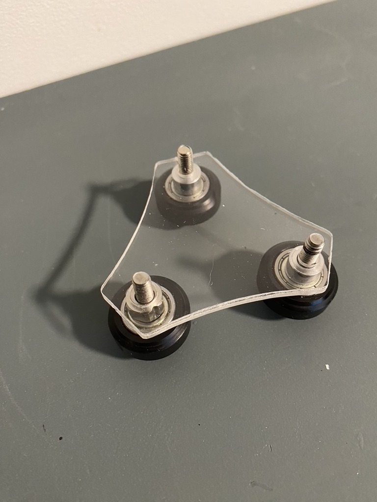

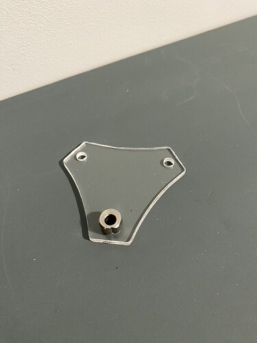

So here are some photos. I think for the cam/lock you will probably want to cut out of aluminum, the printed parts might soften in the enclosure and lose tension. I wanted to dry fit everything with mockup shapes first, and good thing that I did. The rails/extrusion didn’t align centered as I expected.
Here are the photos. I will put this on the printer and see how it works tomorrow!
I used an extruded part for the spacer…with nut races…or whatever they are called.
You can see from the top down that the alignment with the bearing block should be good.
Also, it fits the same height profile.

Did you heat set threaded inserts? Also, where did you get the cam lock? I searched that on amazon and I get ikea furniture parts… oh I just got 13 wheels delivered today. my next machine will have wheels on it and I’d really like to try the carriage… just don’t have the cam offset for the bolt
They are parts bin parts but if you search Amazon for: Eccentric Spacer, 5mm Bore, Column Isolation for V-Groove Wheel Aluminium Extrusion 3D Printer, you should find them.
No heat setting required. When I create a part in Tinkercad with nut races I use a 6 sided cone, with the bottom radius the correct nut size 4mm (8mm nut) and the top radius a little bigger 4.5mm. I find the nuts set themselves as they ease into the races.

Those triangle roller parts are really interesting. I hope this works!

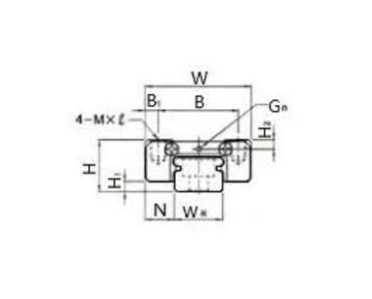

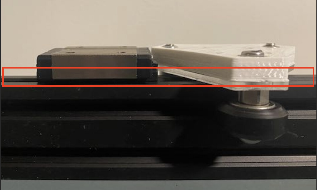

Not quite yet , it doesn’t. You’re not accounting for the linear rail that the bearing block rides on.
Good news is you just need to go thicker on the upper part.
You need to be 3mm higher at the top, that is the height from the linear rail to the bottom of the block.

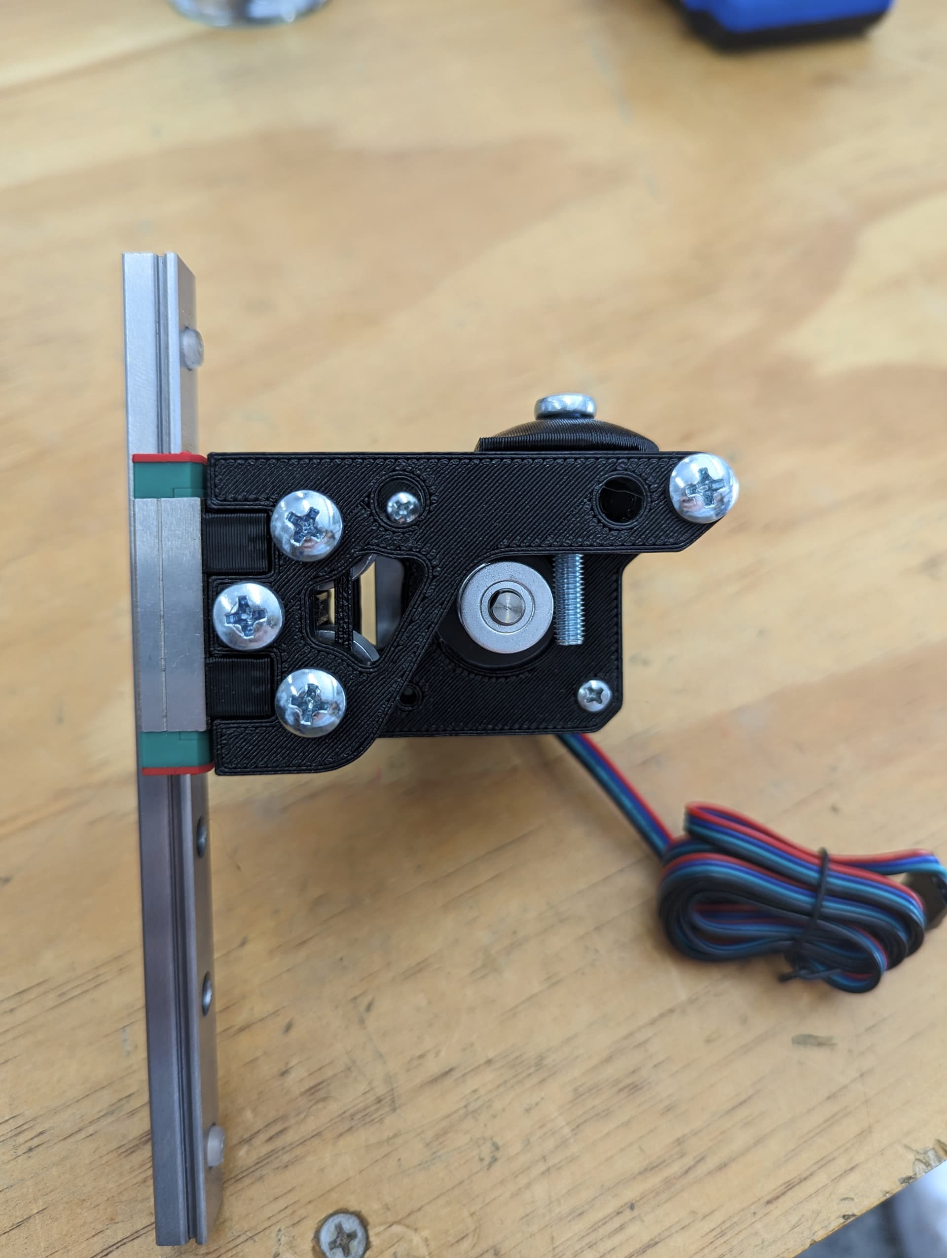

Did you mock your X carriage up on that V wheel block to make sure there isn’t interference with the triangle shaped parts protruding +Y/-Y outside of the MGN block footprint? That would interfere with the extruder mount and its assembly.
Seems like the examples shown in your posts up above would all need to be redesigned to clear the roller triangle. Or maybe this is for consideration only for Y axis and Z axis use?
Mounting the X rail would need different consideration at the end where it attaches to the Y carriages.

It is hard to see, but there is a small plastic bearing retention holder on the bottom of that block. I think my parts account for H =13mm
For those of you wondering about weight you would be increasing the moving parts for the Y-AXIS by about 50%…
MGN12H = 50g
This contraption = 85g.

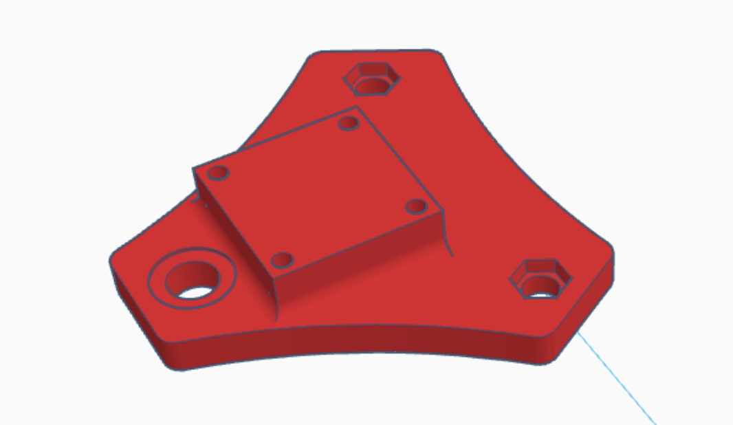

My response to the comments about mounting the parts where clearance may be required. This updated model should work with most MGN12H | MGN12C applications. I am going to try it with a bed slinger I have linear rods on at the moment.
Model is updated again at mp3dp-printed-z-axis-substitution
I can’t wait to try carving this! Going to order some .5" acrylic!
This would only be for the Z axes. I would not recommend swapping the X or Y.
I agree, but there were some comments about clearance for the Y Axis / carriage. I think the new part should work, although it is 50% heavier, and it will need to roll on-top of the extrusion making it possibly a challenge to enclose the printer.
