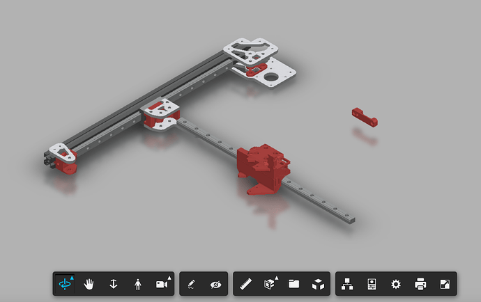

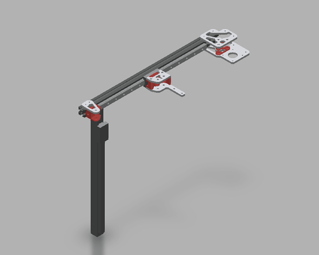

Well, looking at it, Now I remember why I put the steppers on the moving block…it saves a ton of room.

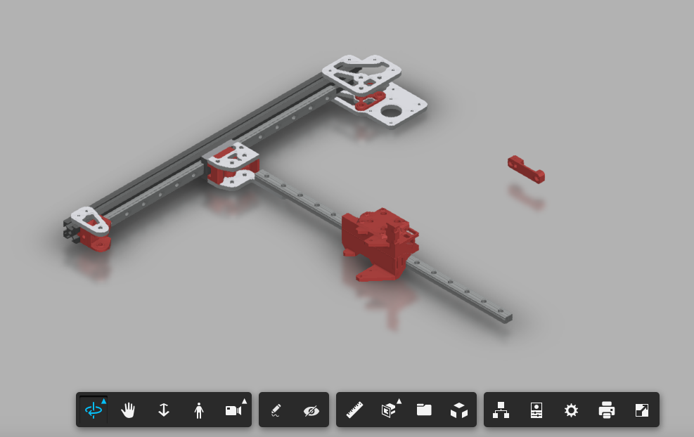

Okay, speak up on this one. Moving Z stepper saves about 40mm in height. A moving stepper is heaver…but it seems we will be using a brake either way, so does that matter?
Sorry I was typing and didn’t hit save. Should be rolled back with a Z rail now.
no biggie…
I can see the Z rail now LOL.
I remember you talking about 42mm in the beginning. So less than 2". I know we have talked and talked about brakes but has anyone actually got it working on a functioning printer yet? and one with klipper?? If we are 100% positive that we can get the brake to work 100% and for more than JUST power failures then I will be on board with leaving the motors on the moving block. But if we arent 100% sure then less than 2" taller is not anything thats ever going to make a difference to me. It can be a foot taller and wont matter for me LOL. I know everyone’s situation is different and I know even more so for you with the farm. I am just really tired of burned out boards LOL. And those constant tension springs that are enough to actually do anything are WAY too big so that doesnt seem like a viable option to me.
I am messing with a Sketch in the new component. And using pen and paper.

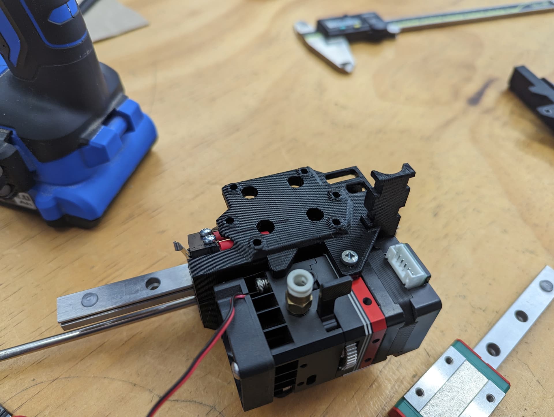

Little break for a test fit. I messed a couple through holes but the rest seems good enough. Smaller in real life.
That looks great! Are you planning to use heat inserts for the mounting the EBB boards or just threads into plastic? My choice would definitely be heat inserts. I always tent to screw up threads in plastic

I promise there are small ones, I have a bunch around here I just have to stop to look for them.
Either way, we did the weight earlier and taking steppers off on a bigger bed still needs a “brake” to be safe right?
No they are huge and add to the BOM. The CAD is there you can edit it to add them if you want. Just change the hole size of the ones you want. They should clear the belts even if you go larger.

I thought about the heat set inserts when making it…but the space is tight, all the holes and stuff was not much room. I remade that part probably 10 different ways. I also figure someone is going to ask for some other CANbus card to be adapted so I figured just the most simple flat plate would be the easiest to modify, because I am not doing requests for all parts.

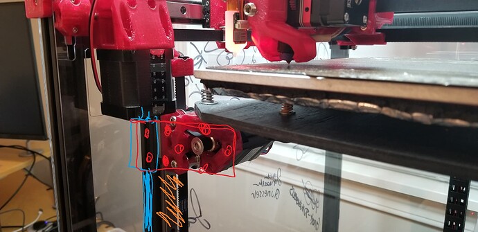

I want them up top but is sucks up so much room, and then that means the bed mount is a huge hook shaped thing. I can put them at the bottom and use the extra 20mm room from the bottom frame rail, but then the stepper is only mounted with two screws pretty close together.
Looking more closely, we gain at least 20-25mm on the bottom, and 20 on top. 40mm is not the end of the world. I am going back and forth.
Less parts with the moving Z stepper… I am going to keep going that way unless someone has a good reason not to. Two printed belt mounts at each end, and the Z mount can be a plate sandwich like the trucks, with the Z stepper tension-able instead of moving a block. Should look great and save us at least 40mm. This will put the stepper wires bundled with the bed mains wires though…hmmm.

I haven’t seen any kind of drawing for up top so I could be way off but what pops in my head just doesn’t look good. So ill keep my vote for bottom or moving lol. If moving I will definitely have to take a better look at how to manage those wires. I did NOT do a good job of that on the V4, or really any of the wires LOL. I think its getting a major wiring overhaul soon with all electronics moved to the back and out of the way. We need a canbus board with 3 2209s on it to mount to the bottom of the bed support and run all 3 steppers off of 4 wires like the tool head boards LOL. You can hook up multiple canbus boards in klipper!

Was imagining bulk of the coil rides with the moving Steppers, so only the end is attaches to modded Z Belt Holder.
Between hotend and PTFE needing to flap around, we need ~120mm height Lid anyway, so, guessing there’s plenty of room up top, especially if XY steppers are at the back?
There seems to be some space. Would repositioning Z linear rails to be on front (or rear) face of the upright extrusion enable simpler CNC’d plate based Z Posts? Belts stay pretty much where they are. Can Z Post end up just being a CNC’d/laser cut plate, with no/minimal printed part(s)?
