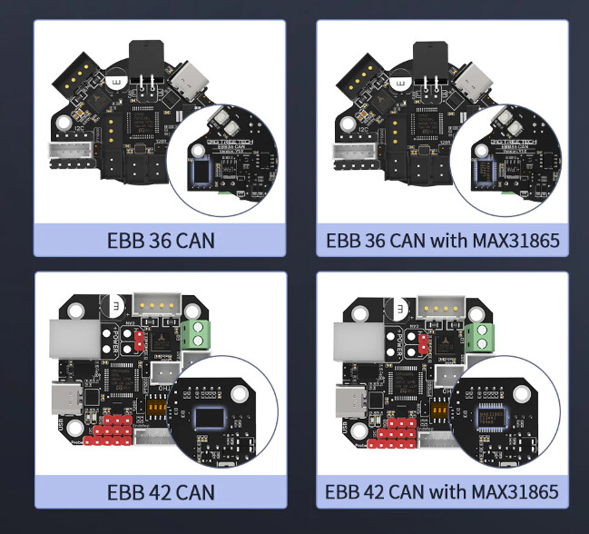

What specific can cards are you guys using, so I can see how they might fit? EBB 36/34? I will just add some sort of flat deck on the core.
I’m running the EBB36 right now but I do have an EBB42 as well. Not sure which one I will run on the V5. Just depends on how it all looks/fits. I think for me it will depend on which extruder I end up running. If I go with an orbiter V2 like I did on my E5+ then there are tons of mounts to put it right on the back of that. But options are always nice
That is the square one (40x40mm), and the triangle (50x35mm?).
Edit:
Found the STEP files on their Github
EBB 36
EBB 42
Using EBB36, at the time, seemed like most MP3DP Makers using CAN went with that.
Noticed @gpagnozzi used EBB42 for his build when I was reviewing what everyone was Making https://forum.v1e.com/t/mp3dp-v4-azas-build/37251#bigmp3dp-v4-v1e-community-builds-buildersbig-35
As far as I know they are basically identical boards. The EBB36 is designed to mount to a nema14 and the EBB42 is designed to mount to a nema17 being the only difference between the 2

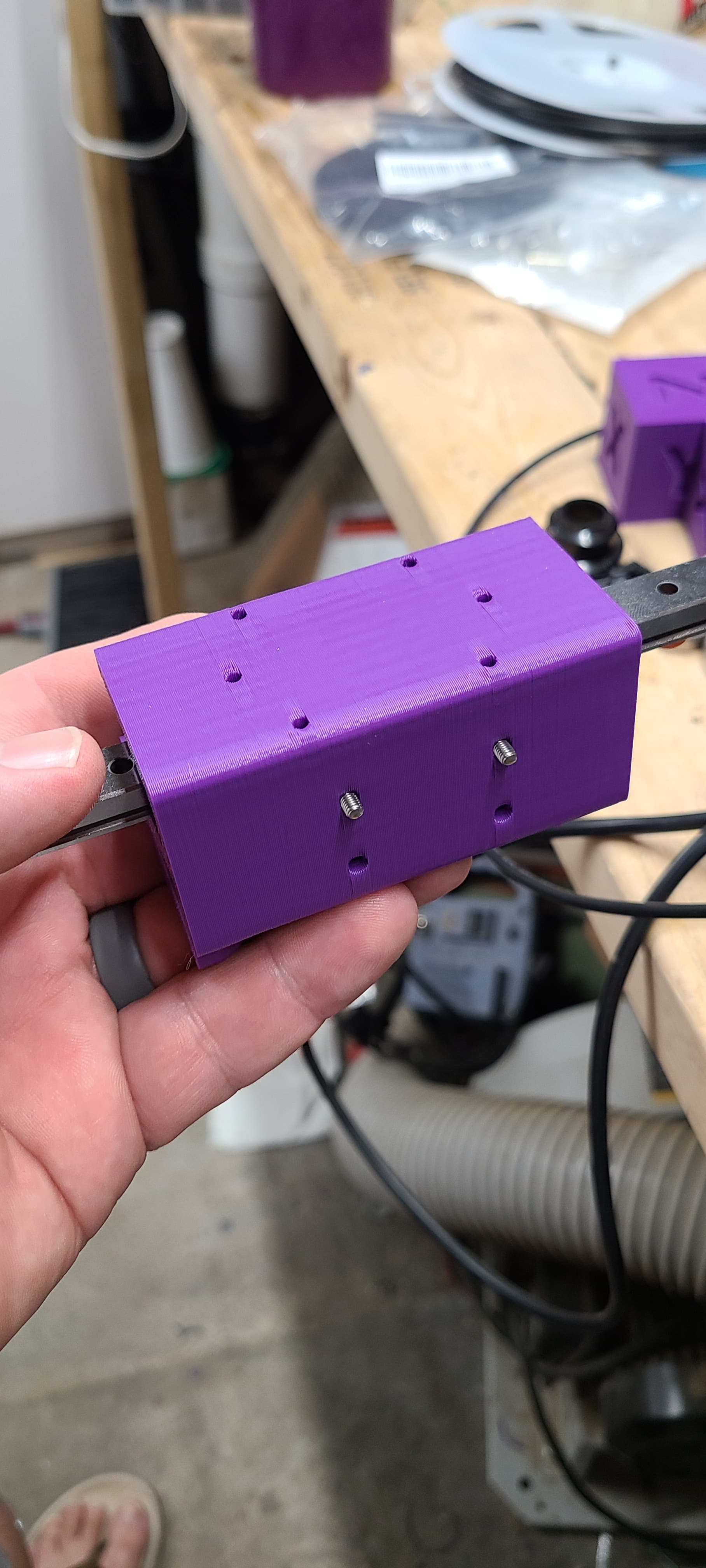

Okay, looks like I just need another test print of the core after all the fiddling.
Has optional ebb36/42 mount, hemera or H2, and a umbilical holder(not sure about this one until I print it.).
So XY needs a X rail nut holder (tnuts), and a Y endstop. After those we finally get to move on to the Z axis.
I will add a note here The XY has 1.5-3mm “extra travel” on all sides. We just got lucky. I know for a couple of you this is not enough. I would rather cut it this close (maybe even lose a mm or two) than have all machines with an extra 12-15mm on all sides. If you want all sorts of extra room for some reason you will just need to add 25+mm to your bed size, and pay attention to the bed mounting holes, should be no big deal. Same goes with adding things to the sides or back just add more room
