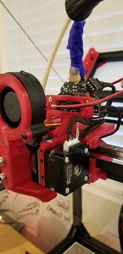

Strain relief and CAN Bus board mounts being added to the Core?
My hot glue and self fusing silicone tape works, but is pretty janky.

And I agree with @azab2c can board mount would sure be nice
:drooling_face:
I would add extra room and mount it behind the core instead of on top if that doesn’t mess with your accelerometer. But yes you can add it anywhere.

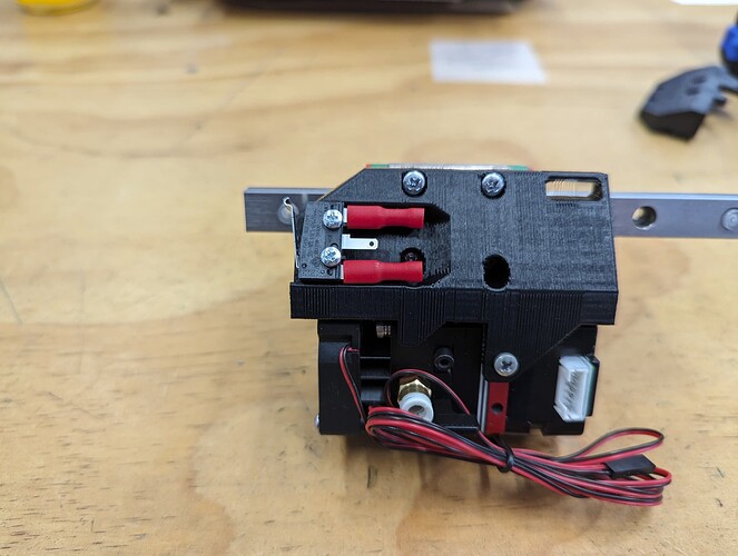

So close. Need to move it a couple mm’s. I can make this a pocket so you will not see the switch, I figure it will be with the umbilical anyway so It would not hide much…but it is an option.
The slot on the back is for routing wires from the bottom. Last thing to add is somewhere to attach the umbilical.

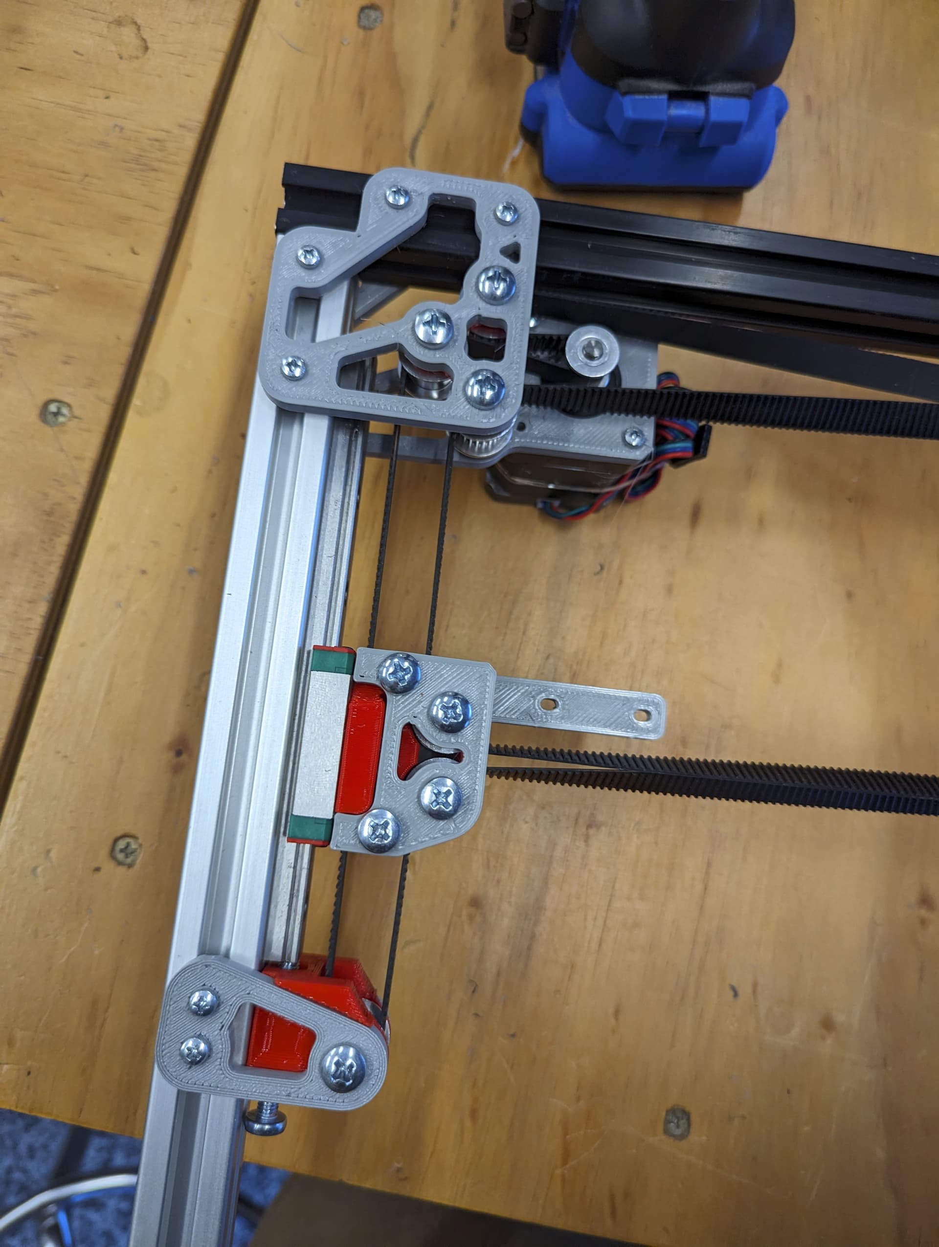

I’m curious how the belt lengths on the v5 compare with the v4… wonder if the upgrade will require longer belts (replacement).
Yeah, I think it is going to be a couple inches longer. We added the rear steppers so that requires an extra offset, and currently we can do 1 belt instead of two…but two will still work. I am not sure if there is an easy way for me to check that length but I will give it a look pretty soon.
