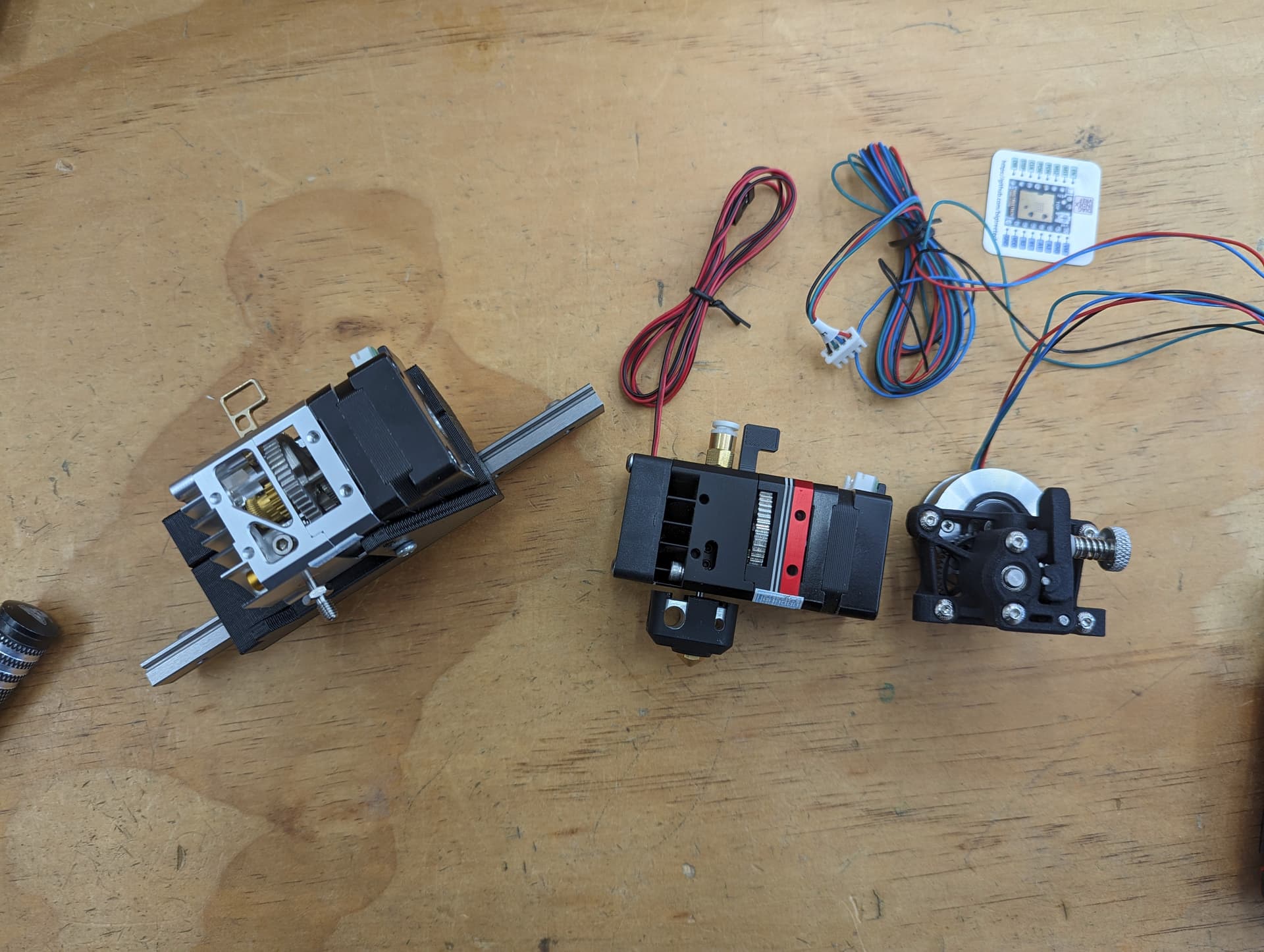

Slightly different body and nozzle distance for BIQU H2 V2S REVO vs regular H2…
The bottom view is just as bad…this thing is so random.
Ohhhhh, yeah it can get tight, but it is not too bad. Once I get the h2 mocked up I will commit to a endstop location.
it gets set in the firmware so you can’t screw it up…but I prefer to home both simultaneously, so that is why it goes on the core (or the truck)
OMG…the drawings for the two are completely different. WTF. The revo is worse, How do you measure from a 0.4mm hole off plane to anything. These have to be the the worst drawings I have seen in a very long time.
I am going to mock up one H2, if you get a different one slight adjustments will need to be made, but not by much.

I have the H2V2S and the side with the gear sticking out where it says this is preferred for mounting… isn’t. It works for holding a fan, but the truck mount: on the opposite side. The threads are shallow (I think I used a 6 mm M3 with a printed part to hold the fan on. The 8mm screws bottom out. I’d say they are tapped like 3-4 mm deep… maybe 5 mm. there are 2 holes on the top, on the back, and on the bottom next to the stepper that are preferred for mounting… if that helps. I can get you measurements for offset on any of it if that helps.
Yeah the manual is even worse. I noticed that error. I think they are looking through the back in the drawing and did not realize it.
It is the worst.
Thank you, I have a couple here. I know some of the holes are super deep, some are shallow.
I have already made the mount, with top and bottom screw locations. (flipped the printing orientation) I also made both belt screw holes look symmetric, and smaller.

So that one truck insert piece is ~$23 each printed in stainless or aluminum. MFJ nylon is good to up to 175C and is ~$6 each. Have not checked the core yet.
Man we can make a frigging beast like that a couple MFJ Nylon parts.
Aza, if you are planning on doing a 80C+ enclosed super collider edition, I bet that ~$12 would be worth it.

We currently only have the inner truck part, there is not much plastic in between the screws to actually fail.
With that said, we will have to see how hard we can push things. Maybe we do break the plastic part…That would actually be kinda cool.
The core, could have a bit more to be gained depending on how much you are going to hang on it…but I also have not finished that so maybe it gets a bit more redesign. (second part is nearly done).
For me it is really hard. I know the corners, basically can not get better. So that only leaves two parts…I do not think there is anything to be gained, but for a few bucks we can have some super crazy parts.
Now the next question is would FDM PC be worth it…Not sure. If I enclose this one I will surely give it a shot, just to do it.
So, in summary, I doubt it but it would be cool!
