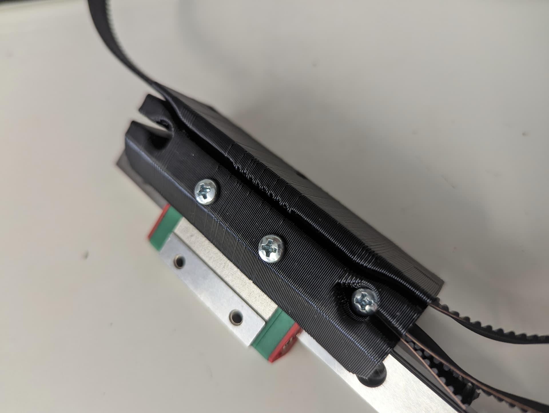

That screw in the far right of this picture just has a belt wrapped around it. This fits real nice.
Bottom half feels good now.
Just in case I will make the crossover belt gap a parameter to easily adjust.
Just need to finish up the XY tensioner and the XY is mostly done and ready for some test prints shortly.

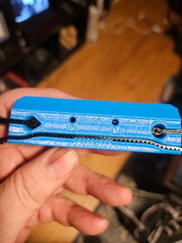

Will see if my printer’s 0.6mm noz, 0.3mm layer height, inside walls first is tuned enough to make decent belt teeth…
Worth a shot. But worst case print it again with a lower layer height to get more resolution. You can go down to a .2 or less even with the .6 nozzle. But I’m pretty sure Ryan prints with a thicker layer height so you should be good at the .3
I think he prints with a 0.5 nozzle. From the picture, I’m going to guesstimate a 0.3-0.32 layer height

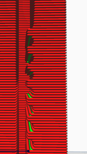

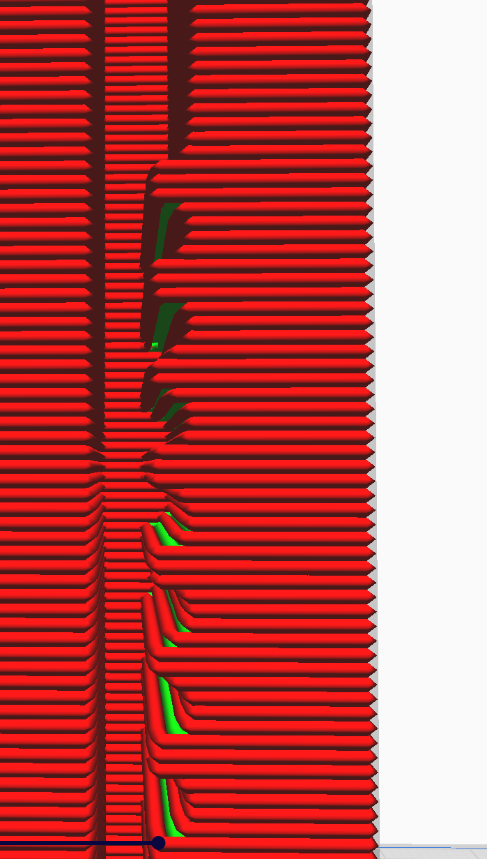

For clean belt slots, do you want us printing like this?
nope
I used 0.38 layers, fits too good.

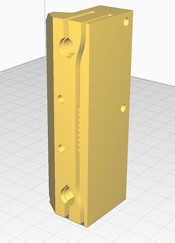

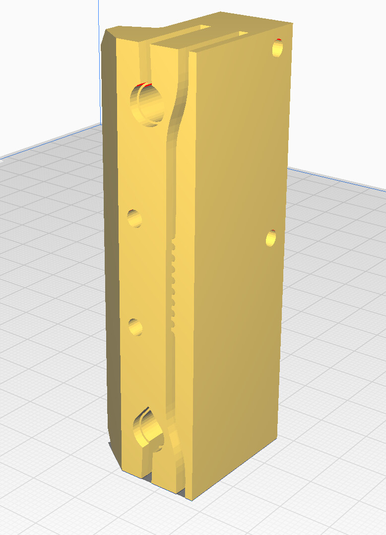

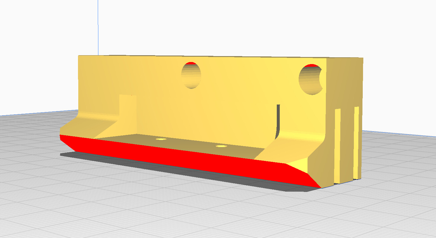

Is there a reason one bolt hole is spade shape and one circle?
Print without support?
This was my guess when I noticed it as well
Winner!!
It’s winking ![]()

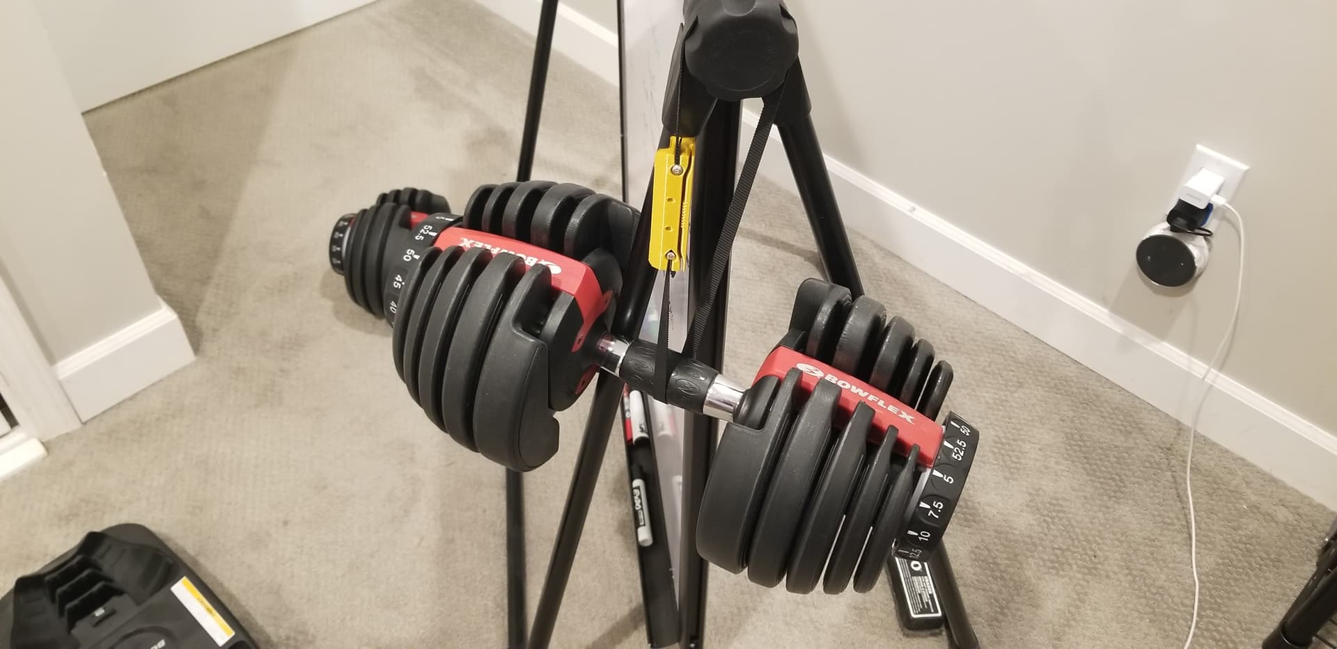

Looks good, and holds up well to me. Thank you for making holes large enough for flange M3x10.

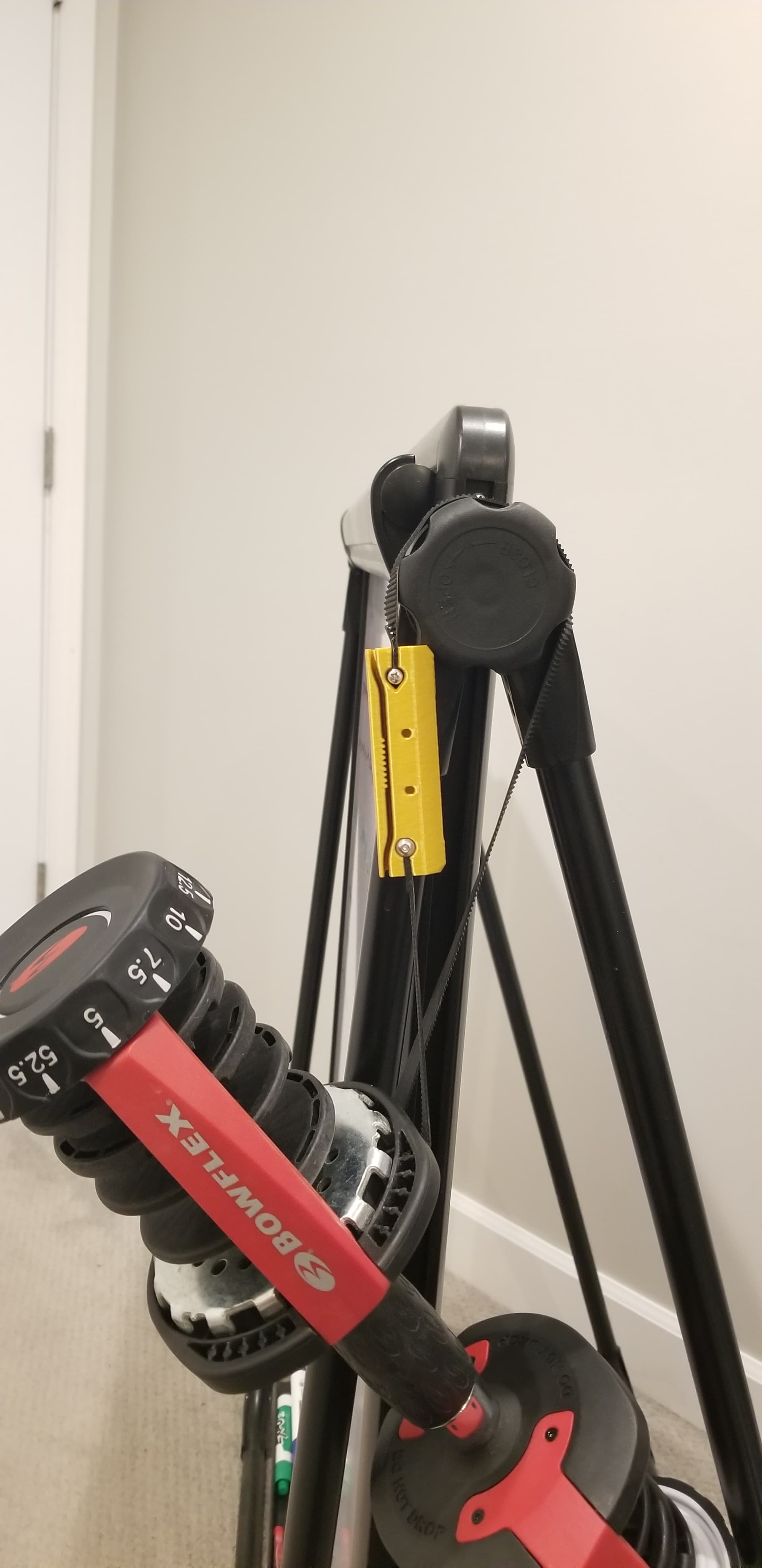

Do you have a target pull/weight limit?
20%, 2 walls, weight limit unknown, but working on it… (Dead load?)
EDIT: Overture silk gold PLA just because that’s what was loaded, and will help show print flaws. Added 5lb increments all the way up to Max weight of my LR3 hold downs, which is 52.5lb. v5 proto type Core is still holding…
Will leave hanging for a bit to see what happens. Indoor space is 66F.
Shared gcode (which includes settings in comments) on GitHub
