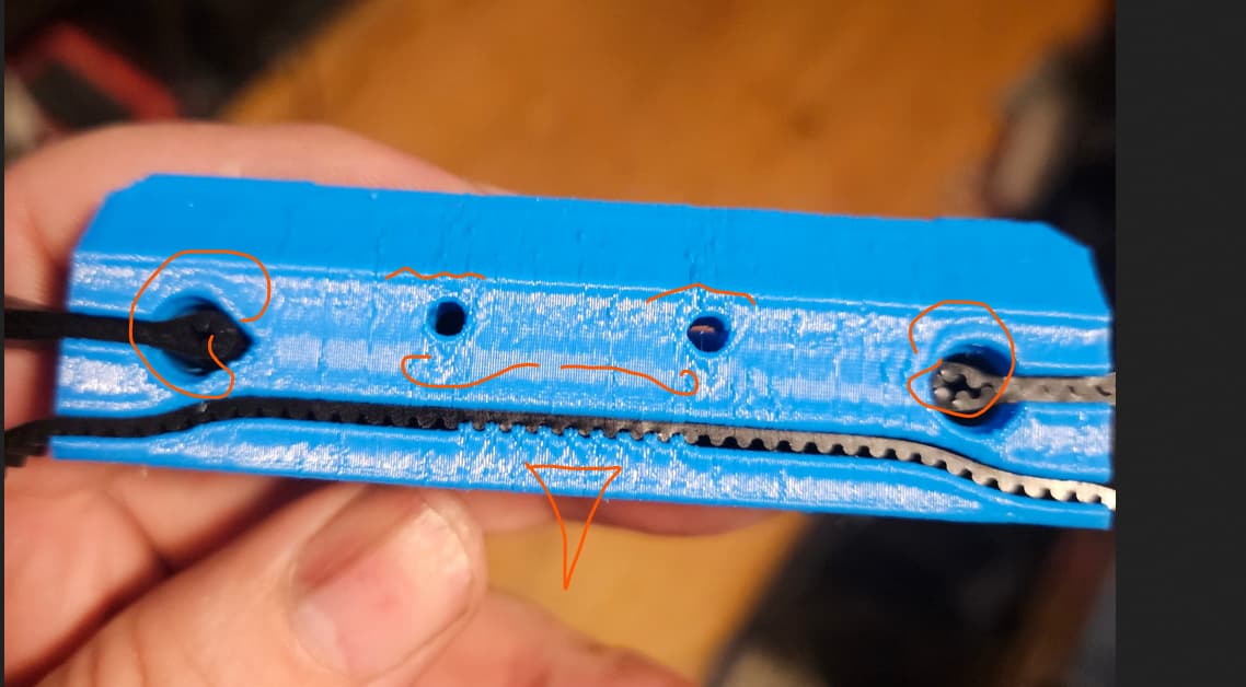

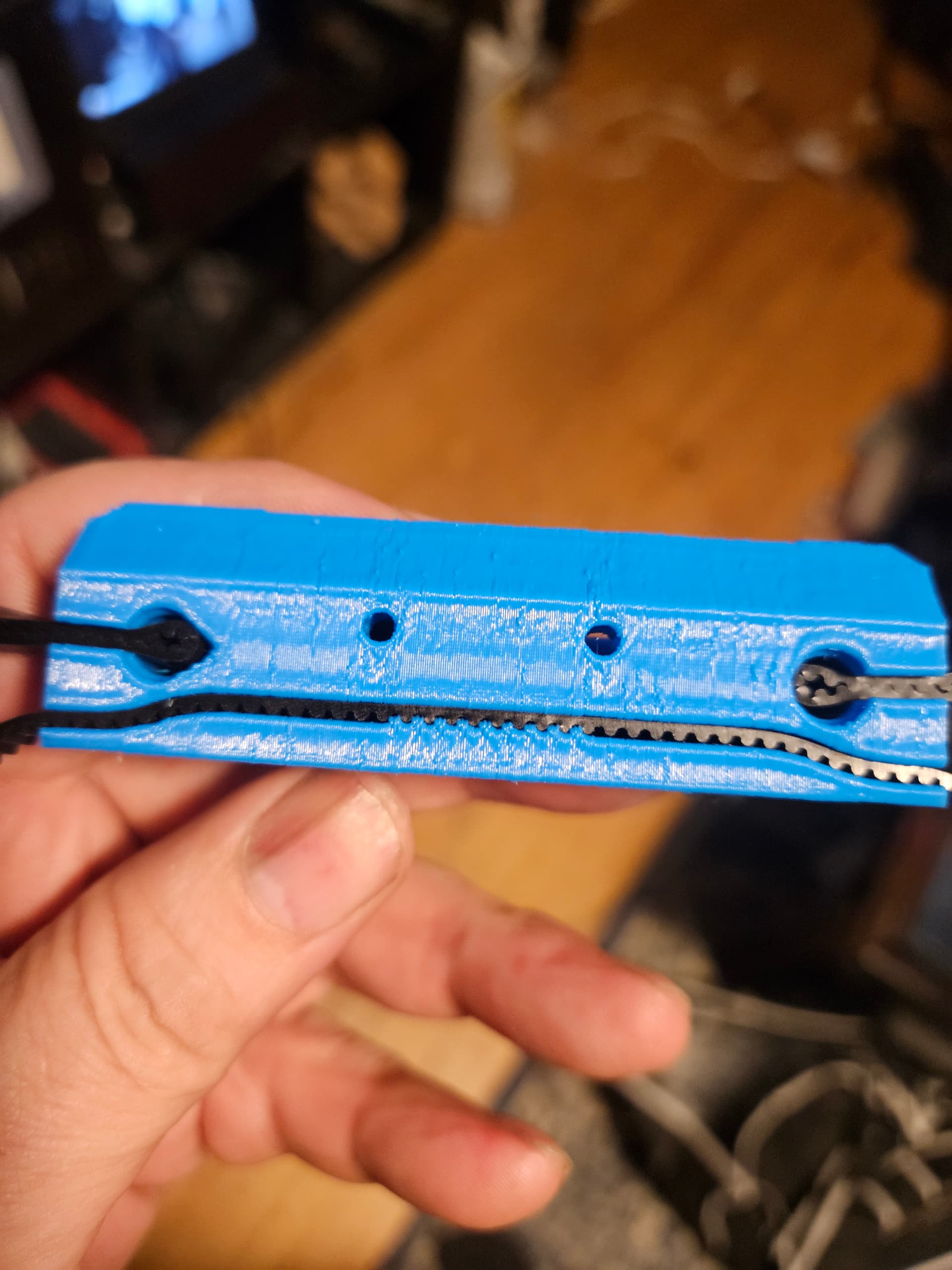

if it holds for 5 minutes, it is more than strong enough… next, get out the heat gun and slowly control the room temperature until you get up to…
Sure, but couldn’t they both be spade shape? My ocd is kicking in from it not being symmetrical.
No, it’s functional. Note the orientation. On the left, you need the spade shape because it’s a closed shape. On the right, you have the gap for the belt to exit. This serves the same role as the tip of the spade so that no supports are required.
Tell your OCD that there’s no assymetry, and imagine it standing upright. There’s a spade with a gap on the bottom, and a circle with a gap on the top. As it should be. :slight_smile:
I did the same thing. Because of how we print it the side on the plate is “stronger” and needs the spade to make that hole printable, the other side has a 45 degree chamfer on the back, and they will create a void.
If it helps anywhere there are two holes I can make one a spade…then we have a name for the printer?
No one is going to comment on the face it makes?
Don’t forget this also squishes between your extruder and the bearing block…we can actually make this a few mm thinner is it helps anything.
I tried to keep all the load off the rest that does not sit in front of the bearing block to minimize and chance of deformation.
Having the right be a spade wouldn’t serve a functional purpose, but it should still print ok :slight_smile:

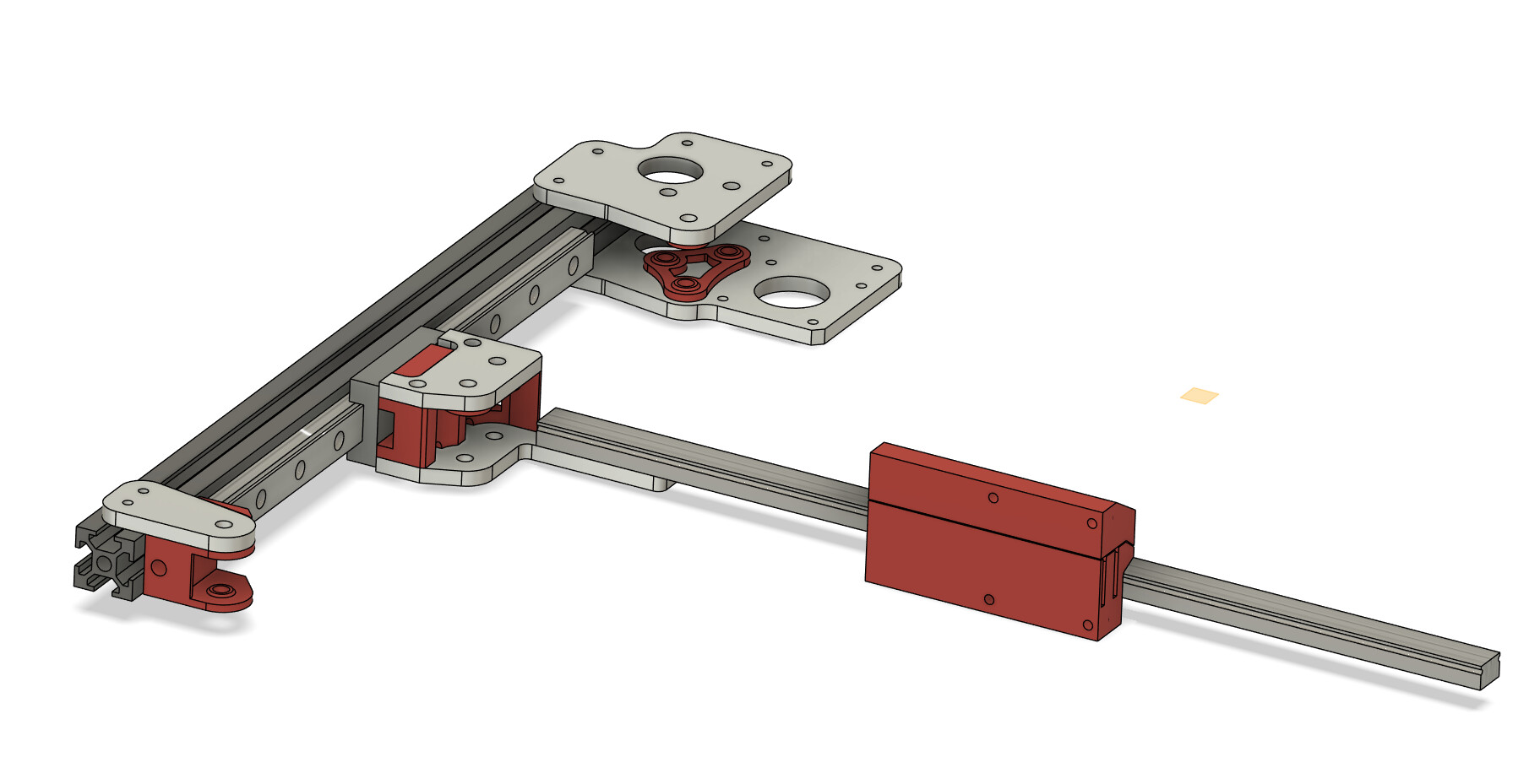

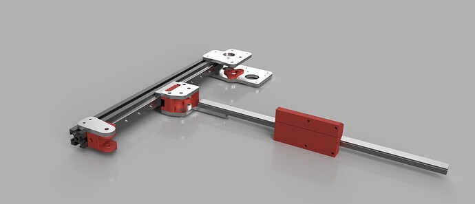

This is everything XY except endstop provisions. That has a touch over a true 12mm of XY tension adjustment on each side. V4 had 10 but the belts got pulled into place so it was probably 5-6 for most people.
Everything else is just flipped over, not mirrored. so Super easy BOM.
No front screw tension block needed this uses the Rail to push off of.
The XY has 11 unique parts…unless we need some more for the endstops. Sensorless homing is an option, but I would really prefer to also have hardware endstops available. Space is tight, not seeing anything obvious yet.
Other than extruder specific changes to the core anyone see anything funky? If you need to look at the CAD it is linked in the first post and I have the rails pretty functional so you can move it if you need a visual aid.
The BED and bed location are not fully parametric yet but I think I have that figured out now.
