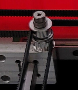

I love all the machining that went into those printers the parts are gorgeous from mandala. I do not understand why they did not support the tops of all the pulleys (they are all double stacked with a very long M3). That is my one quip about it.

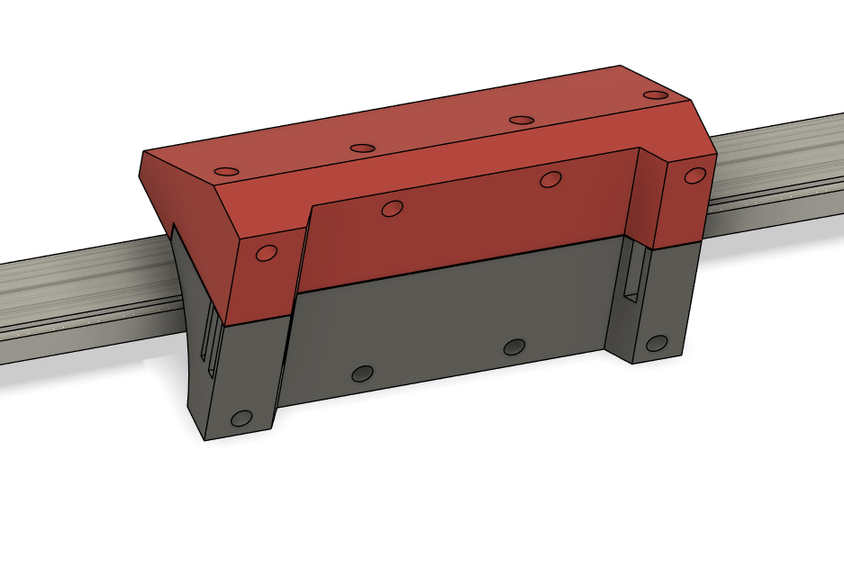

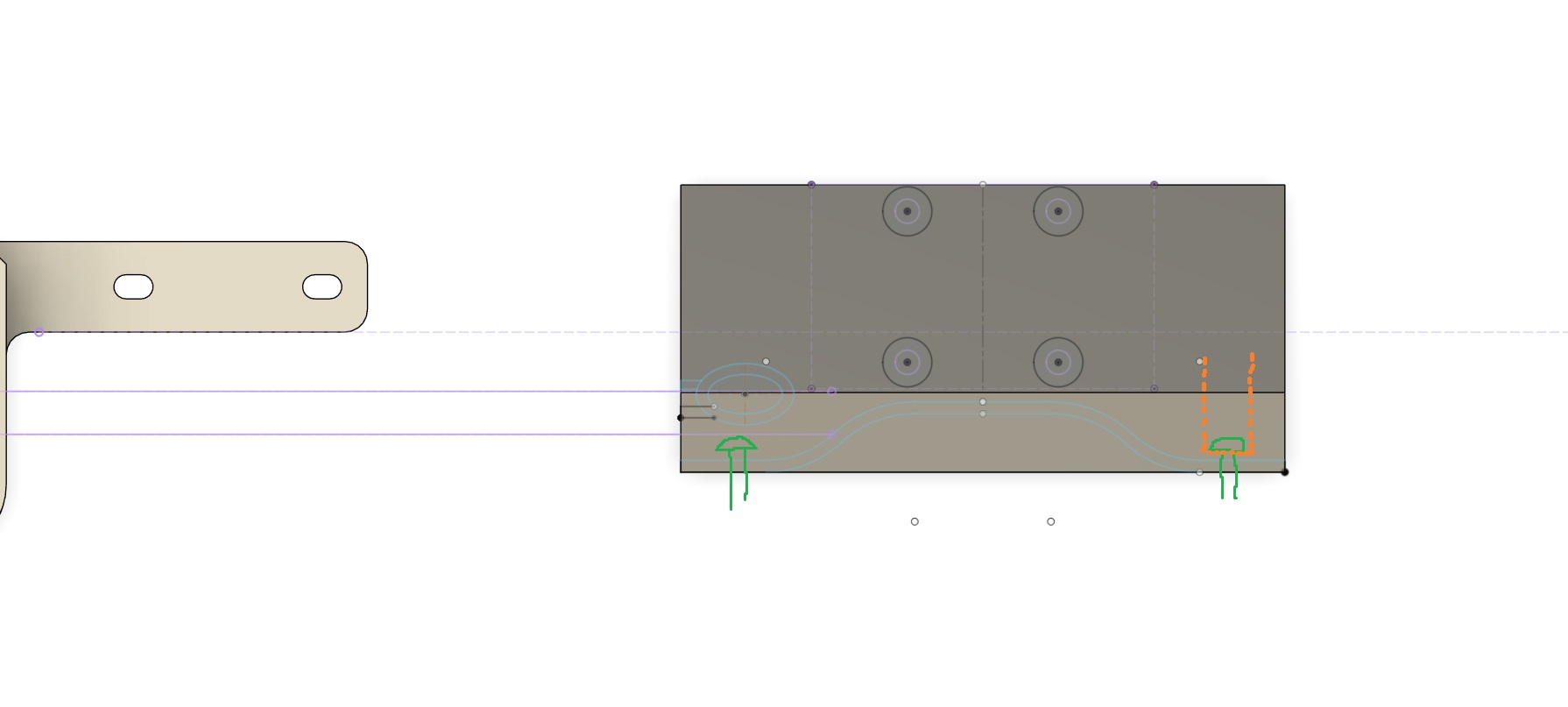

I think I like horizontal here, the main reason being plate thickness is not fixed.
Secondary is less hardware to mount it to the trucks, we can get to the bearing screws and extruders screws at the same time, and I think the belt mounting is stronger.

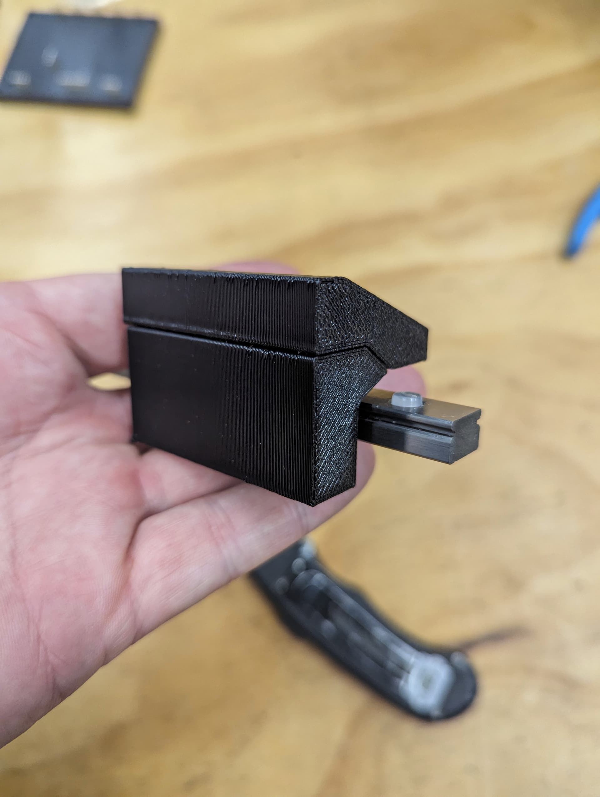

I think I need to print a couple test parts to see if the split core with the belts in the middle is rigid or not.

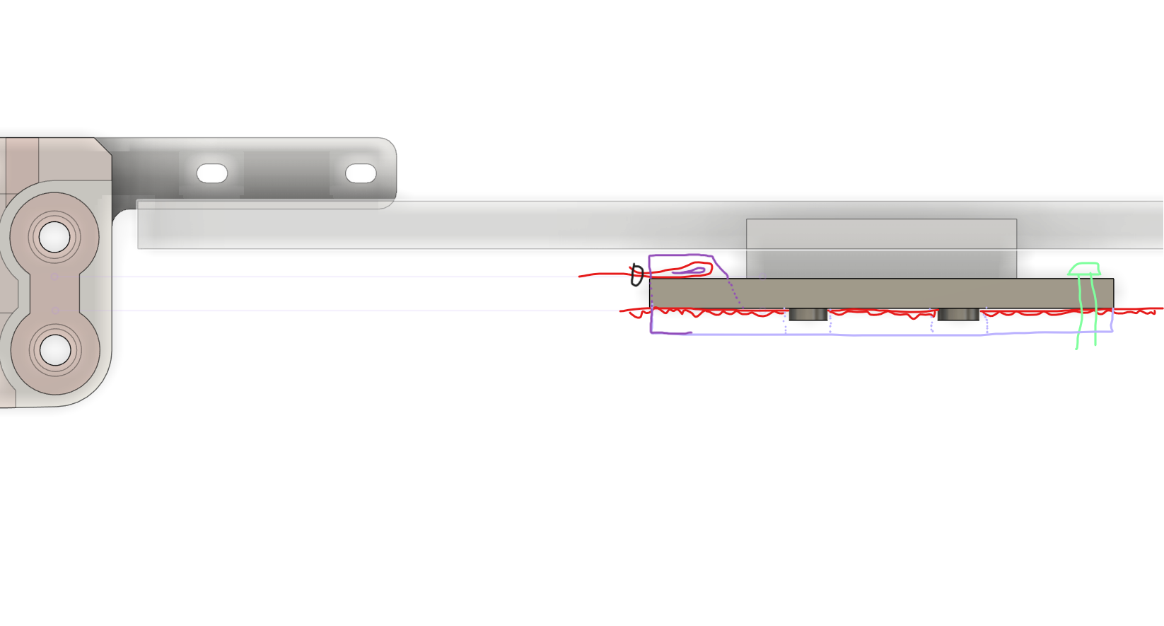

something like this,
if it was in a printed part i could see possible issues. But its a steel bolt threaded into aluminum plate and the two belts are pulling opposite each other. I mean there is a difference of leverage but I cant see the steel caring at all about that. The belts are still the weak link for sure.
That being said, I do feel like it was an oversight that could have been dealt with pretty easily.
That is just it, they are not pulling opposite, they combine to pull towards the middle. -y and +y cancel, 45 degree +xy and 45 degree -xy vectors add and together to get 2Y

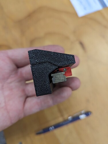

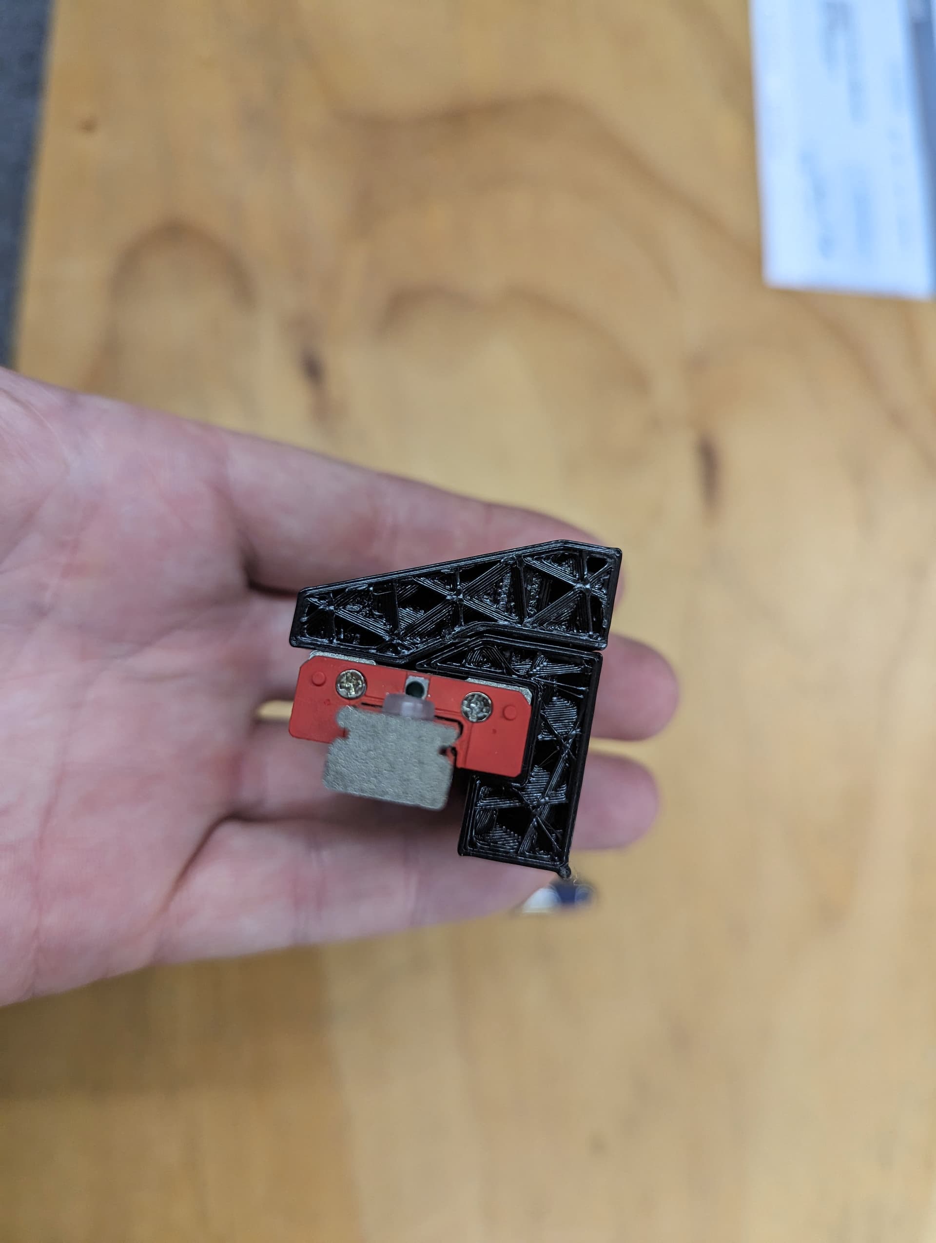

Even this rough, chunky version is pretty dang small. The two pieces seem to work well. With that lower half braced on the outside and touching the bearing block it is solid, and the top is nearly a straight shot.
I am feeling good about it. If I can get the belts in there, I am going to keep pushing forward. Unless someone sees something I don’t?
We know the Hemera fits, as well as anything with a 34mm (maybe even 28mm) or larger screw pattern height (80mm wide or less). I looked at the H2 as well since it is so tiny. And it will fit just like it did on the V4 screwed into the top and bottom instead of the side…ultra rigid.

Okay, I had an idea for fixing the belts and keeping things as strong as possible. Not sure how to describe it so I am going to print out a quick visual aid. Instead of printing the center post to wrap the belt around (not ideal in this printing orientation), or using a piece of filament (a little to small), how about we use one of the M3x10 screws at each connection. It fits perfectly and it frees up a ton of room. It will not be screwed into anything but it will be trapped.

Sounds ideal.
