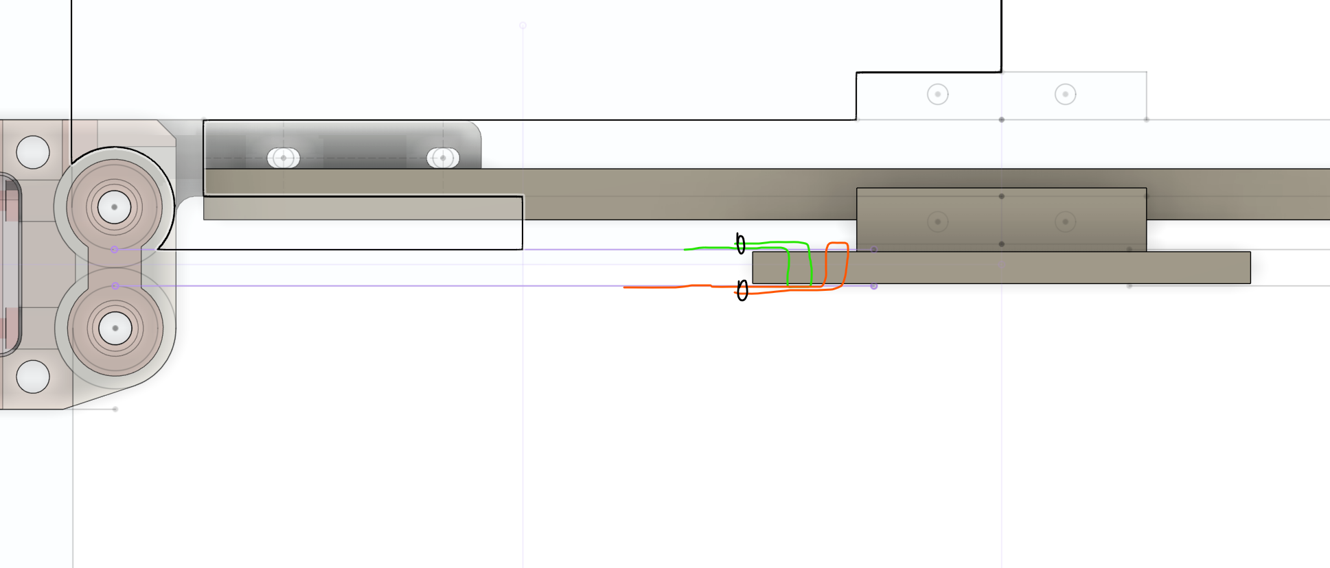

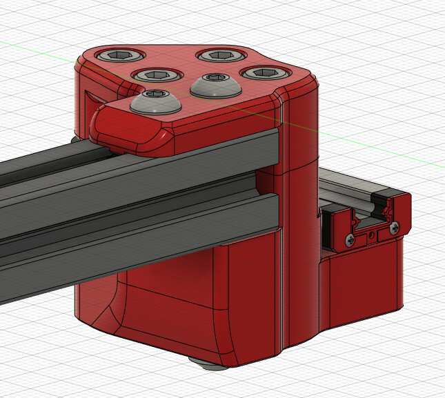

To be clear I am leaning towards vertical bearing block…but. I guess to put it in the simplest terms in my head. The rail is connected by a 12mm surface with fasteners at the centerline, the bearing block is 27mm wide with fasteners 20mm apart . If we are going to have to use plastic to make a 90 degree connection, I want it to be at the 27mm surface. So unless we come up with a good vertical rail plate it has to be horizontal.
If we go with the horizontal then mount systems for every extruder hotend combination known to man is already out there. And from what I’ve seen all with step files for any needed edits like for the belts. If we turn the tail vertical now we are making up all our own stuff or having to use a 90° printed adapter to make it work. Just my .02
Either way we still have a flat vertical surface to attach to.
There are quite a few printers with rail turned vertical, so I don’t think we are making up our own stuff in that regard any more than coming up with a mount for a Voron Trident or whatever.
I think we can make a toolhead that mounts roughly similar either way right?
So isn’t it really more, at this point, a question of how the rail connects to the Y Trucks?
Yup. It is going to be really hard to beat that single plate, so now I am looking at the belt connections as well to see if that adds complications on the other end. I have something basic on the horizontal CAD, Just need to play with the vertical now.

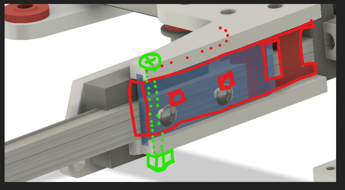

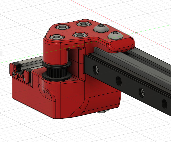

OMG…Aza you had it, no third plate though.
If you make the red printed part come all the way down instead of the third plate.
You screw the rail into the printed part…the end of the printed part is secured with another M5.
So now back to how the belts terminate

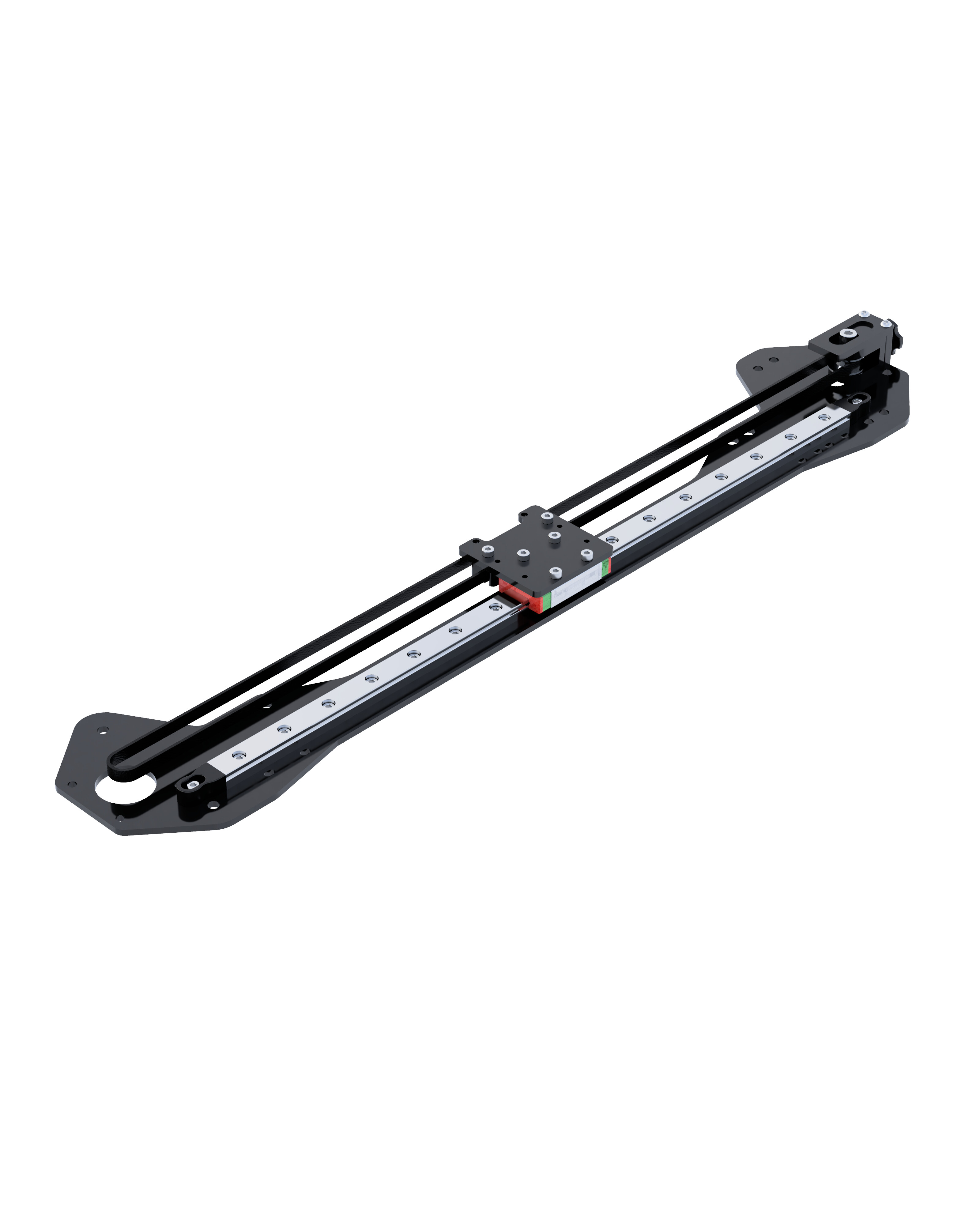

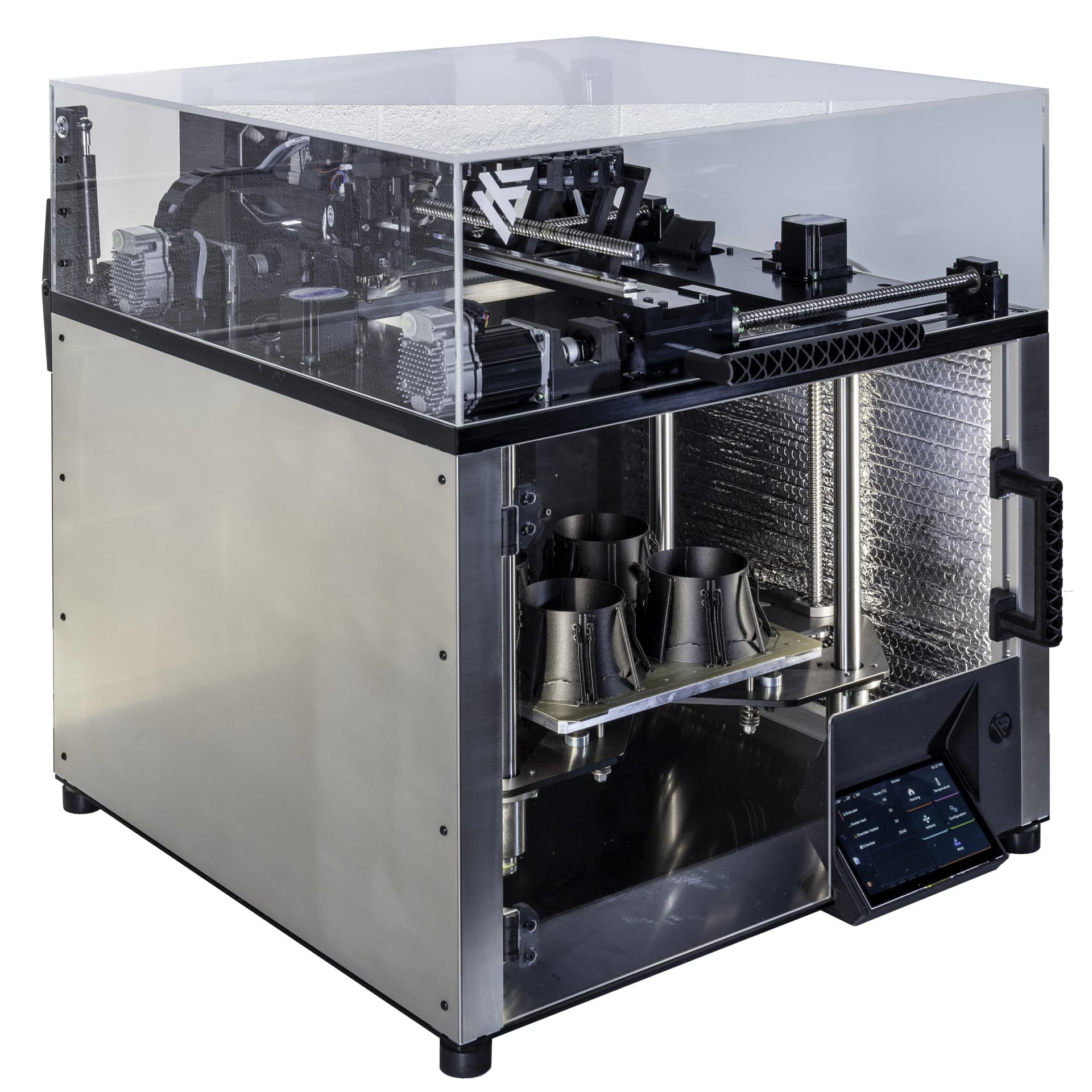

what about horizontal mount with a cnc cut aluminum flat bar for a backer… say 3/8-12"
for reference only as this is a $10k printer but… sorta like they did here
possibly something more like this would be attainable

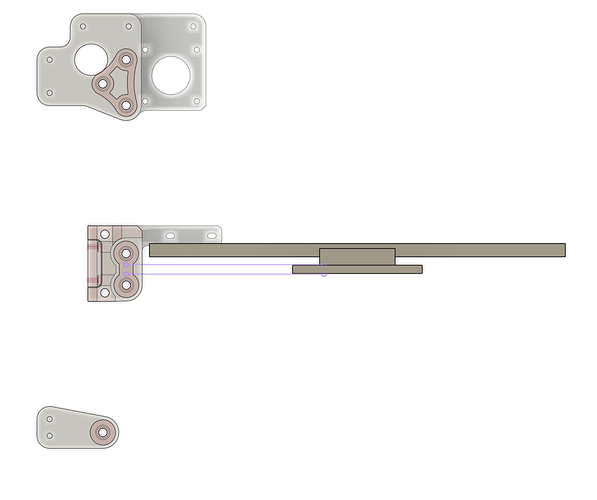

You can do it that way if you want on a horizontal Linear bearing like you show, but it is expensive and I do not see it adding anything but weight and screws. It won’t work for vertical, though (on this design).
I moved the idlers up that gives enough room for the linear rail to mount.
It does not work the other direction, bearing facing back, because the screws that would hold it get in the way.
The belt splitting the plate is not good, because the plates would stop bing parametric and would need to be a specific size. That and it does not make attaching them any easier.
This sort of thing need a specific plate thickness, and really belt thickness kinda sorta comes into play.
This plate can be a printed part pretty easily, that sort of takes the fun out of it though.
This core piece is trickier than the trucks.

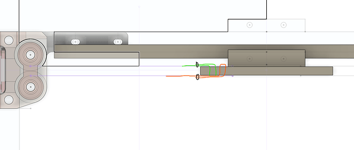

That’s one of the reasons why I put the belts on different planes on my corexy. That and avoiding the twist part where I wasn’t confident both belts wouldn’t grind each other at higher speeds.
If you put the belts on different horizontal planes they can easily come aligned on the same vertical plane at the carriage, it makes the carriage attachment points a lot easier.
Is there a technical reason why you need the belts to be on the same horizontal plane?
the offset plane is how the V4 is already set up. It does work, but the single plane is today’s design challenge.
