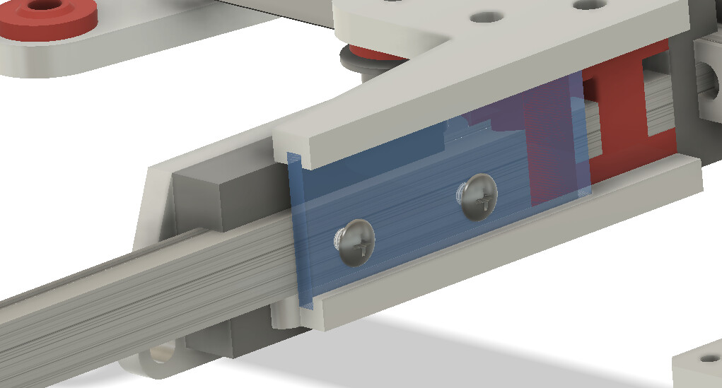

Seems like a lot of added weight that’s not really needed. But maybe I’m just not following you correctly.

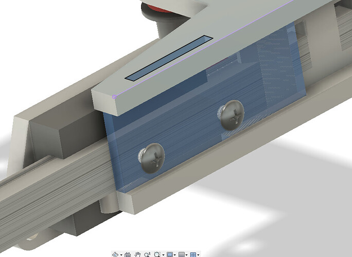

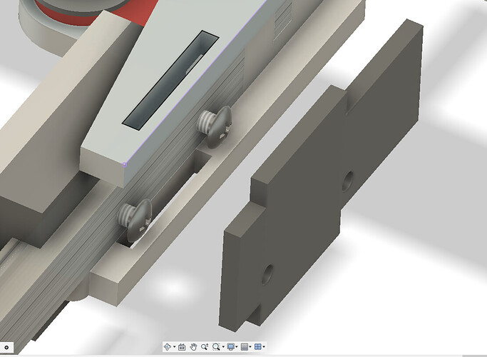

You thinking (for vertical linear rail) to just 3D print Y truck, don’t bother milling?

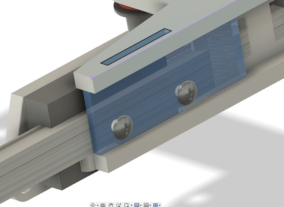

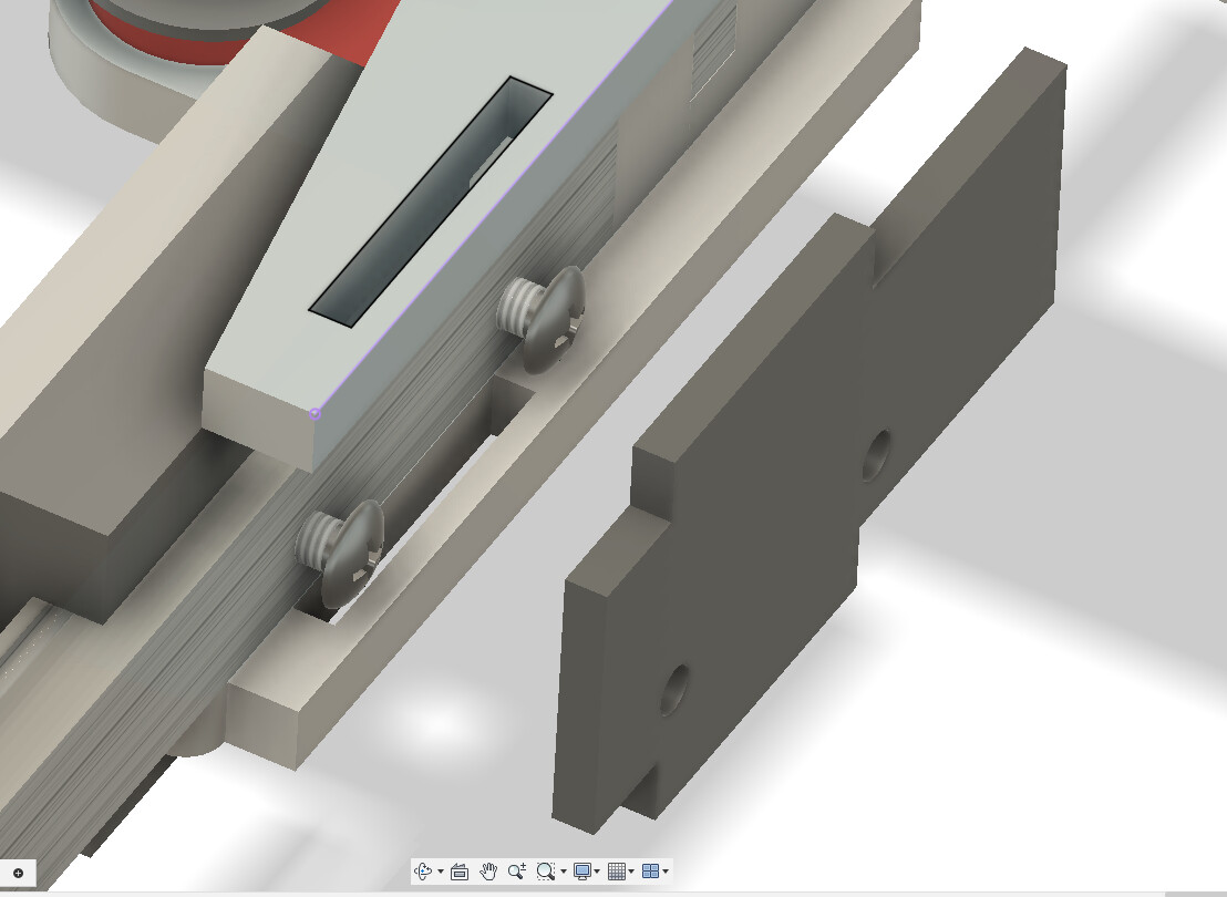

If milling, sketched one way for mounting X rail to truck…
Or… If recess channels are more $$$ than full depth laser cuts, then maybe full depth slots, something like…
Maker still epoxy/glues/welds during assembly, so there’s no movement/slop (?) in the vertical plate connecting top-bottom plates.
If router milling instead of laser, then, dogbone/rounded corners needed for slot cutouts.

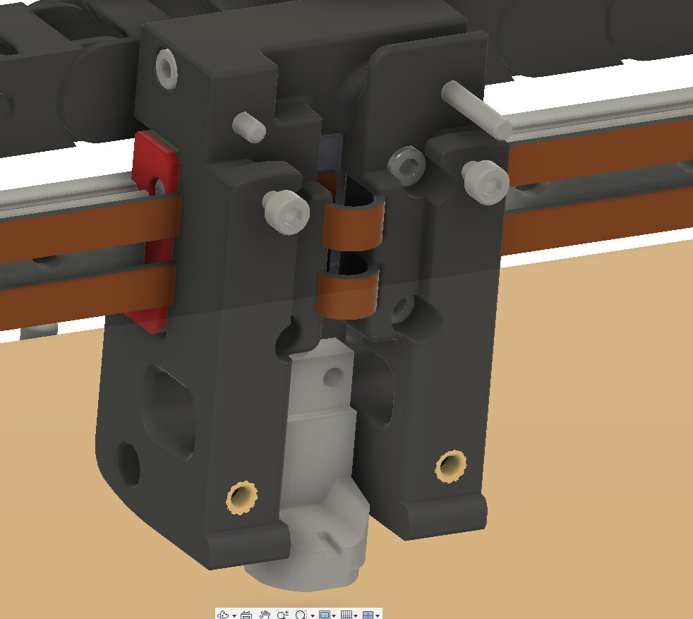

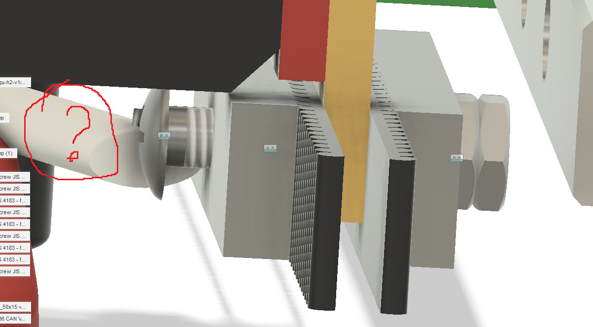

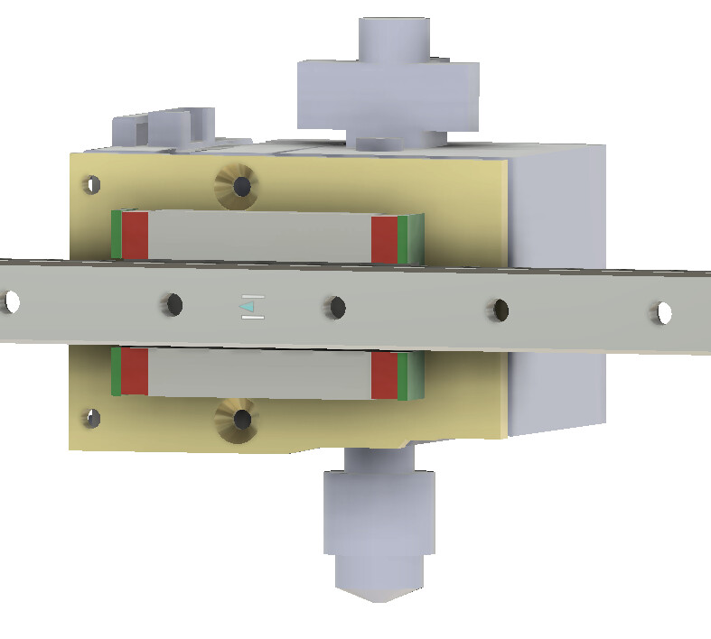

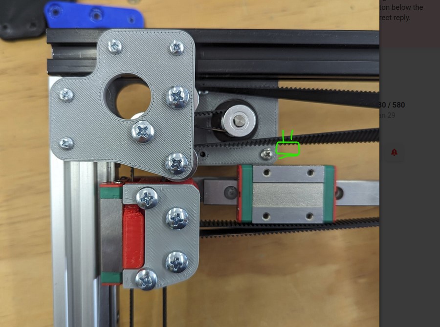

Did you notice where the belts are in this picture?
They either need to cross right down the center (like the trucks are) or way above or below the screws.
You can mount the rail in front of the belts or where I show it is about as far back as it can go. So the extruder would need to be in front of the second belt by a bit.
Putting the side mount sandwich and the way that extruder will mount, how different do you think it will be than horizontal? I think either way the extruder is always going to be sitting right in front of that front belt (we can bend it back a hair). It is looking like the extruder will be in the exact same place either way.
So how would that vertical mount look knowing that the belts are at the middle of the bearing block, or have a really good side mount.
I honestly think the mount is going to look nearly the same either way. Screws facing up or screws behind the extruder.
Maybe think of it this way, vertical there is more stuff in the way, horizontal you have more access. 13mm vs 27mm, 8mm vs 12mm.
Following that logic the mounting holes seem better vertical if you can get to them if they are behind the bearing block it is all bad.

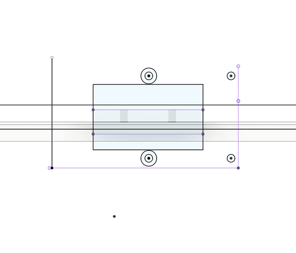

Looks like we need some extruder mounting patterns to see where they land.
Let me see if I can get some actual mounting hole locations and draw in a vertical rail as well to see where things land. That might solve this for us.

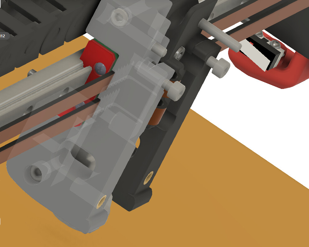

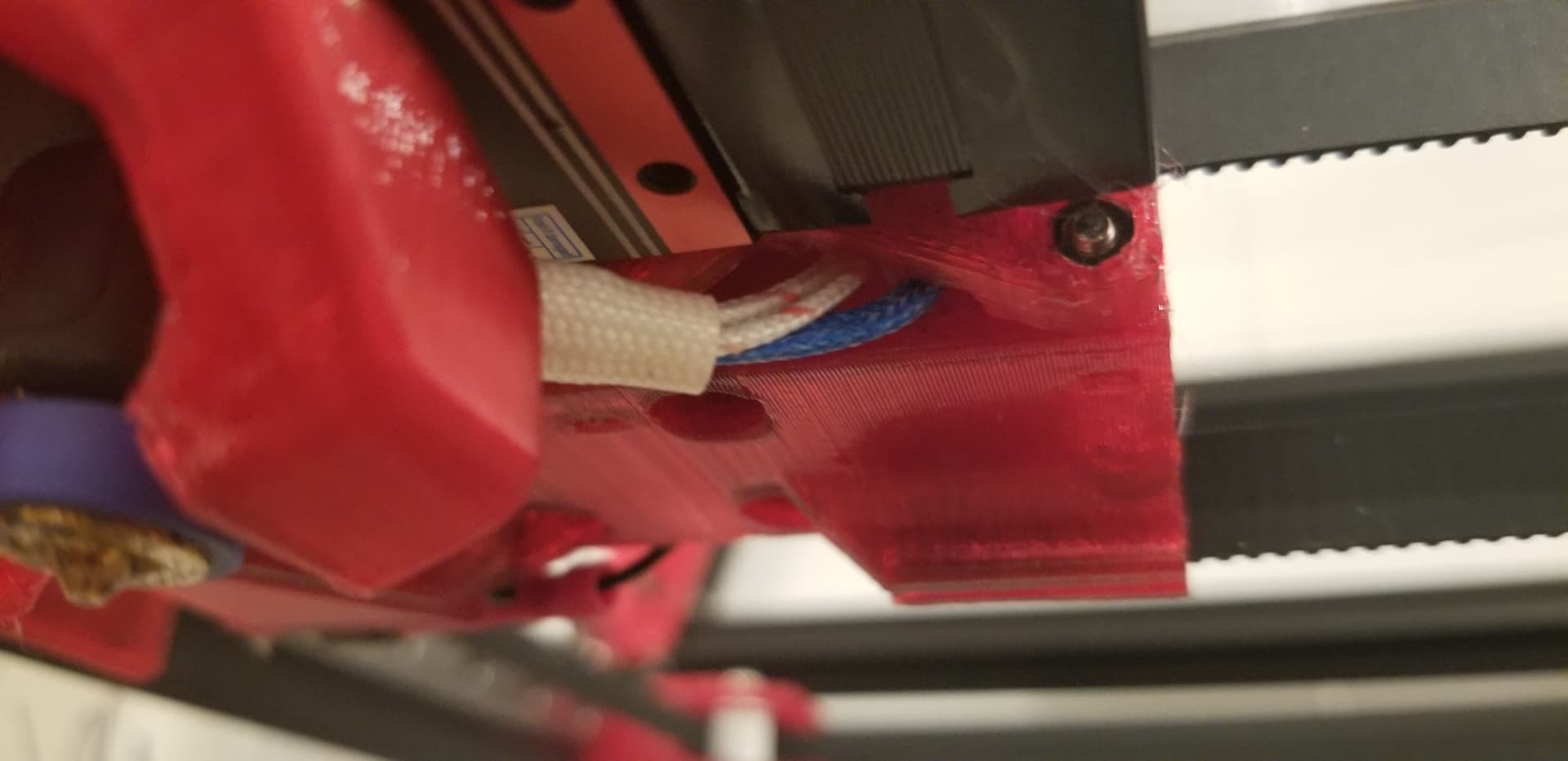

Hot-end wiring for power and thermostat need a path up to CAN Bus (or umbilical). Easy to channel in 3D printed Core. With milled/laser cut plates routing may require hole, or, (milled) recess channel in the plate, if the backside is a busy/restricted.
Pic above shows Mike’s H2 adaptor mount which includes a channel for hotend wiring.

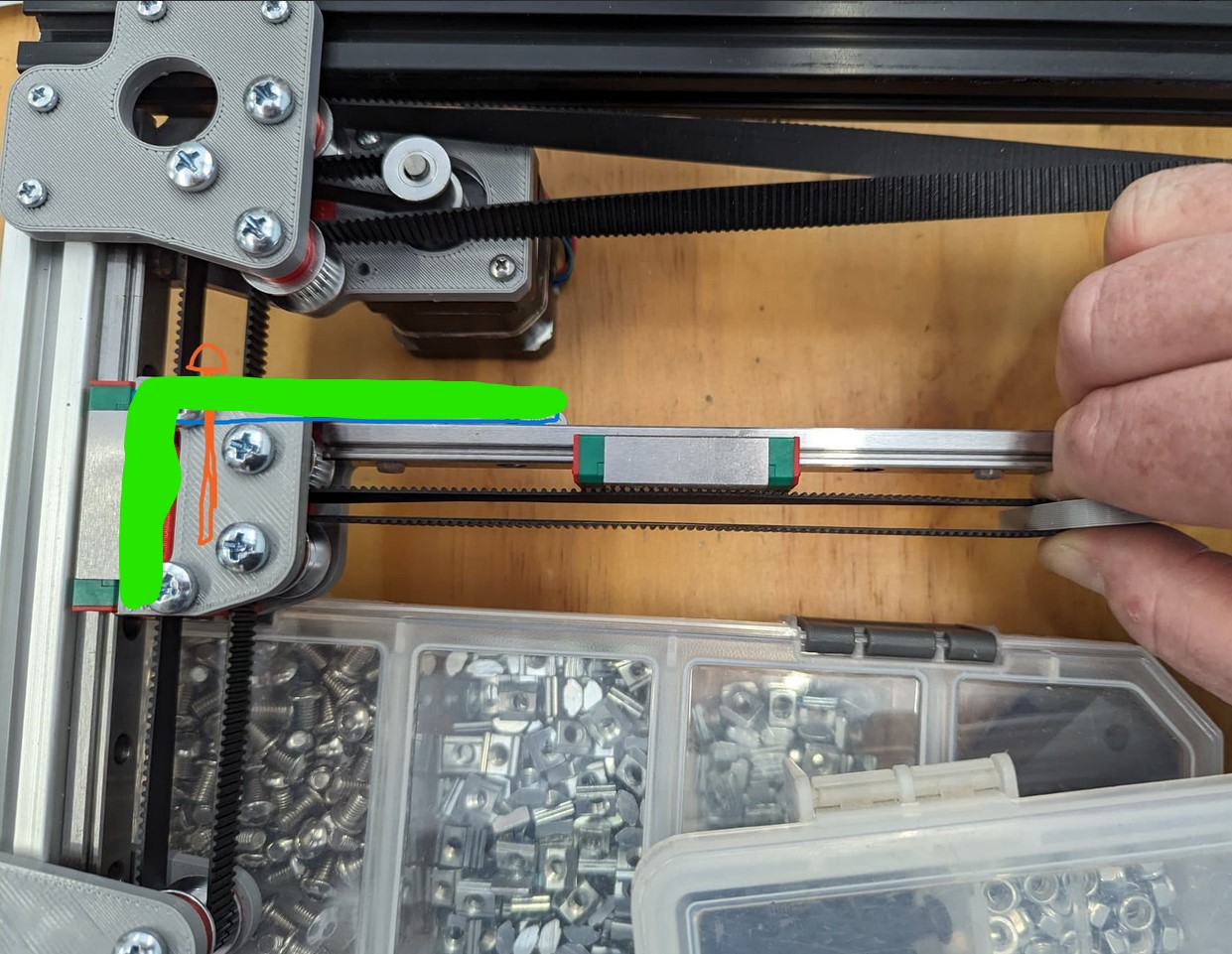

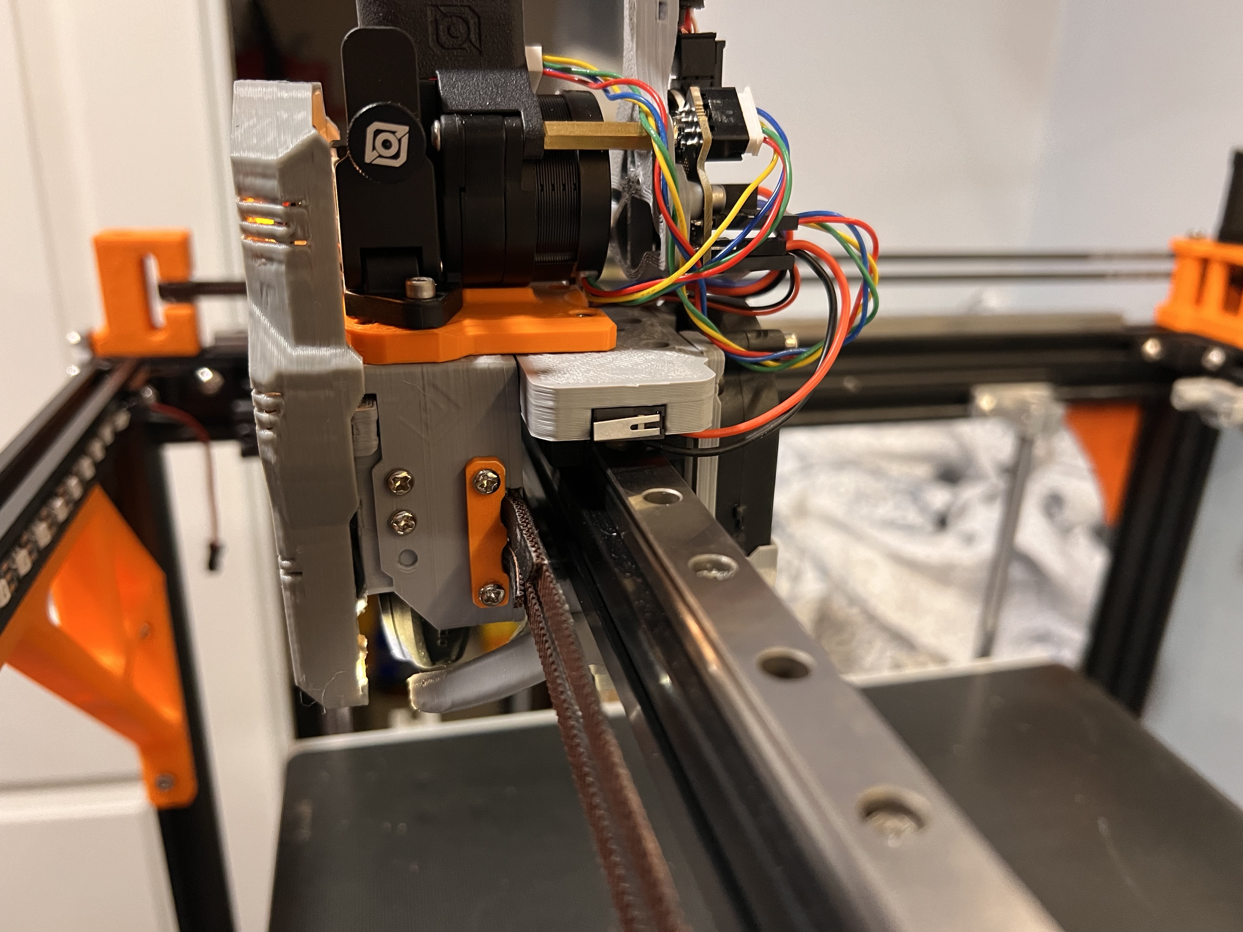

Here is how my setup is on the E5+. I get its different but just some things to look at. Belts could be easily modified to come in together and without the extrusion the whole thing has plenty of room to move around/adjust. Tons of different mounting options already designed for it. Tons of different cooling options already designed for it. This is an orbiter v2 and a Rapido HF. Separate units with a short piece of PTFE in between going though a printed part that could easily be an aluminum plate instead. I know we aren’t quite to this topic yet but this is to give some ideas on different setups other than just the hemera style one piece extruder/hotned. The current V4 is locked to that style without major cad work to make it all mount. Maybe not major to some of you but it is to me.

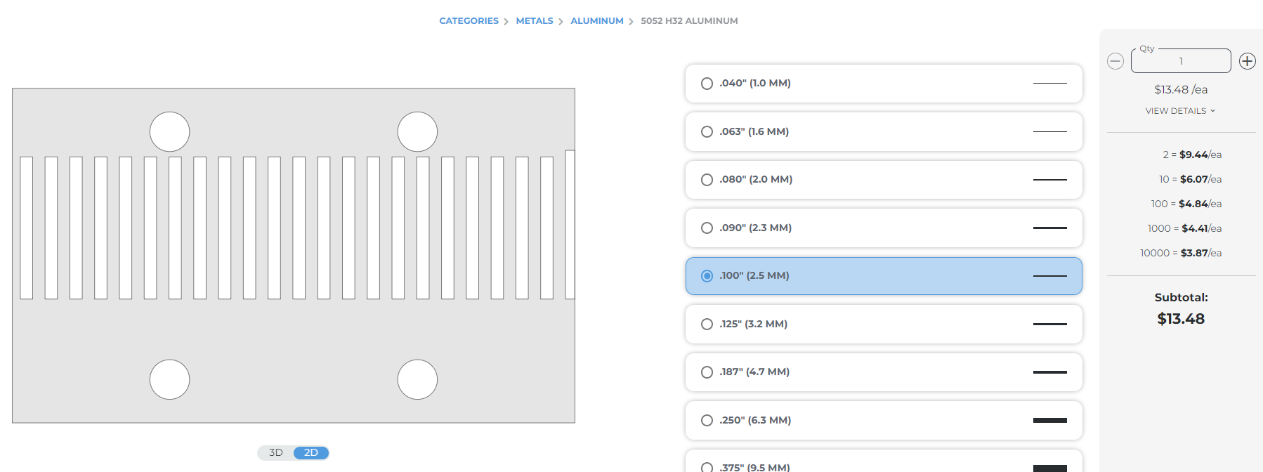

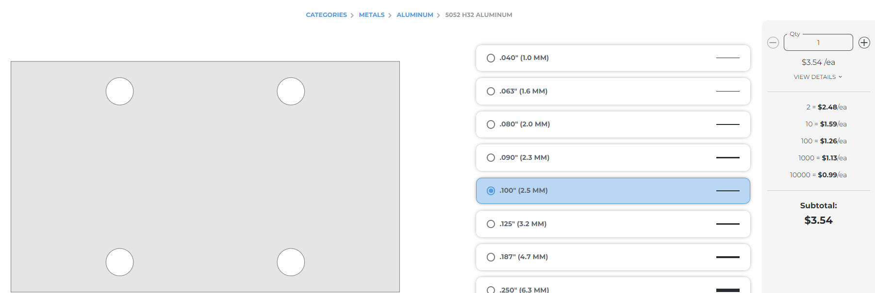

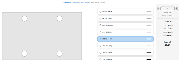

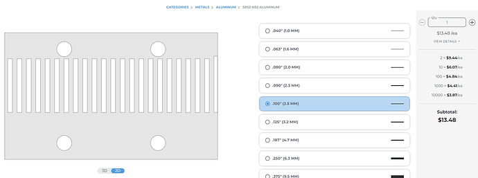

Checked how accurate laser cut plates are…
Checked price difference for making grill plates…
Another reminder of how relatively cheap, and easy 3D printing parts is.
To avoid 2nd plate from rocking (or Extruder if just using one plate), then, would you need printed parts, or be able to recess channels in the metal plate (adding to plate labor/cost…).

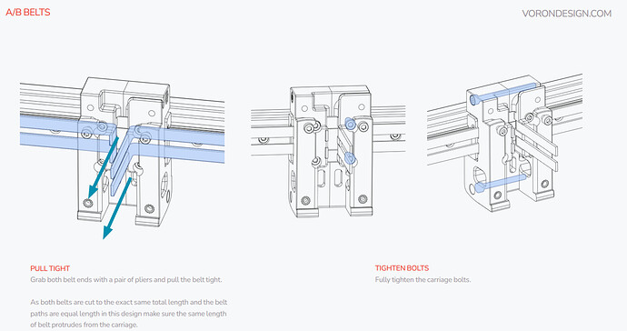

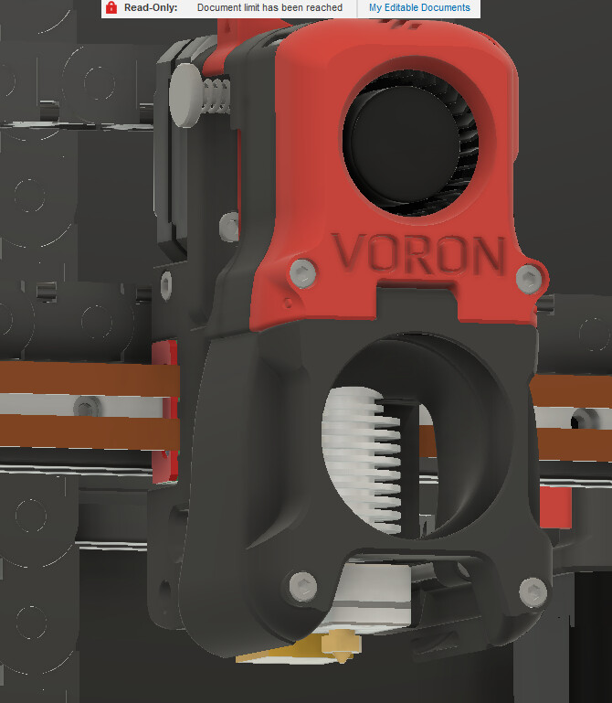

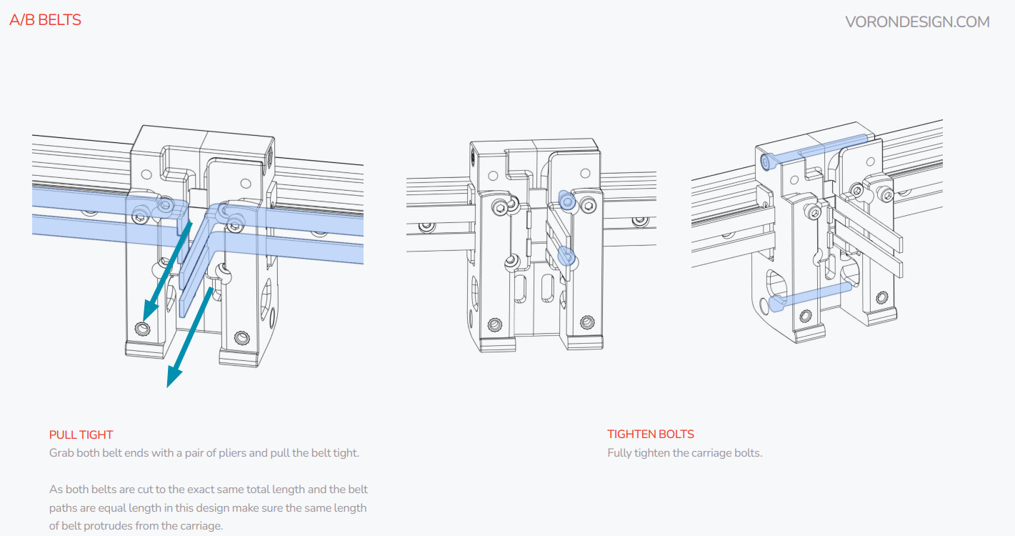

fwiw, looked at Stealthburner used on Voron. Stack belts right against the rail block, nice. But then…
Induction sensor is located closer to linear rail than hotend :man_shrugging:

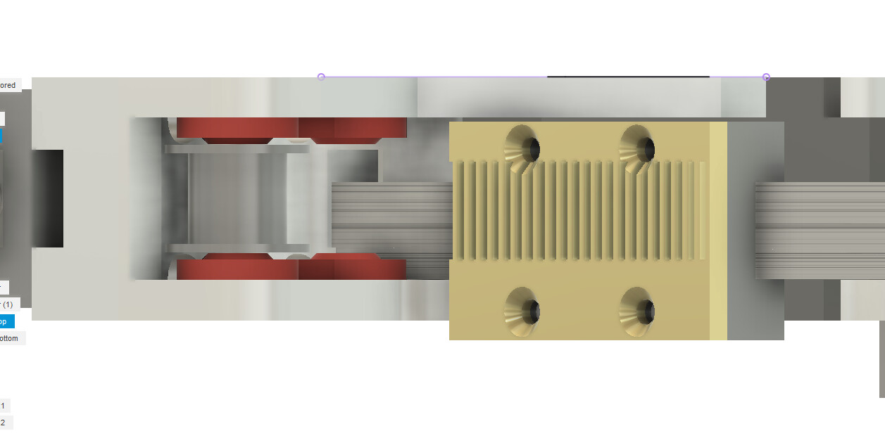

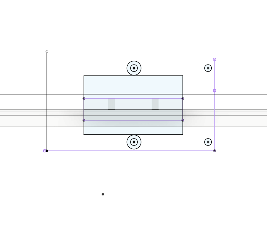

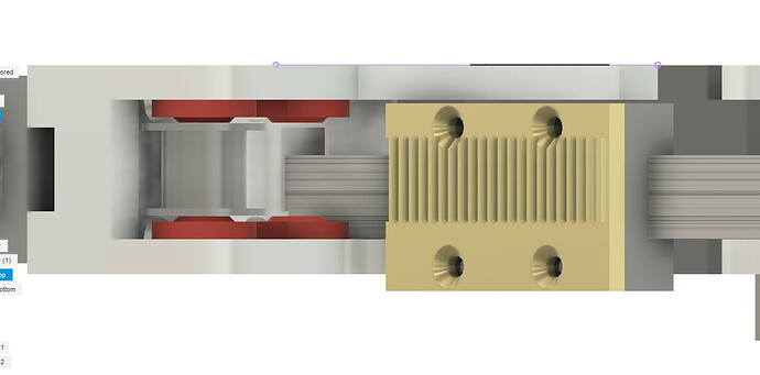

Briefly looked at where Hemera mount holes, and rail block holes are relative to each other. Single plate looks possible if plate holes have countersunk bolts…
But, during assembly, would probably need to insert countersunk bolts for the extruder (but not fasten), before mounting plate to rail block.
Left-right center of mass will likely be off because of how close the inner most countersunk bolts will be. Don’t know if that matters much.
Even with all those holes, there’s room for belts too across the rail block, but would need to mill a channel. Ok for one off personal use, but $$$ to outsource? So, guessing 3D printed one plate with holes and recesses/channels for belts would be good enough for most people.
If belts along the X rail end up with teeth facing each other, then maybe there’s an opportunity for them to grip one another. e.g. Belts enter from the sides, then routed to be smushed/meshed together, pinned in place against the rail block, when the one plate is fastened to the rail block.

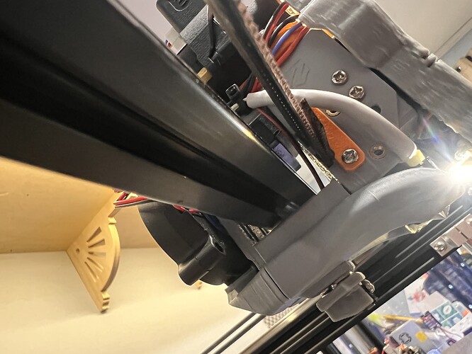

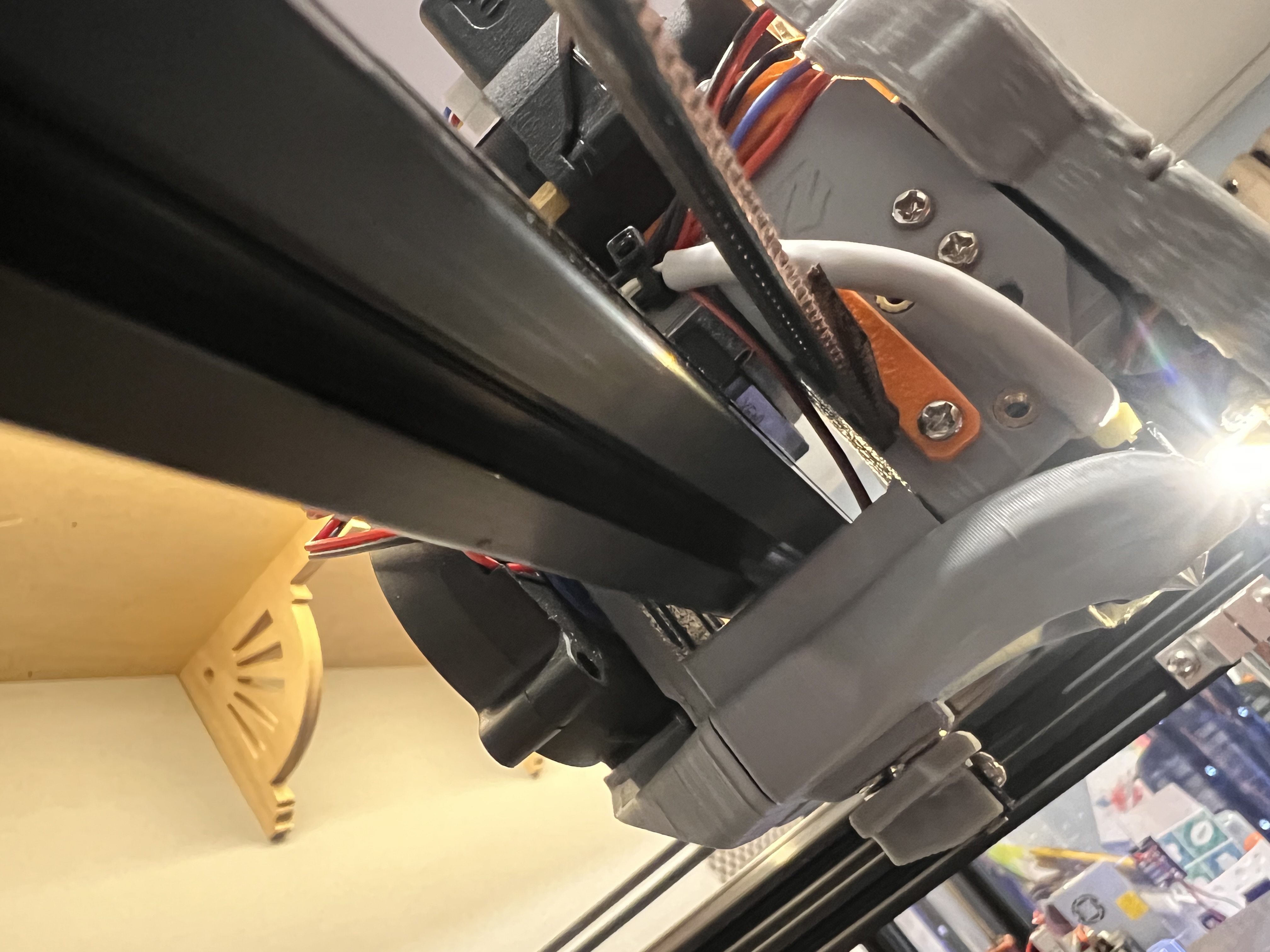

as an example, look at the different options available to this toolhead I am installing on my E5s1.
https://www.printables.com/model/539219-evantis-5015s-toolhead
For vertical bearing related to belt location. What about moving the rail forward so the belts ran behind the rail opposite the bearing block. Belts on one side, bearing and extruder on the other.

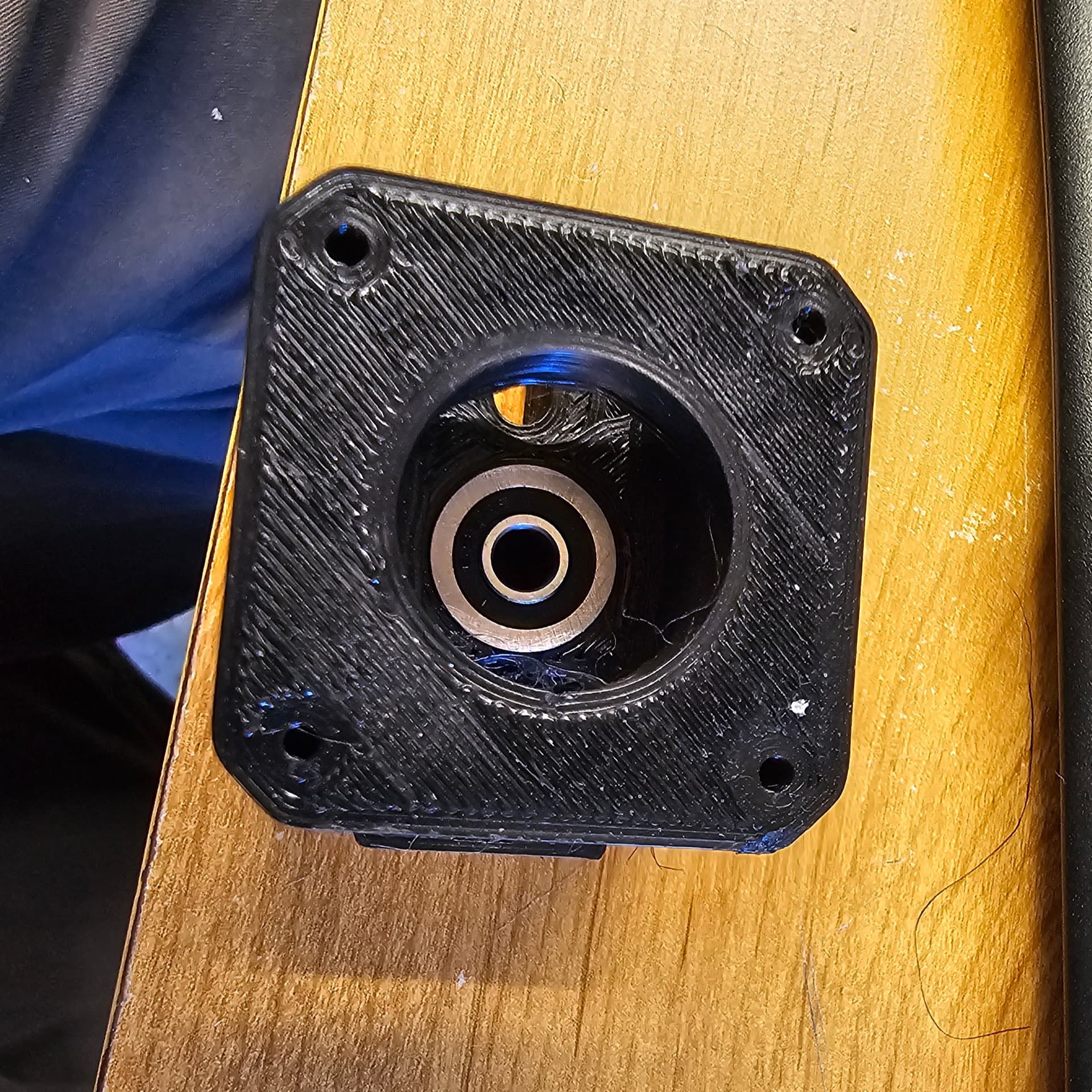

this is interesting, but I would rather see the motor shaft supported by a bearing of some sort opposite the motor. This motor stand for example mount the motor shaft down, through the toothed pulley into the bearing. Makes for a much stronger shaft with alot less play. Also holds up to the force of the belts in motion better esp in a heated (either passive or active) chamber.

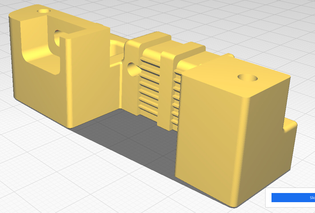

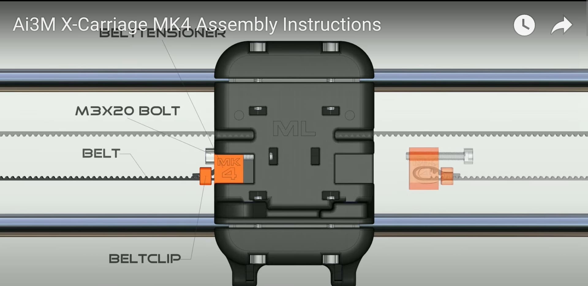

this is ancient technology from back in my AI3M days, but look at the belt mounting on this toolhead. Its for a bed slinger so things arent 100% the same, but the idea is still pretty good imo. Belt swap can be done with the entire toolhead in place and it gives room for fine tuning tension.

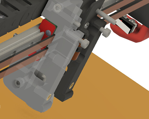

Screenshot from neat Solidworks Composer based assembly video https://youtu.be/LadxXGYkU20?si=chBJK_c4Sm_lBA75

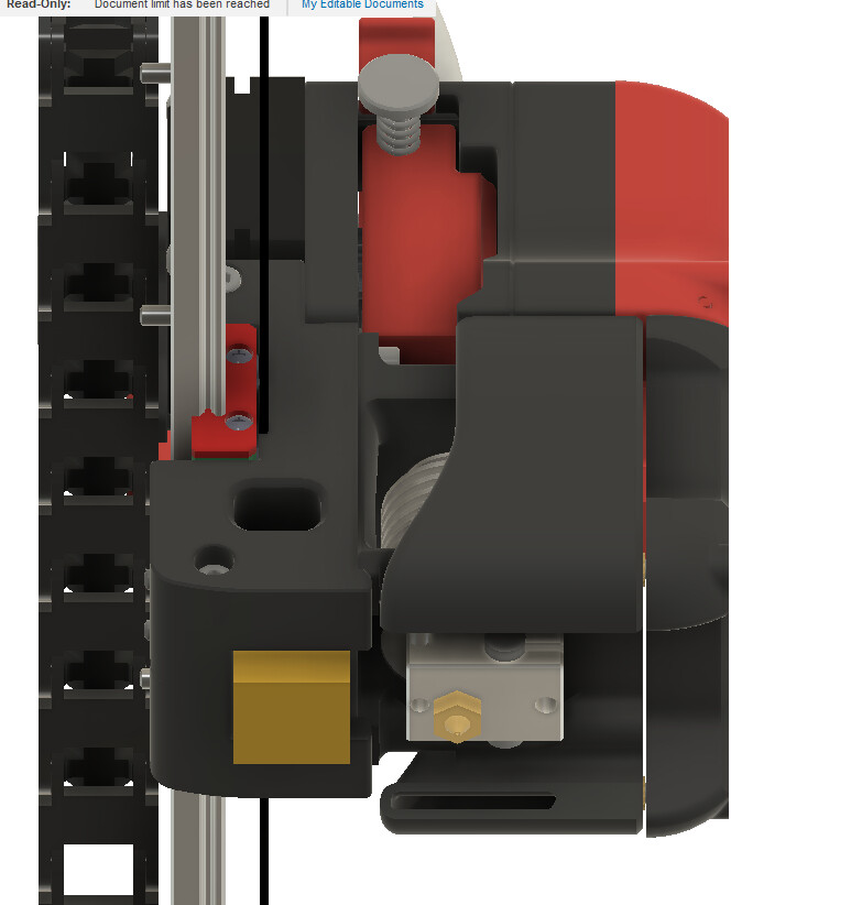

I dont fully understand your question? Yes we could use as many holes and screws as we want. On that design it only needed one. Esp with the captive nut design because you had steel on steel for not going anywhere grip with a decent amount of plastic in the middle. I was just showing the method as an idea not a specific “do exactly this” type of thing.
They fit fine either way. With the vertical rail you are absolutely locked into vertical position. The purple shows the horizontal block there is room to move it up and down.
That point is the nozzle tip. The closer that is to the rail the more efficently we use the Z axis space (that is where the bed would start).
  • note the hemera is the Worst case scenario, not necessarily the recommended. If the hemera fits everything else should as well.

It would work but to go behind you need to go behind the bearing, rail, and rail nuts. Also fine, but that expands the width of the Y truck to be able to spread the idlers.
The steppers are very able to handle the correct belt tension, but we did discuss this earlier, you can simply add one to the top plate. (I have some steppers that have been in use 24/7 for years on end with no signs of failing)
I do like supporting the shaft, in this case it is just not going to be the default, but there is sufficient room to easily add one.

Looks like what we are aiming for, just a looped belt, just no need for extra hardware. we are moving the hardware off the moving head to adjust tension at the front idlers
