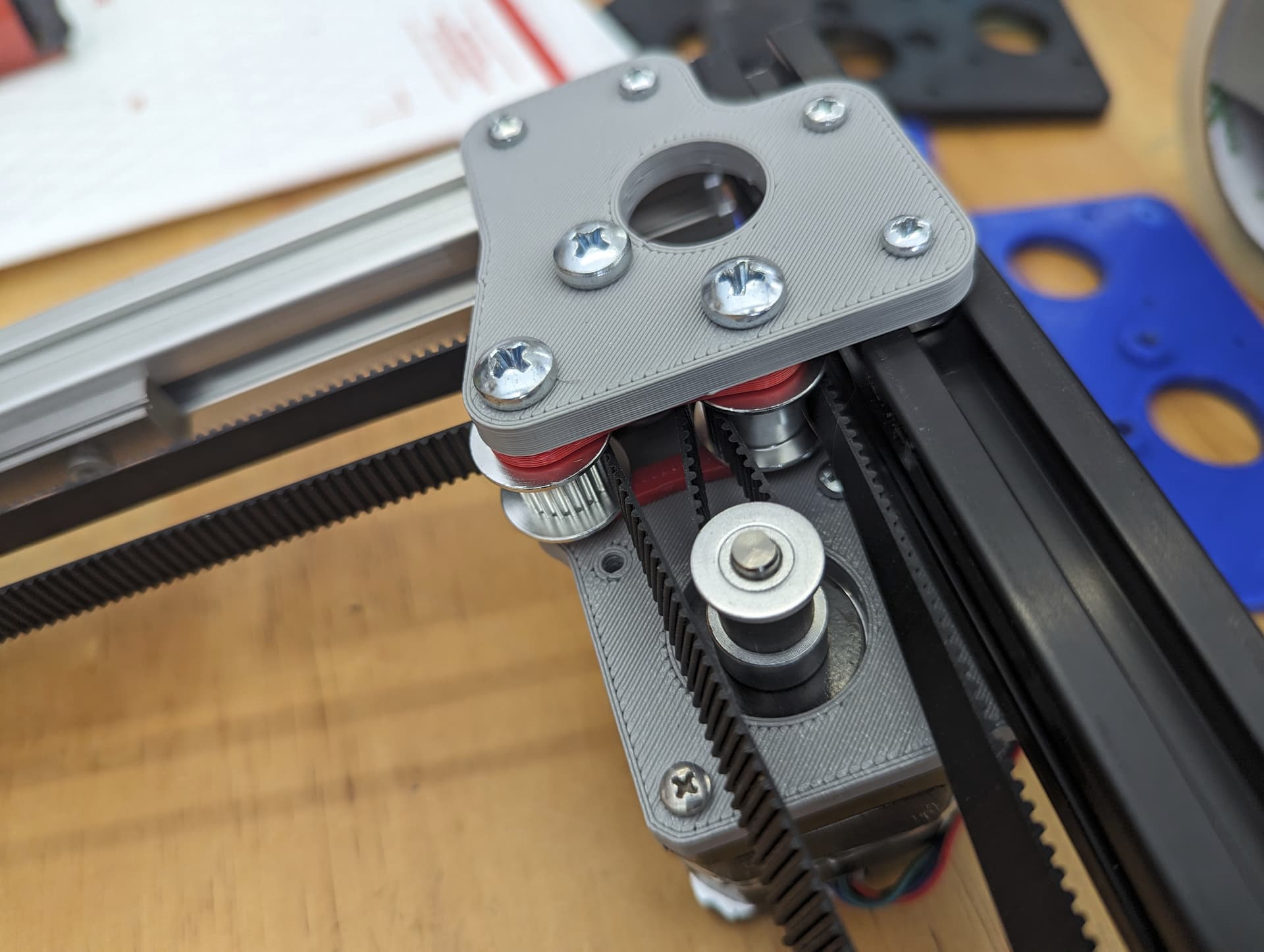

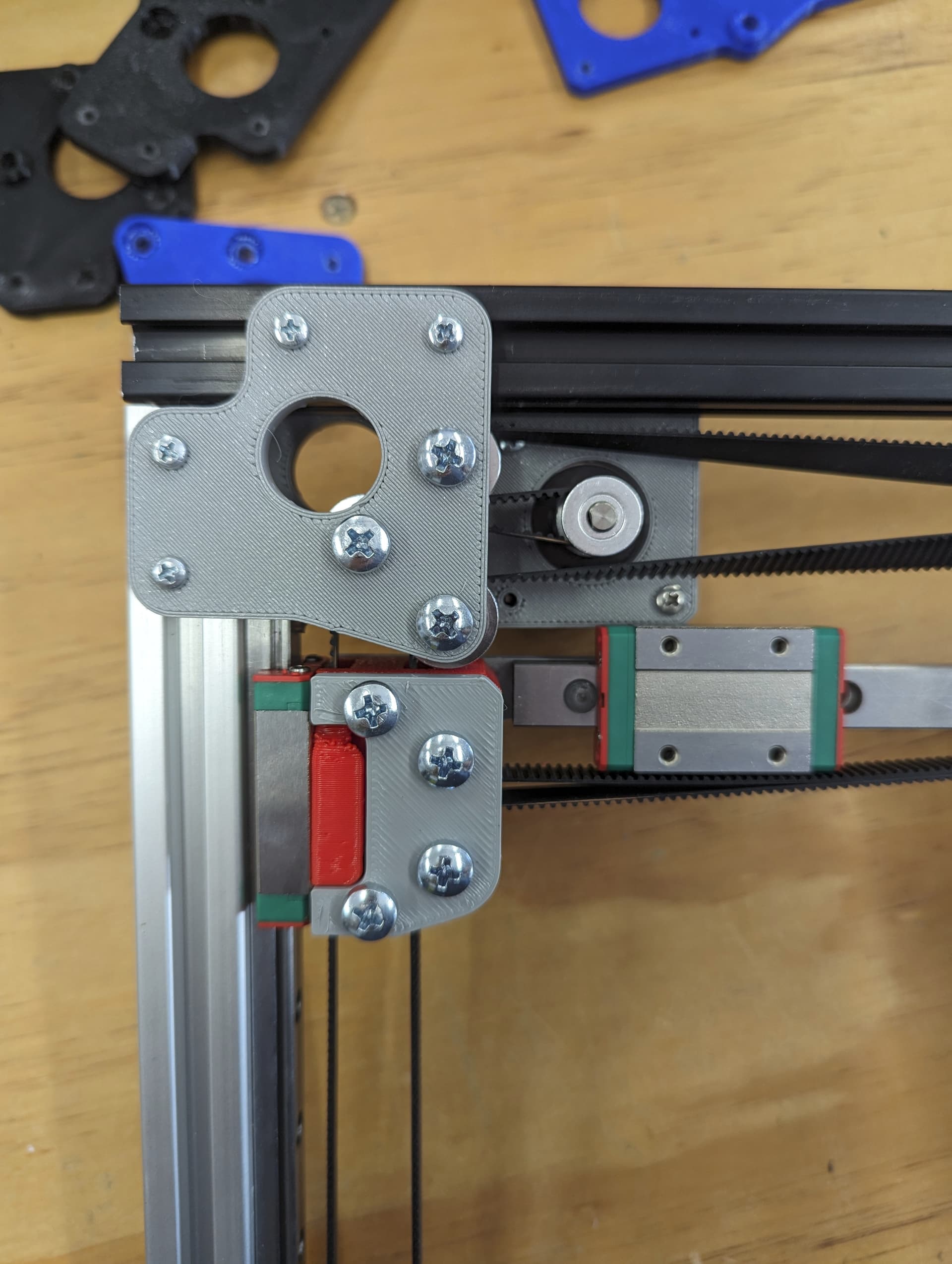

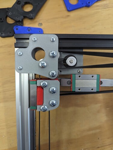

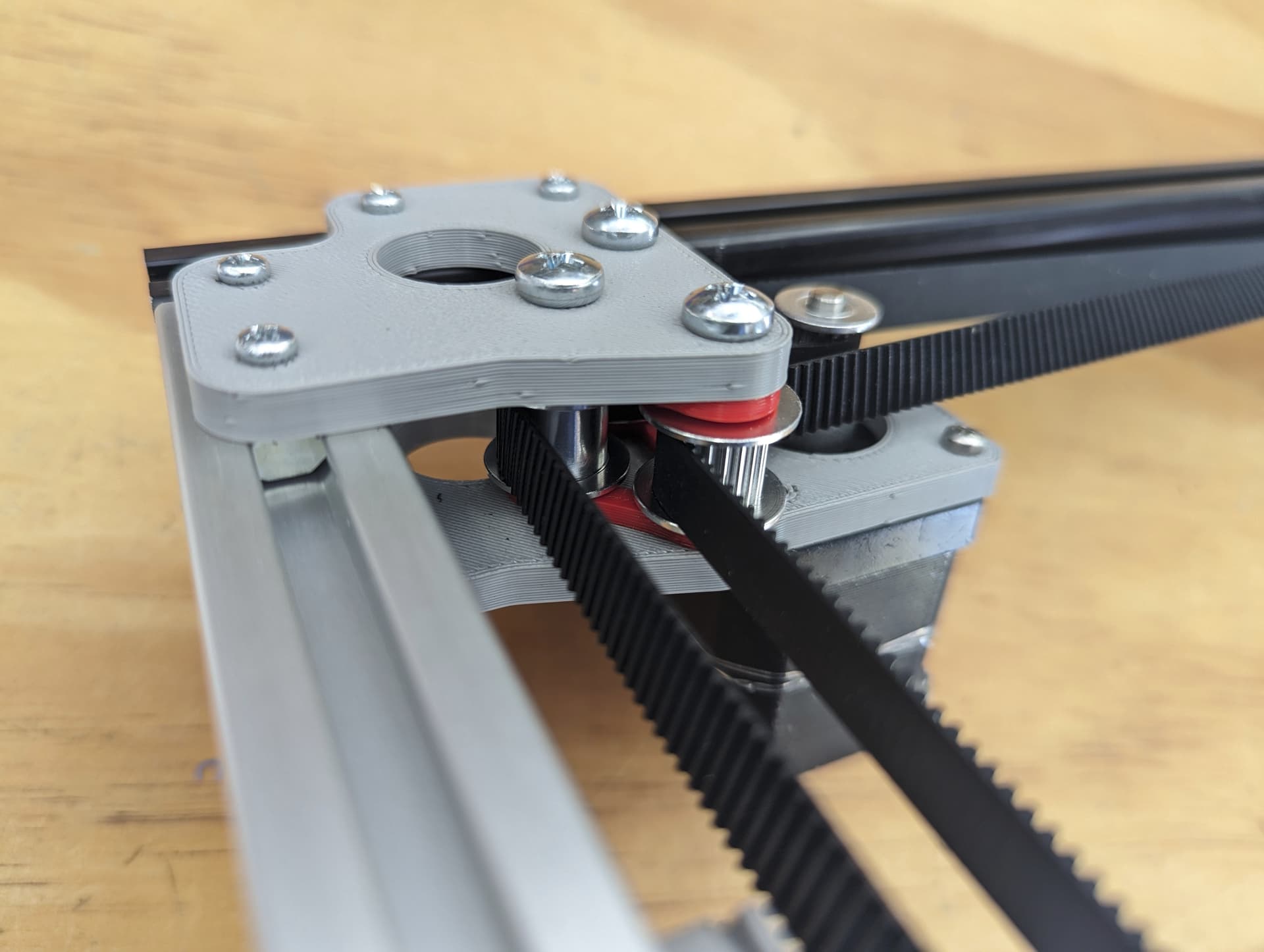

So far so good. Just need a few little tweaks.

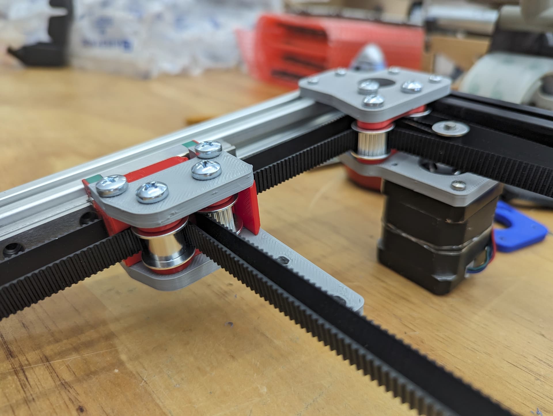

Once we get closer to extruder territory we can all a little more meat to the Truck I think. The printed part is a bit smaller in real life than I assumed…fits great but some walls are a bit small.

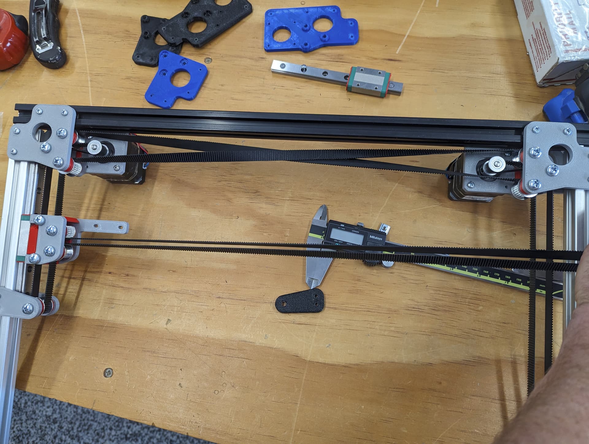

Damn that looks good! Can we see the whole belt run how you have it there?
I only have the one truck on.
No room at all behind the bearing…perfect fit.
This angle is how I am going to add some beef to this side, it is similar on the other end (front of the build).

So now maybe whip up the PTFE spacer for the crossover.
Looking at it 3mm plate would be more than enough. I know we all like overkill…but the rail support piece looks real good in 5mm the rest looks way over board.
