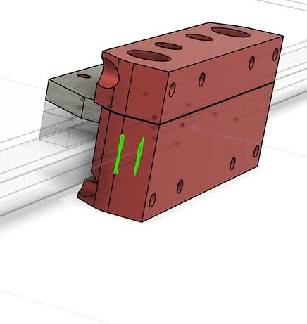

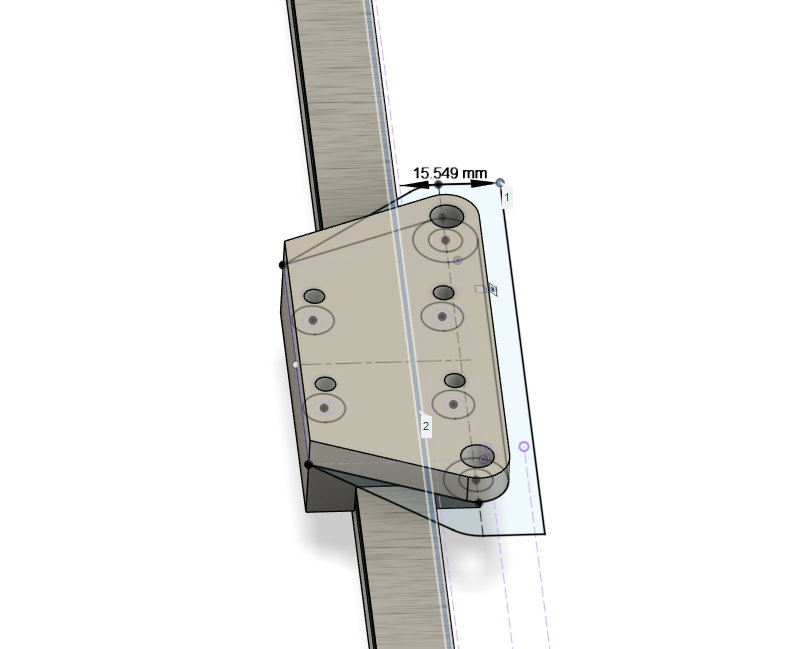

How are we with the Horizontal rail? Are we willing to give up the X linear rail mounting plate to have a vertical rail?

Horizontal rail with car on top for easy access.

@vicious1 The plate pulley holders look good as does the crossing belts. The low slung fan is something I was thinking about yesterday having had to reprint my part cooling fan mount and trying to think of a smaller simpler setup. I wasn’t sure how that would work and if there was sufficient clearance for it, but interested.
I like the bearing block on top too.

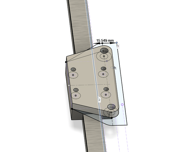

Does “X linear rail mounting plate” mean the plate attached to Y truck that connects X linear rail to Y rail? i.e XY mounting plate?
LOL, I still like vertical :slight_smile: But, I don’t have additional reasoning to support beyond what people have said already. I don’t feel strongly enough to push that hard on this. For example, I haven’t fully considered various tradeoffs/consequences/opportunities of how vertical X rail positively and/or negatively impacts mounting to Y rail.

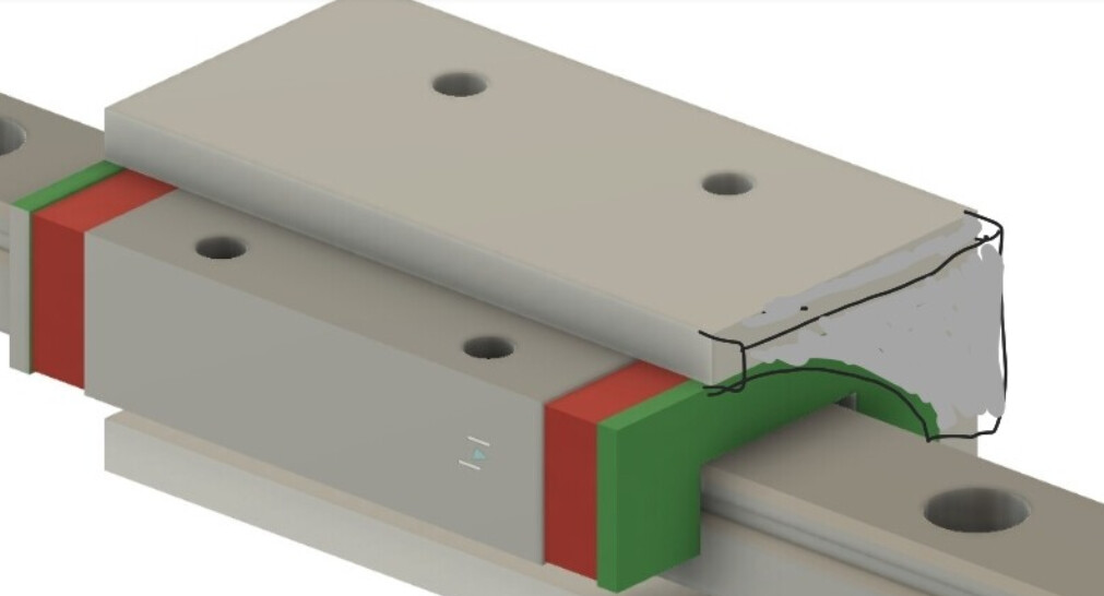

I am wondering whether tool changer will be easier, and making adapter plates for diff extruders too. Personally like the idea of direct contact between rail block and extruder. Ideally the belts are sandwiched between the 2 3mm (or 2.5mm) plates.

Do you think your two plate method is better than the direct mount that is coming along?
Those would need fine teeth milled in to work??
It seems like either way we have a plate on the bearing surface adapters could be made I suppose. I am not seeing a tool changer as a huge design driver unless you have something in mind you want to make work. Either way the belts need to be mounted to a plate and the tools attach to a plate. Without a current design to accommodate I am not really seeing how one is better than the other.
The part we will lose though is the flat plate to mount the X rail on. Is a possible future toolchanger that happens to use a vertical bearing instead of horizontal a reason to ditch what seems to be a good, solid way to mount the rail?
With this two plate system, what is the advantage vs just using one? Is the red one just to stand-off from the screw head in the yellow? If the yellow had a counter bored screw hole would it be better as a direct connection to the extruder?
Or are you just saying you want the belt s mounted in a plate, not the current way. I guess what I am getting at is I am not seeing what the biggest advantage of this is?
With this it is still a flat vertical mounting surface, the screws come into the extruder from the back.
I still like vertical, I like having the moving mass as close as possible to the axis center, but it’s not a big thing. The rail being mounted to an aluminum plate like that is probably a bigger benefit if we can’t have that with vertical.
This is what I am thinking.

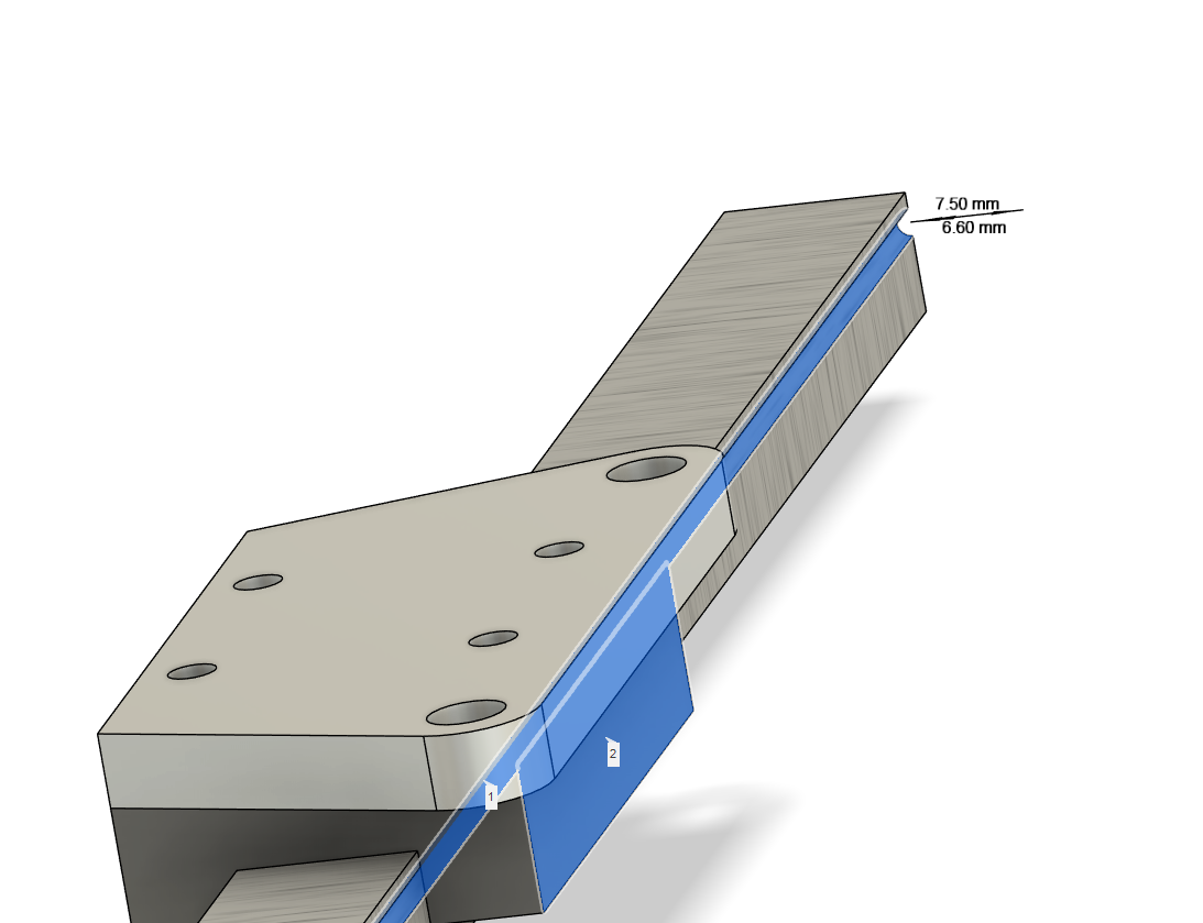

I think the balls are the point of contact, so the closer to the actual ball bearing is the actual point that matters. If that is true it is not all that different.
Then sprinkle on a little, the rail is stronger this way and the force it greater in this plane because of accelerations. (although I think this is negligible)

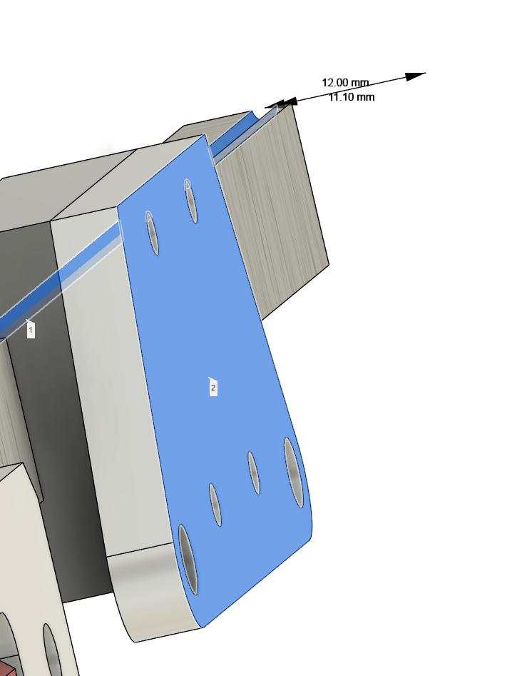

Just taking a quick look, if the bearings are the part to consider. A vertical mount gets us 12mm to the face, as this sits we are at ~16mm to the face.
4mm is more than I expected.
I can bring that down to 7.5 if I move the belts a little bit.
If you think that is the correct thinking, I will start moving the belts.

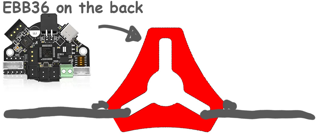

  • Will mounting EBB/CAN Bus, securing wiring, and other stuff needed be easier/harder with either arrangement? Briefly thinking/asking about overall hotend assembly incase that helps nudge towards a specific direction.
  • Maybe you end up with a practical plate that’s raised in the middle?
    e.g. Rough sketch… Center would likely need to be filled for misc extruder mounting holes, hopefully with polycarbonate, LED backlit of course…
Am going back to look at your earlier questions, and try to respond, but wanted to share this half arsed idea incase it sparks something useful.
