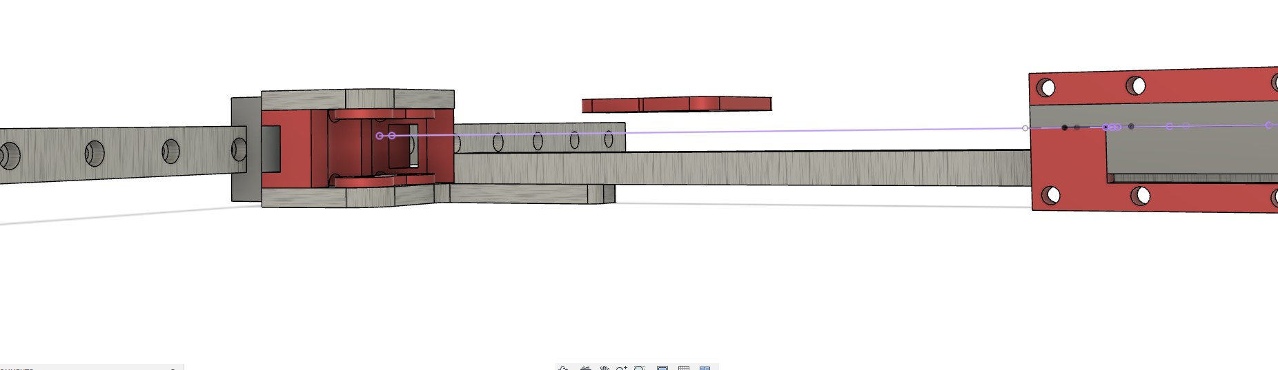

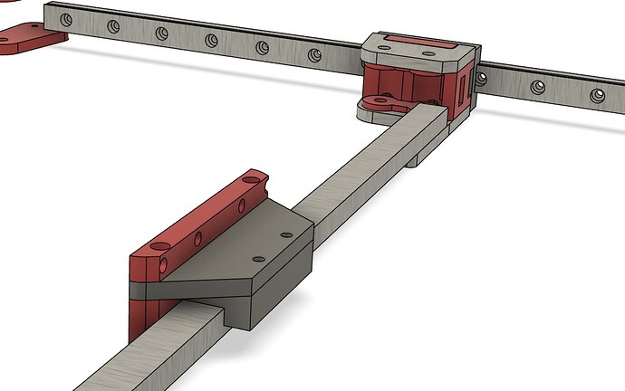

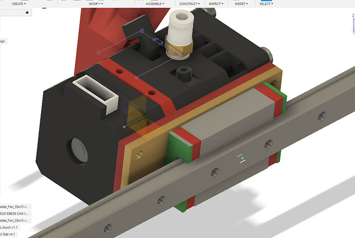

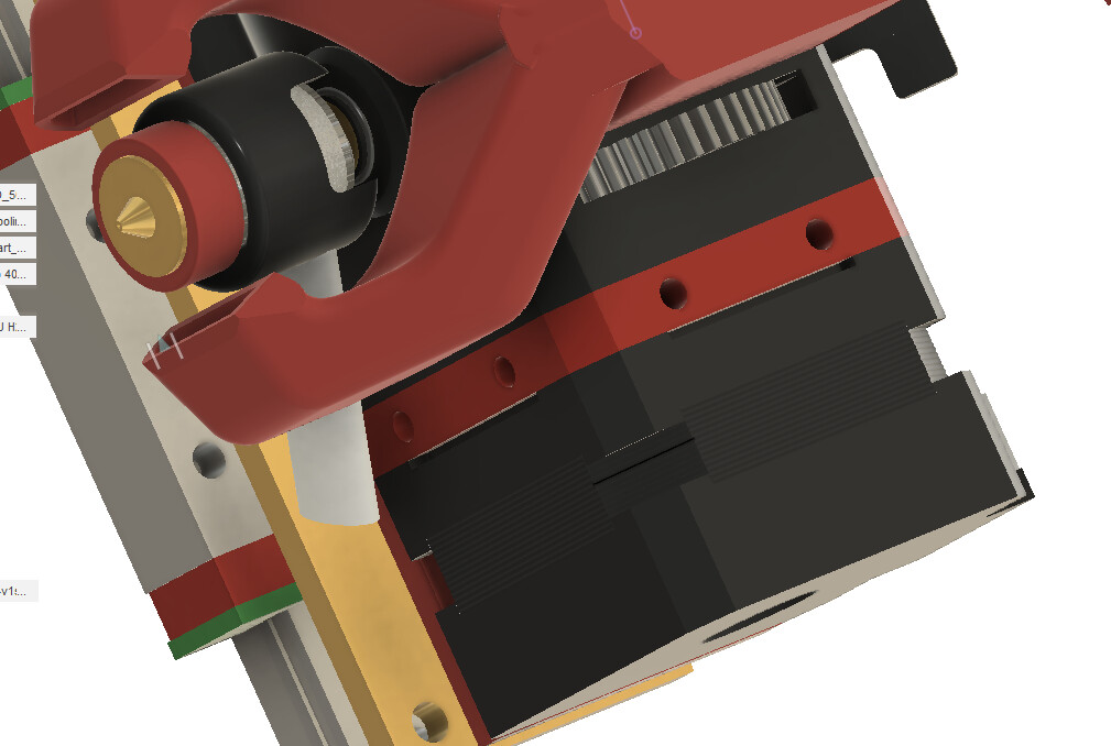

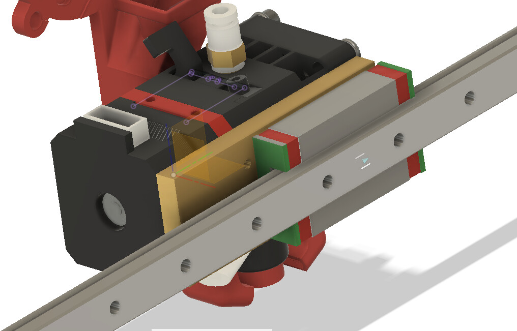

The new picture probably helps explain it?
With small parts like this I do not think it is as important. A large giant plate yes, but these small plates would not error stack much. A few tenths of a mm width is nothing.
Yes. I think so anyways. That’s the Y rail and truck there and the mount where it would be on the x rail.
I still say if going flat I would prefer the bearing to be on top. That just makes it where I don’t have to stand on my head to get the screws lined up. And will make it not only rely on the screw heads to hold it to the block but also gravity lol. I’m sure at this light weight that doesn’t matter but it just sounds better in my head lol
Yeah I don’t disagree there. But still a good time to double check square and stuff like that if you haven’t in a while lol. I know I checked mine before cutting the panels for the E5+ and it was still dead on. Always nice to see.
Thank you for taking the time to explain it better. Your timing with this is perfect. Much needed distraction!!
I like the lower mount with the carriage facing up. I expect you could use the rail and a portion of the sandwich on the y rails to give it more strength and rigidity. Using a long screw all the way through the sandwich on the last hole of the rail maybe.

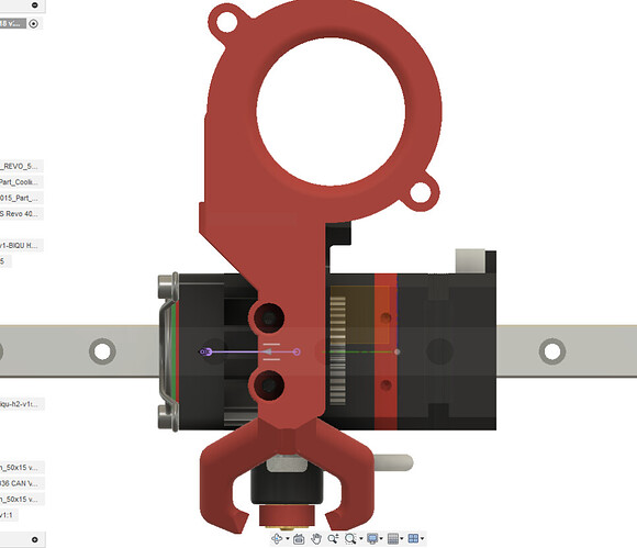

As far as the extruder, I am a fan of the H2 Series. Way more options and way less cost. I am running three of them on my different printers.
of course there is this… Smart Orbiter v3.0 – ORBITER PROJECTS
In that picture it is bearing and screws up. You said it last time and it sounded good to me as well. Why fight gravity.
It is hard to do. When I look at after the fact it I am realizing I visualize a lot of it in my head. I just imagine the parts in place and kinda don;t realize it.

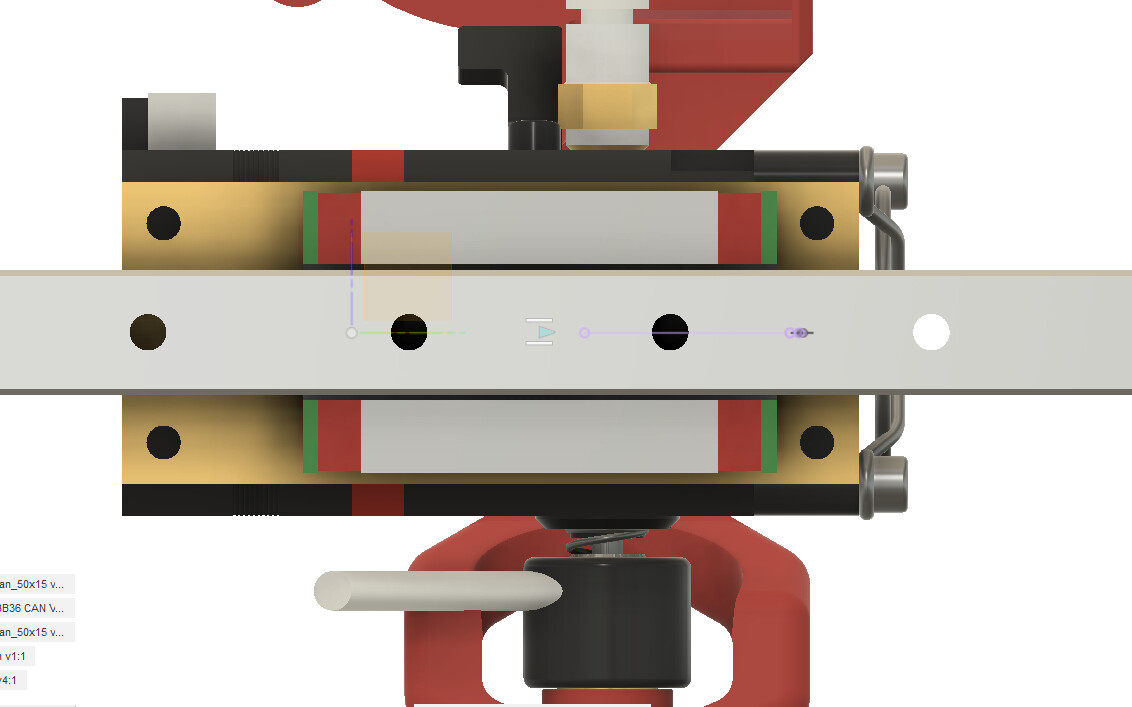

Sorry I will try and put is some rough parts so it is easier to visualize for everyone not in my head. I guess I need to be a bit more of a CAD monkey in a group setting.
exactly. The truck as shown has some things I like. The plates fight the idlers getting pulled away from each other and at the same time supports the X rail from twisting. The downside to the plate/rail is the nuts we use on the M3 (I think those will be the Tnut from the extrusion with M3x10 into a printed part to stop them from spinning).

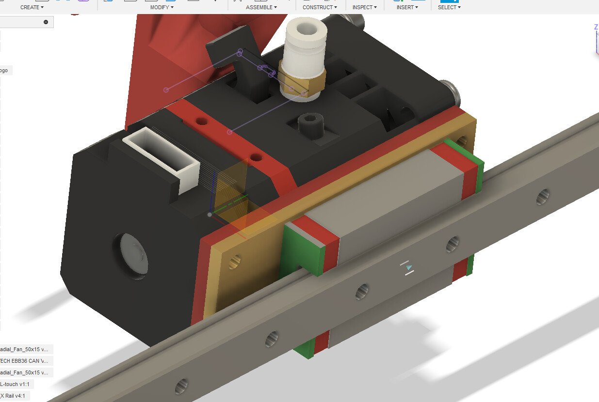

We have had a few votes for a flat rail, and one for a Vertical. I am going to take the flat a little further and see if any issues pop up.
If you want vertical let me hear your reasons. At this point to me they seem pretty 50/50. The belt routing seems slightly easier flat…I think.

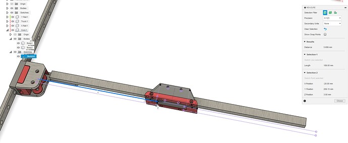

I don’t really know, though, how much deflection a 400mm rail has with just a 1-2lb toolhead riding on it.
Turning it vertical though could also cause some vibrations, I guess, in the Y direction at the center of the rail at high speeds, which is why I assume most of the ones I’ve seen have some extrusion reinforcement.

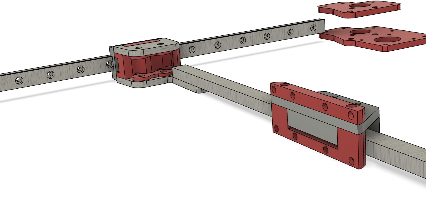

Quick rough sketch of what @niget2002’s Aluma Core experiments got me thinking about some ideas for my BIQU H2 setup…
“Core Plate” would actually end up being taller/wider with mounting holes for peripherals (EBB36) and/or 3D printed mounting parts (e.g. maybe stub for X end stop). BL Touch can mount to front holes.
That red band on the H2 has 2 holes on each side including top and bottom.

I also know there is probably very little difference in terms of beam deflection for a MGN12 with these loads. So I am indifferent in this regard. If we went to an MGN9…I might fight harder for it.
The bearing block is also equally rated in both directions (from what I remember).
Adding a beam is possible in either direction, you just have to choose where you want to add the space it will eat. In the image you show it will make a deeper printer, flat will make a taller printer.

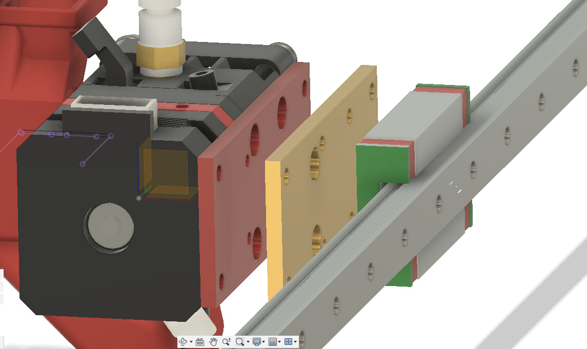

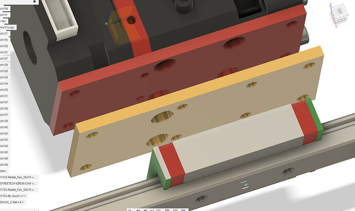

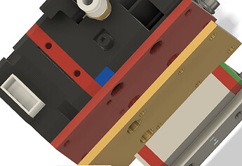

So this is what I was trying to explain earlier. With the flat horizontal plate we do not have to offset by screw head distances. In that mount you will always have to be at least one plate thickness and a screw head away from the bearing block. Turn that 90 degrees and you can have the stepper touching the bearing block.

Try it turned 90 and instead of stacking everything higher bend it over the top of the rail.
think about trying to keep all the mass as close to the very center of the rail as possible (Most importantly is where any wires attach as they add a lot of force near the extremes).

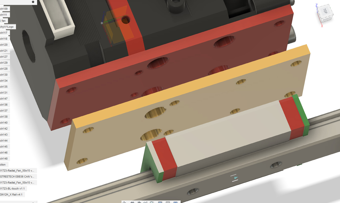

Thoughts on a two plate Core for extruders with inconsiderate hole spacing…
  • Assembly sequence…
    • Assemble Red plate to extruder using M3
    • Assemble Gold plate to rail block using M3
    • Marry Red and Gold plates using M4/M5, maybe slop on thin layer of Green Glue vibration dampening compound between the plates.
In this sketch the Red plate’s 4 corner holes would need to be tapped, since the extruder body doesn’t leave space for nuts. However… The final plates would be taller than this so EBB36 could be mounted, so in that case simpler M5 through bolt with nylock nut could be used for the top. Maybe the plate bottoms could extended down past the extruder to allow nylock nut to sneak in and hold the plates. Do this and the pair of 3mm plates becomes simple to CNC?
Are nylock nuts better/worse than threadlocker tapped holes and metal nuts?
The larger holes provide space for the ‘other plates’ button head bolts to recess. Goal was to allow simple plate fab for bolt holes, avoid needing to do chamfers.
Edit: Oh yeah, belts need to be attached… Um, maybe they can opportunistically be fastened between the plates, and/or additional small belt gripping plates would be attached…

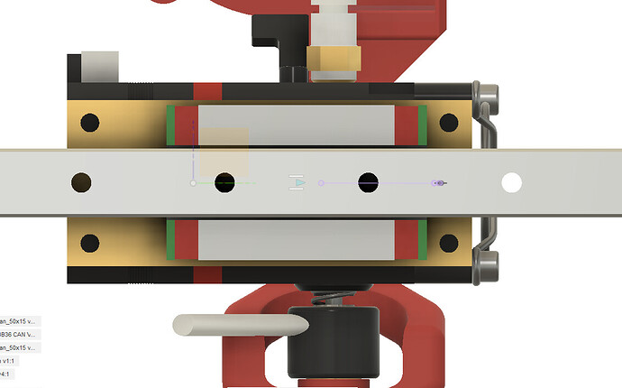

I feel like the most recent Horizontal plate screen shots I put up is the happy medium to this?
This expands the footprint. We are right up against the belts, so I suggest keeping things on 3 sides not four. So front, top and bottom.

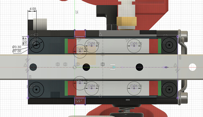

This is just trying to show a very minimal sandwich. As in how different it is to the V4. Seems rigid. Seems easy to move things up or down. Lots of room above and below.
The belts are a few mm out front so it is probably best to add a few mm, but I want to see how minimal I can get the belts as is.
belts in purple.
And now I see the belts with nowhere to go…
With the close belt this close it would need to turn away from the plate.
This config need to have an offset from the bearing, I got the belts too close. All the statements before that I said you can touch the bearing are only true from small extruders, not true for a hemera.
So a vertical rail also has to have that belt offset and that accounts for the bearing block screw heads.
