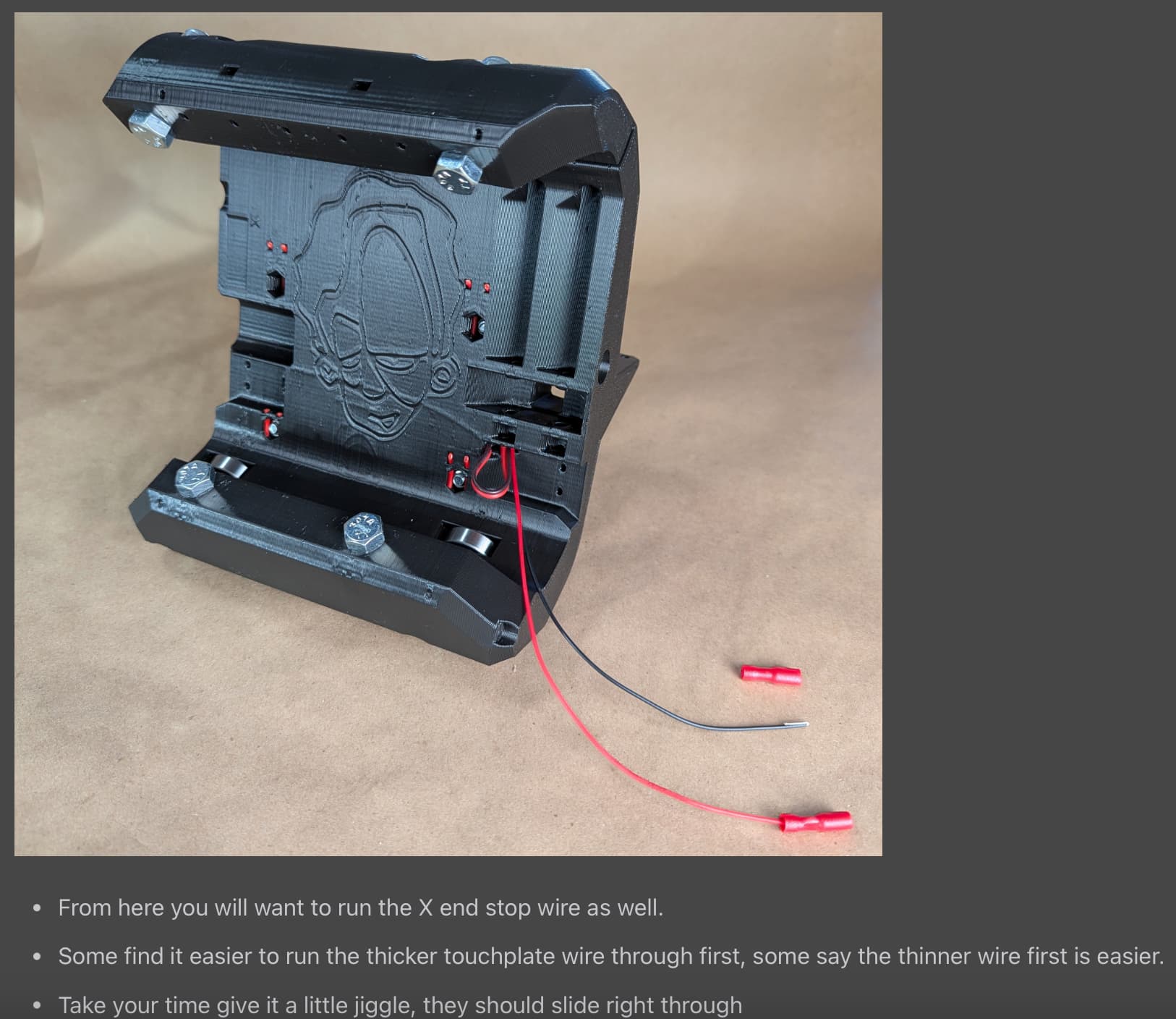

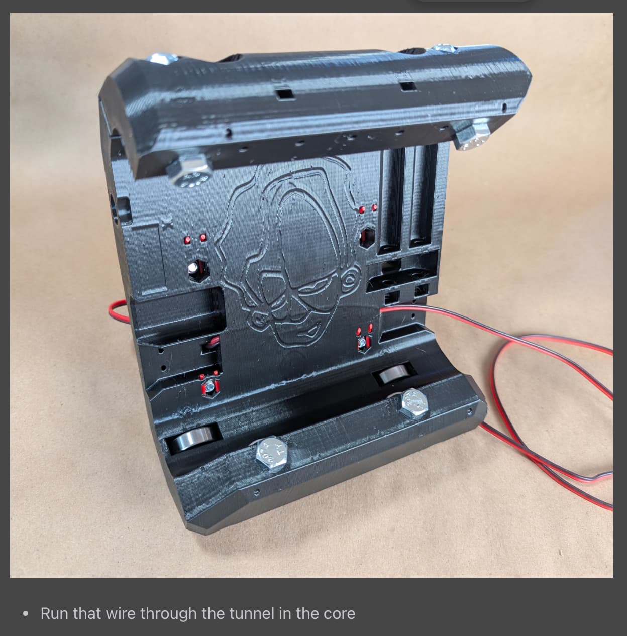

I’ve got all the bearings installed and the pressure plate wire has been ran thru its tunnel. Now I am supposed to hook up the X-stop switch, and here is where I am stumped.
I’ve done this step:
But the next step:
My Questions

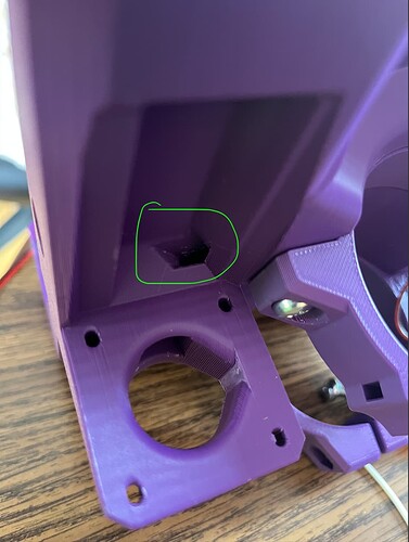

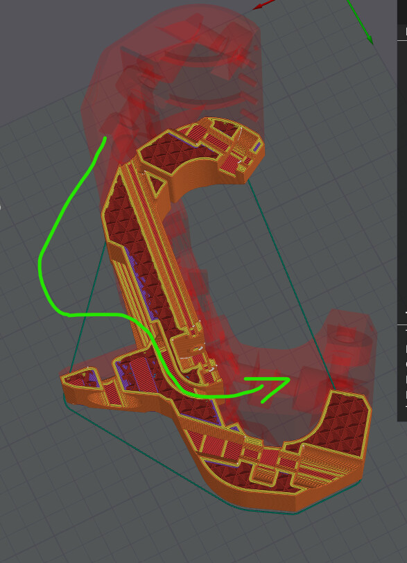

  1. Why is the pressure plate wire now folded up and pushed into some hole?
  2. Which hole is the X wire supposed to go through and how did the black connector fit through whatever hole it is using?

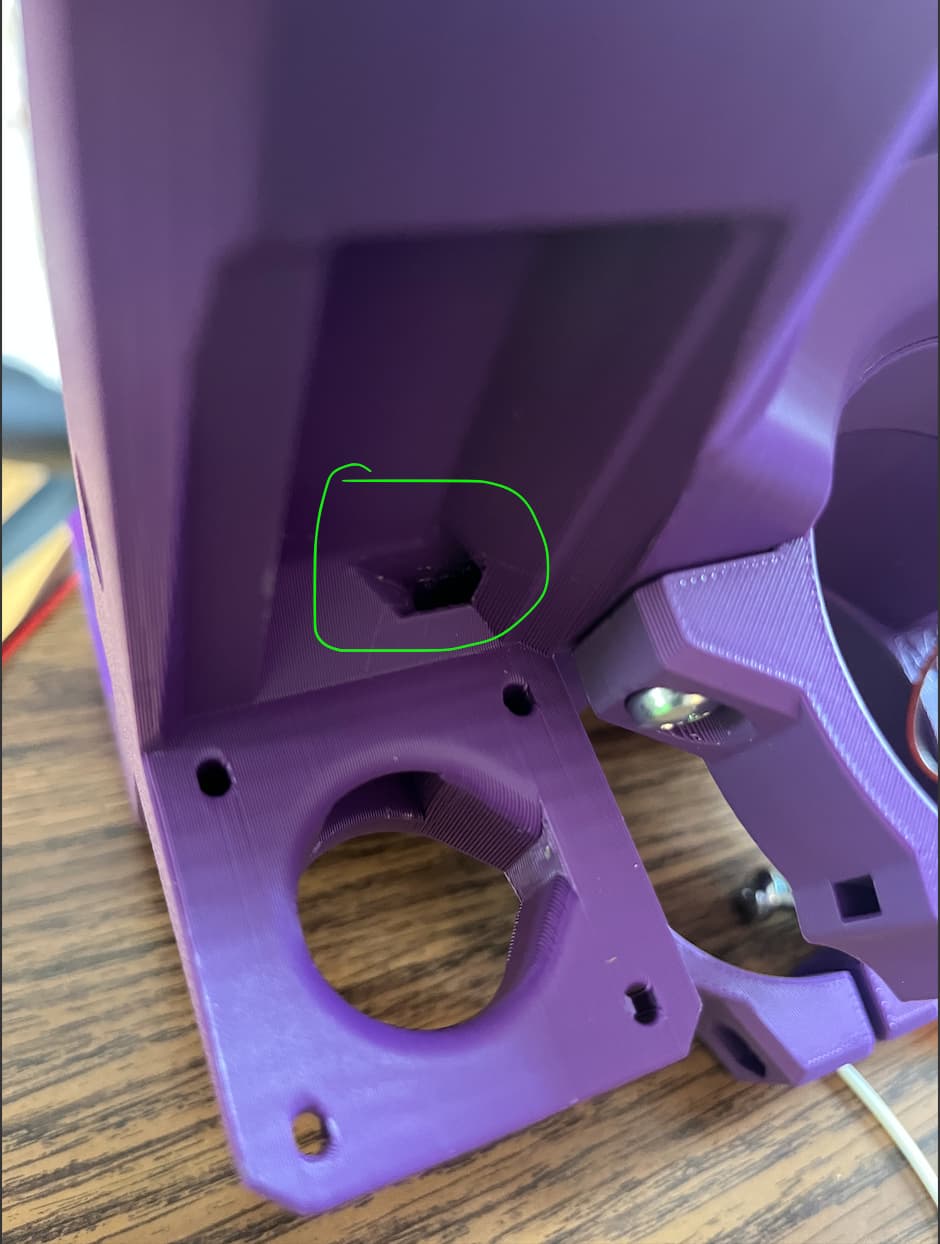

  3. The only thing I can see that might be the right hole/tunnel is this angled hole behind where the X stepper motor goes, but from what little I can see into this hole, it’s at least partially blocked by plastic… is it supposed to be that way or did my printer settings mess it up somehow?
Pic below shows the hole that I’m thinking is mistakenly blocked from the inside:
I’ve tried fishing the wires through but can’t get them to go, so there’s absolutely no way the black plastic plug end would fit through it either, which is what the instructions recommend you try if the wire-first method does not work :frowning: . Any and all help is greatly appreciated!

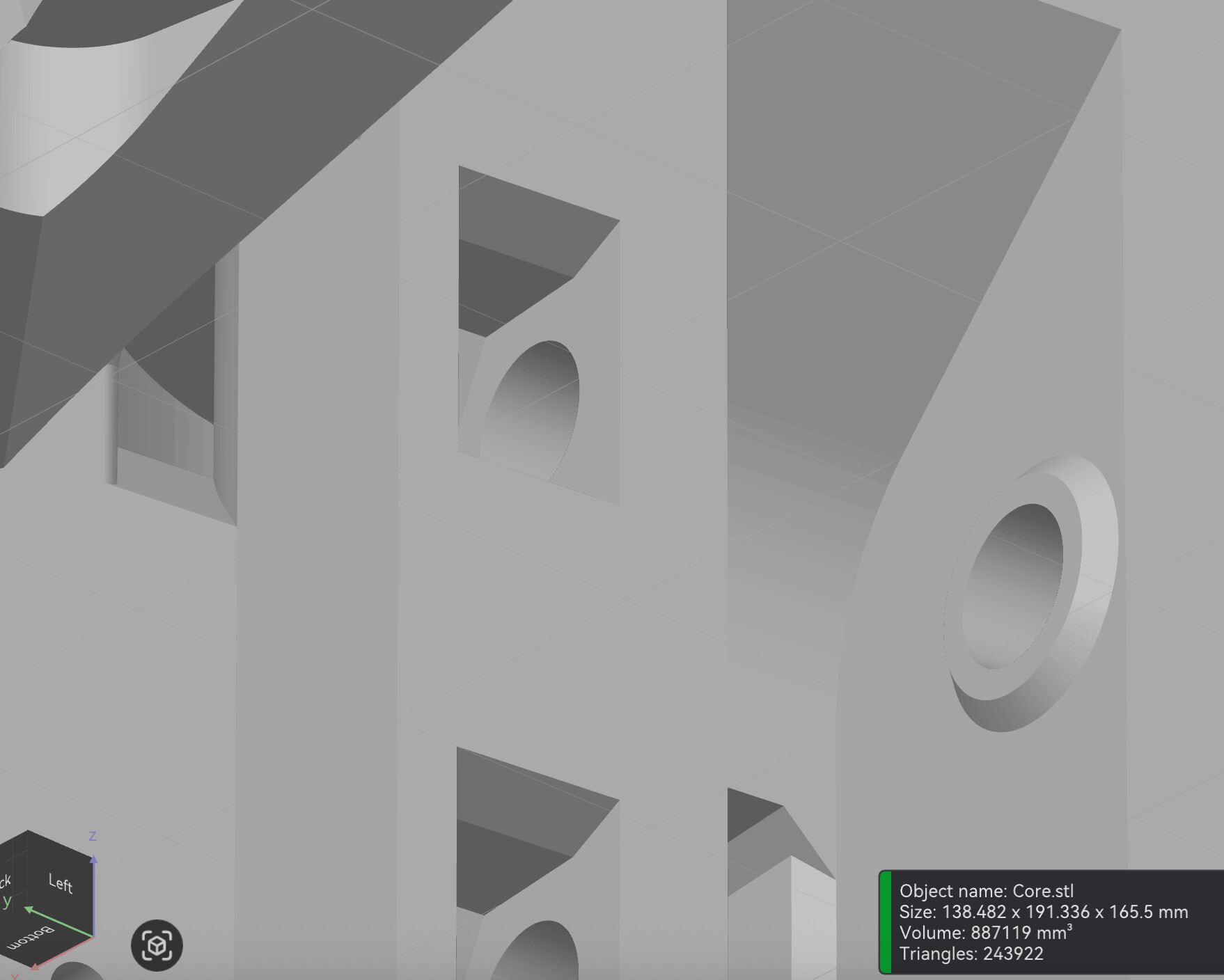

OK after taking a break and realizing I can open the STL file and see what the passage is supposed to look like, can confirm that my printer added supports in there because it is definitely not a smooth hallway like the STL shows:
Will hit it with some stuff to try and pop it open (without breaking the core itself)

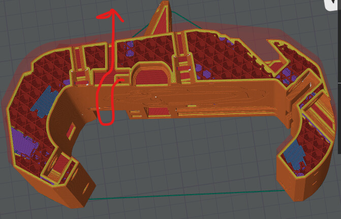

  1. the touch plate wire goes through the front of the core to the max X side endstop (not typically used) through the back of the core in a hole to the X-min endsop, (in orcaslicer, after slicing and backing off a few layers, I have this showing:)
    up through your green circled hole with the endstop wires. typically the endstop wires are fed from the motor side and then crimped to the connectors or soldered direct to the endstop. both endstop and touch plate wires are then bundled with the motor wires back to the controller.

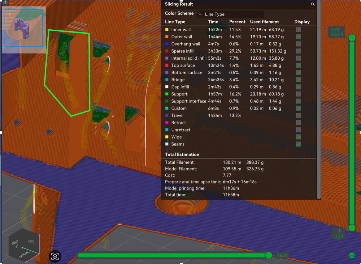

  2. x wire endstop goes through your hole circled in green. push a piece of filament through it and make sure it is open. The black dupont from the touch plate may hang up in there if your overhangs are droopy. Looks like you might have infill as you mentioned… if you can use a screwdriver or needlenose pliers to pull some out, you might be able to clear it. in a pinch, you can use a soldering iron, but I’d not suggest that be your first option.
Thanks a ton!! That definitely clears things up for me. Unfortunately though I can confirm that I have quite a bit of infill in that passageway. I spent a good bit of time poking out the supports from pretty much all the other holes, but this one with the bend in it is killer… Below I have a screenshot from Bambu Studio, trying to show that the support trees grew all up inside of tunnel (again lime green polygon):
did it block all the bolt holes too?
It did, but only with flimsy little trees and since they’re straight shots, I was able to poke em all out with a screw driver and needle noses
But the great news is I got it cleared out!! A combo of hitting it with a drill bit and some handy curved picks I got from Harbor Freight let me brute force a solution. Will continue on and will update this thread when I run into the next situation :slight_smile: Thank you again for the help!!

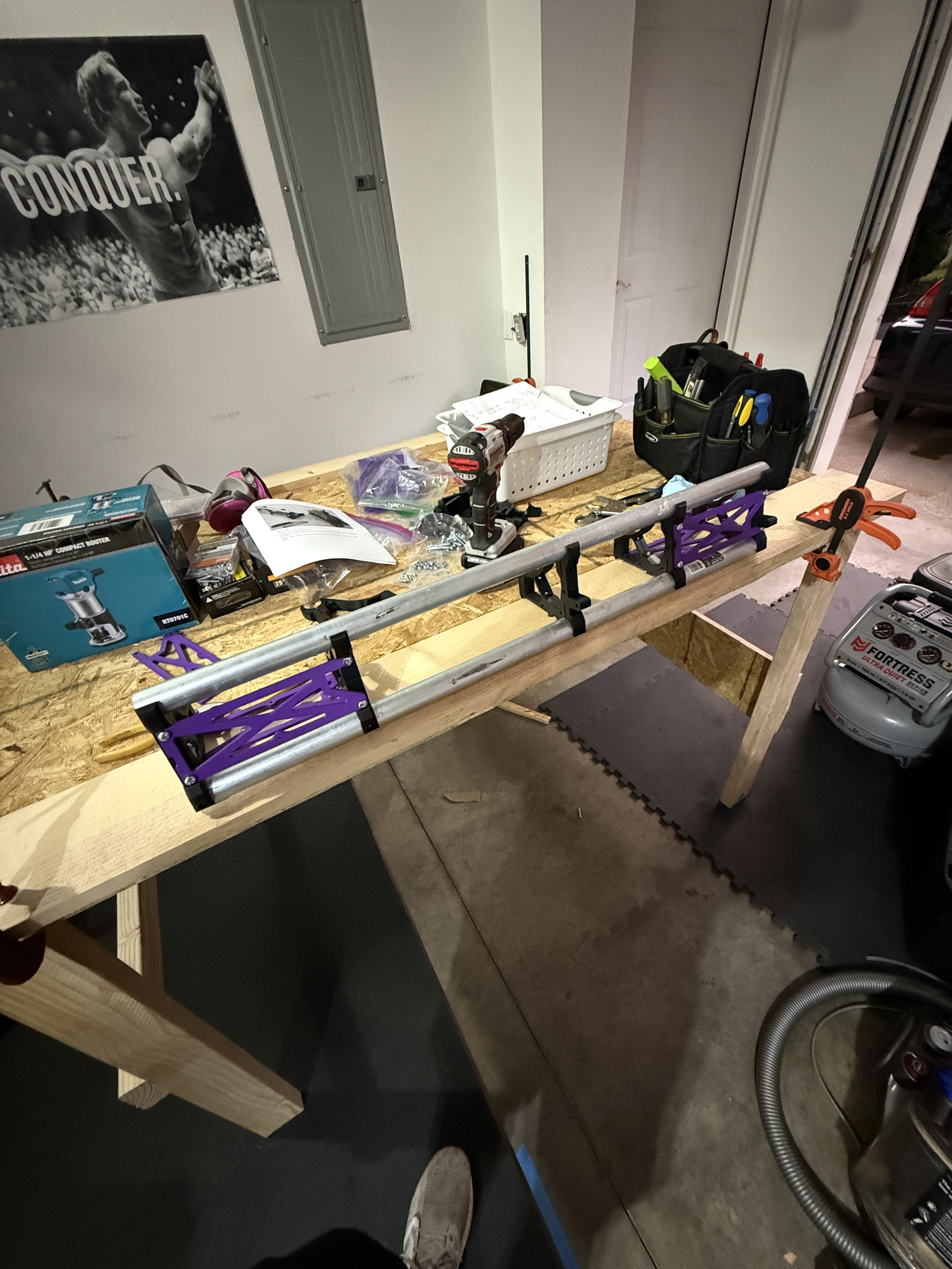

Long over due update! Life got super in the way but I’ve been grinding out progress lately.

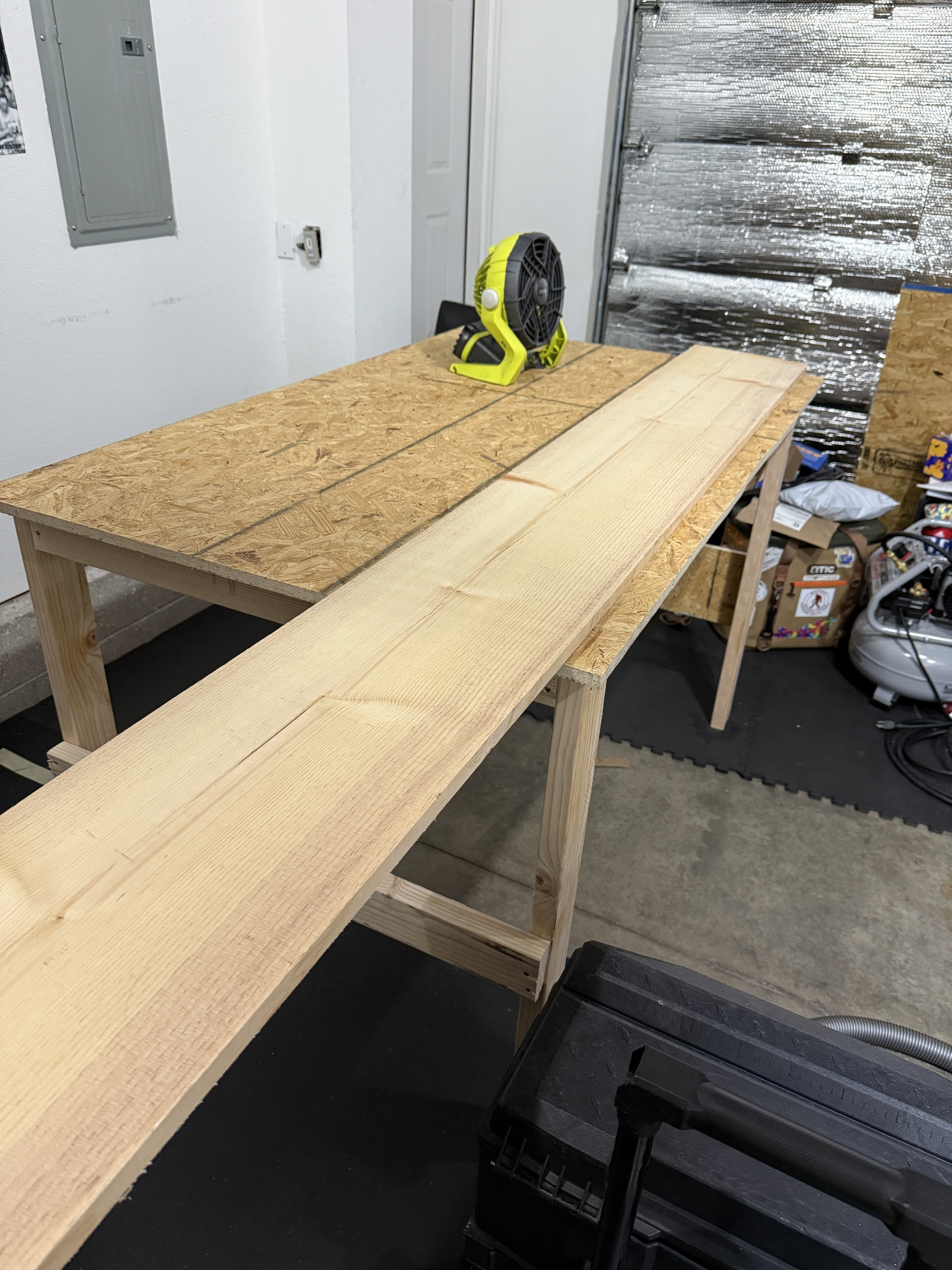

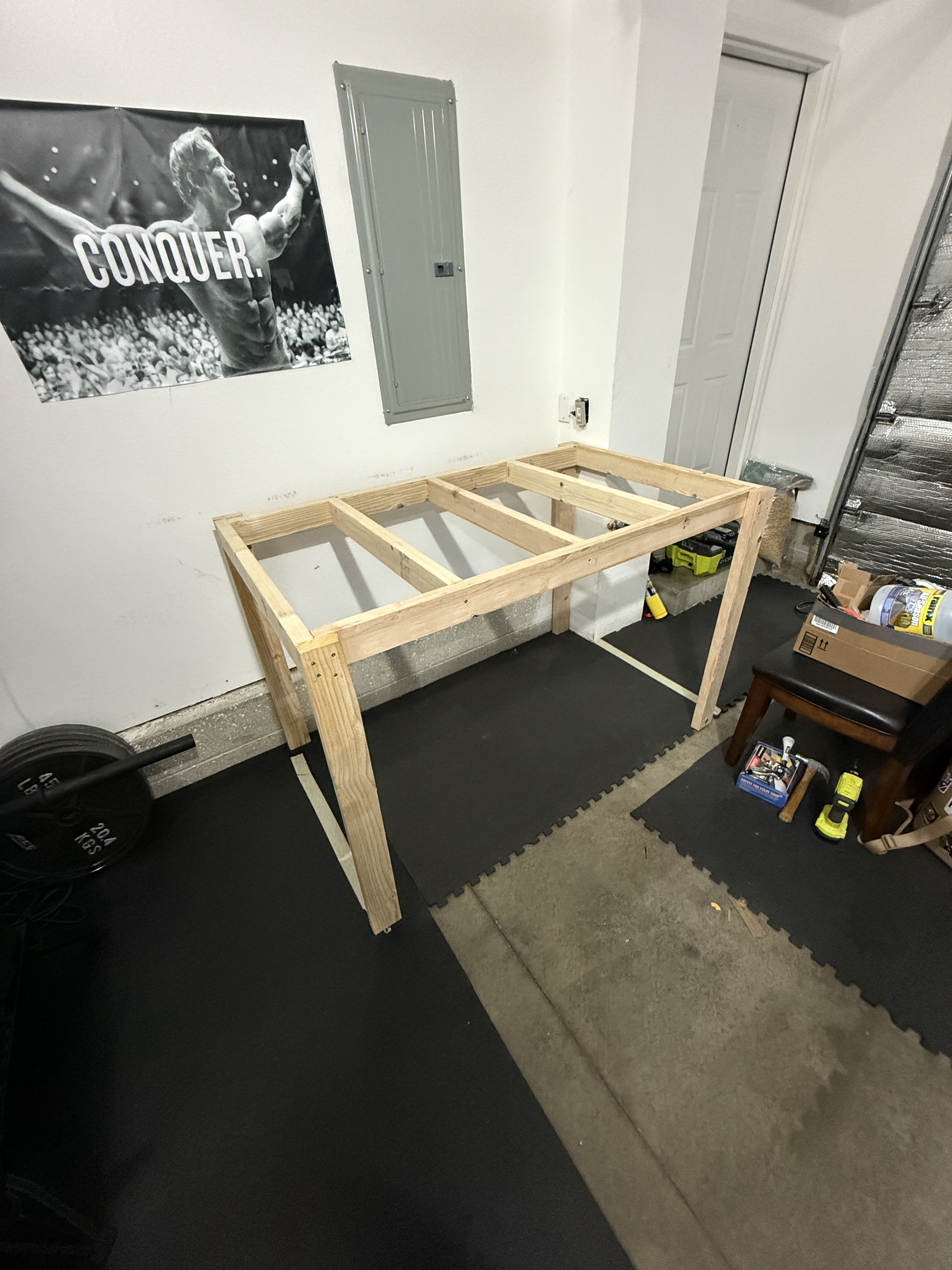

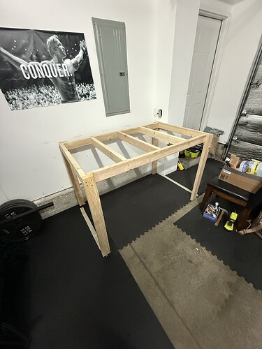

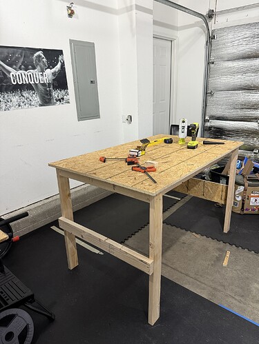

I finally got all the 3D printed pieces put together and have a table built! While this feels like it shouldn’t be so difficult/time consuming, I gotta remind myself that this was my first ever 3D print and the first table/workbench I’ve ever built! I’ve already learned so much and every day I’m looking forward to getting this thing completed :slight_smile:
Pics of the table and an almost complete X beam are below. Thanks again for all the help and kind words so far everyone! Will follow up with more as it comes.
Looks good, but make sure you have slats between the feet in the long direction as well, otherwise the table will shake a lot. :slightly_smiling_face:
Thank you! Yes excellent suggestion, I planned on that but ran out of wood… will definitely do that soon/before it gets finished up :slight_smile: I was also thinking I’ll eventually screw it into the wall studs once I know where I want it to be long term
