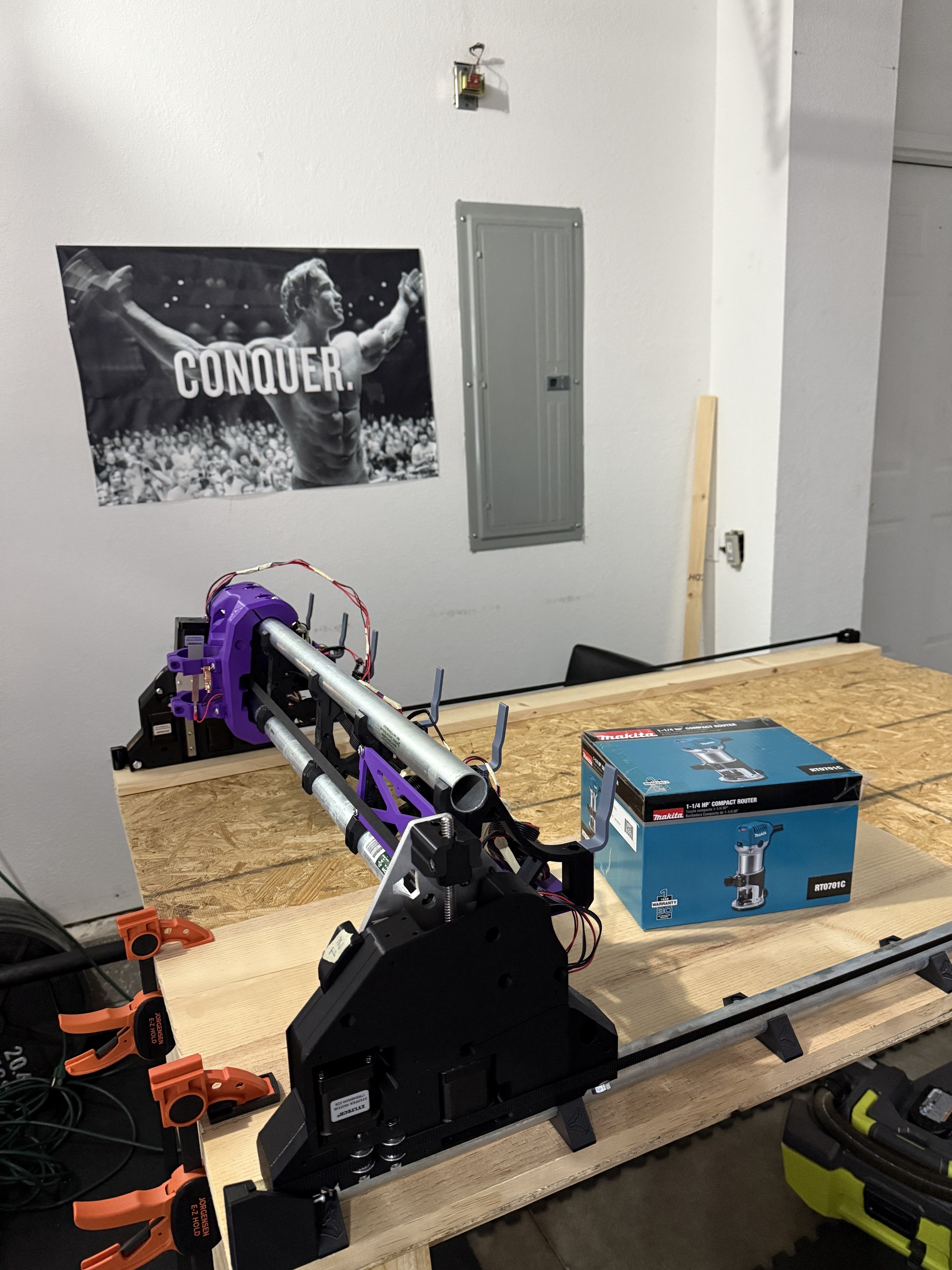

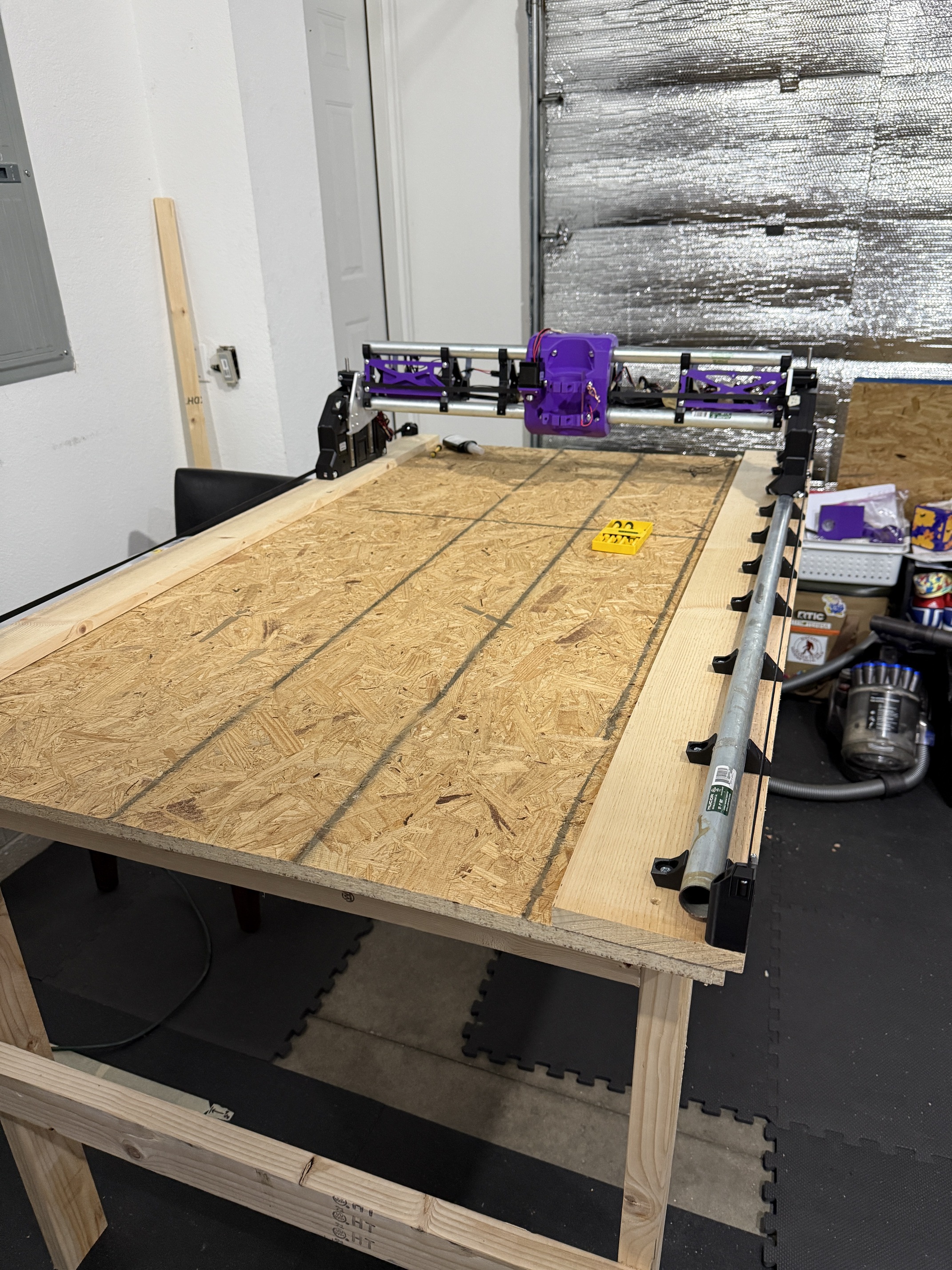

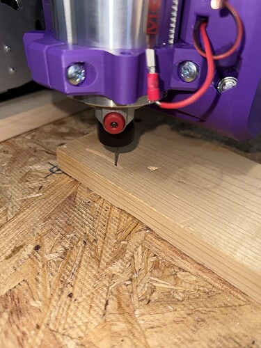

WOOHOOO I got it powered up and moving via FluidNC and hitting the X,Y,Z movement buttons! Also got the homing figured out, took a minute to realize that “+” = further from home and “-“ = closer to home.
I believe all that is left is installing the router and cutting my wooden struts! Taking a break before I get back to it, will update as always

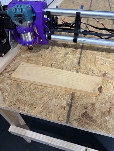

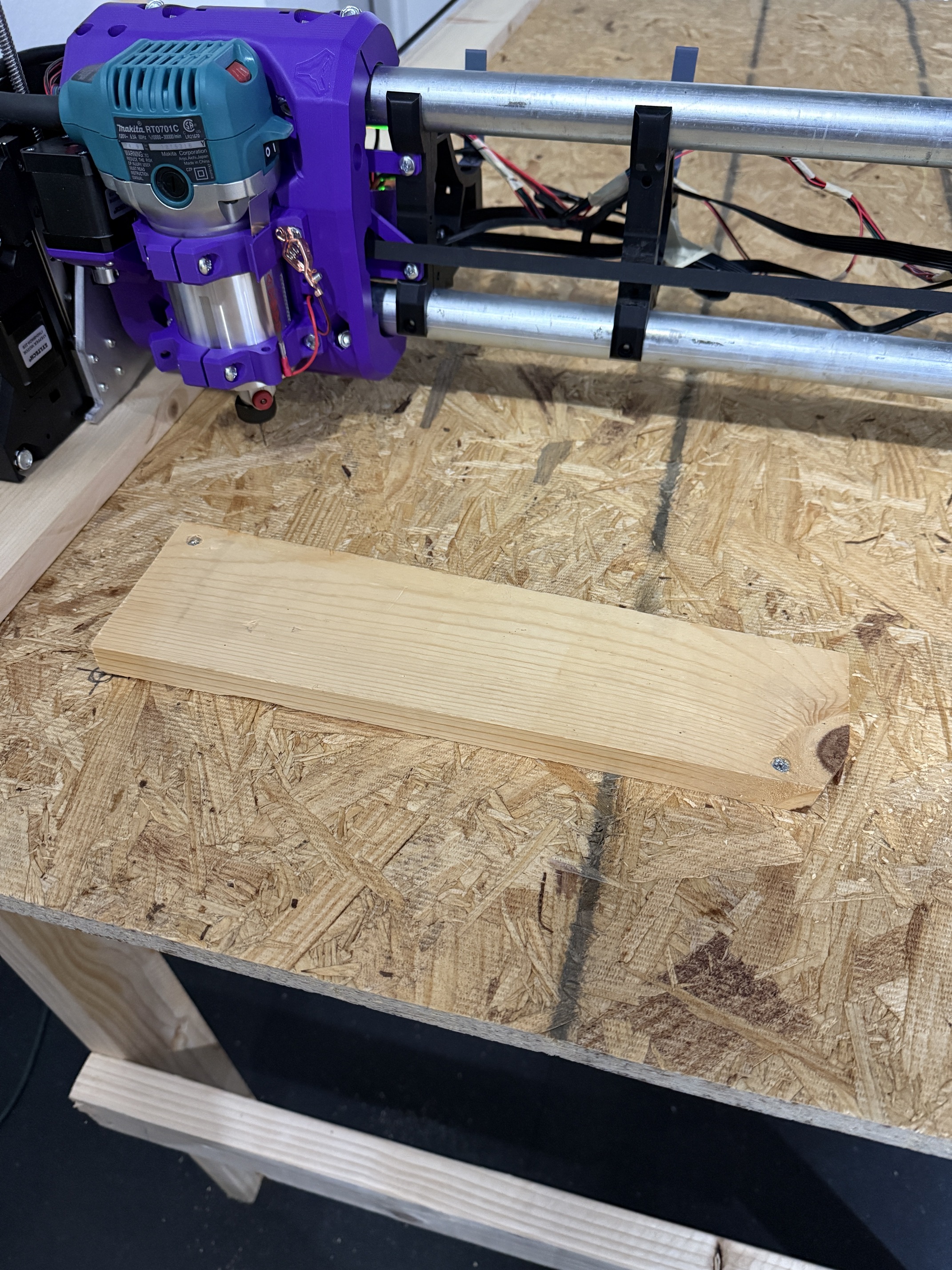

Decided to start with the crown!
I got the shape and tool paths set up in Estlcam and saved out the gcode file. I am connected directly to Jackpot (wifi AP) on MacOS (Safari). In the FluidNC webUI, I created a directory on the SD card called ‘crown’. Inside of it, I want to upload my gcode file, but nothing happens when I click upload… any advice?

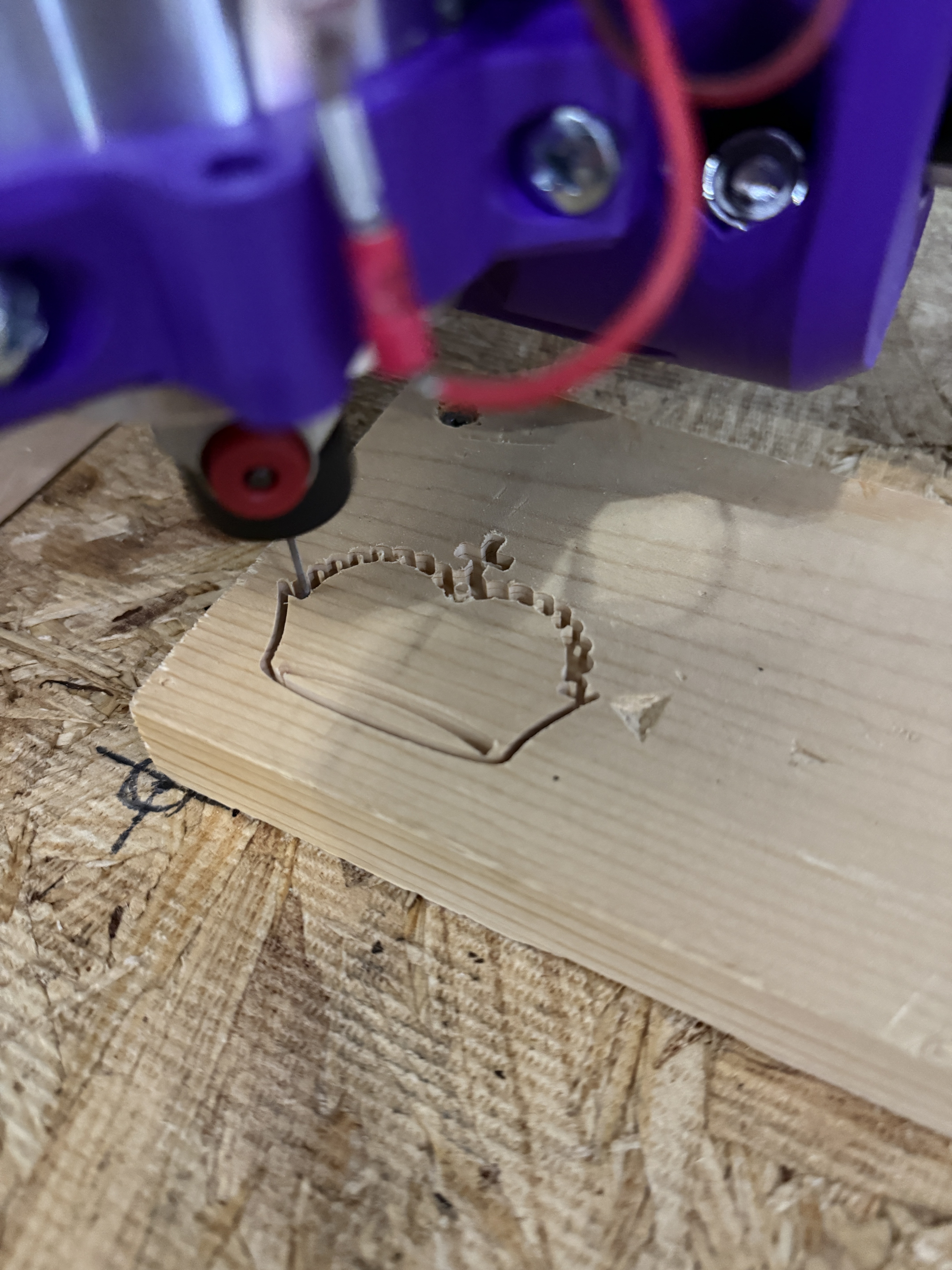

HELL YEAH IT WORKED!! Woohoo :partying_face:

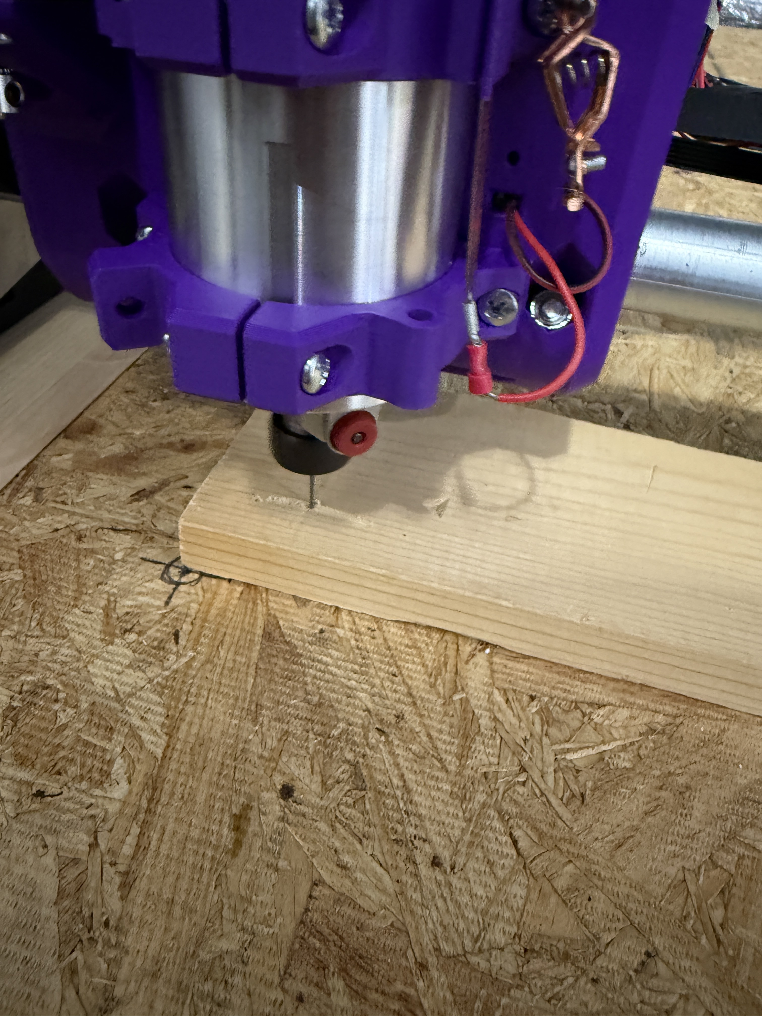

In seriousness: yes it did work! I was able to connect and upload my file via MacOS and Safari no problem, once I connected to STA mode.
Unfortunately I had to leave for work so I paused it and shut down the Makita (didn’t want to call it a router since we’re also talking about WiFi stuff lol). Will be a good test to see if I can reconnect, turn it on, and resume! I decided to get fancy and used estlcam to make 3 crowns in different positions, so we’ll see how they go :slight_smile:
