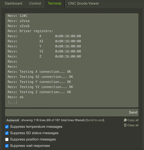

After it happens, you can also send M122 through the terminal interface in octoprint. It will print some debug info, including overheating, and open loops, if it detects anything, that is a good sign of where to look.

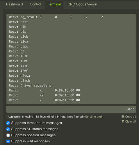

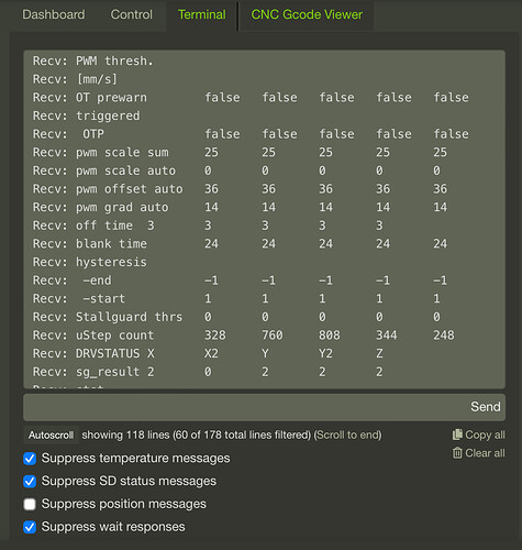

I’ve just done M122 and the results are as follows. I can’t see anything obvious, except in the line
Recv: sg_result   2    0    2    2    2
where there is a ‘0’ under X2.
That’s pretty convincing. :slight_smile:
If that from after you tried to move the Z? I can see they are all enabled. The flags get cleared on reset. So they will only be useful after there’s is a problem, before power cycling them.
SG is stall guard, part of the sensorless homing, IIRC. So nothing useful there.
Those results are all reasonable, so the drivers are likely ok. They are definitely powered and communicating.
