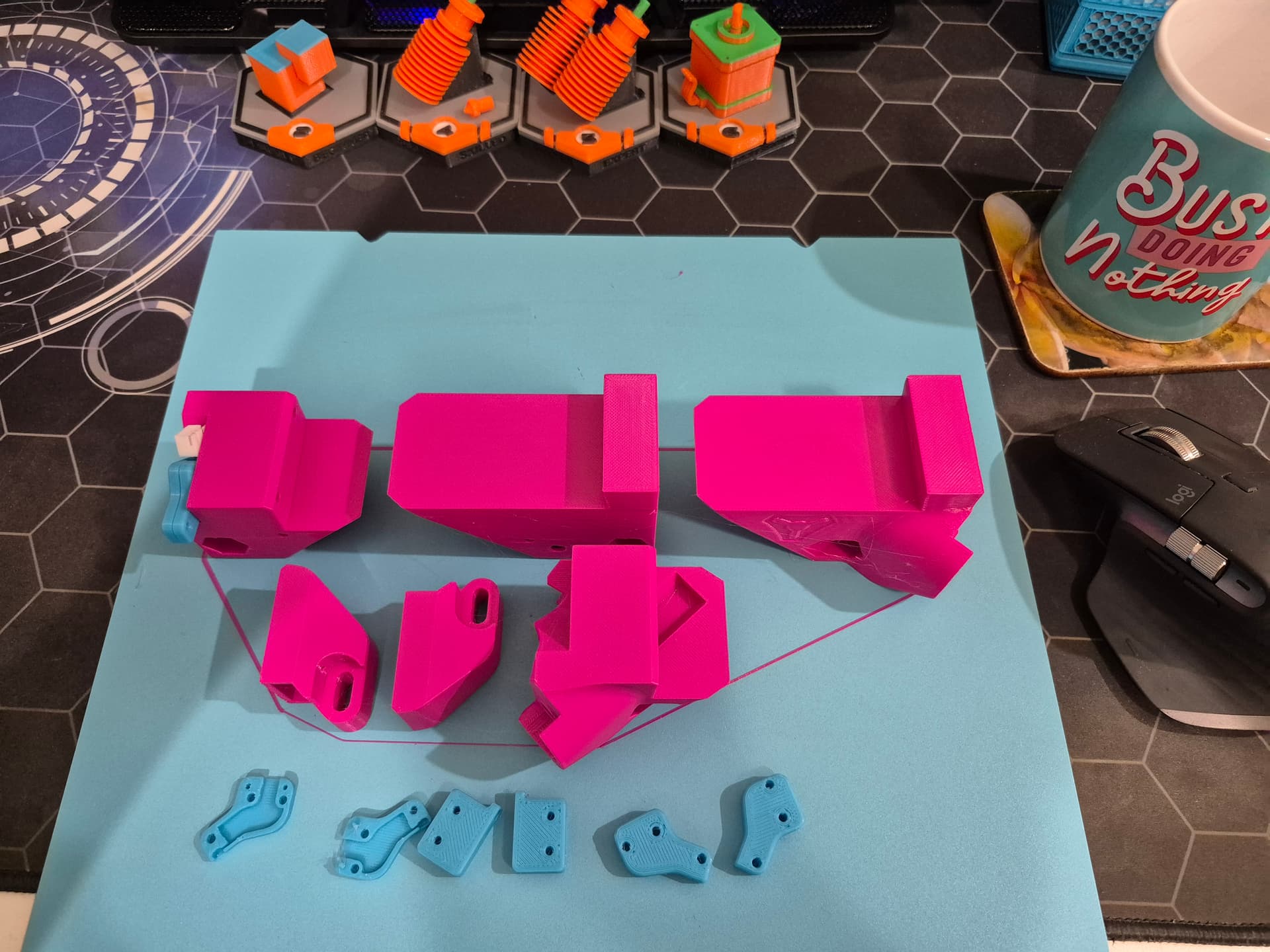

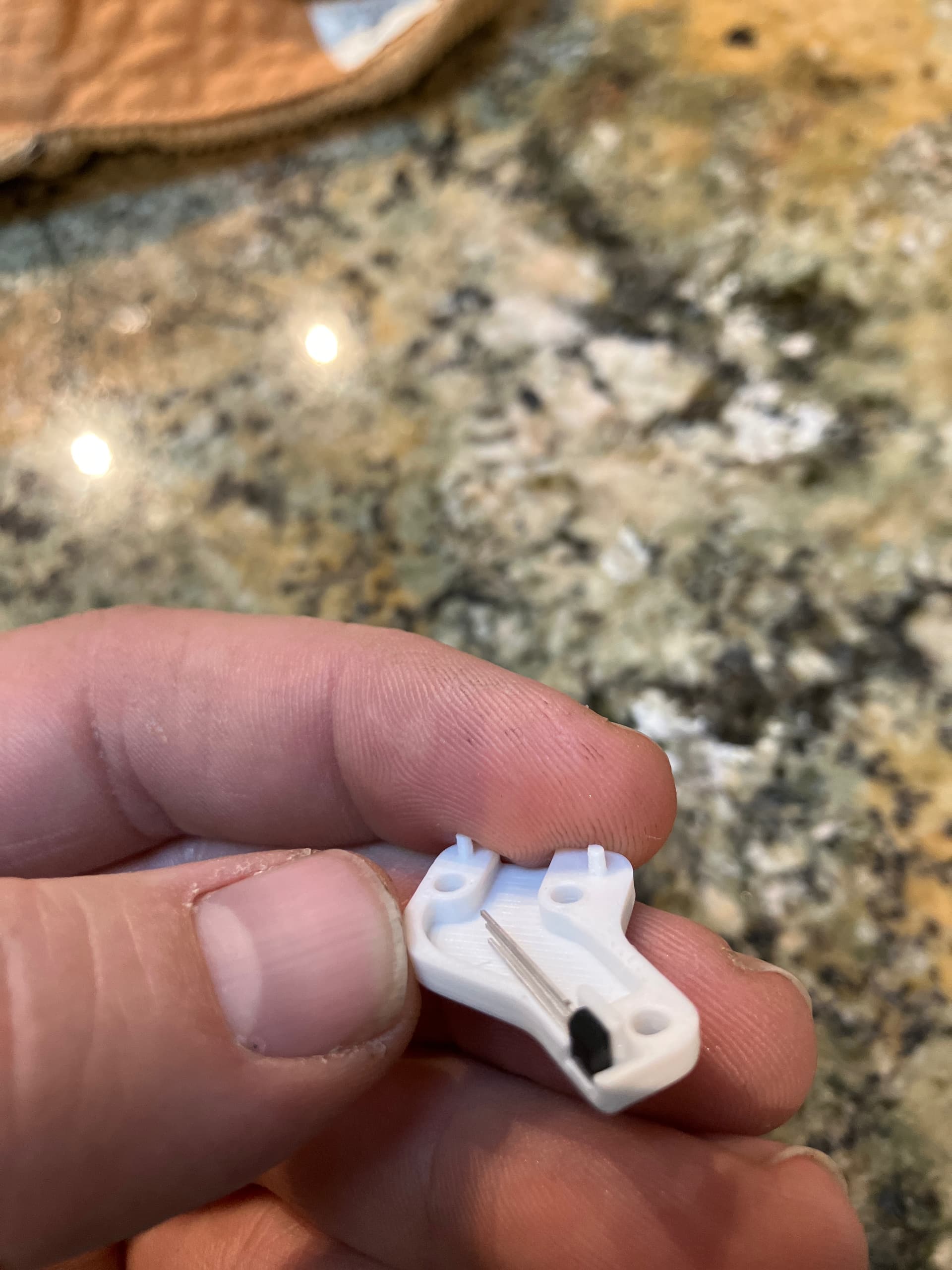

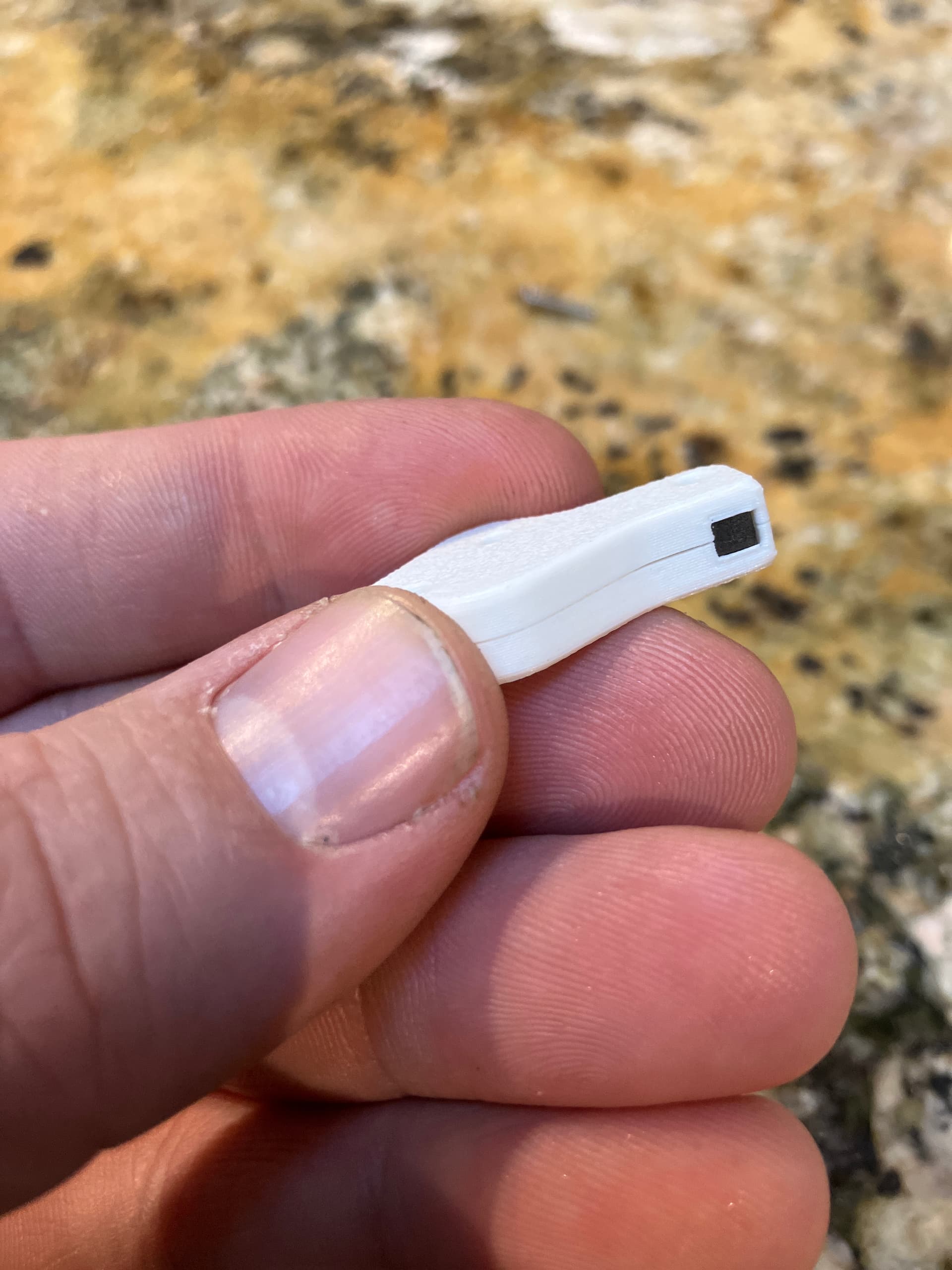

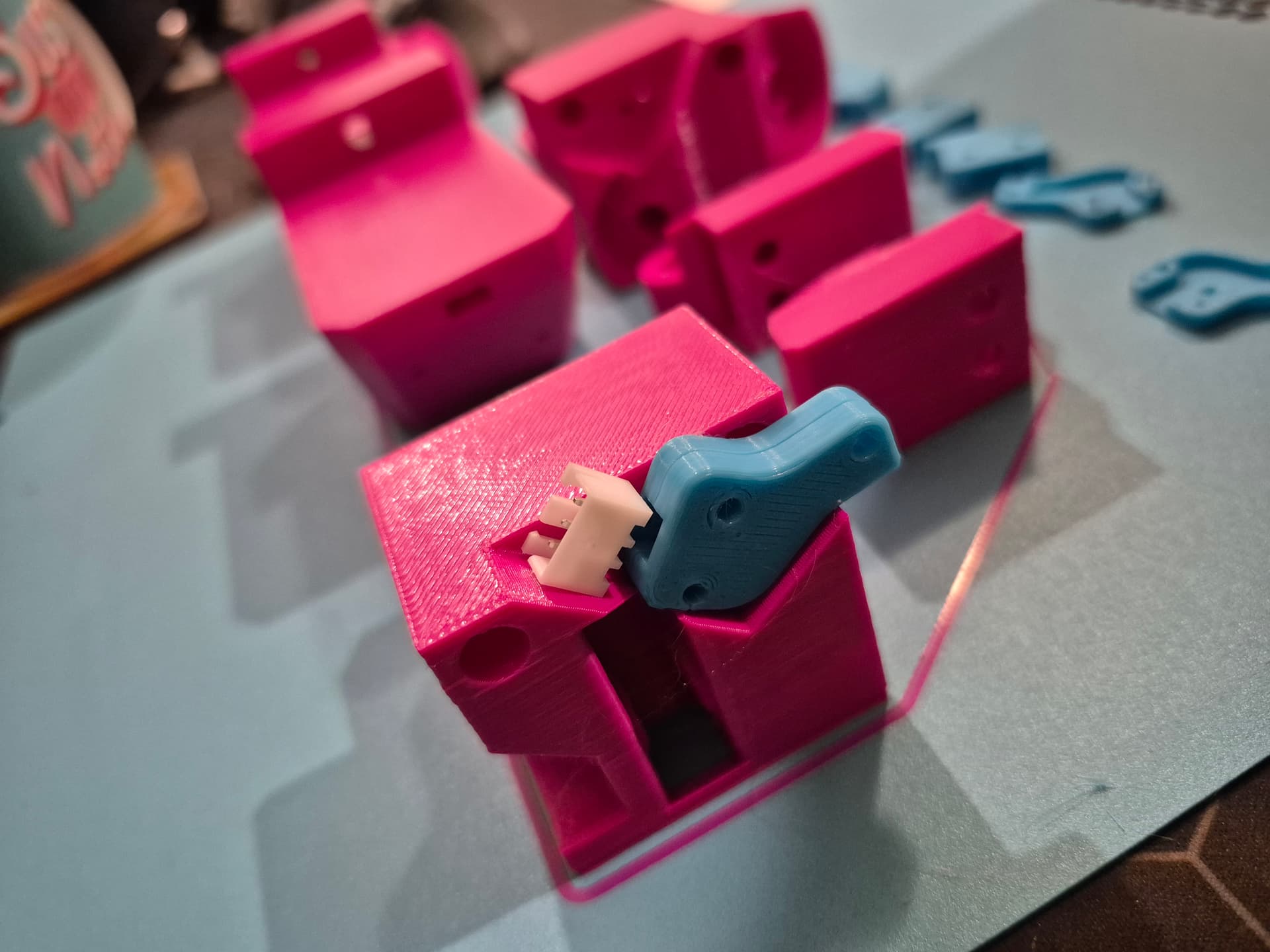

I printed a few iterations of the mounts last night and I’m now happy with the y axis mounts.
Nothing builds confidence like knowing the designer did print and test iterations until happy. :slight_smile:
hahaha especially when they print and iterate a day after they enthusiastically shared it! But here are the stls for that if others want to try it. I liked a tight fit on the body of the sensor but if it doesn’t fit for other people’s printers I’ll add some tolerance before I publish it.
y_axis_hall_mount.zip (166.0 KB)
Neat! Cheers for sharing!

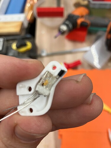

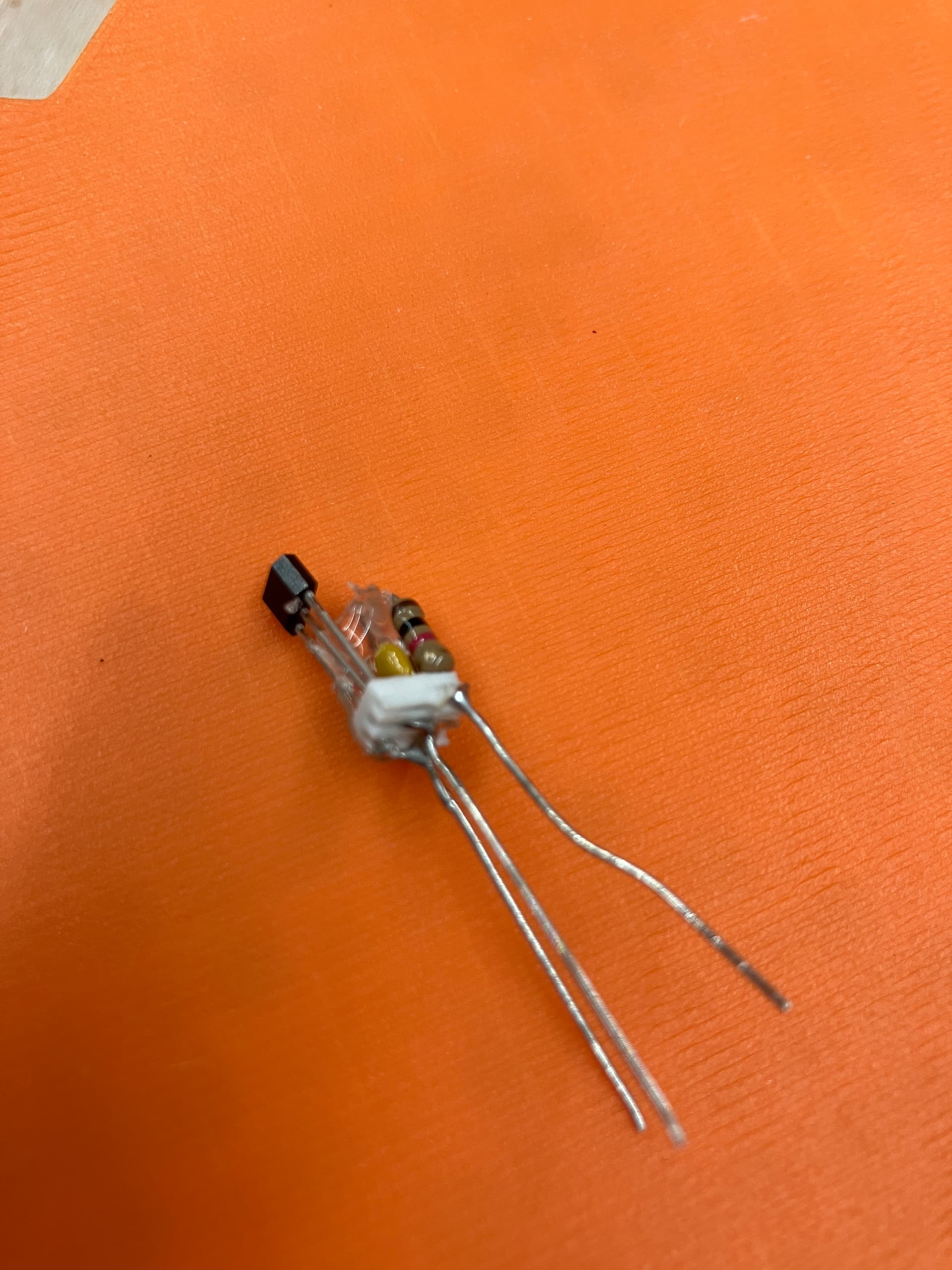

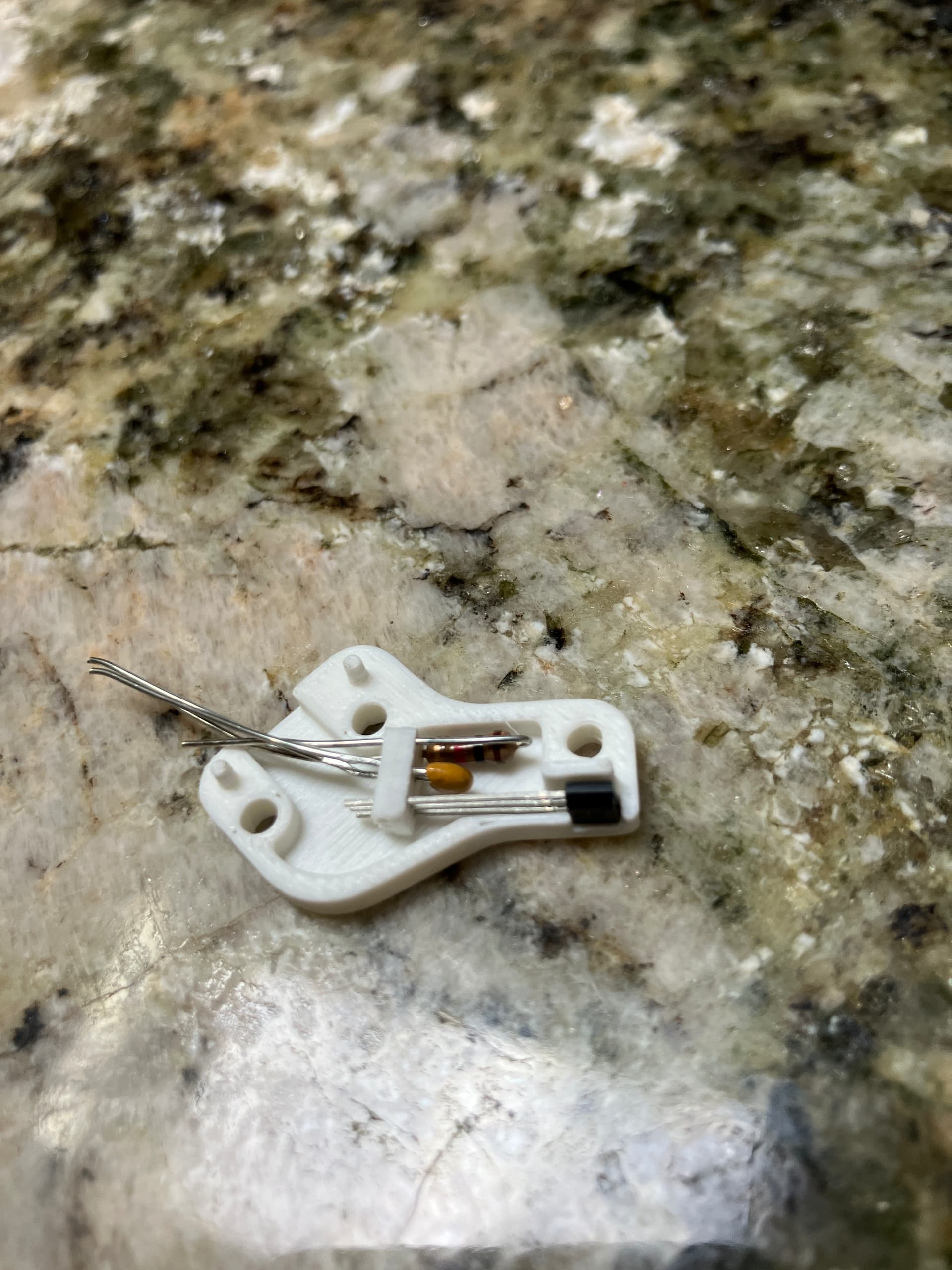

Also I’m overly pleased with this idea I had. I printed basically a waffle with grooves to mount the parts to, to give them some structure. I shifted everything around in the case until I was happy. Then I dabbed some hot glue on to hold it while I soldered it using the leads.
Nice!!

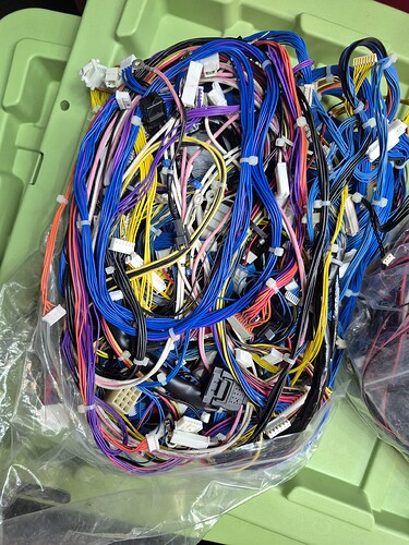

I like the snug fit. I printed all the LR4 parts again and also the appropriate sensor housing. Im just looking at the JST connector and I might have to go with a PH size connection. Since the depth of the parts and the printed part might protrude. Also I have all this great wiring from an old photocopier which is a great size and the colours are appealing :rofl:. I had to run an additional 4 wires through the end plates and it was very tight. If I had 6 of the wires fir the endstops in the smaller gauge it would be an easier fit
Yeah, I originally looked at mounting a DuPont connector but those are pretty long. Looking through my box of electronic stuff I have some xhp connectors which look like they’ll fit. Sometime tomorrow or Monday I’ll probably make a version to fit those. Otherwise maybe just some 2.54mm header pins sticking out the bottom would be good.
Header pins would be good, could attach the wires from the board that have a Dupont connector.
