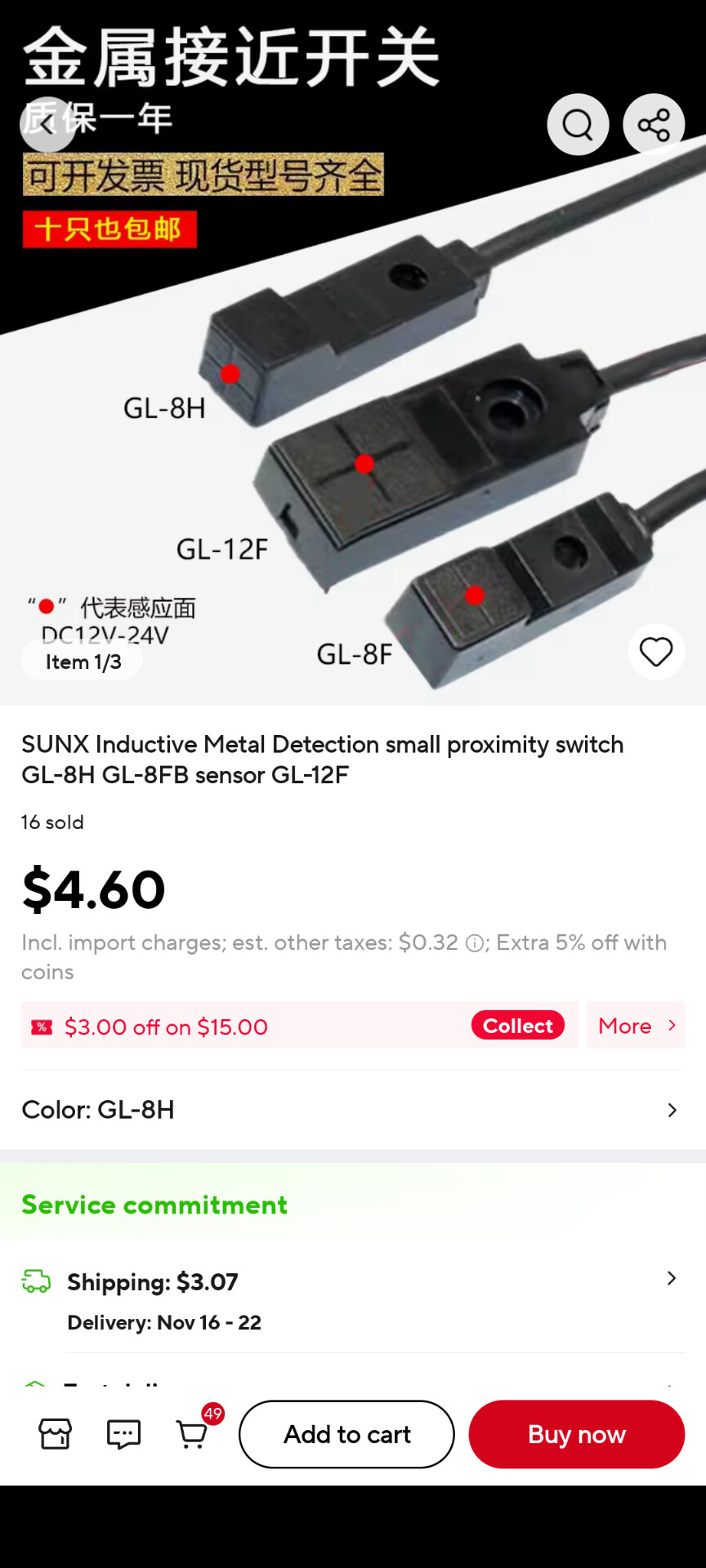

You could use the GL-8H sensor. They run with 5v. I have had good results with them in 2 non V1 builds.
My lr4 runs with the stock switches( i just added some 2mm plastic behind the screw so the lever gets triggered always)
I’ve ordered some switches which will get here this week so I’ll test the print I designed. I’ll also tweak it for the z, and x axes.
If anyone prints them before I do let me know how it goes.
Those are big and clunky. They can be accidentally triggered by any metal. And they cost much more than Hall sensors.

They could be triggered by metals yes, but they are not big at all: they are: 2cm x 0.6cm x 0.6cm

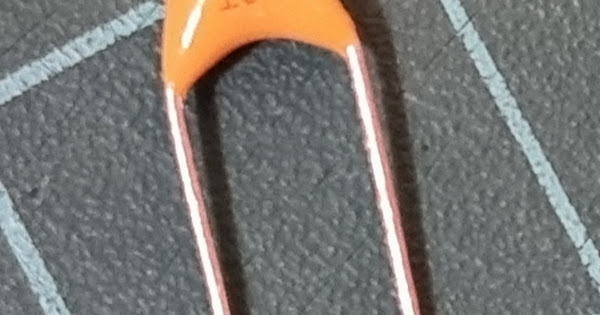

I use 0.1 mfd = 100 nF
It is marked 104 which means add four 0s to 10 (in picofarads)

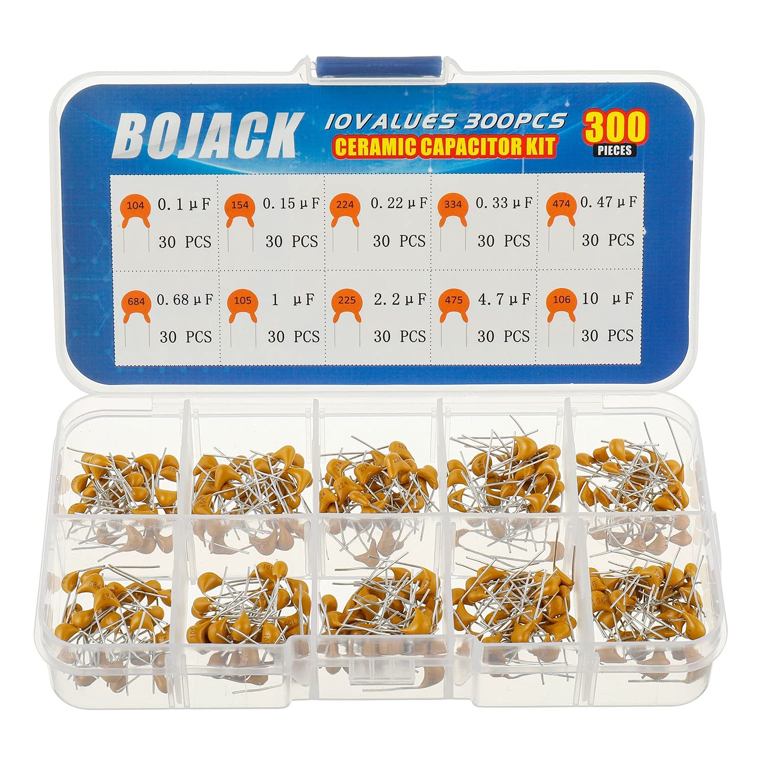

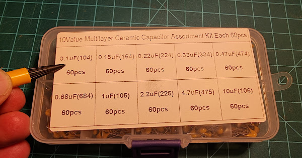

You can get a whole assortment of filter caps for very cheap on Amazon.
Google Photos
Google Photos

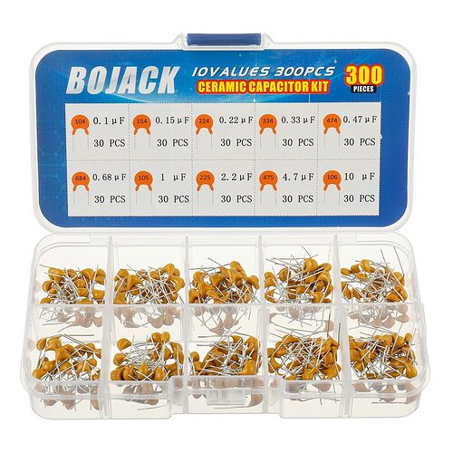

This assortment look like a half decent deal?
https://www.amazon.com/BOJACK-Capacitor-Multilayer-Monolithic-Assortment/dp/B085RDTCCV/?th=1

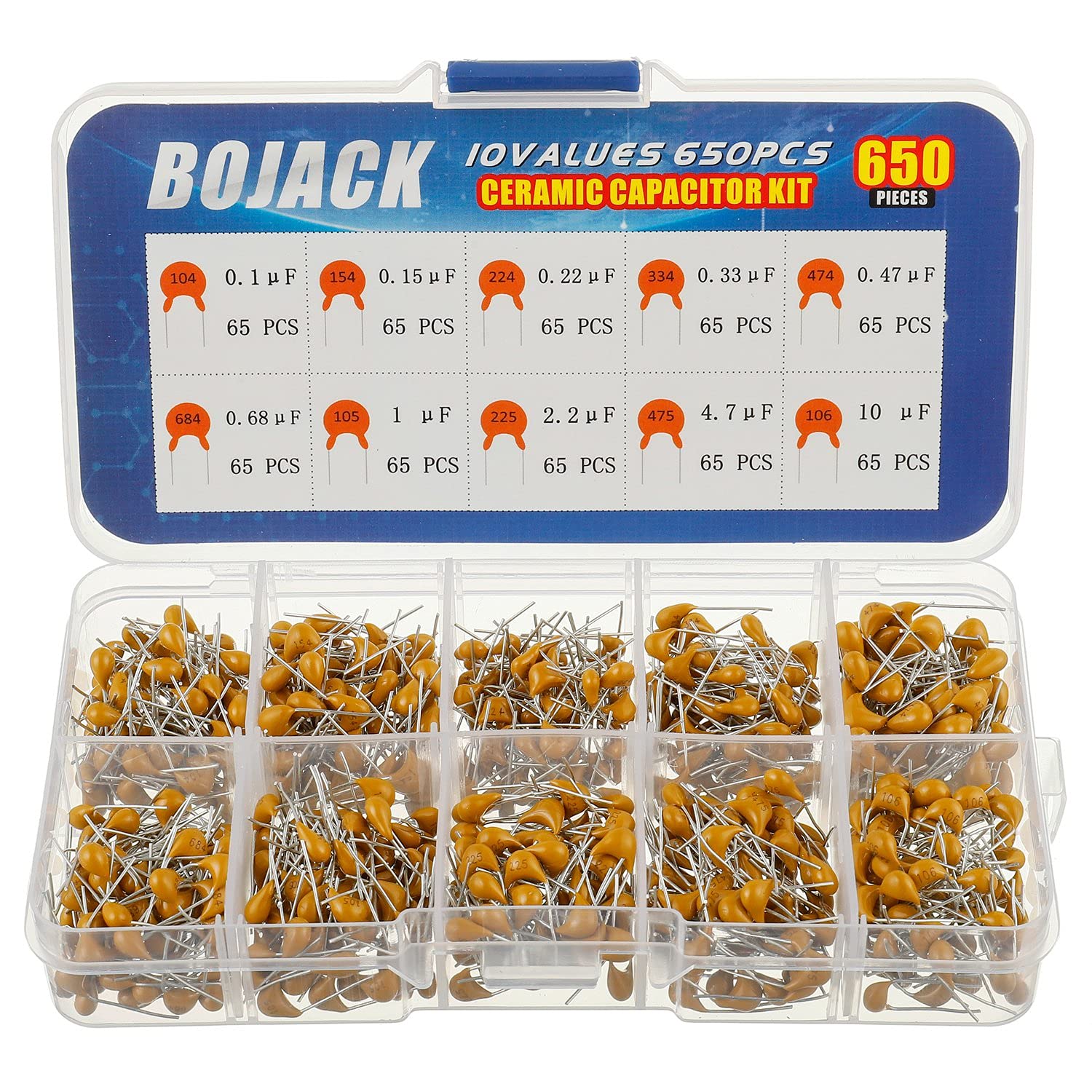

I also found this one, which has 650 pieces instead of 300 pieces:
