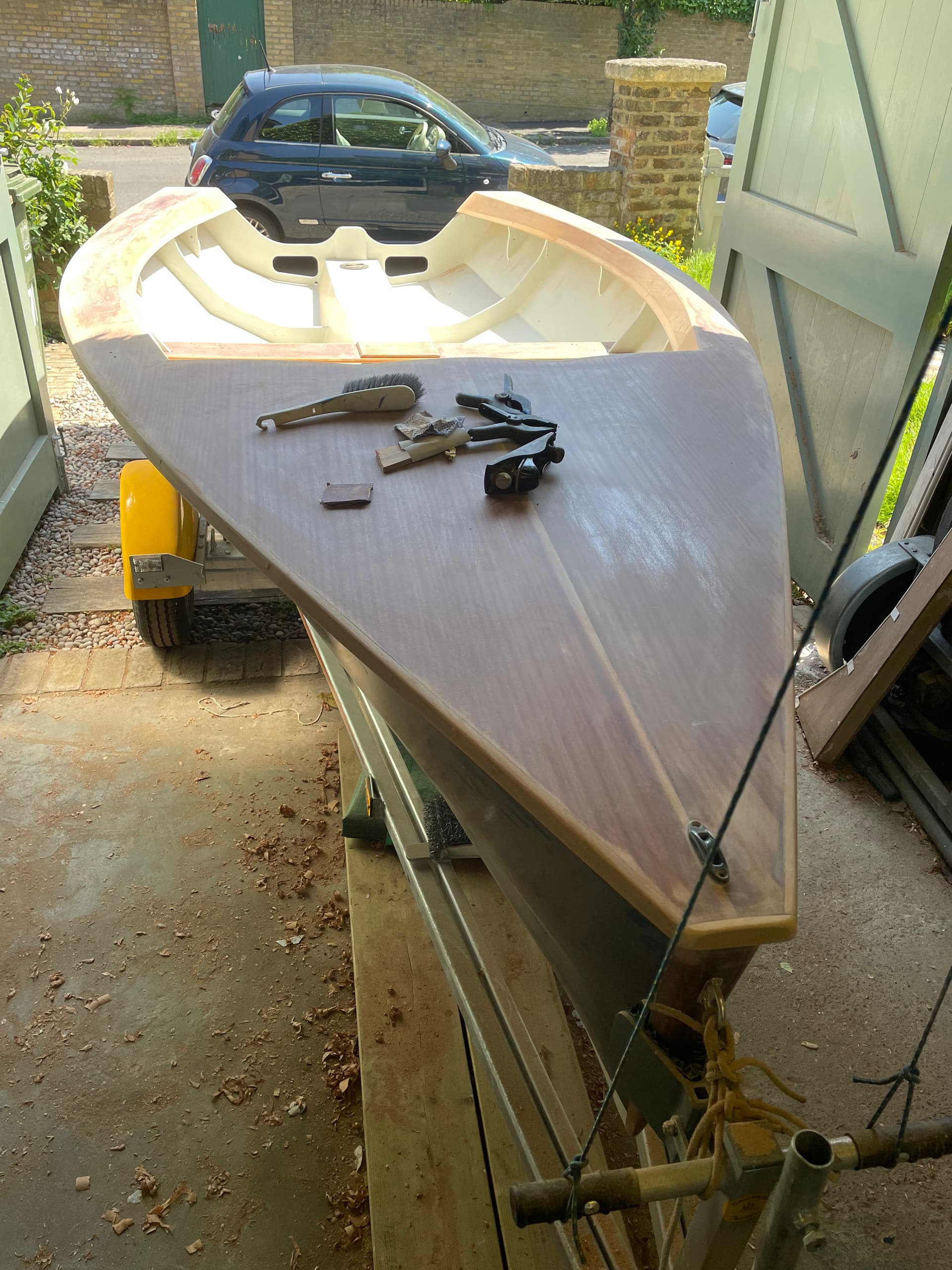

Hi I have just stumbled across this thread almost exactly two years into my H1 build.
I thought I was the only one but apparently not?
Great source of information - only wish I’d found it sooner!
Aiming for launch in a couple of months.

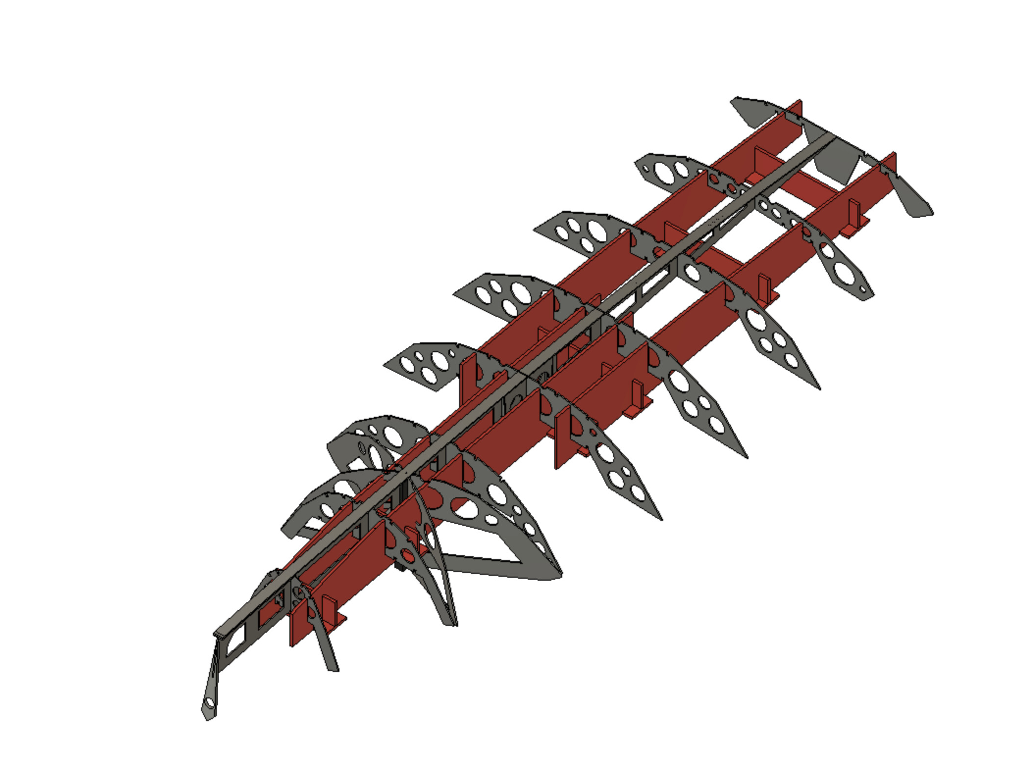

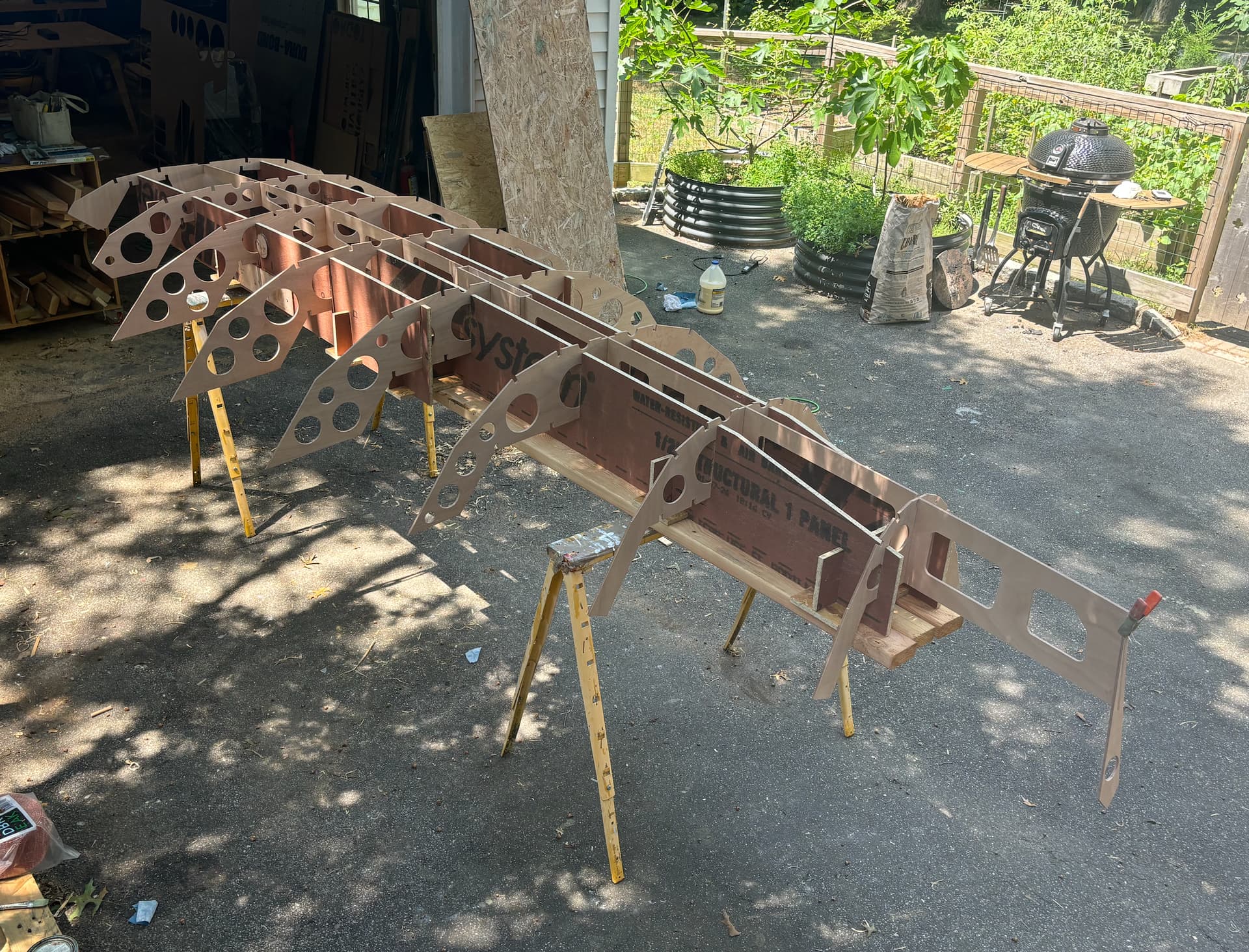

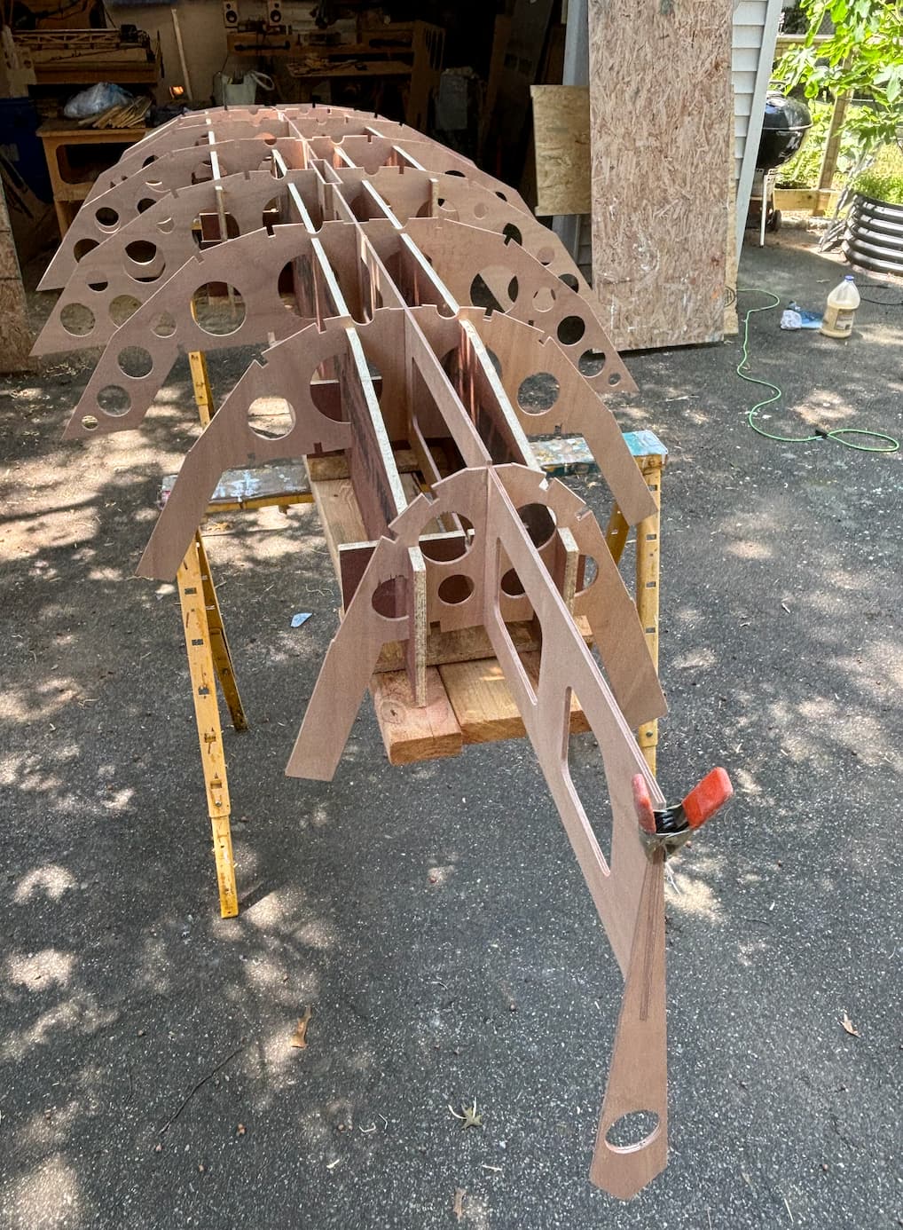

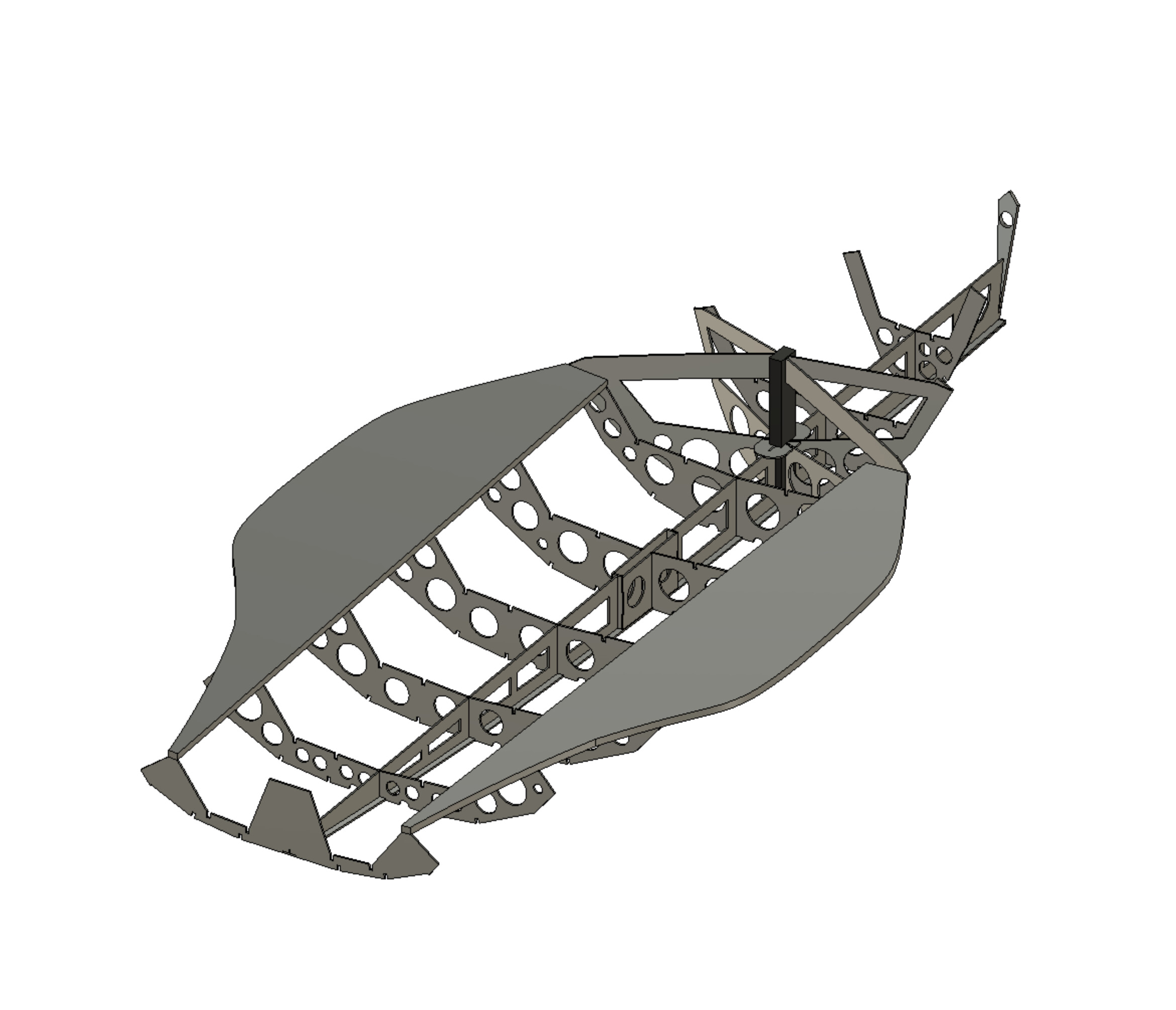

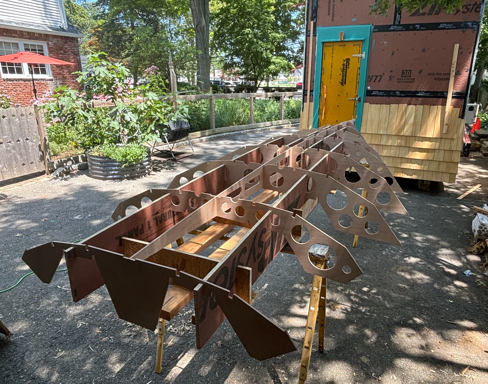

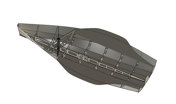

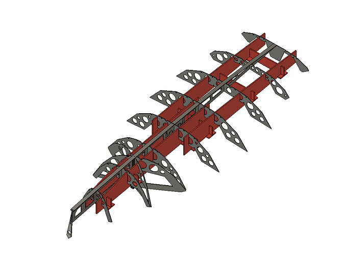

This brings me to:

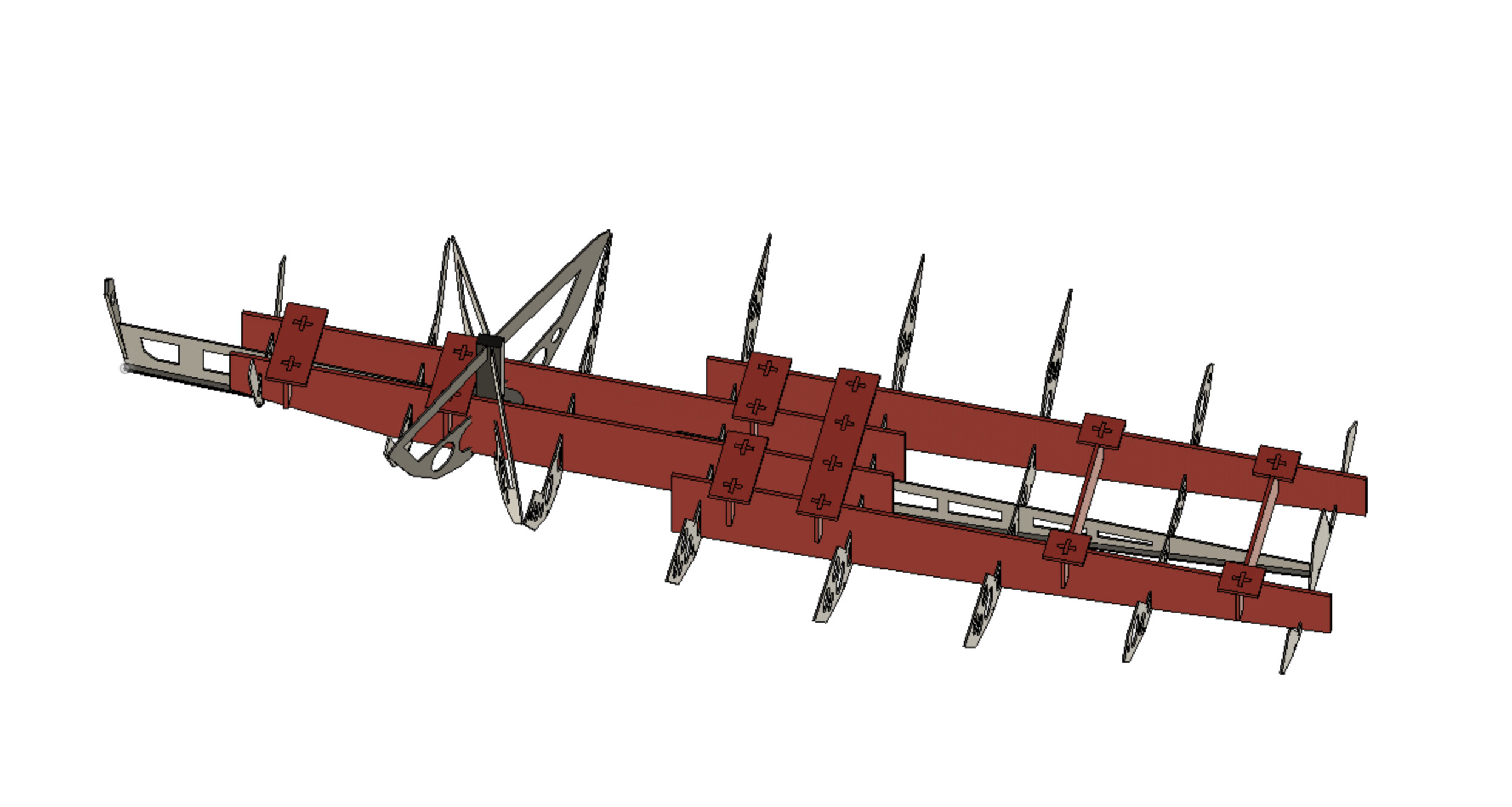

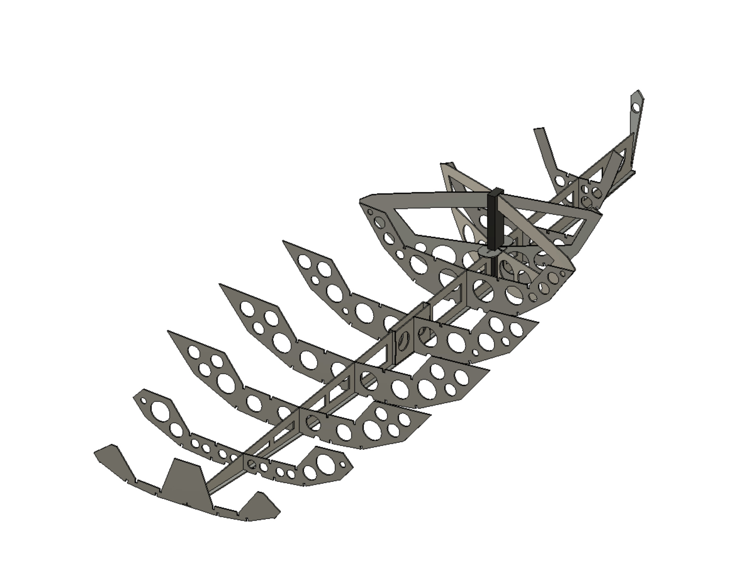

  1. I am redesigning the whole interior - reducing the weight and overall material. With the help of carbon/fiberglass in strategic areas – 4mm hull instead of 6mm, 3mm deck, laminating foam wings (trying some vacuum bagging). Bringing the overall outer deck closer to the water, daggerboard instead of centerboard, simplifying the fittings and using as much soft rigging as possible. I should probably put this build on another thread so people can follow but it will go something like this:
Red structure is the saddle it will sit on while I am making it.
The hull would fold in on itself at the back.
The bow would be uncovered giving more room for spinnaker bag. Forestay would go down on station 1 deck.
  1. Overall, I do love sailing the boat – it is very responsive and adaptable and I see it has great potential. I just want to be in control of it more physically and not be at its mercy. I appreciate Keith’s design framework but I think in wood it makes more sense for a more small scale boat like the Moth. My redesign is really just based on the typical tried and tested plywood build with stringers that has been around for decades. I guess another potential design direction would be like the OK Dinghy route. Carve out a center area and leave plenty of buoyancy all around…

Are those your CAD files?..im retired Mechanical designer but i still keep my solidworks Professional License active… bit pricey, but it nice to have ability to design and make my toys. Now i think of it… maybe asking about the cnc format and if there an 3d files or cad files is the reason he did not answer by hand full of Questions. :thinking:
What your thinking between switching from centerboard to dagger board… is it to cut some weight or reduce the trunk… Just curious…

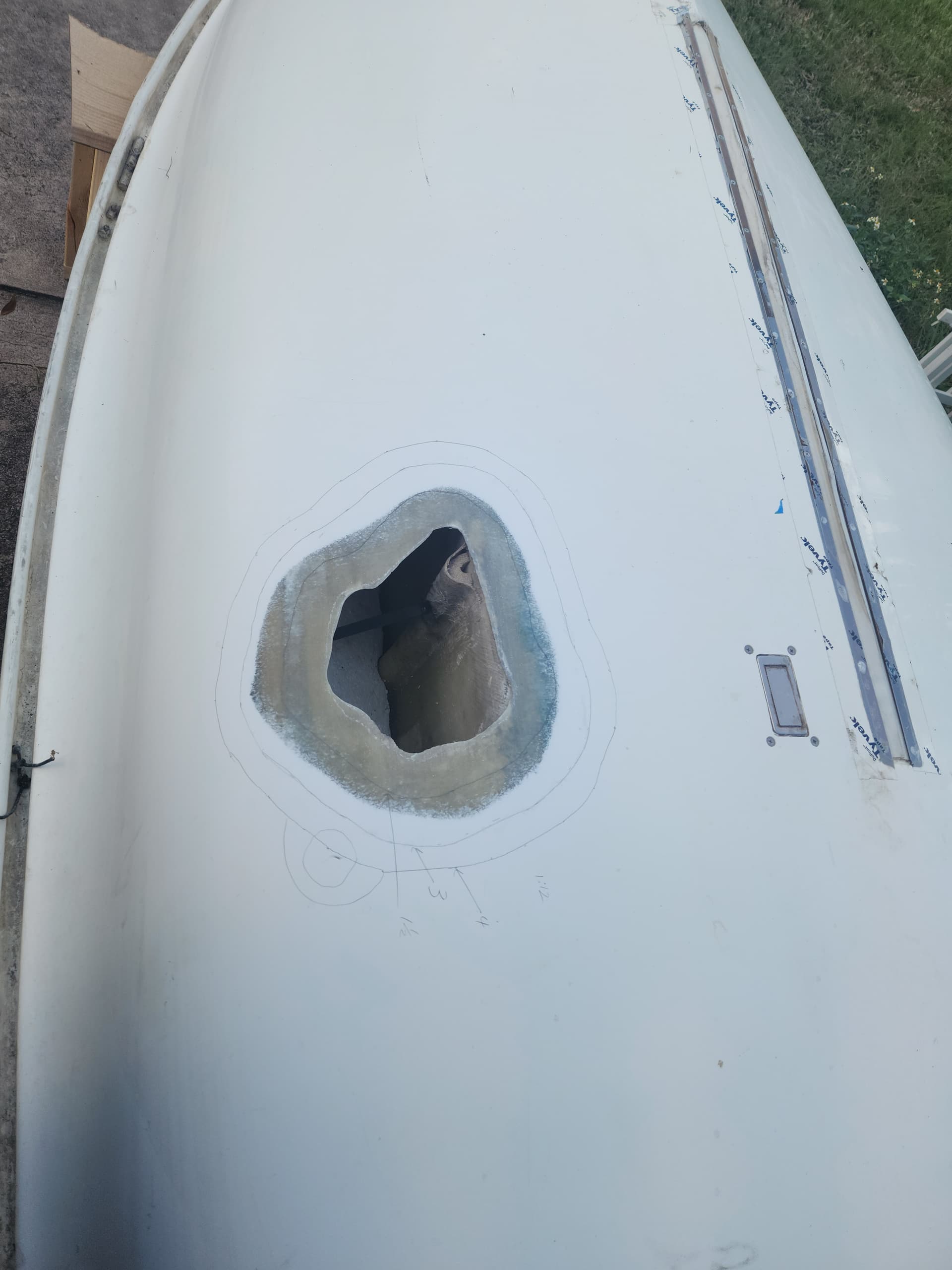

Was going to post pic of my most recent full rebuild… but not allow as a new user… keep me informed… your work and Customizations and redesign… no…more of a new design Inspired by the orginal.
Save quite a bit of weight with the ribs. Looking good! And the stern looks much better your way… that should allow for an easier capsize recover and faster self bailing. On your orginal h1 did i see of suction bailer on the floor next to the center board trunk… was that orginal or did you add that to speed up bailing.
yep, i am a little scared of making massive errors in the vacuum process - i was going to keep it simple and just do two things – foils and deck area for hiking (about 7’X2.5’) - basic shape, keep it flat + do it on flat surface etc.
i think a large part of the weight in the original is the high deck, the mahogany bits and bobs. all stuff that adds to the charm but has got to go. in my instance i used some old growth southern pine for king post which was a big mistake. I’m sure I went too heavy on epoxy and paint as well.
part of the consideration here is the workflow. i would like to be assemble this fast and keep it all simple. that way someone else can use my plans if it works. i just want it a bit more manageable (20-30 lbs less?) and then i will be happy.

yep, the daggerboard is to reduce all the drag and commotion in the slot. i also think it’s easier to shape a daggerboard and prolly vacuum.
i guess if you pay the fee to keith i can share all my files? he probably won’t be happy - but at the end of the day i think his current wood design is fundamentally unsafe/unsound to anyone under 230lbs even in peak condition.

The slot gasskets have a short life for racing, as soon as it forms that bend, its done. we repace ours every season… the pic in my last post was the old one i replaced few months ago… I only do fun “races” so it does not bother me much, but my daughter does ~10-14 regattas a year, including multiple practices a week so we keep our c420 in race ready Condition. This year the joke at our club was she broke about every part and the boat itself that its pretty much a new boat now.
Dinghy full assemblies ruddets are getting crazy over price, when you looking at $800-$1800+ is nutz i have a few spares from a few different boats and even more assemblies without rudders so I definitely would modify to fit the assembly i have…
Same goes with mast/boom and standing rigging and sails. If i can get away with it. Ill attempt to use something off my shelf… have a 100sqft sail with carbon mast boom that might fit perfect.

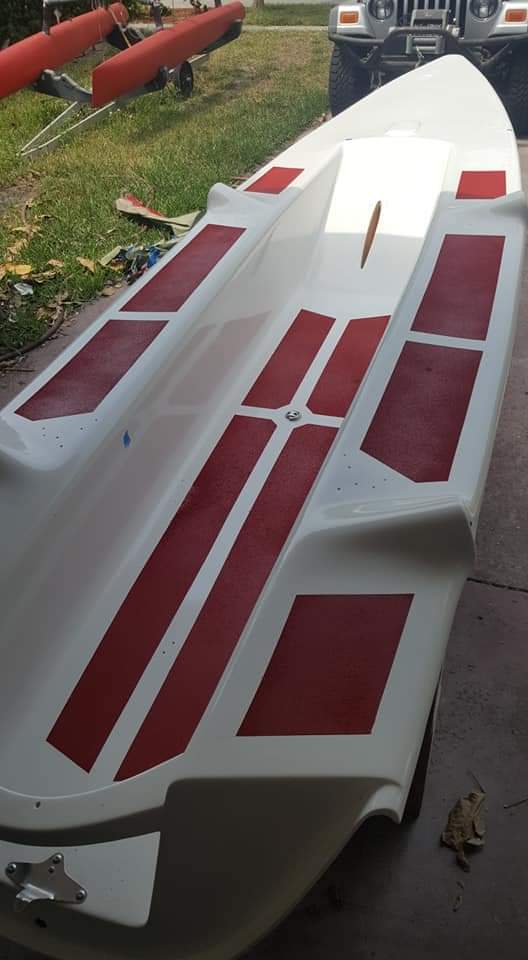

Im sitting little over 6’6" so moving around under booms is always challange… weight… yea haha.
Iv always done everything in gel-coat as i have all the gear needed to spray it… but it adds quite a bit of weight about ~8.5lb a gallon and the last 14’ boat i did used over 3+ gal. But out of the mold gelcoat process uses a lot more gelcoat then in-mold. Not including Chemicals like wax, duratec ect… and way thicker too. Iv never used paint with a boat, so going to try out Epifanes, got to be lighter and cheaper gelcoat… and faster too.
Last gelcoat i did was out of the mold…more time removing old gelcoat, that was the hard part… the grip is my own design. I spray slow cure mix gelcoat with extra bonding agent, then I load a ton of small composit texture grip. Before it curred and still safe to do another wet layer… I blew off the extra texture grip … then spray a layer with almost a 1:1 duratect gloss and gelcoat with bonding agent. thin layer… it came out perfect… loved it… holding up better then i could ever Imagine. (Think im limmit to one try again
