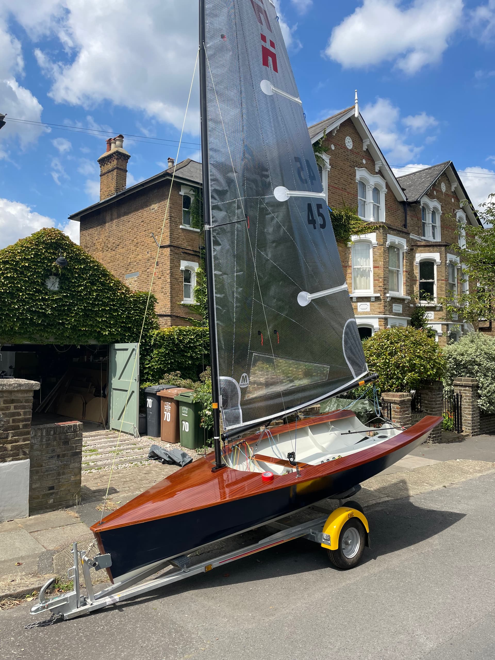

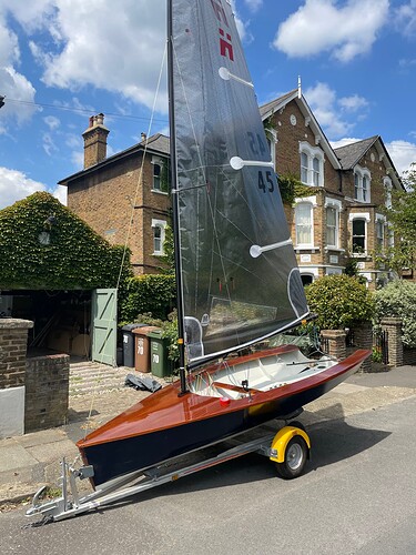

Staying true to Keiths original design seems to have paid dividends.
Looks absolutely fantastic. Be warned capsizing is a little scary! But you could add a buoyancy bag in back if you want to retain the “look”.
