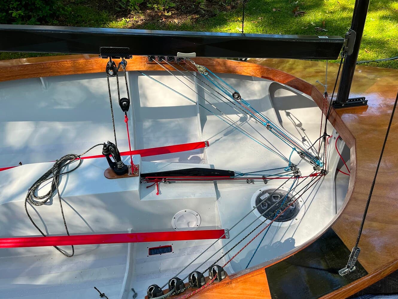

Those bolts are for the toestraps! I don’t think they are in best position. i ended up affixing the straps to top of tank. it seemed cleaner that way.

You don’t have to have affix the shrouds onto the shroud knee reinforcements. The drawings are a little confusing there. In the later edits Keith points out that you can just use a u-bolt going through deck as with later H2. Also I think you are missing the ‘transom pad’ for the rudder. Not a huge deal - you can just cut a piece of wood to fit snugly over that circular reinforcement. I was moving around clumsily on another boat and cracked the transom back there when my full weight was leaning on tiller…
As I recall the top forward panel wasn’t the correct on the plans. Double check that and/or measure off the side wall.
Also put in some solid reinforcement for the mainsheet block. Have it extend back further than the plans. Check out the H2 mainsheet systems that don’t go back to transom. You could consider having a thwart in there for a traveller.
