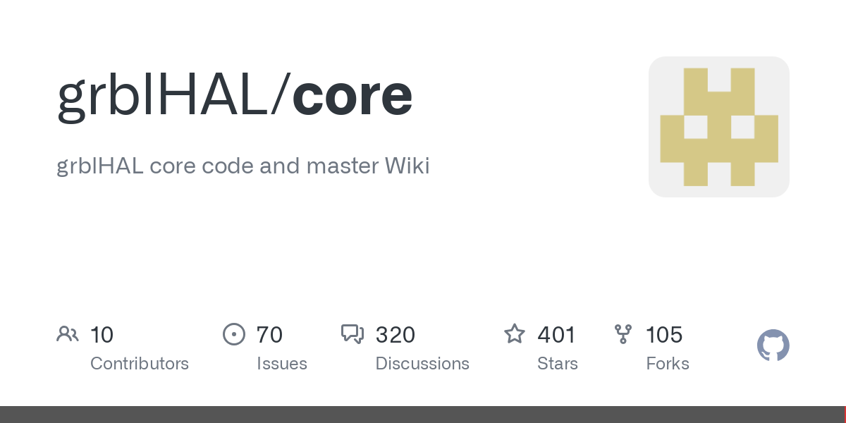

I was using the sender coded by the guy who invented grblHAL, Terje Io. (HAL is a hardware abstraction layer, which allows grbl to be easily ported to any new processor hardware that comes along.) This sender, IOsender, worked well most of the time but the UI was way behind the times, and settings are organised in several places. It took me ages to find where to set up probing.
So it’s new for this branch of firmware. Really contemplating buying a grbl board for my CNCShield to switch between the senders. :slightly_smiling_face:
If you are curious about grblHAL, here is the wiki on github.
My board only supports a grbl board, but those PrintNC guys all use the grlbhal thingy. :slightly_smiling_face:
