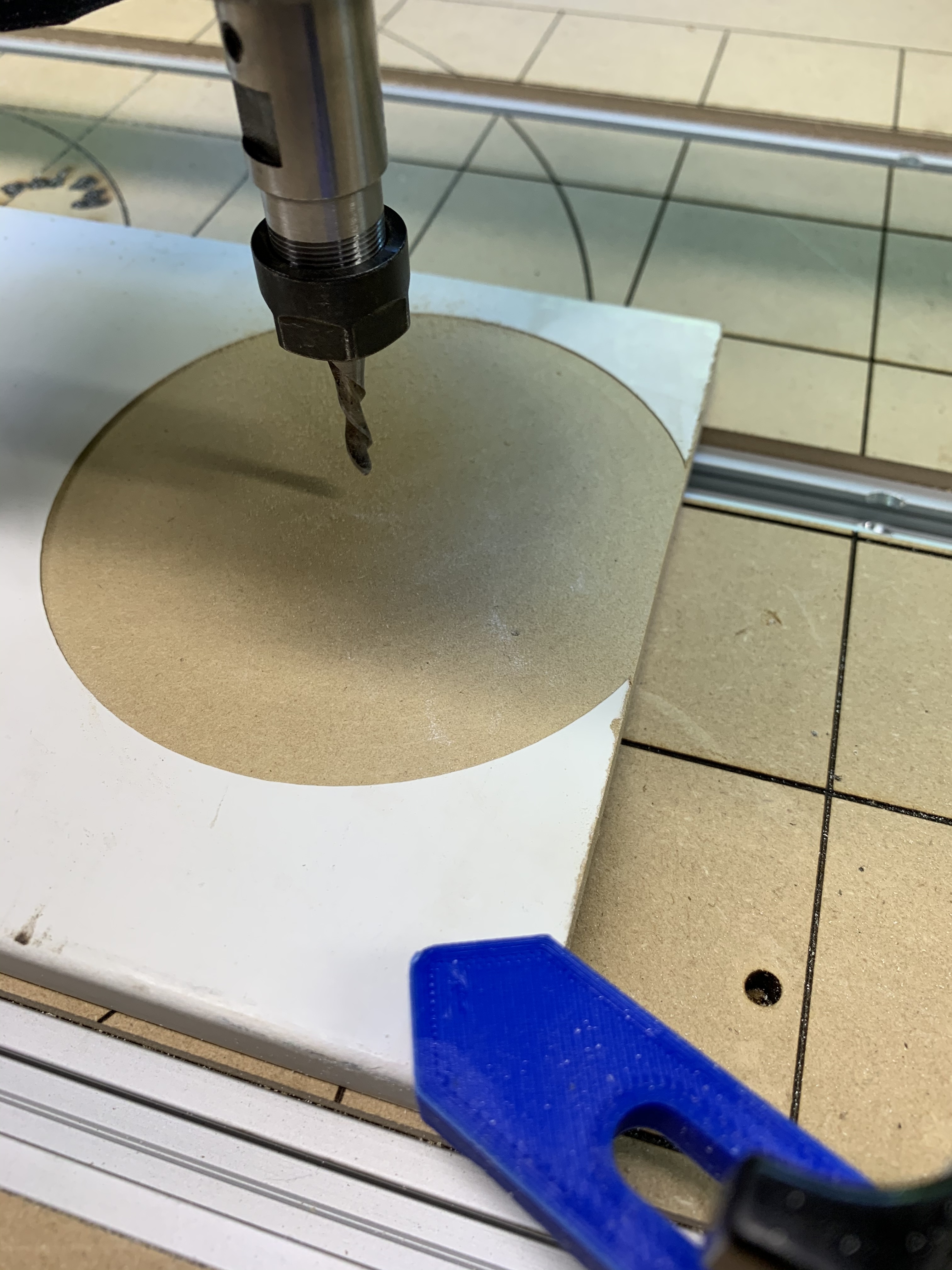

Thanks for doing that, Tony (and for your help too, Tim). And yes, it was following the same path on each layer that it was cutting. So it must be something wrong with either my GRBL configuration on my controller, or something with CNC.js.
As far as the configuration goes, I pulled it from the LOOOONG GRBL post in this forum. I think this one:
I don’t remember which fork I actually took, and if I recall correctly, I had to massage it anyway to finally get it all lined up. Seems to me it had the X2 and Y2 axis labeled as A and B, which was causing the “extra” stepper motors to stay stationary when the “original” stepper motors did their thing.

Thanks for the input, all. With your help, I was able to figure out it was a firmware issue. I had $11=0 and $12=0. Changing the $12 to 0.002 seems to have fixed the issue!

Wooooooow. That is TOTALLY not what I thought $12=0 would look like!

  2. Level my spoilboard. On the 100mm circle, there’s a variance of about 0.4mm from one side to the other. Maybe I better check my legs are all firmly seated… That seems like a larger difference than I would expected. On the plus side, it seems to be well trammed, as the bottom of the circle was very nicely flat.

When you disable arcs, are there still G2/G3 in the gcode? It looks like you fixed your arc config, but guffy would probably want to know if his post processor had a bug like that.
I confirmed it, still G2/3 moves. Started with the simplest circle I could sketch before attempting to troubleshoot, thanks to advice from guffy himself after my other issues that weren’t actually arc related.
I wonder if it’s not a bug because my other grbl pp does the same thing.
@guffy. In case you weren’t aware.
Yes, it was issue for GRBL only version. I had not hear about any problems with arcs in GRBL, so I have no idea why it cauld be handy.
but anyway it’s fixed now
Grbl arcs are so SMOOOOOOOTH
