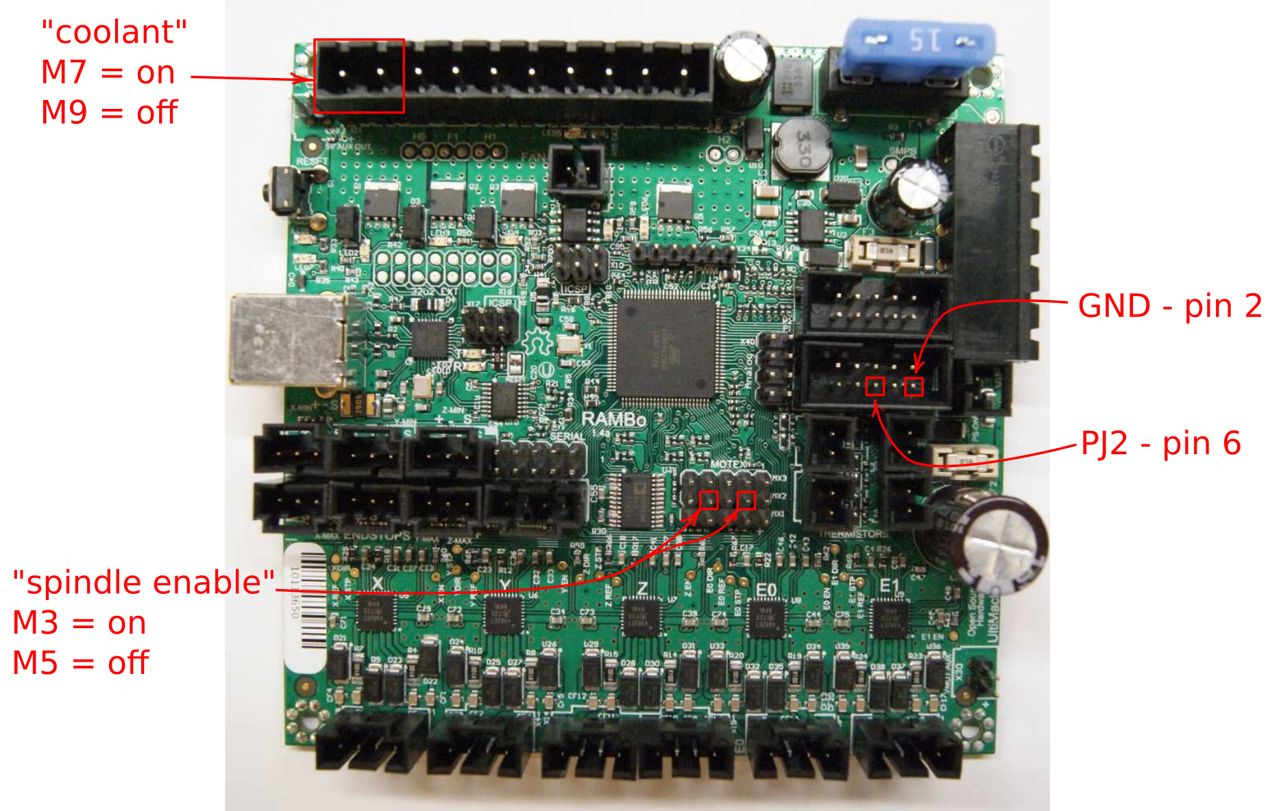

Okay, I think I have something going here. Fumbling through the dark with this stuff, I have my Spindle and Coolant both working within cnc.js, rambo 1.4, and grbl using John’s great work. In case anyone else looking for this, this is where you tie in your relays or what might have you. This is not changing any cpu pin mapping. I understand that most may already know this. This should also answer @victord question from awhile back.

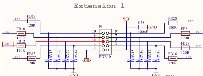

Now, I have also tried to wire a physical button input for Feed Hold (pause) to the LCD connections, “Extension 1”, Pin 6 (PJ2) as shown in the schematic. but am not sure where the other wire would connect to. I am assuming GND, but it did not work. Is this not how input pins work? Below is the cpu_map.h and schematic. I am connecting to correct pins, aren’t I?
Thanks in advance!

According to the configuration and source code you are connecting the correct pins. What you describe should work for the feed hold but my RAMBo 1.4 does not appear to recognize the hold or safety door inputs.
The default configuration has the pin reporting enabled (REPORT_FIELD_PIN_STATE) so it should print ‘H’ to the Grbl terminal when the hold input is pulled to GND and likewise it should print ‘D’ when the safety door input is pulled got GND.
I didn’t have too much time to experiment, but the reset and start should also print the letters ‘R’ and ‘S’. I’ll see if I can experiment some more tomorrow.
