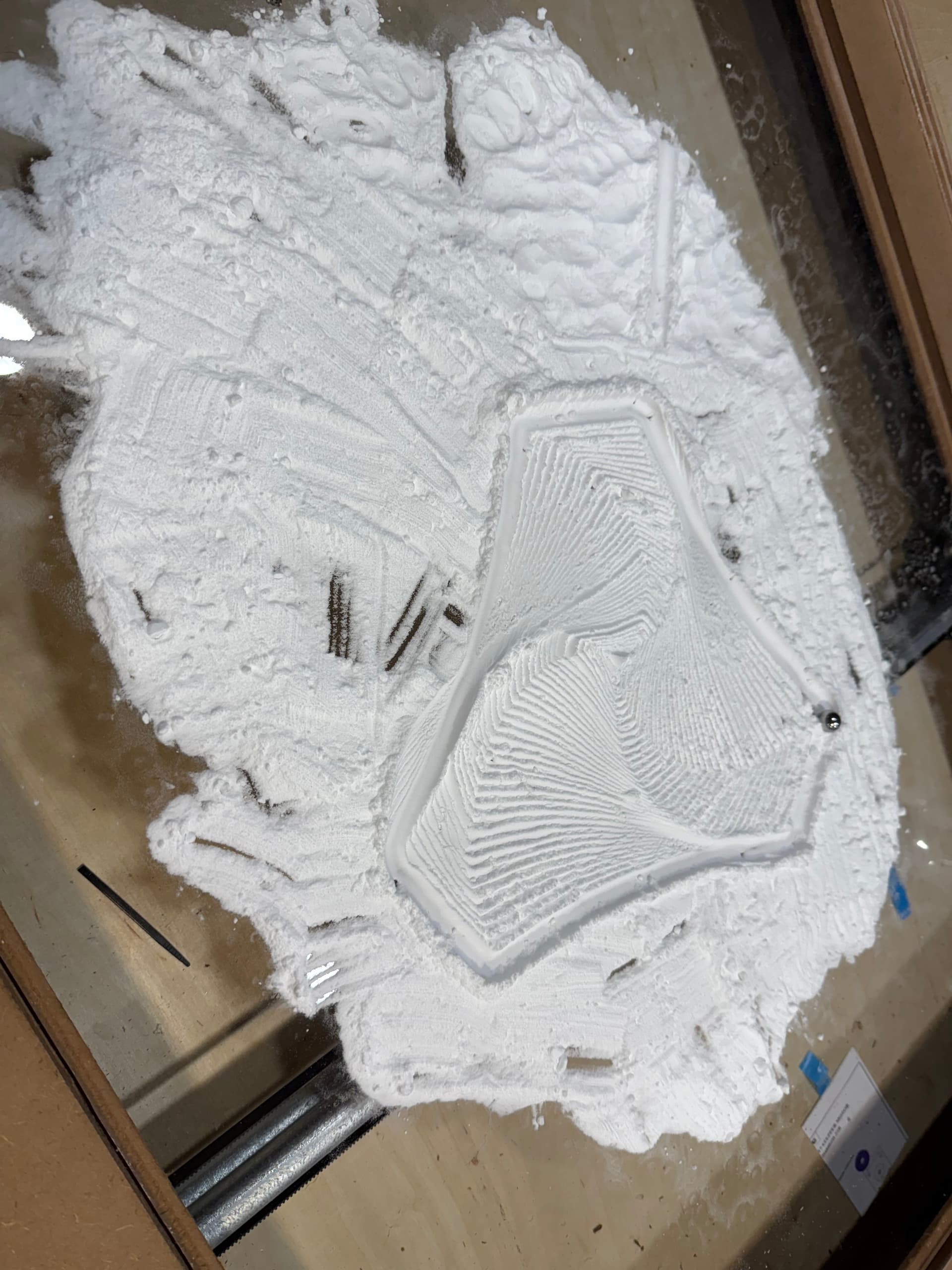

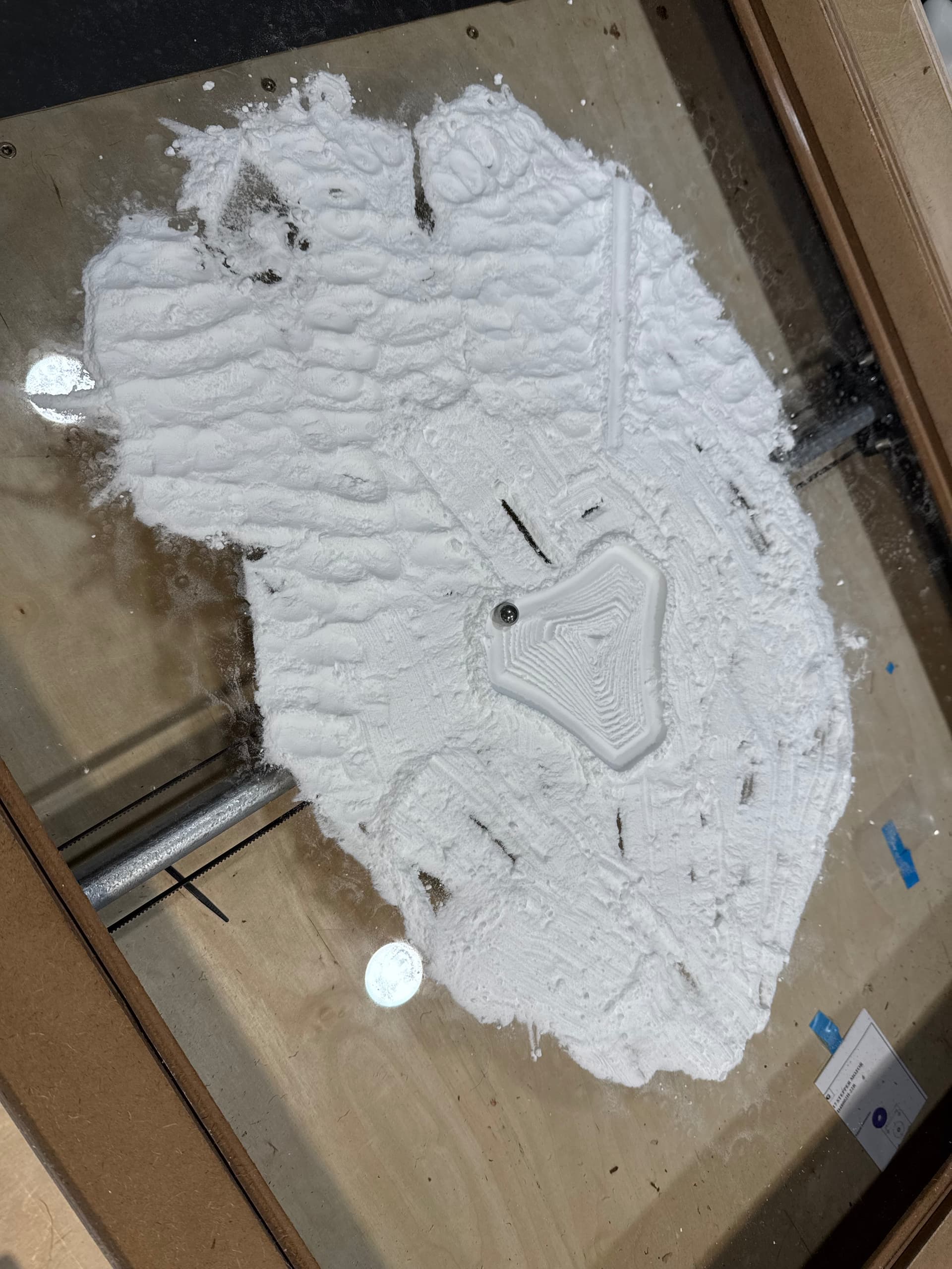

I said I wasn’t going to do it but I just had to see it lol…
Boss lady had one small box of baking soda so we dumped that in, got as many clumps out as we could and spread it around some. Loaded up the V1 logo in Sandify and sent it off and running…
So cool seeing it run around.
I still need to do some work on it of course. Its not wanting to home X correctly. And I need to figure out the start up gcode stuff but for this temp run it was easy to just send it.

Yeah I thought it was going to be a LOT more. I need 1/2 a box or less to finish filling this one. Headed out the door to the boat for 2 weeks right now. So next time home I will finish filling it and get the rest of the table built.
