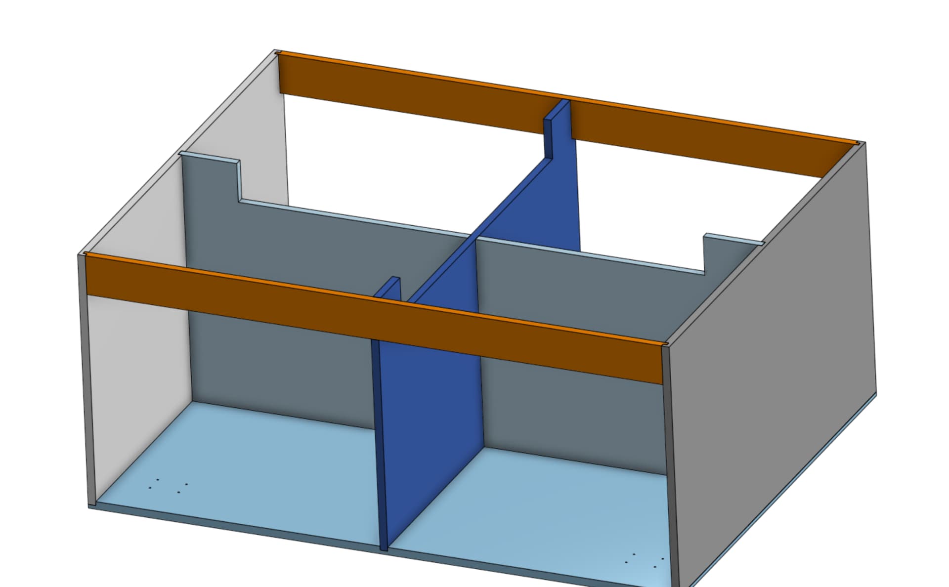

Don’t laugh at my unfinished cad but here is the idea…
The plan is a “test table” to run my prebuilt LR4’s on before they get packaged to ship, and what would be better for pics and such than having a nice Zen table in the middle with LEDs and such???
The idea is the Zen will be part of the table top, with the cabinet bases notched out to allow room for the actual Zen. I also went with the layered approach stolen from @jeffeb3’s awesome Zen table for RMRRF
The 4 separate parts are for the “LED Layer” and keep the LEDs (hopefully) back far enough to keep the actual LED’s invisible. And being the 4 separate parts they don’t waste near as much material.
I think my largest concern right now is do I have enough room under the frame for the actual Zen machine.
Hopefully I have shown enough to give the idea of what I am trying to build without wasting anyone’s time. If you see anything that looks dumb or wont work don’t hesitate to point it out before I pull the trigger and start wasting material lol. Ohh and I forgot to say earlier that I have 2 sheets of 1/4" Acrylic (I think, might be polycarbonate, I cant remember right now and too lazy to go look) one for the top and the second for the base to put the baking soda on.
Easiest just to build the Zen and take some measurements. It is nice to really squeeze it in and leave as little extra room. Sucks the CAD is gone.

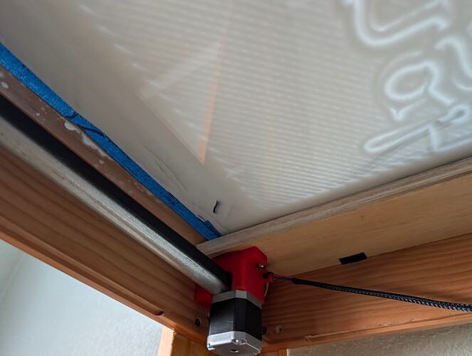

Made a little progress finally. Got the conduit cut and everything assembled minus the belts. I’ve had the kit for this thing for so long that I lost some of the hardware. M5 nuts and M3 screws were no where to be found, but had everything else and thankfully spares of the needed hardware.
Now I need to get off my butt and build the table top (and the rest of the table) so I can actually get it mounted and figure out how to run it lol. Picking up the needed plywood tomorrow so that’s a step in the right direction!
HOPEFULLY before I head back offshore next week I’ll have some pics to post of it at least mounted to the table top lol

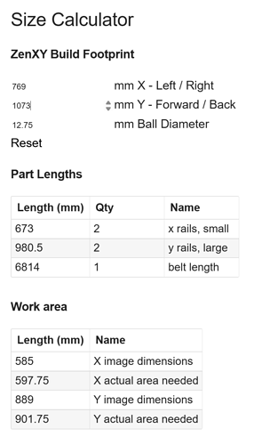

Here is a link to the CAD in Onshape. Don’t judge too much please.
Also…
I fiddle with the calculator numbers to make the Image Dimensions equal to what I have open on the acrylic inside of the “lip” to hold the acrylic. Does this look correct? Or do I need to give a little more wiggle room?
Yup screws with fender washers.
Not sure what you are asking for, but I have mine set for minimum and planned on cutting holes for the steppers to poke through.
My glass goes all the way to the outside of the frame that is why I do not have any side screws of fender washers…or even a frame for that matter, But it also means I stacked two magnets to get that extra 1/2".
The dimensions it gives should be the exact outside path of the ball that is why it asks for the ball diameter, you will need to add a lip of your own.
With the way this table top is on top of cabinets instead of just a normal table like you have, I have to create clearance underneath. That was why I added the CAD for it but here are some screen shots that hopefully will help explain it better…
The square “notch” cut in the top of the cabinet middle/back is for the Zen to have clearance. The top (second pic) sits down into the cabinets. That’s why I need to make sure my notch is low enough and the sides coming down from the top are long enough to give the motion system clearance to move without hitting. I am fine with the motors sticking down lower as they don’t move and are in the clear as far as the cabinets are concerned. Hopefully this makes more sense now.
Sweet. That’s what I was assuming, but we all know what happens when you assume :rofl:
as of right now I will be up 4mm. So hopefully I can just space the magnet up that high and be ok.
