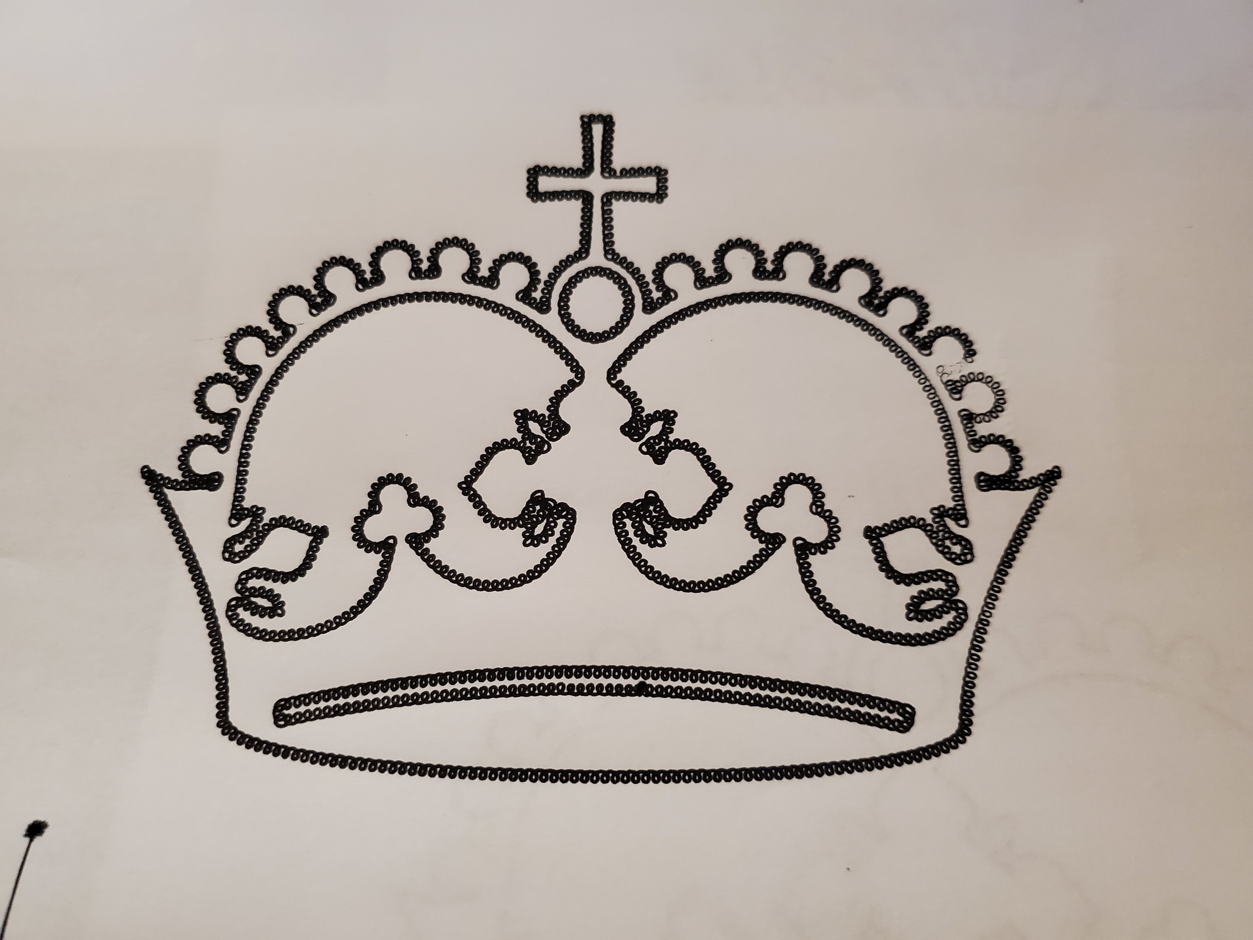

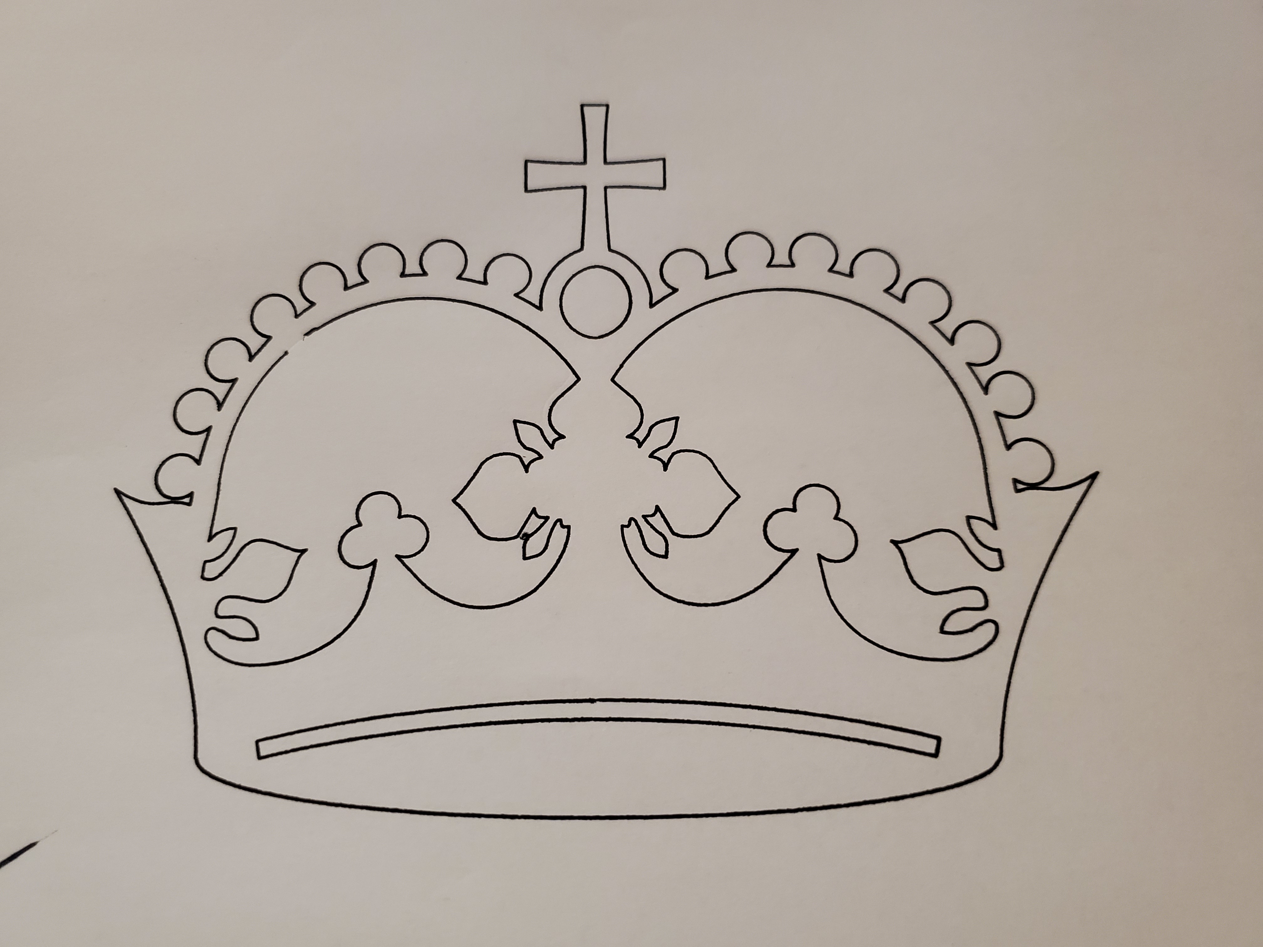

I got the crown all setup but its creating loops (or spirals) instead of straight lines. I’m not sure what settings need to be changed.
problem solved
spiral problem that has been solved.
after solving spiral problem.

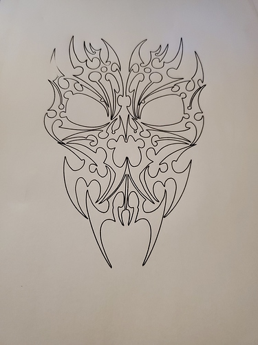

and a little fun because I had a vectored image. Don’t worry about symmetry this is a doodle from a decade ago that I drew in the middle of class.
