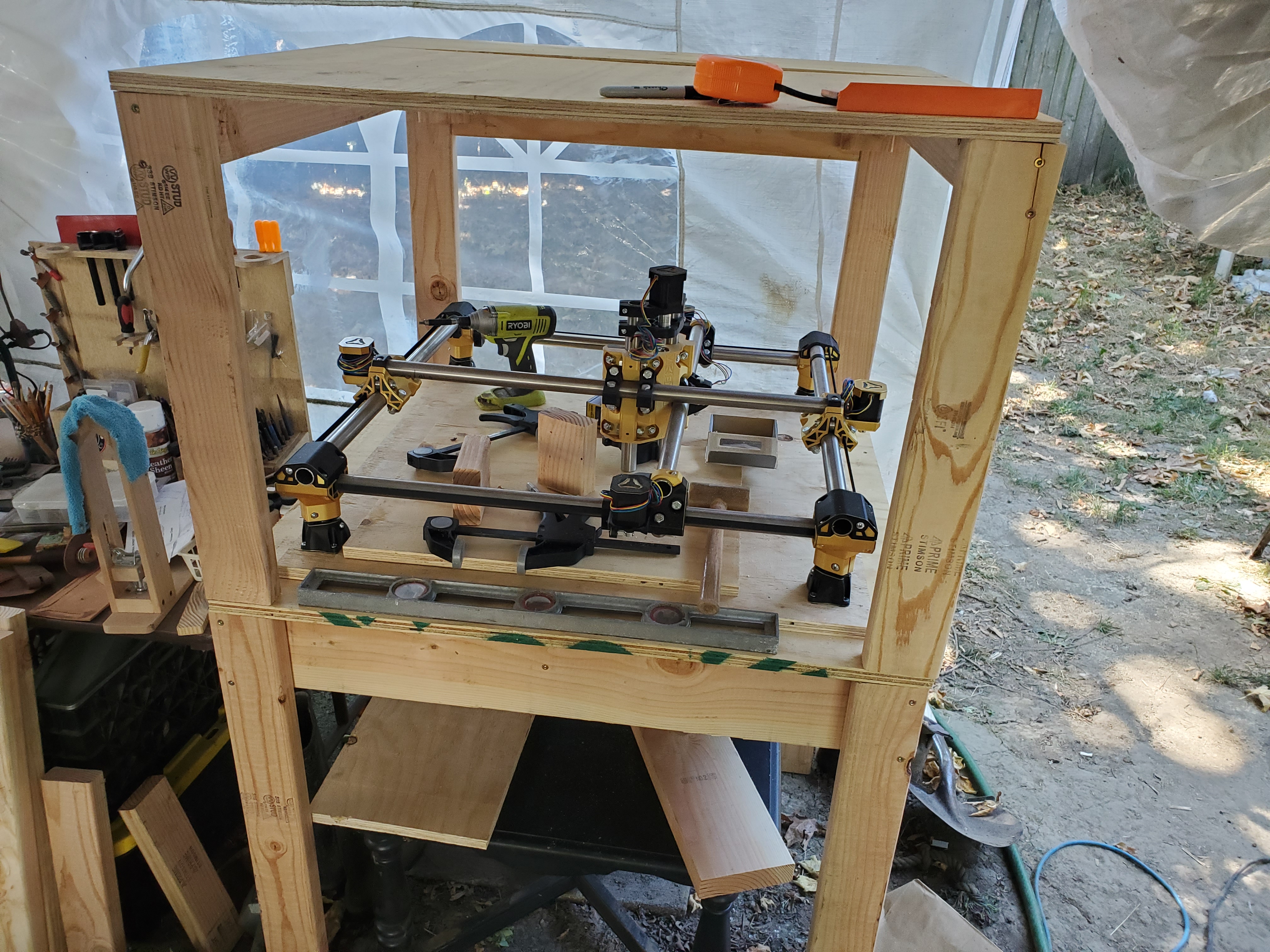

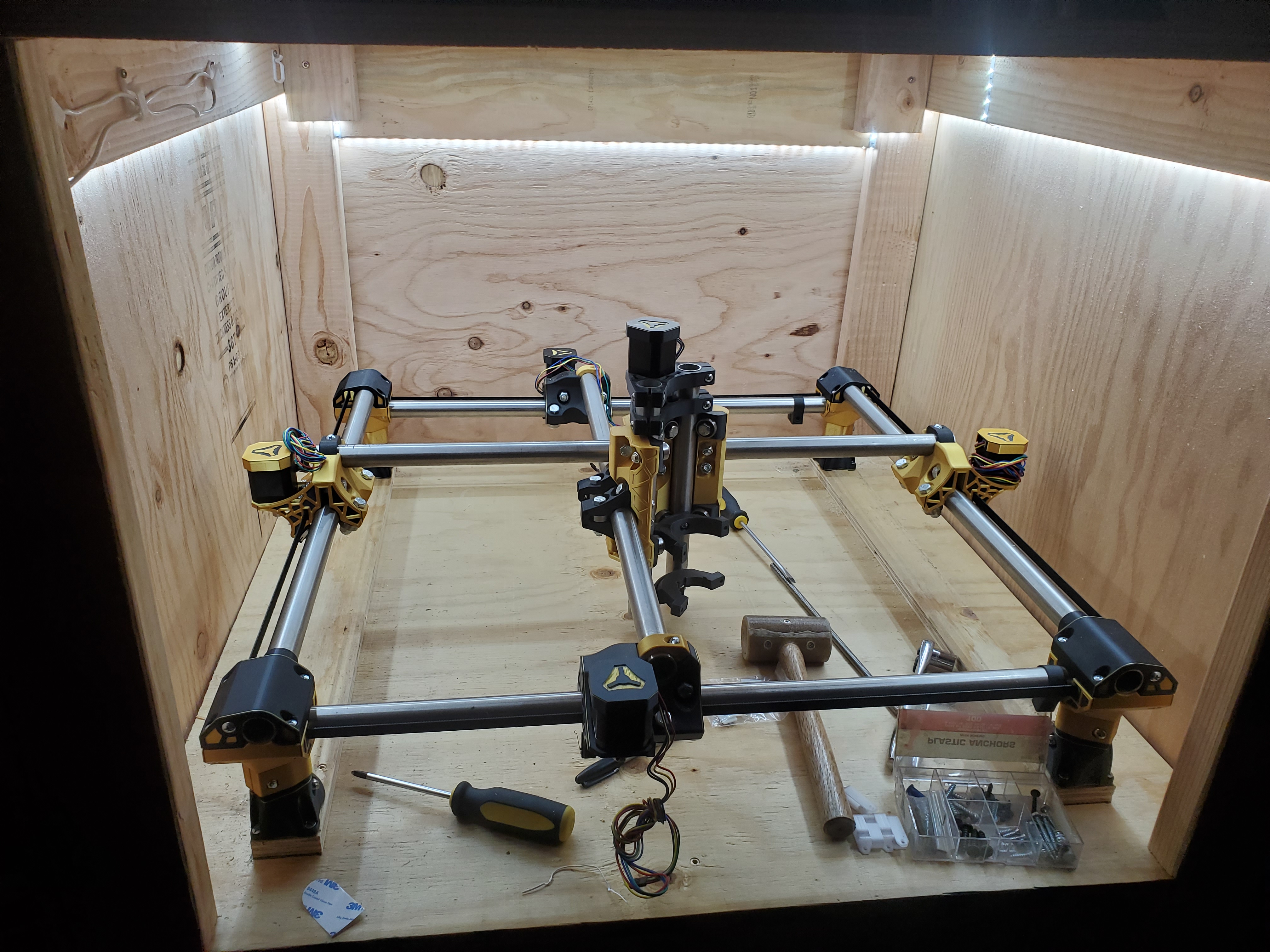

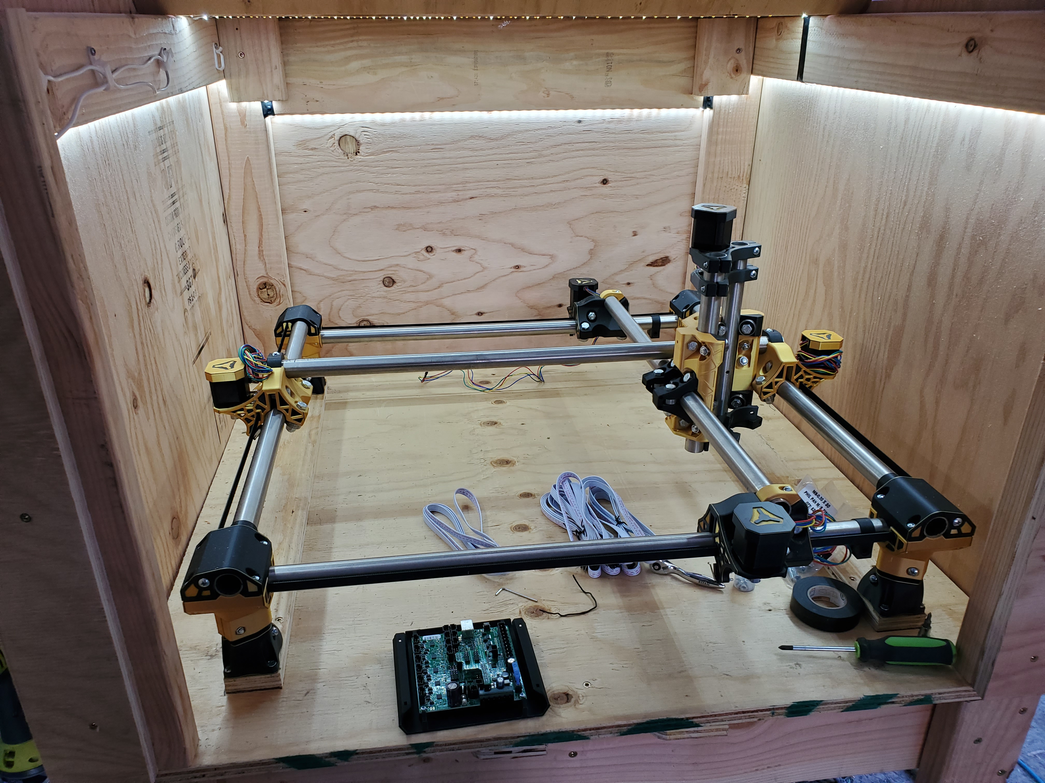

Alright V1 Fam! This is the first chance I have had to share my progress since my last set of images. Here is the table / enclosure I have been working on. I really didn’t put a lot of thought in to it. My main thoughts were to make it fairly easy to work on (lid lifts up on hinges and the entire top is removable if need be), have at least some sound reduction and have enough space to add an overhead vacuum… Eventually. I also wanted to have my enclosure ready when I do the wiring so I can make everything look clean. More updates coming by the end of the weekend hopefully.
I took the primo apart so I could separate the spoil board. I was a little over confident with reassembly and messed up the orientation. You may notice this in the images. I have since fixed this oops. I had to flip a couple trucks flip the core and turn the base 90 degrees… Oops… in the end this made the front left corner home.
