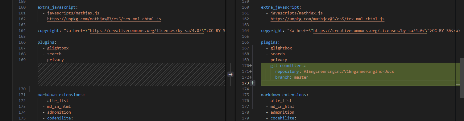

My Token is not being seen. I did create one with the name cut and pasted so it should be right. (tried it several times). I tried adding some environmental secrets and variables with it and that did not work either.
What am I missing?

The last change you made is for GitLab, not Github.
I think you need something more like this one using the Github secrets

With your github token inserted directly locally, does it render properly?
Seems like adding something as an environmental variable for the mkdocs-git-commiters-apikey is a good option as well but I don’t know how to set the location. I tried adding it and just see if it worked, and it didn’t.

You have a token created in Github I assume?
And did you have it in your mkdocs.yml file when you built locally?
nope, and nope.

“For a repository hosted on GitHub, you can provide a token to increase the rate limit and go beyond the default 60 requests per hour per IP address. The plugin will make one request per mkdocs document.”
If you aren’t setting a token, it is making an anonymous request, and should be subject to the limit.
Your best best is probably to go ahead and make the token as it needs.
Create a secret in github that you can use in your Workflow
Add your secret as an environment variable, then set up the mkdocs.yml to use that environment variable
First, I would create the token, and verify the errors go away using the token in a local build to make it easier to verify the first step before trying to automate it
Token creation
The token does not need any scope: uncheck everything when creating the GitHub Token at github.com/settings/personal-access-tokens/new, unless you access private repositories.
For private GitHub repositories, you only need to allow read-only access to Contents and Metadata on the target repository. This could be done by setting Read-only access of Permissions > Repository permissions > Contents.
