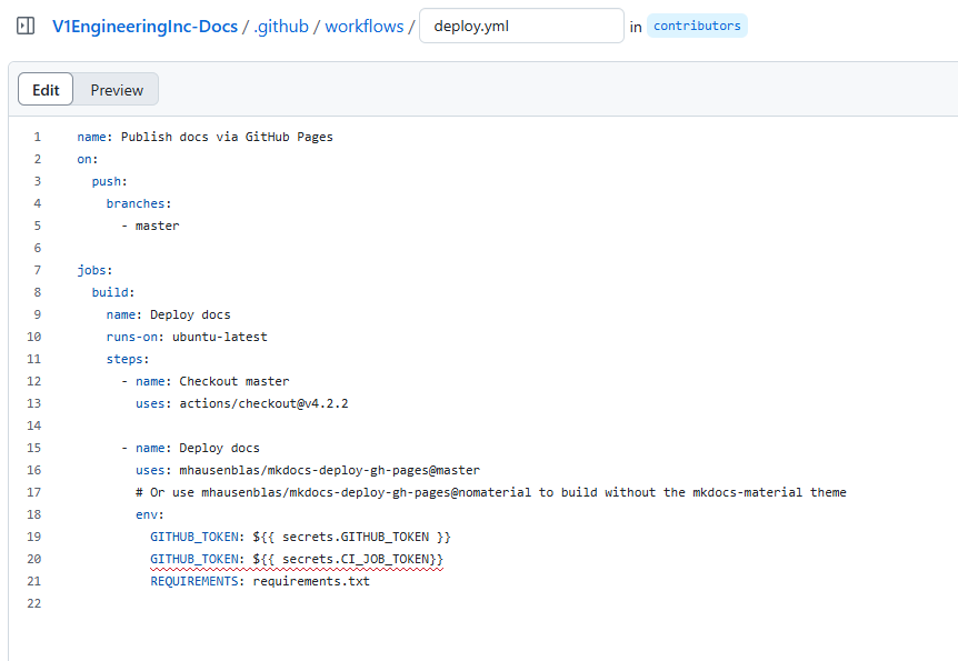

env:
GITHUB_TOKEN: ${{ secrets.GITHUB_TOKEN }}
You need to create a secret and put your token in it.
You just need to replace it in the yaml.
You can’t call it GITHUB_TOKEN though.
So if you create one called ‘REMOTE_TOKEN’
it would be replaced like this instead
env:
GITHUB_TOKEN: ${{ secrets.REMOTE_TOKEN}}

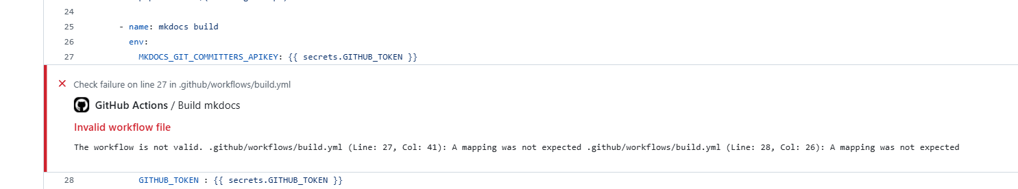

contributors · V1EngineeringInc/V1EngineeringInc-Docs@1b438c3 · GitHub , Nope same error. I think I need to make a new token, not use the automatic githubtoken
You may have exceeded the API rate limit or need to be authorized. You can set a token under 'token' mkdocs.yml config or MKDOCS_GIT_COMMITTERS_APIKEY environment variable.
Add another environment variable
env:
MKDOCS_GIT_COMMITTERS_APIKEY: ${{ secrets.GITHUB_TOKEN }}
GITHUB_TOKEN : ${{ secrets.GITHUB_TOKEN }}

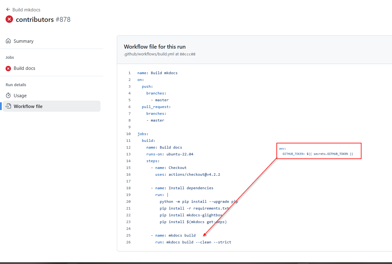

to both build and deploy?
whichever workflow is doing the mkdocs build that has the plugin fetching
ok… i see.
you have it in deploy.yml, but it should be in build.yml
that’s where the requests are actually happening, during mkdocs build

It needs it in deploy as well to be able to write I think.
Missing ‘$’ in front of the expression
Ryan:
it won’t hurt it to be there, but I don’t think you need it now, if you didn’t before
