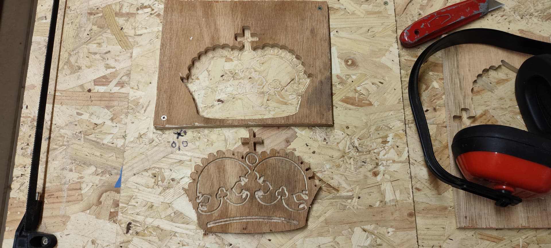

I have been making first cuts with my Lowrider V4 and it’s working sort of well!
I have noticed when I do a part cut in estlCAM with the correct material depth, the machine will not cut all the way through, e.g. this crown took a few jobs to get all the way through with some gcode hacks (hence uneven edges)
On closer inspection, z -12 seems to correspond to -7mm on the work when zeroed to the top surface. I did configure xyz offsets before starting, but perhaps z needs a closer look.
My controller is an SKR PRO 1.2 running V1CNC_SkrPro_DualLR_2209-2.1.1
Lead screws are 8mm T8 Lead Screw 2mm Pitch 4mm Lead With Nut, as specified in the BOM.
I fiddled with esteps/mm to try and make z more accurate.
Current values are: M92 X100.0000 Y100.0000 Z823.0000.

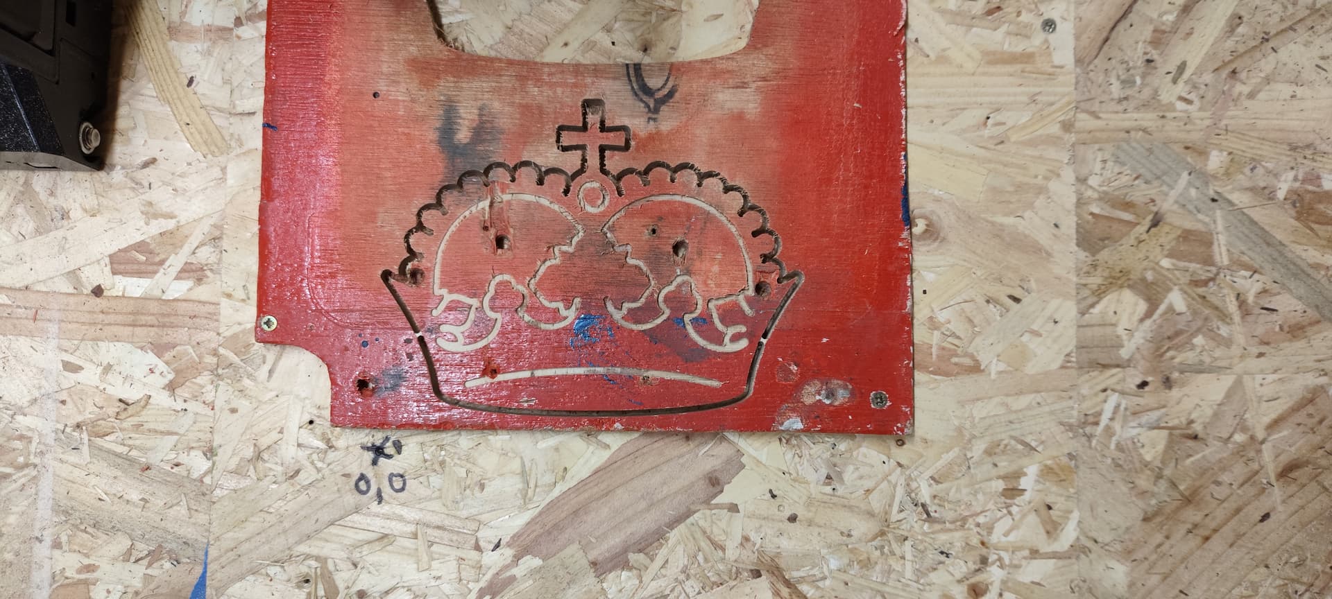

This brings me closer to correct values, but it’s still a bit off. With 3mm estlCAM DOC, this makes quite aggressive cuts of around 3.5mm, and shapes are not accurate probably due to deflection. The crown below was set to 3mm engraving and 9mm part cut around contour, and you can see evidence of deflection, particularly in the circle at the top. but it did cut all the way through in one job!
I managed to ruin each of these at the last hurdle by crashing the spindle into the surface, or filing off tabs and splitting the ply :frowning: but they’re just scraps…I still have lots to learn.

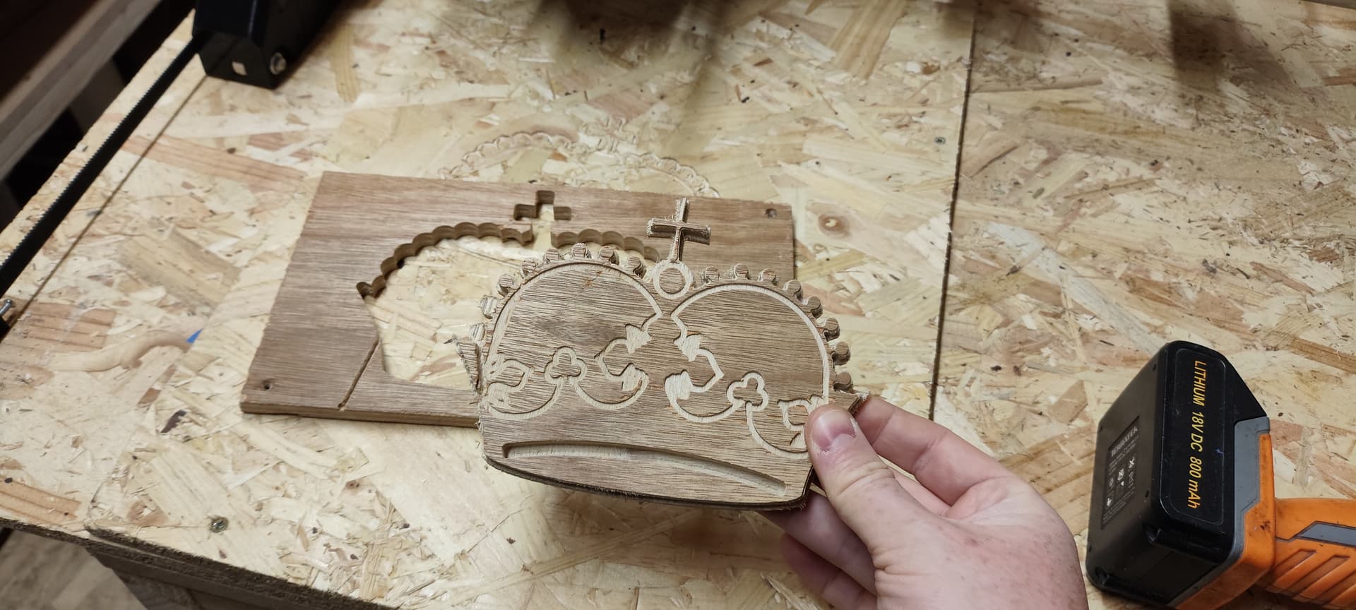

I suspect the steps for z should be 800 - this is dictated by the pitch of your lead screws. Double check all the grub screws on you z axis. Actually check them all, sneaky blinders that they are…

I set the Z steps to 800 and it’s working a lot better!
I’m getting the hang of estlCAM now so perhaps I’ll stick with it.
Latest results (before breaking the tabs)
It went all the way through just fine. I could probably benefit from using a smaller endmill here - I’m currently using a 2.4mm but I notice it’s missing some of the intricate cavities of the geometry.
