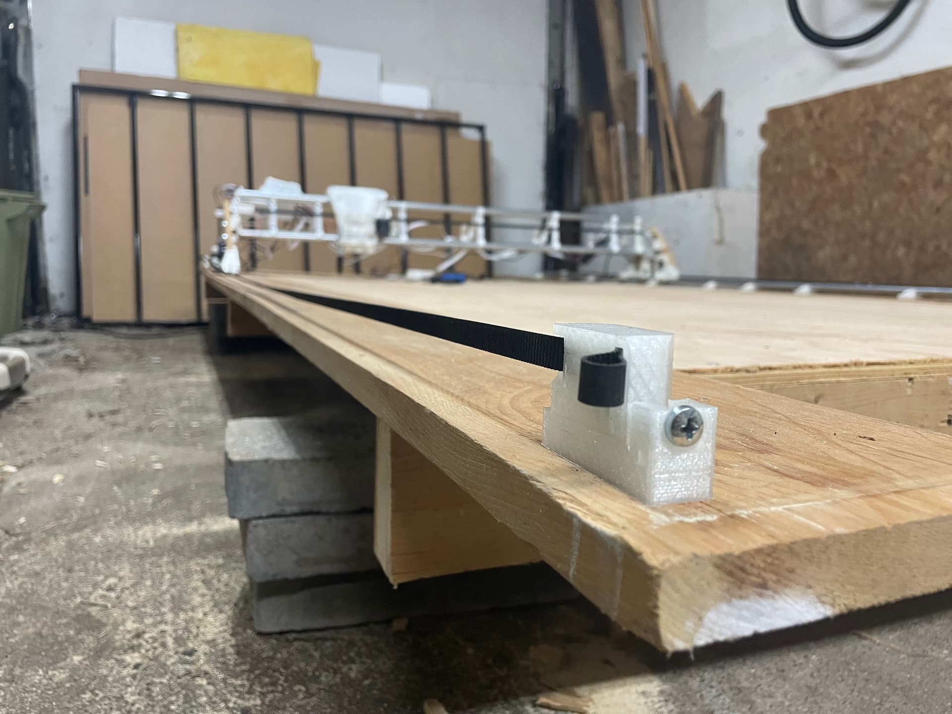

So just want to show the progress so far. Build the table top and currently just want to get the strut cut before finishing the whole workbench.

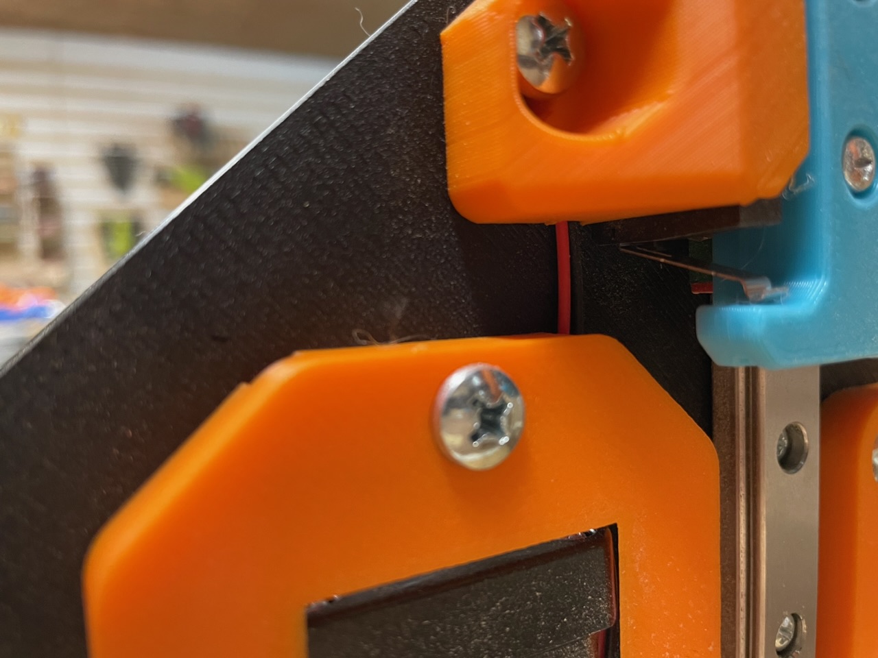

Hey guys, so I’m starting to home. Oh and I don’t want to create thread on thread for newbies question so I’ll fit everything here!
  • For the endstop/limit switches to be triggered do they need to click or just be barely touched? Because I’ve been homing the CNC and for the X and Z axis it just go on forever doing a loud noise.
I tried to run a G92 X1100 Y2400 Z214 as a good point to start on my table but also without success.
What am I doing wrong?

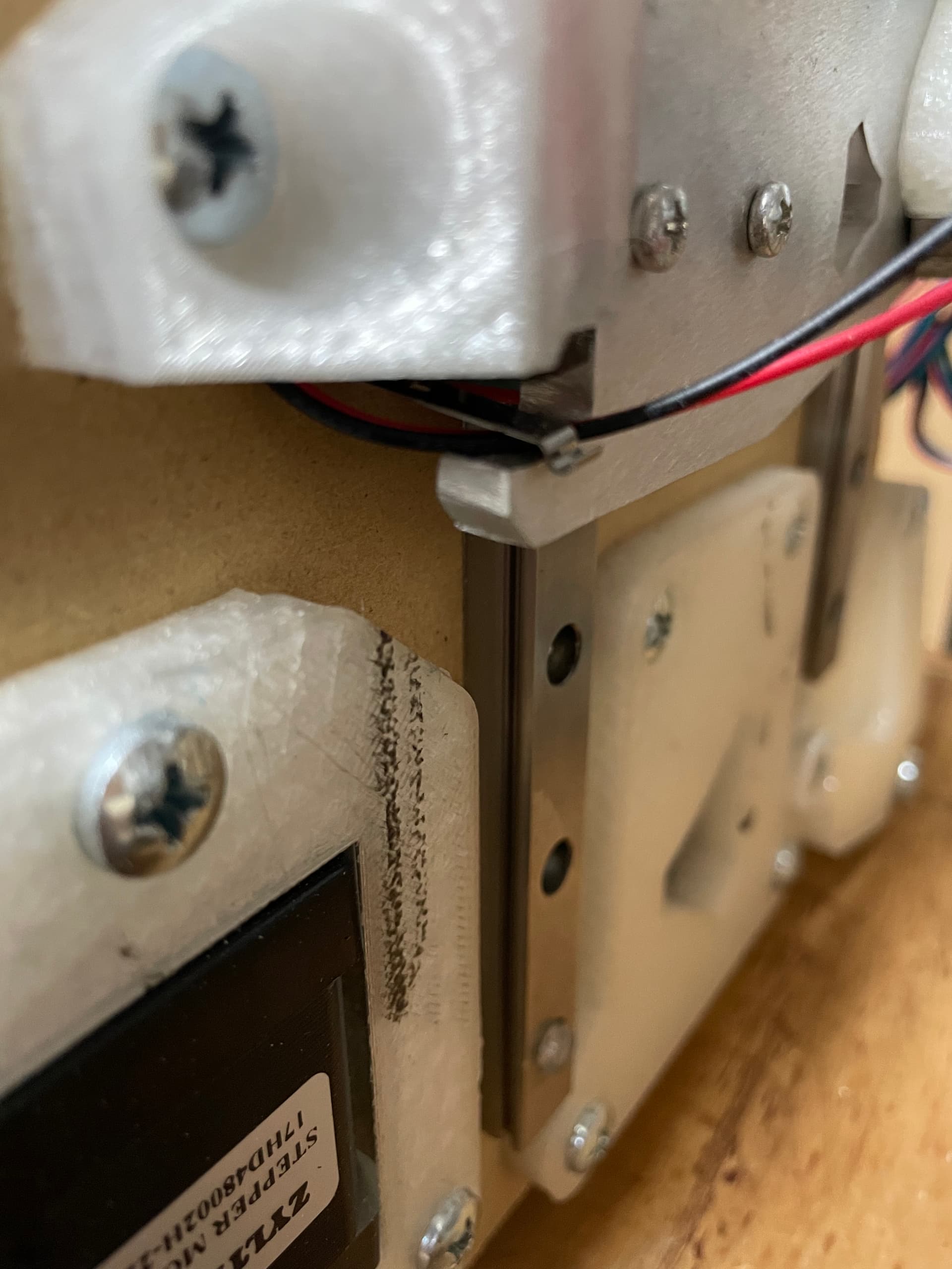

I uploaded picture to show you the Z endstop, it doesn’t click it just barely touch it. So maybe I will have the move the endstop a little bit further down the plate.
Thanks
You should hear it click. You probably do have to move it a little bit.
Looks like your wires might get in the way too. I would tie those back

By the way, the X only as 1 endstop? Right?
Yes. The X axis only has one end stop.
Regarding the end stop switches touching but not clicking, one easy fix is to bend the little metal blade a bit so that it makes contact sooner.
The main reason I designed those 3-D printed “boot” extensions was because in the course of dismantling and modifying and repairing and rebuilding, I kept losing the little blades off the end stop switches, so I decided to put those printed boots on so I could do my end stops without blades. Ryan says the blades help them be slightly more accurate. Probably true. I have been OK without them.
Yes mine barely touch the blade. I might have set the rail a bit wrong I assume.

There should be “cut-outs” in the Y motor housing to pass the Z endstop wires into. That allows you to bundle them together with the Y and Z motor wires, and the Y end stop wires. It will keep them out of the way of the Z end stop switch.
How you have them.now, there is a danger of the wires getting pinched or cut by the XZ plate, or them fouling the linear rails. Cleaning up the wiring will make the machine more reliable to operate.
Like this, as @SupraGuy said:
There’s a slot in both pieces for them to pass. This lets the stop wiring pass to the outside to bundle with the stepper wires, out of the way of moving parts

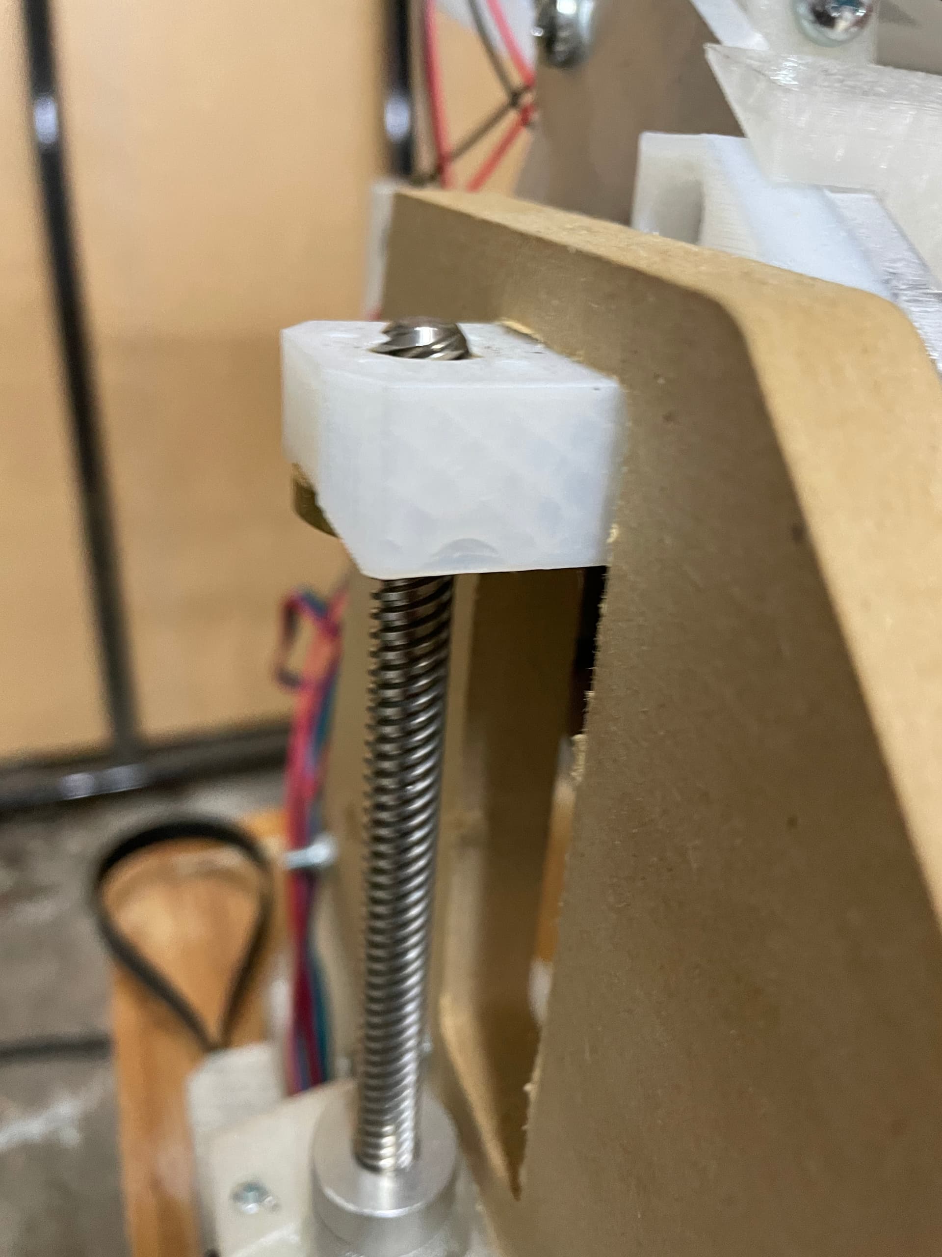

Need help here!
So yesterday finally succeed to Home the whole thing. X, Y and Z.
Today woke up, tried to move the machine and it wouldn’t. I’ve been re-doing the wiring today and again made the whole machine worked, Now, I once again home the whole thing and now my Z motor won’t work.
Anyone with the same issue?
Thanks
