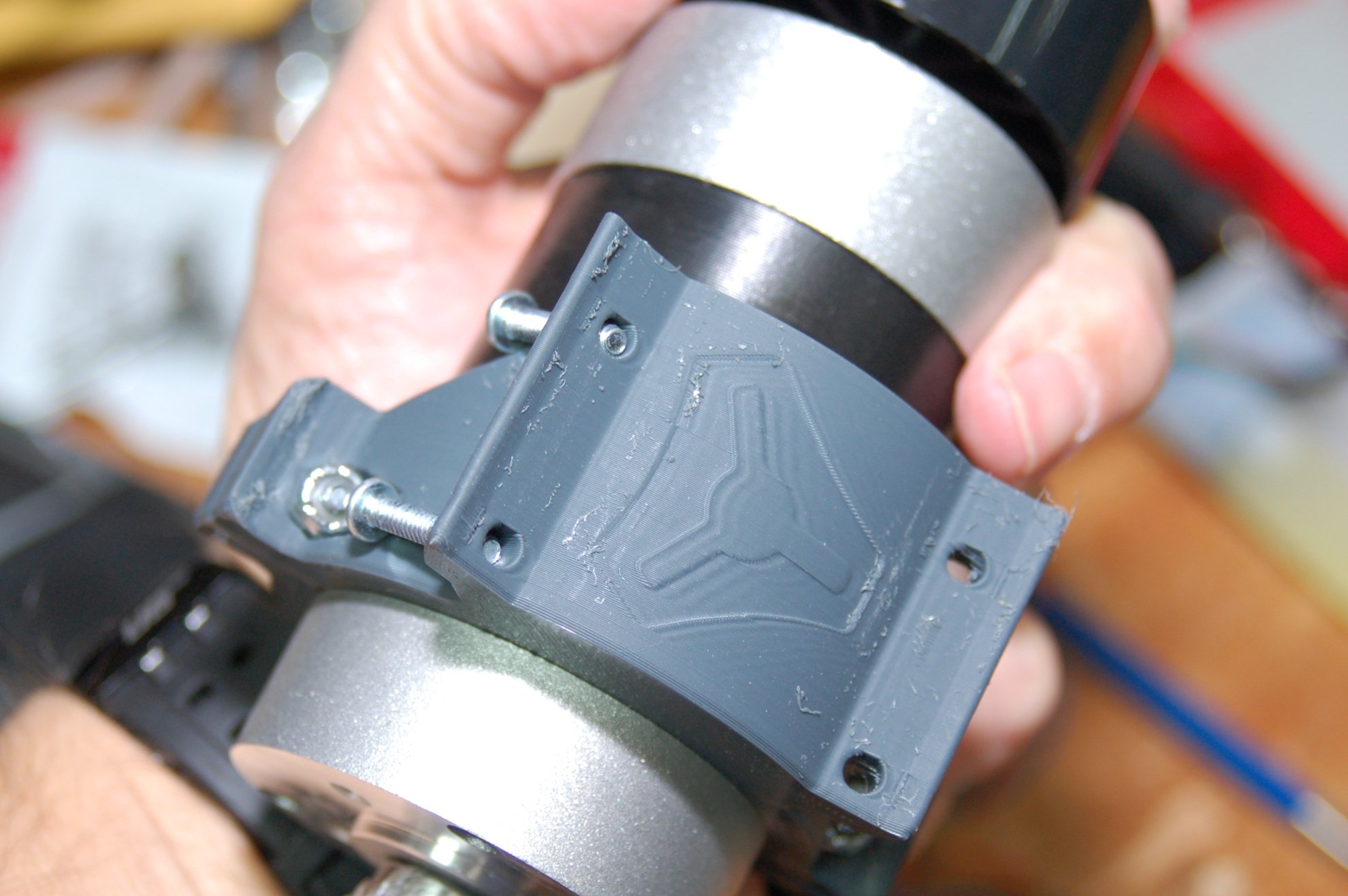

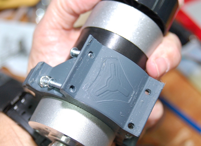

Ryan, can you tweak that 55mm mount you designed? It looks great and it fits great, but you can’t mount it. :slight_smile: The screw path is blocked :smiley:
[attachment file=86663]
The contact surface could be increased quite a bit since there’s really only room for a single mount in the body of the motor.
tnx!
g.
Shoot. If you move it down onto the silver band can you get two of them on there? As for the screw I need to look into it. The dewalt one is kinda like that but once it is in a slight angle on the screw driver worked…So if the screw can’t be pushed in most of the way I can make a larger screw divot I guess? I figured the smaller diameter would actually be easier to screw in than the dewalt.
The silver caps are 56.7mm in diameter. The top cap is 23mm tall, the bottom cap is 20mm tall. The spacing between the caps is 56.6mm.
With your current bracket design, there’s no “line of sight” to the bottom screw at all. Even if I could get a screw in there, no screwdriver I own could turn it. :wink:
The top screw hole is blocked around ~20% by the rising arm of the bracket.
The top silver cap is divided in the middle by the power & control cables that go into it, so it’s really not a good mounting option.
Could you design a monolithic bracket that grabbed the motor body at right under the top silver cap and again at the bottom, but around the bottom silver cap? That would provide space for three mounting holes on each side with clear sight lines for each.

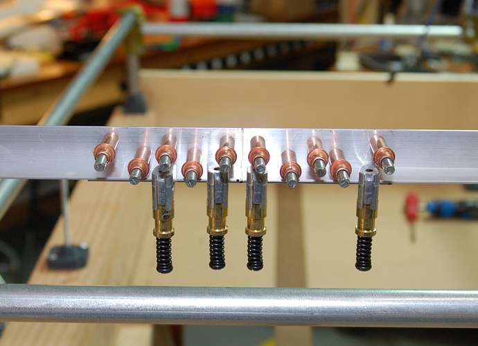

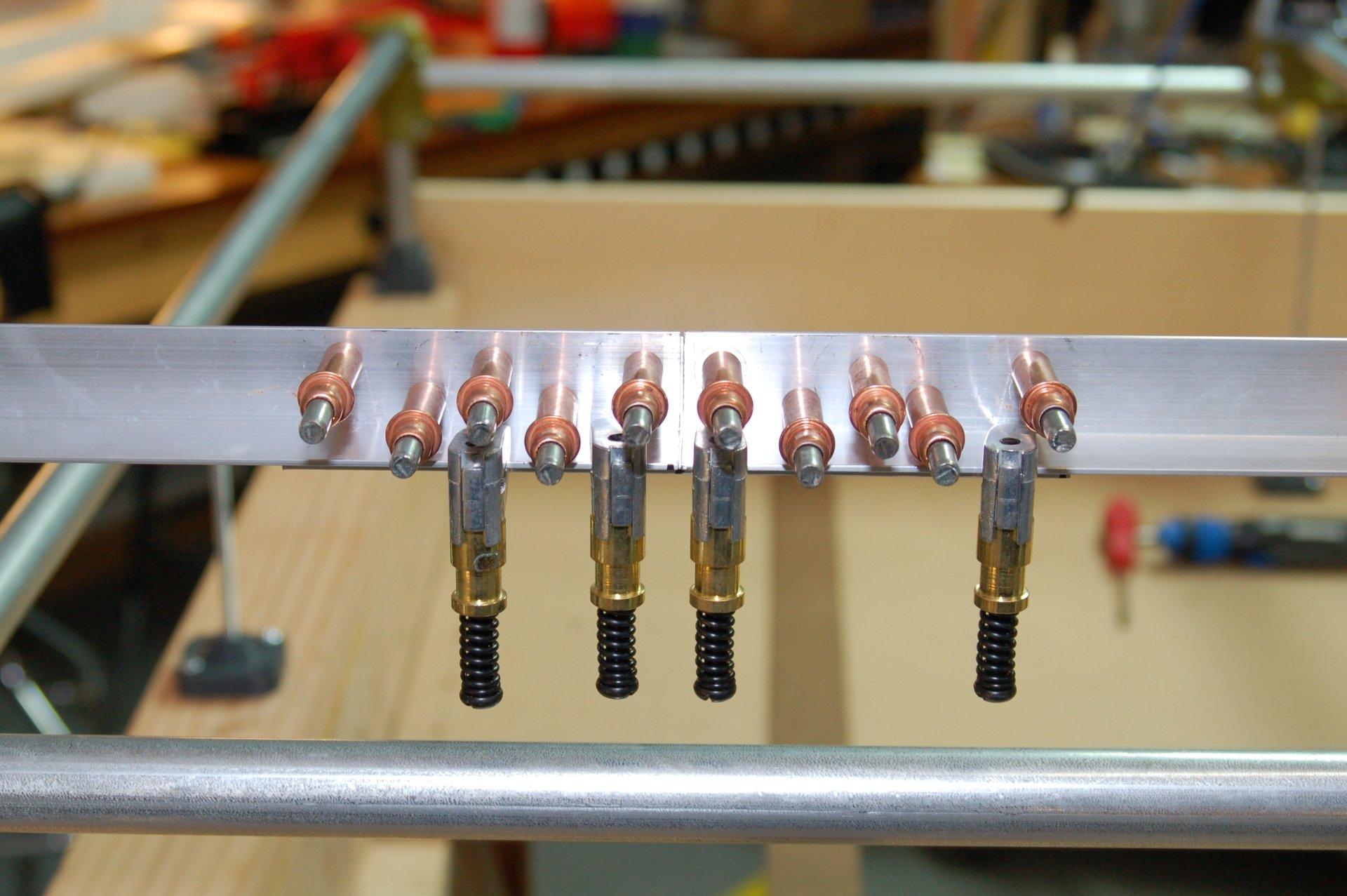

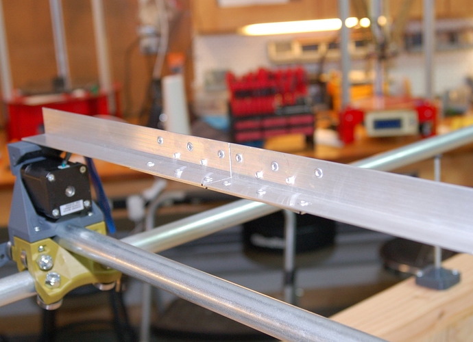

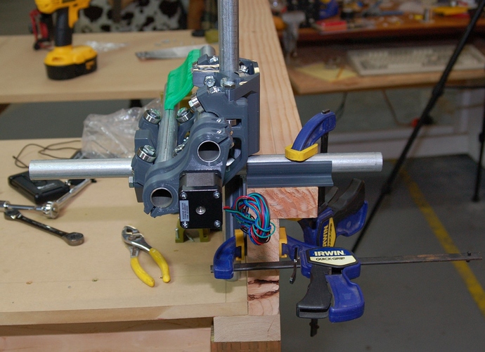

Here’s a few pics from the build…

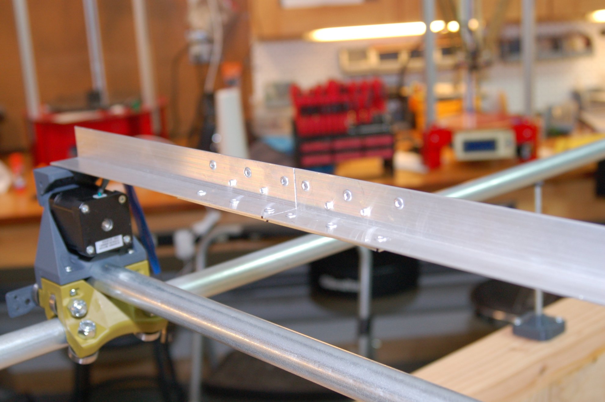

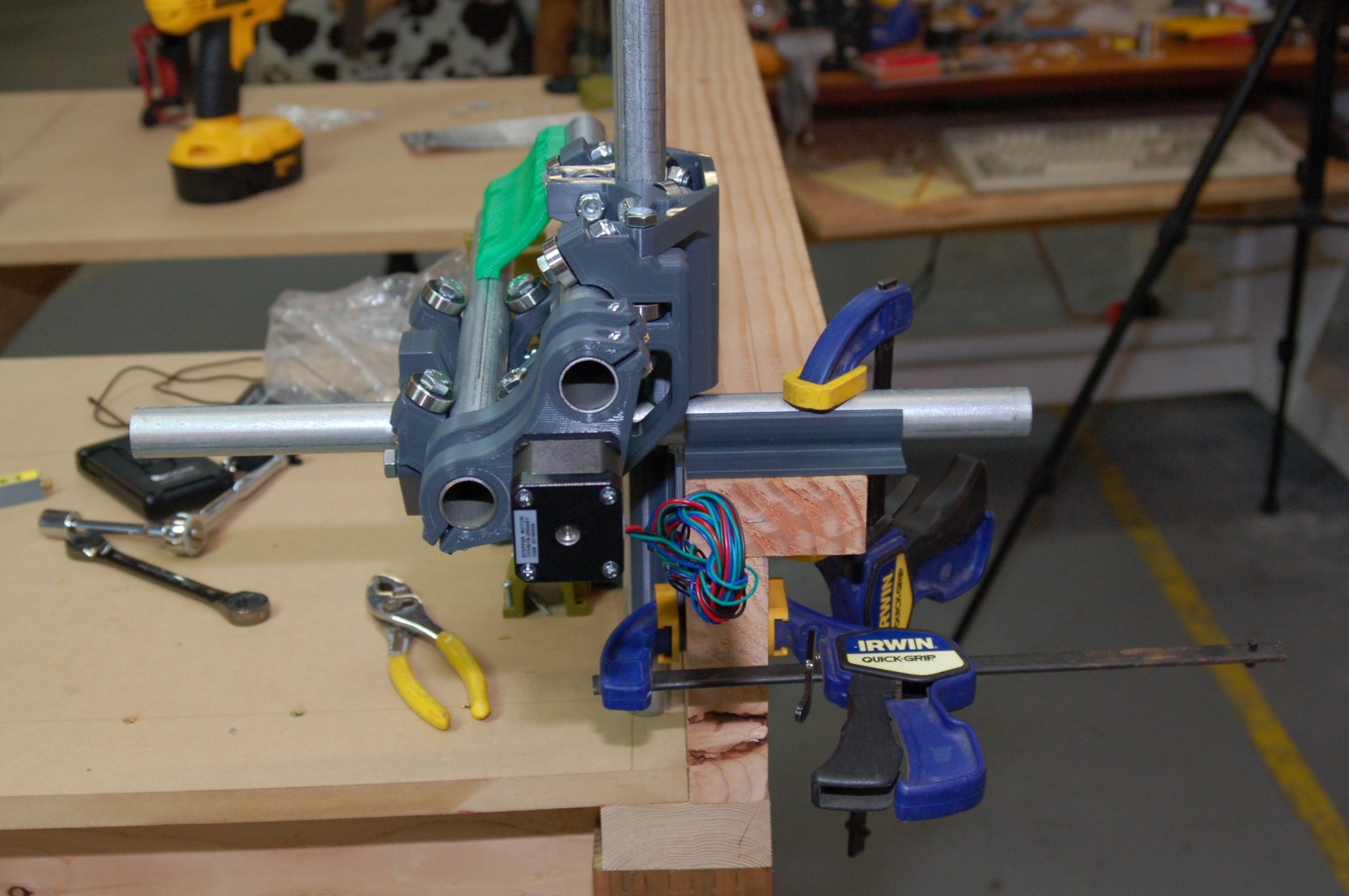

Squaring the carriage the “easy” way…
[attachment file=86847]
“USE ALL THE CLECOS!”
[attachment file=86848]
Unfortunately, I wasn’t able to use bucked rivets for this. It would have looked SO much cooler…
[attachment file=86849]

I see what you are saying, I assumed there was more room than the 660, but there is not. I don’t see an easy quick fix that would not mess up the integrity of the mount, sorry Gene. I have the editable file on thingiverse (under my files blank mount) if you just fill in the 660 mount to the diameter you want in your CAD of choice and you should be able to get the screws in like we do, with a little screw driver tilt.
